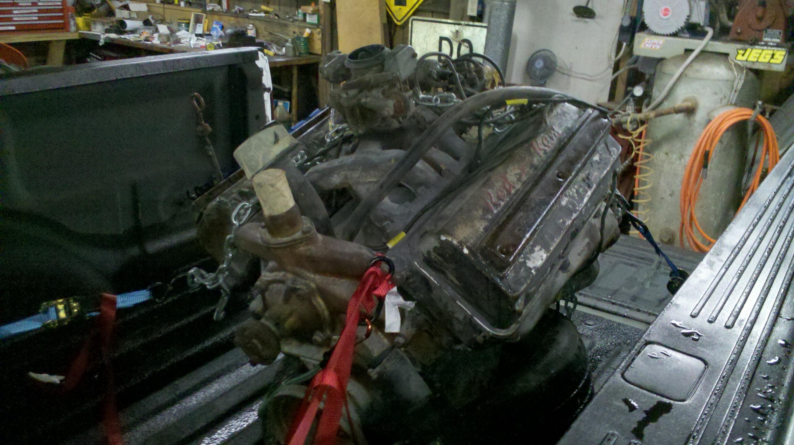

  6. Fenders
    Joined: Sep 8, 2007
    Posts: 3,921
    Fenders
  7. Mopar Jack
    Joined: Jan 24, 2010
    Posts: 1,363
    Mopar Jack
    great info...

    Probably a chr 354 truck hemi in a Dodge truck. If so 1,000 to 1,500.

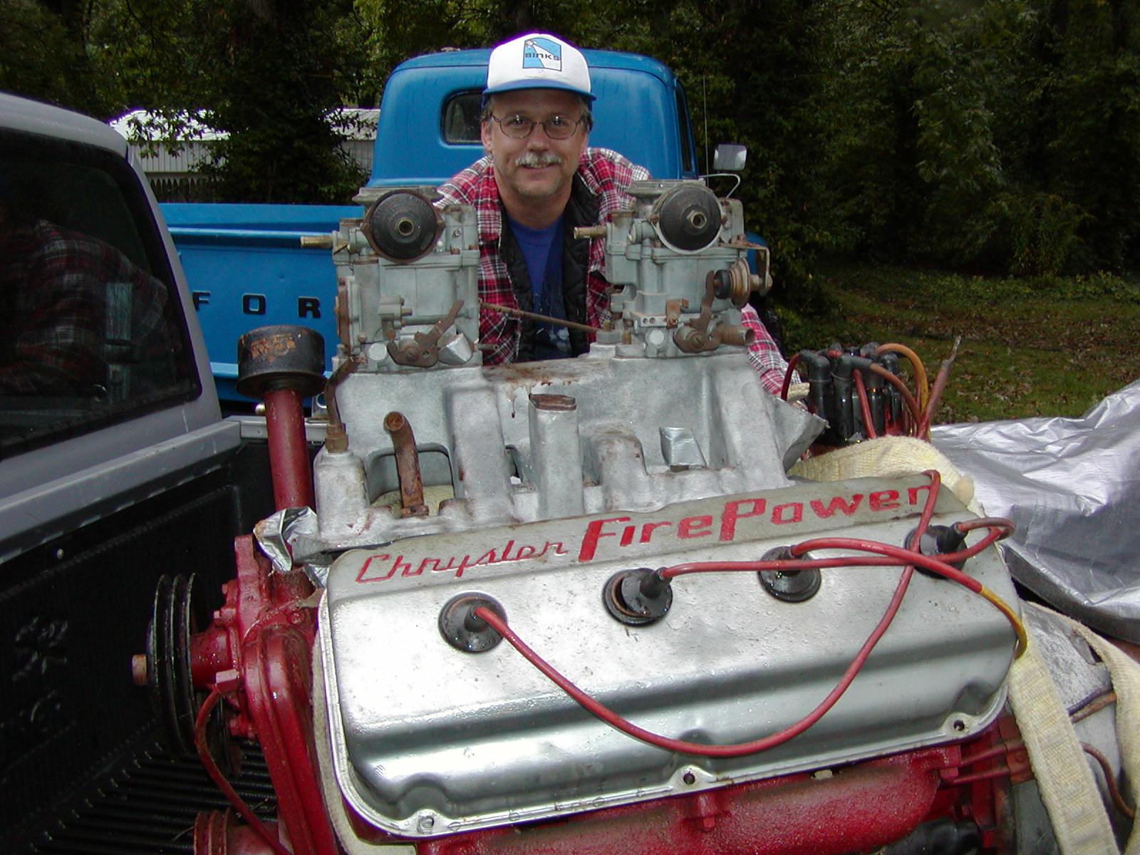

    What's a hemi worth? Thats a good question. I guess they're worth what the buyer and seller come to agree on. You will put a lot of money in one. I bought this 1954 short bell 331 Chrysler 8 years ago for $300, as you see it. And last month I picked up this 1954 241 Dodge for $400. I felt OK with both deals, and am looking for more...
