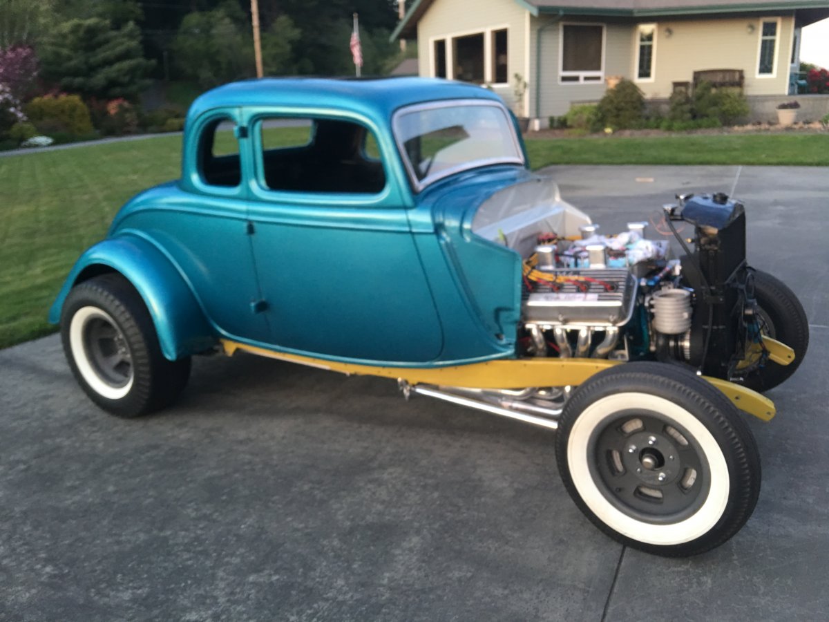

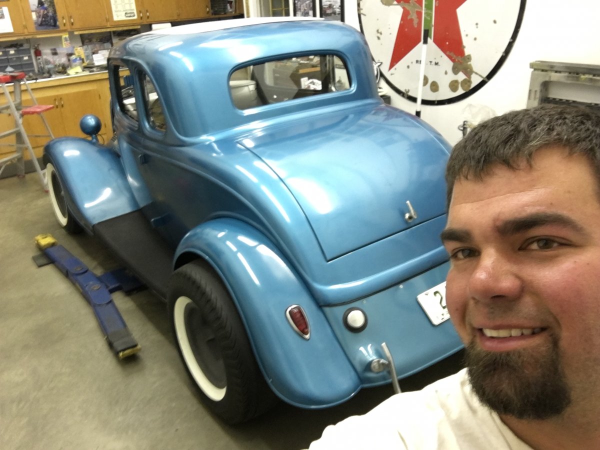

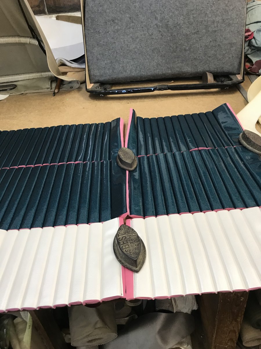

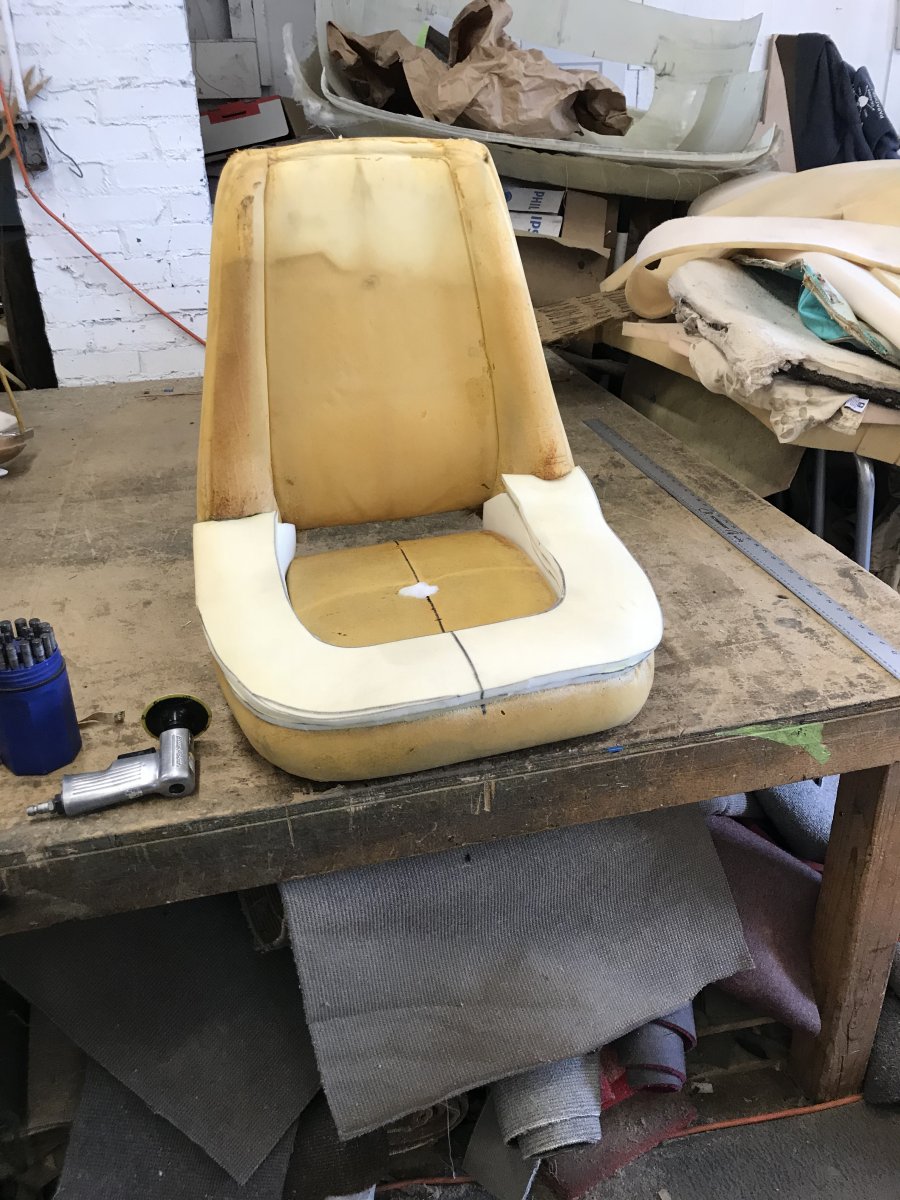

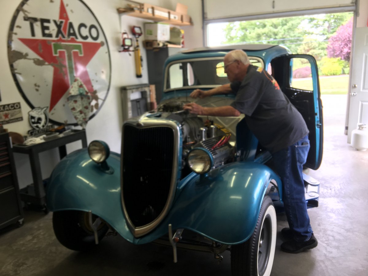

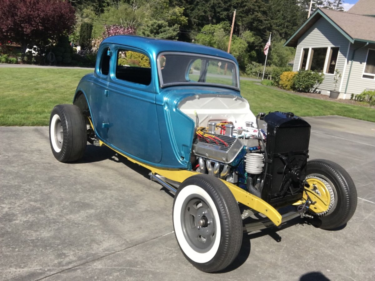

    Well it’s been a while. Got the car about back together and fired up for the first time yesterday. Herm Petersen came up to the shop to fire it and tuned it. She is a monster. Never was finish tuned before. Now it is. And so nice to see oil pressure. Wow. Hoping to take it to a show this weekend that my car club puts on. The buckets are in the upholstery shop being done and the bench is in the car until I can switch those. It’s going along anyhow.

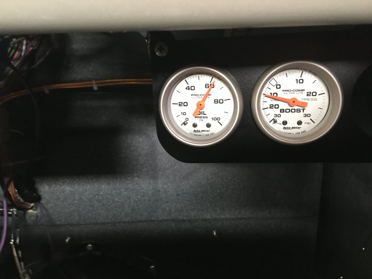

    As in past posts I have wished you well. With all that has been thrown at you over these past accumulative months , I have one thing that sort of throws the car off to me. Looking at the pics it definitely gives off the vintage hot rod vibe but the pics of the gauges , too me just doesn't fit. I understand you need the gauges but vintage or retro gauges would fit the car . Just my opinion . Glad you could see the light at the end of the tunnel, and it wasn't a train.:)

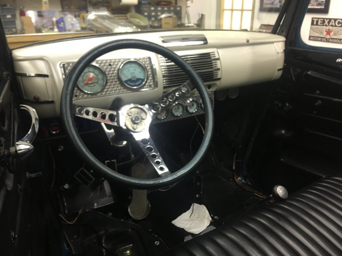

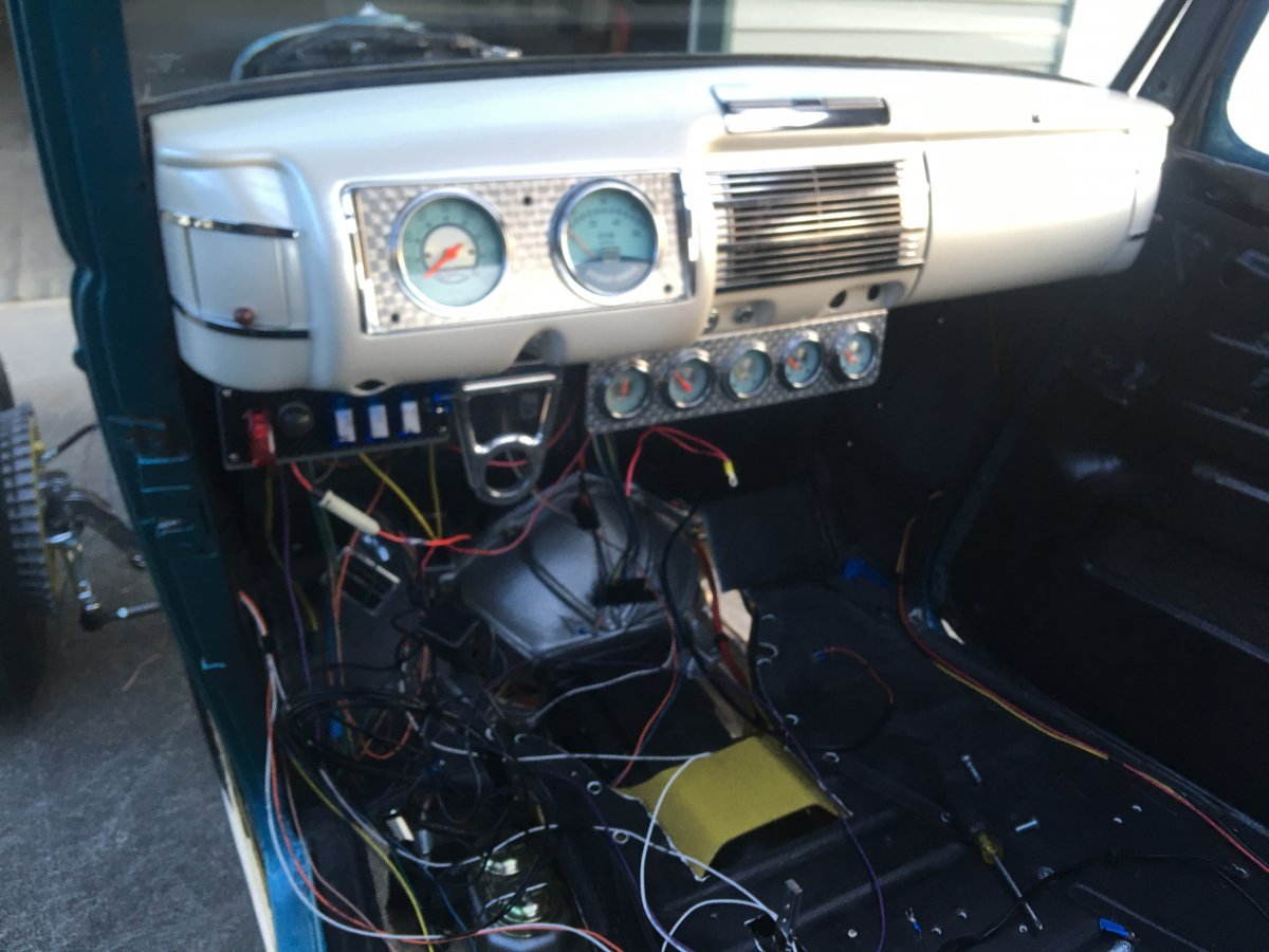

    The gauges are tucked underneath the dash so you won’t see them. I didn’t want to trust old gauges with oil pressure on a motor I now have $37k into. And they don’t have old gauges for boost. But here’s a shot of the dash with the gauges that you can see. All original Twin blues

    Cool! I like it but It made me think (that is dangerous and often expensive) a guy could install his late model gauges and switches on a hinged panel that drops down for action and folds away for show and shine.
    Seriously though, that turned out nice and compliments the dash I think. Glad you have your car back! Washington rules! Actually I cant back that up but we do build cool cars.

    There’s a little better showing. The gauges are tucked under enough to hide away.

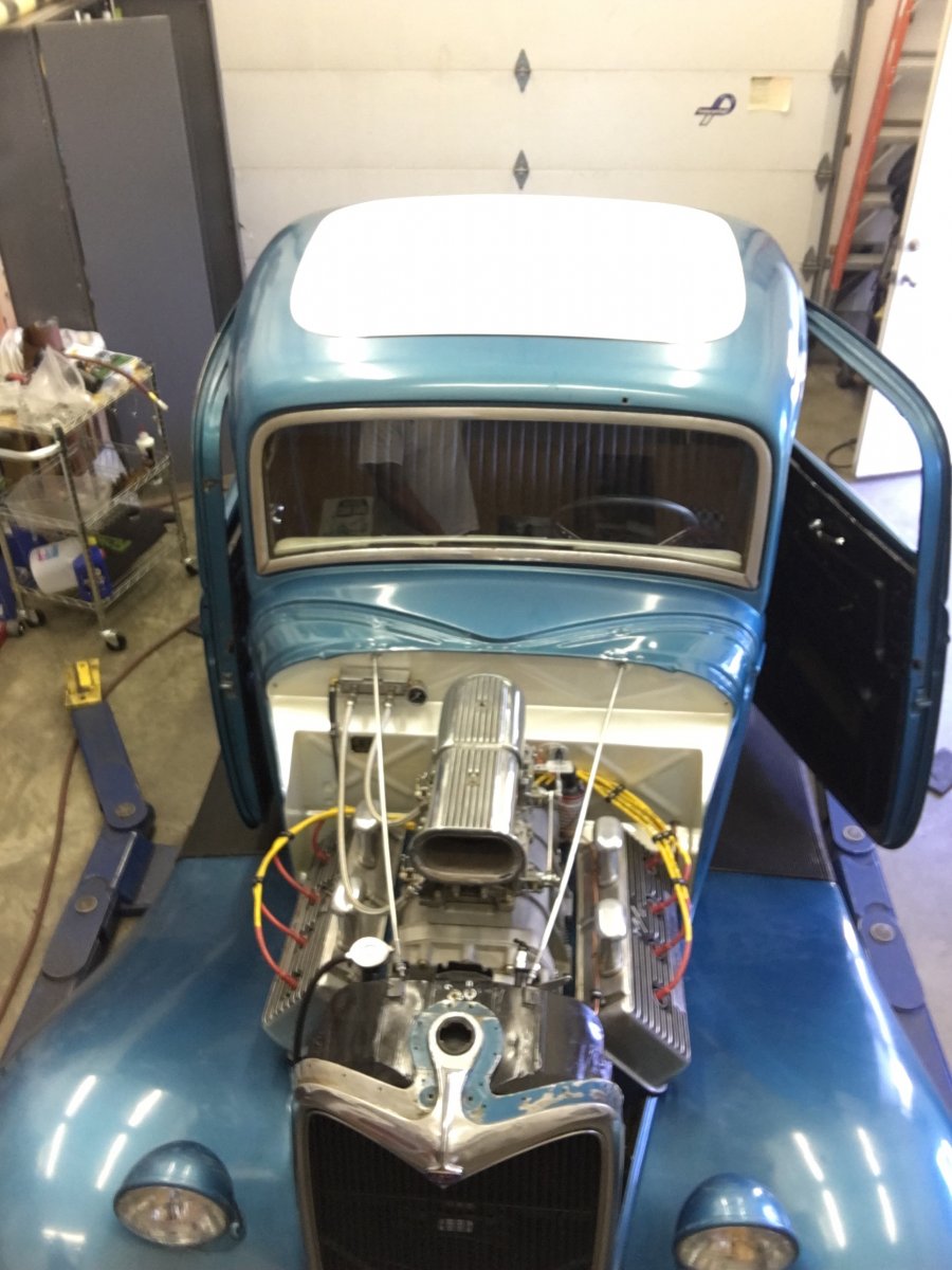

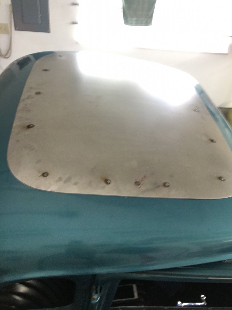

    A little top treatment. Going to plug weld some bolts under where the screws are now and have the metal covered in white vinyl. Unboltable but strong. 3A301AB0-7AAF-4DDE-9246-281DB326DC61.jpeg

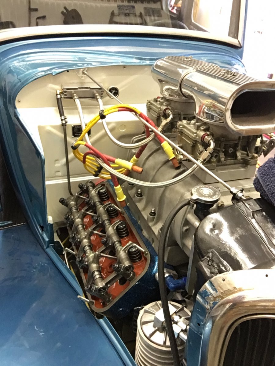

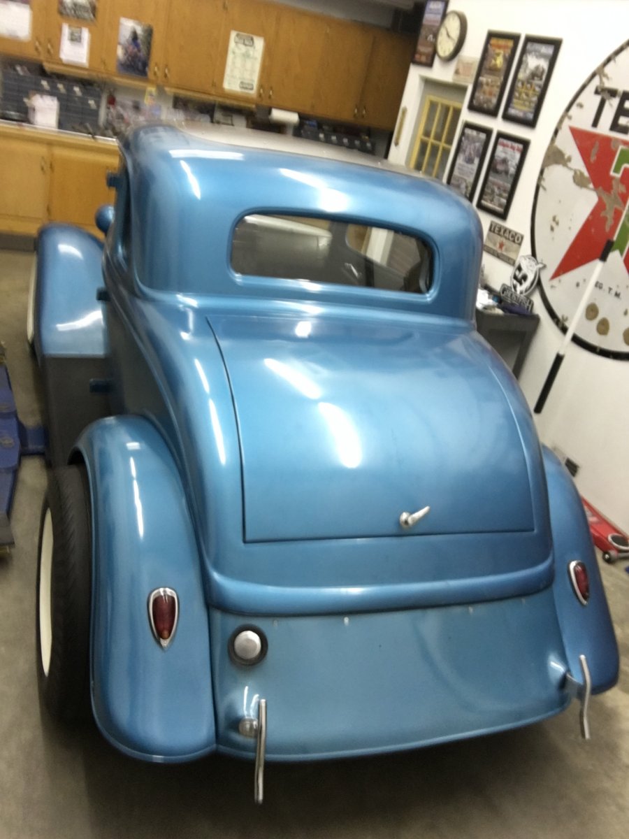

    Retorqued the heads. And painted the rear panel. The hardest blue I’ve ever tried to match. 1962 dirt cheap special lacquer. Just not easy to match. Oh well it’s blue anyhow B6555503-8CA7-4CD5-80D3-0DE393D7C921.jpeg 8E718EC4-42F7-4625-9969-4FFAD3A36214.jpeg 0A88BA83-561D-4E61-8E5E-6E81C830A6EC.jpeg

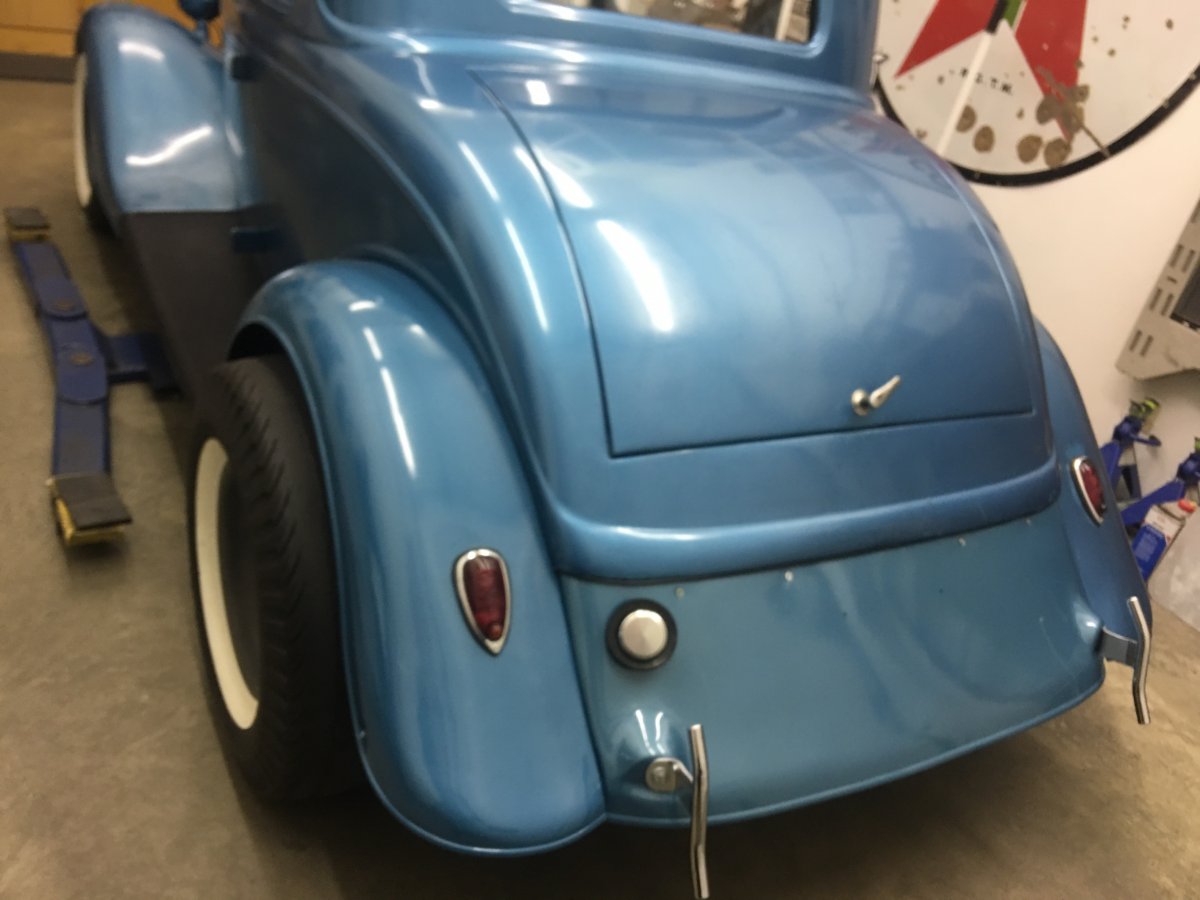

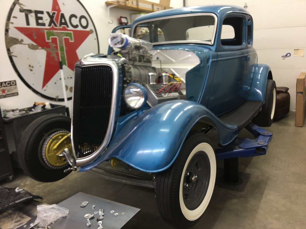

    Little welding. Little grinding and a quick paint job gives it the look I wanted to see before putting white on there with vinyl. I dig the white. It’s what it had originally when it was hot rodded. Someone just painted the white patch black

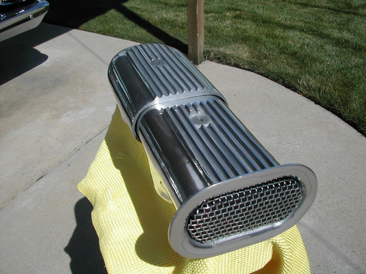

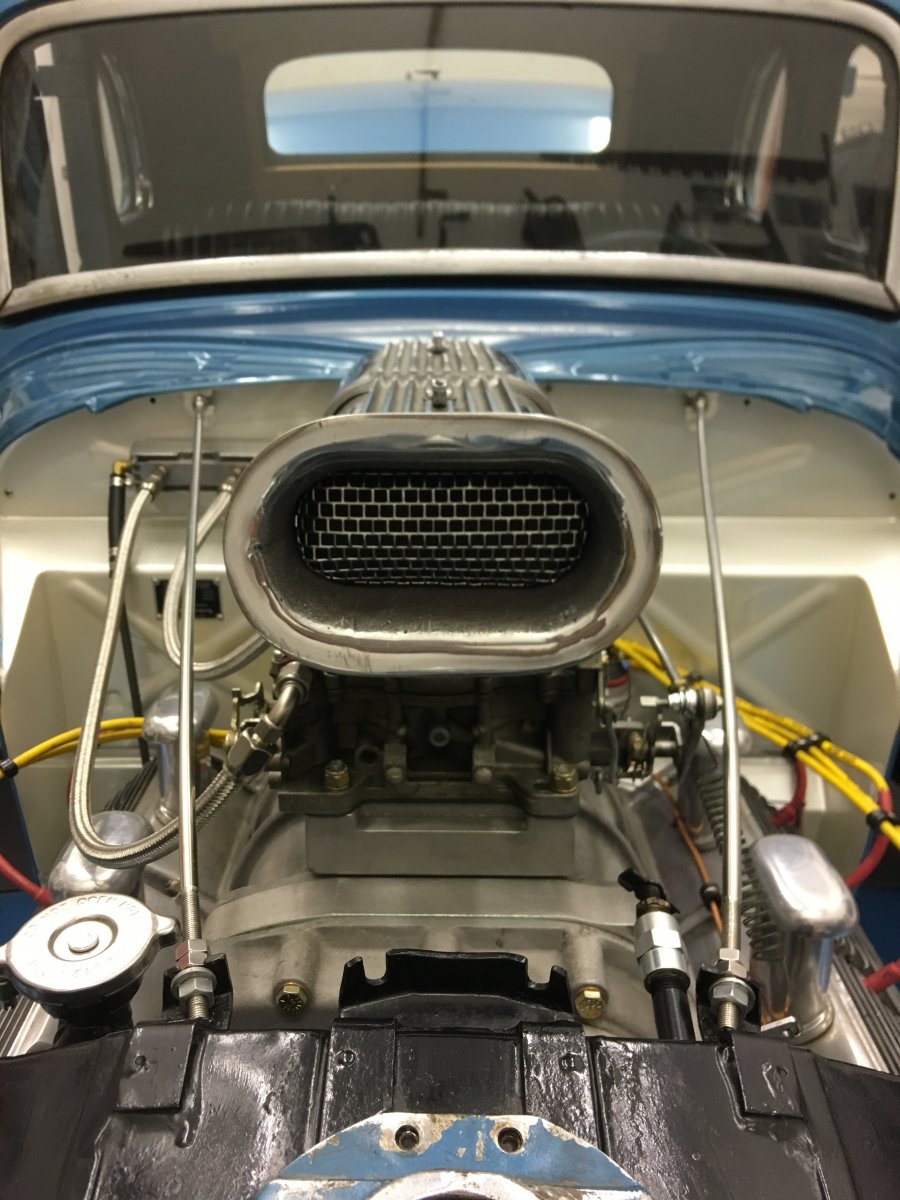

  26. ... I see that KQQL Hemi is sporting an old Cal Custom scoop like the one I sold on feebay 10 years ago ! ...
    kidcampbell71, Stogy and loudbang like this.
  27. GTO_MUSCLE_SS
    Joined: Sep 26, 2013
    Posts: 162
    GTO_MUSCLE_SS
    I almost bought that scoop. I need a screen for mine damnit.
    Stogy, loudbang and 1935streetrod like this.
  28. ... I made the screen by cutting up an Edelbrock air cleaner into two ovals and putting the filter foam between them ... then tack welded a wire to the back that could be looped around the carb stud to hold it in ...

    That was damn near exactly what I was planning. Except the metal and foam from one of my velocity stacks. Oh well just ran to the store
