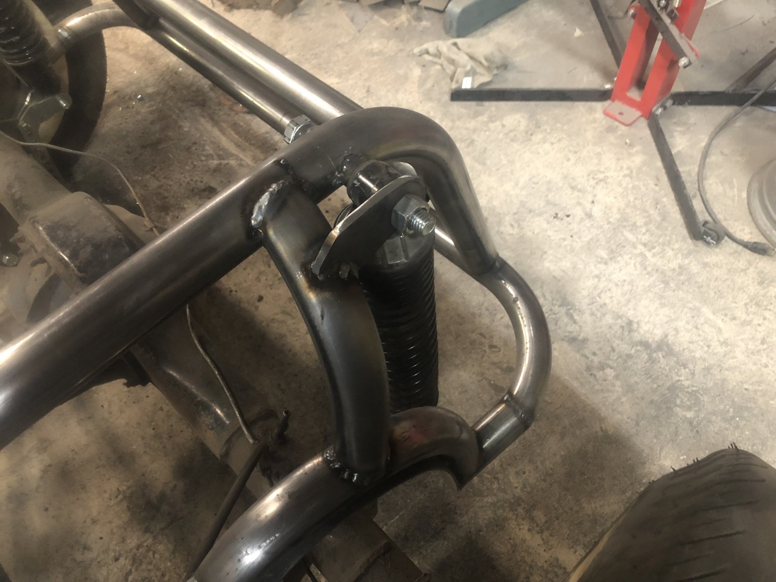

    The car while on thanksgiving break from work. The Rube Goldgerg steering has always been real hard to steer while the car is not moving. After completely rebuilding the ross steering box and making sure that the pile of heim joints were all working as planned, i realized that my leverage was wrong on the steering plate attached to the spindle. The store bought arm was just over 6 inches long from the end to the kingpin. My new one is 8 1/4 inches. This made all of the difference in the world. My car now steers! Yea!!!! Other than this, I just went around and welded the chassis up enough for a test drive, and built a set of mounts to allow the rear shocks to be in double sheer instead of the single sheer style , like they were.

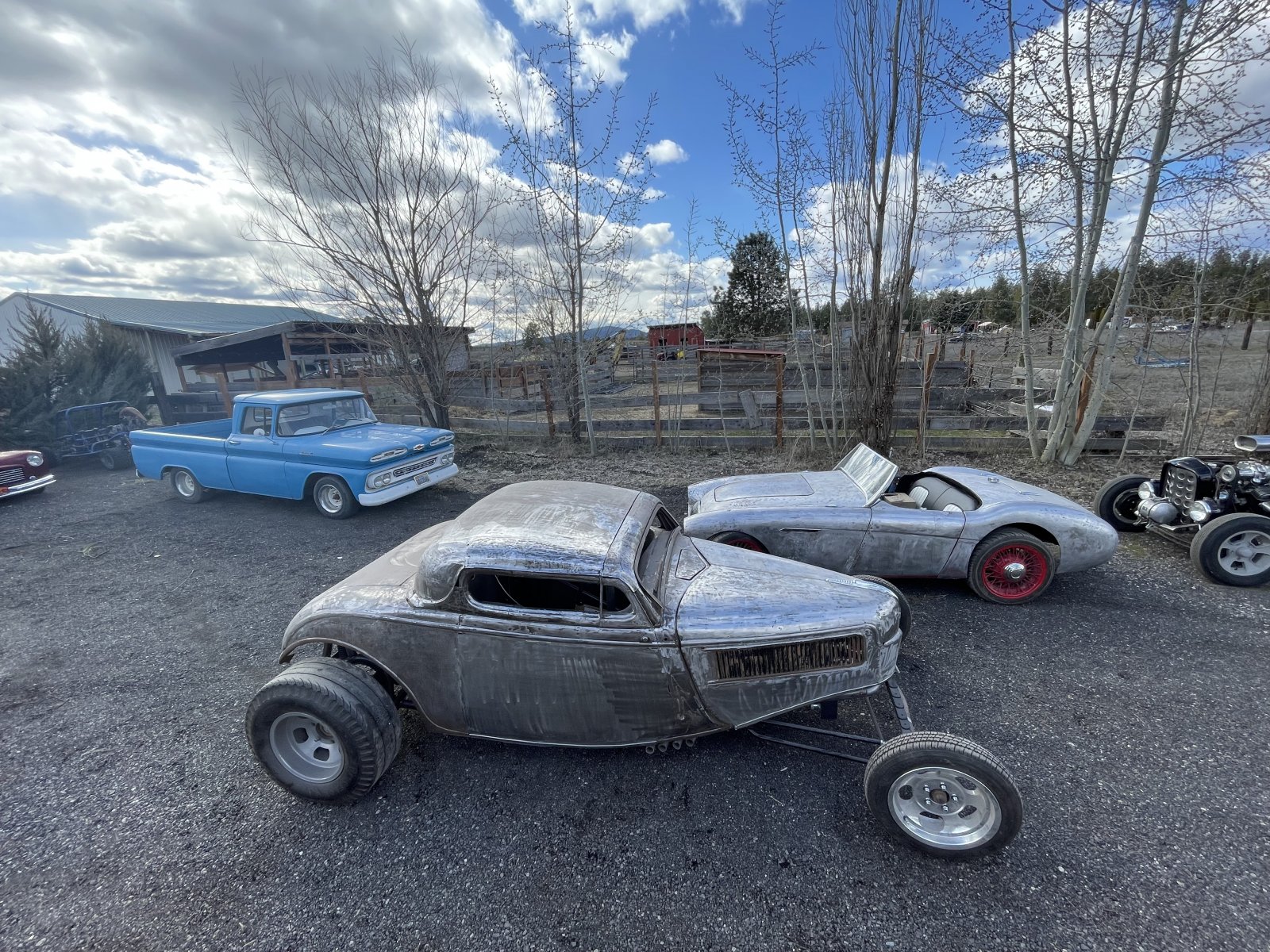

    Got the car welded up and pulled it out for a few pics. 4DC2BA5D-9208-4785-B9A7-EBF020CFEDFC.jpeg

    Its SOOOOO Rad, you must be stoked to start to see the payoff from all your hard work!
    enloe and Stogy like this.

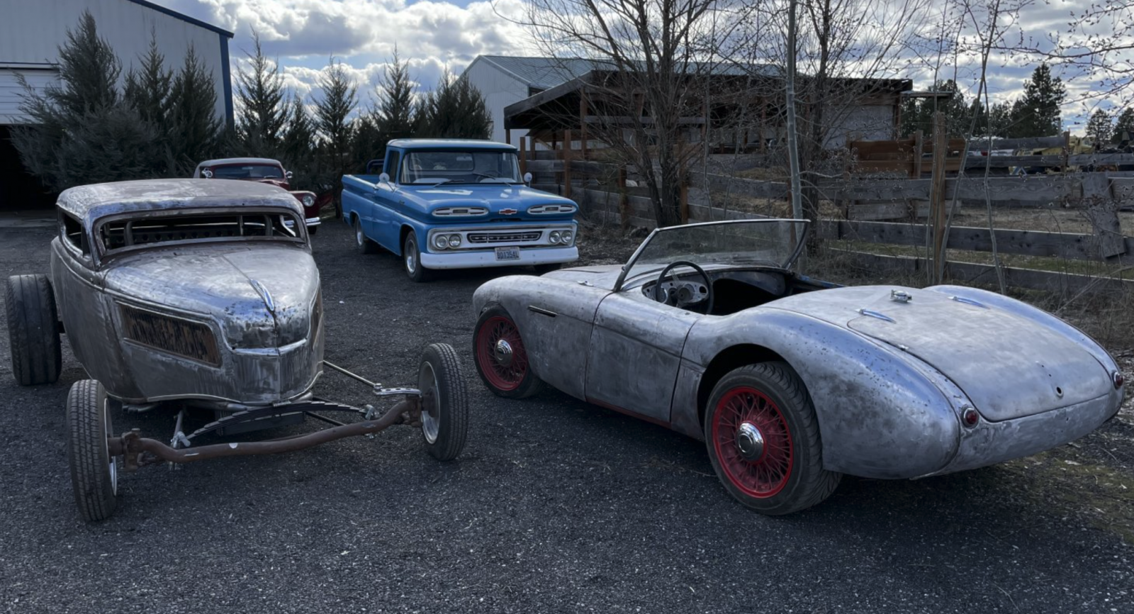

    exterminator, enloe, brEad and 15 others like this.

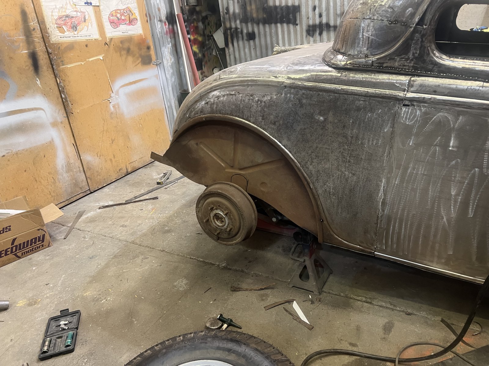

    Its fall and I am pulling all of the cars that i will work on over the winter into the main heated area of my shop, so back to the junk. 34. I have began stiffening the roof, and making it fit the car. I have also decided it needs wheel wells. I was going to leave them out, so as to show a little bit of the tube chassis, but i had a set of ecklers wheel wells in my loft, so I am using them up. What do you think, better with them
    Or more racey without? A7384966-4BCB-41C4-A84D-1B90AA6DE845.jpeg E2F2942B-8A5D-4FB6-8F03-1EAE25981E6E.jpeg

    I like the wheel wells. As a Model A guy the beads are 180% reversed, or have you placed yours that way for more tire clearance?
