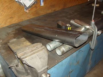

    Well I guess it's time for an update. Like I said earlier, I decided to add an exhaust. Like every project it's always more work then I thought it was going to be.

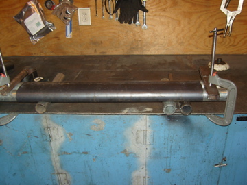

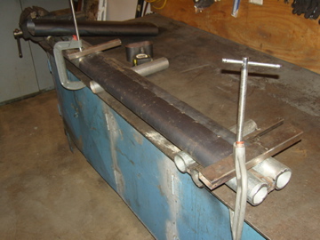

    The first issue was how to squeeze 4" of exhaust under a truck that's only 5" off the ground at the lowest point. I figured I'd use oval tubing. But being the cheap ass stubborn pollack I am, I couldn't image dropping the kind of coin they want. So I did decided to build my own.
    I built a die out of 2 lengths of 2" steel pipe and 3/4" square tubing. I bent flat 16 gauge around it using vise grips, pipe wrenches, my body whatever I needed to push it around. The finally ratchet straps to pull it all the way closed. Actually once I figured out a procedure it wasn't too bad.

    My Dad use to call that being thrifty!! Nice job & great "buck" to get it uniform.
    If you had a press & torch you might have been able to get round material & flatten it out to your desired size. Just a thought.

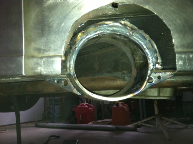

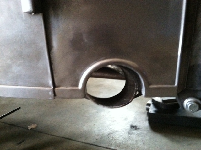

    Probably, one of the tightest parts was making the turn off of the collectors and the turn under the cowl. I originally was going to make the round to oval transition at the cowl. I ended up staying with the round until I made the turn towards the back because I didn't have the room for the oval 90 elbow. Plus I thought the round looks better coming off the collector. The problem I was now running a 4" piece of tubing through a 4" frame rail. Obviously I couldn't just hack a huge hole.
    I built frame cut throughs using cut down 5" steel pipe. 5" steel pipe is 5-1/2" OD, so I cut out a 1-1/2" section and heated and squeezed it down to 5" OD. That left me 4-1/2" ID to sneak the 4" exhaust through.

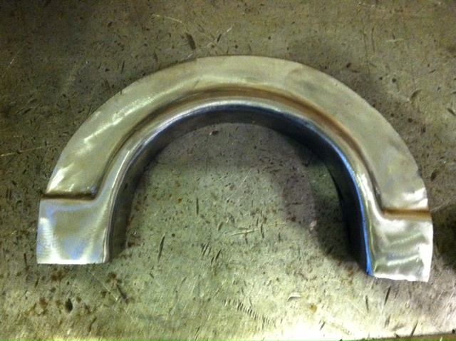

    Since I decided to put an exhaust on it. I had the idea of a bead running around the tubing to finish it off.
    I've never tried to form sheet metal with a hammer form. So I figured I'd give it a try.

    That's right thrifty!! I thought about that but from what I read and kind of experimented with was that it crushes the center and doesn't make an oval.

    I also made the transitions from round to oval. For these I started some of the oval tubing I made. I made a die the correct ID for the round end. I split the tubing to form the round end. I reused the oval die and welded everything back up.

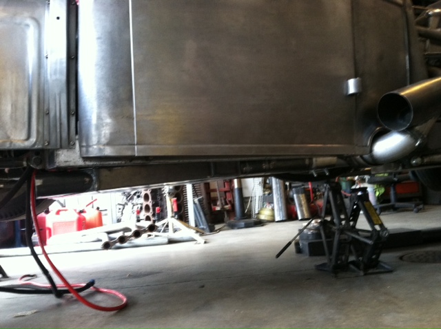

    So, I got the mufflers mounted and mocked up the rest of the exhaust. I had measured it out before and I came up with 3" of ground clearance at the lowest point. Saying that'll be enough and actually seeing what it looked like is another thing. Once I set the truck on the ground I knew it would drag on everything.
    So....a new plan was in order. I decided to cut down the mufflers and notch 2 crossmembers plus a part of the frame rails. This was after I had both mufflers completely done. That and it's now April and I want to be driving this thing. But I'm not good at compromising when it comes to stance, and I sure as hell can't raise it up any.
    So I took a few days off of work and I now have both sides mocked up and the exhaust mostly finished welded. Now I got a bunch of laying on my back welding up all the crossmembers I notched. Plus I need to reroute the fuel lines, because they ran on the frame rail which now has a 4" exhaust pipe running through it. I have a open channel mocked up to run the lines through. I wish I would of thought of that when I first built the truck.:)
    Anyway heres the pics as this is where I'm at right now. I have 2 more days off next week hopefully I'll be close by next weekend!
