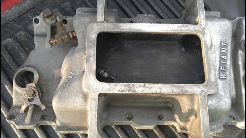

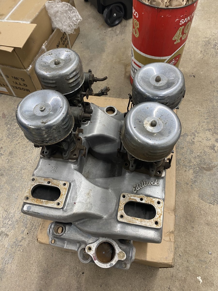

    Posted them on page 2 but they didn't expand for some reason. These should get bigger. Original intake, drilled for 4 or 3 bolt carbs. Will be going with some 2" risers and frogmouth scoops.

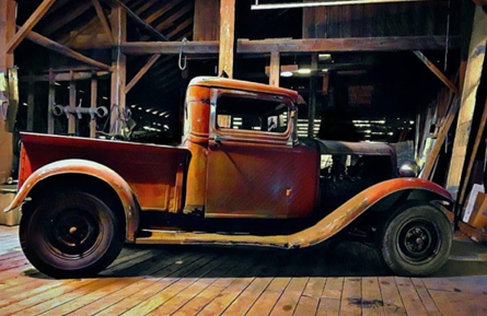

    thanks! Mine is channeled roughly 4-5”, been playing in photoshop by shortening the bed to 50” and a 4” chop. Looks proportionally right. Its a wild look for sure. This pickup has a 49" box and 5" chop, no channel and on a 32 frame/wheelbase so the box distance between the cab and fender is longer here.

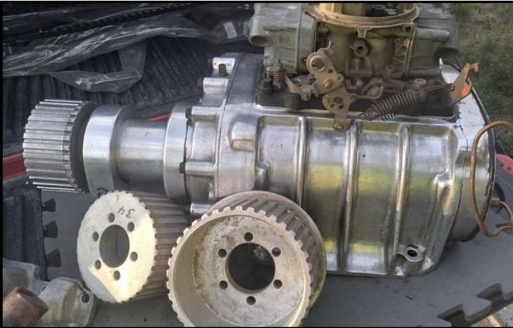

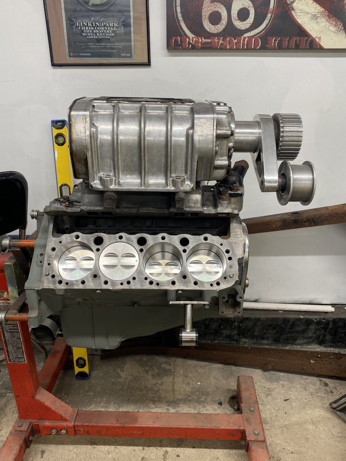

    Finally got the blower home. Now to figure out pulley sizes to underdrive if enough to get around 5lbs of boost so I don’t grenade the motor hahah. Pulleys I got with it are 32 and 34 tooth and the larger bottom pulley is 38 tooth. I believe I have to be in the -6% ratio range so either a new top or bottom pulley will be needed. I need a belt and a water pump pulley so maybe I can just find a whole kit.

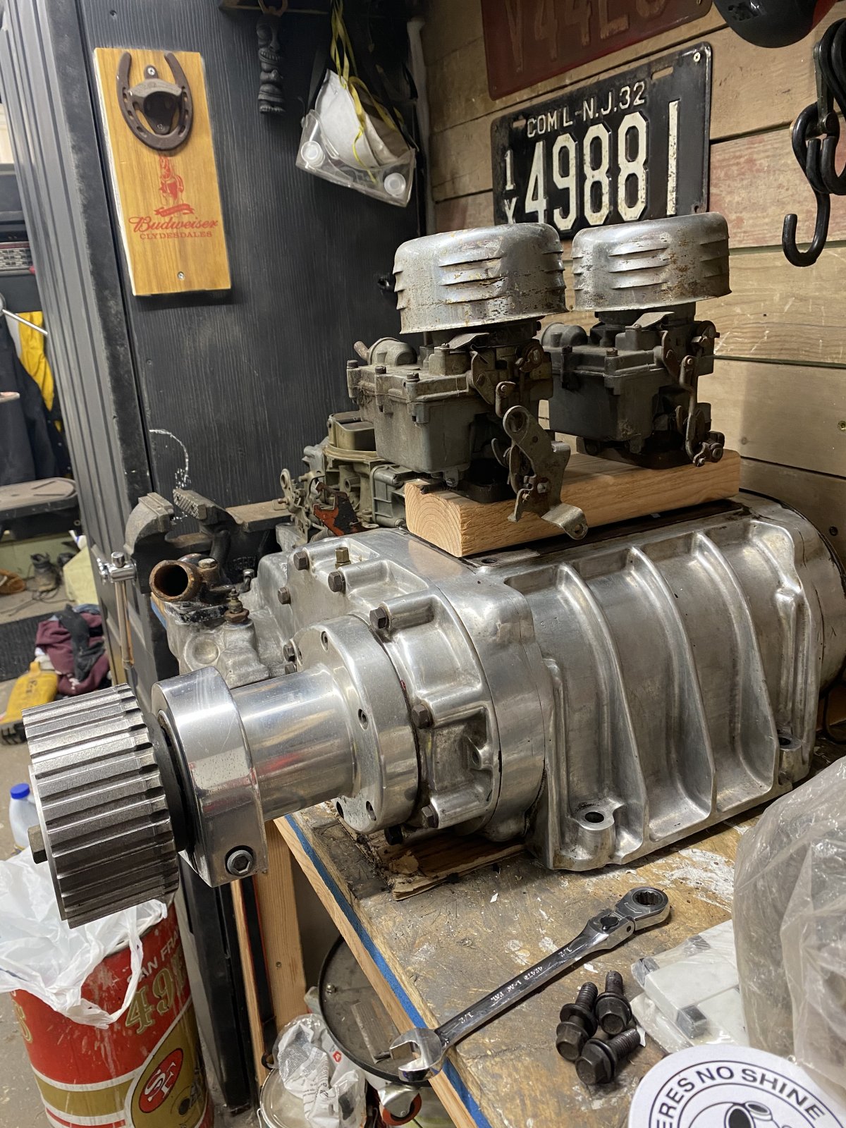

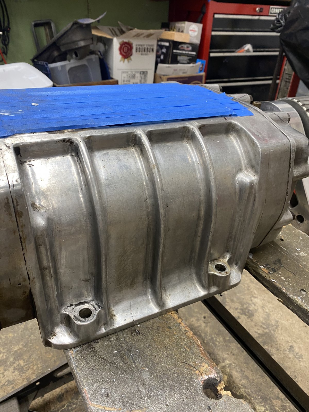

    Had to measure for pulleys / couldn’t help myself
    C2B99F78-0382-44D3-BB15-89C443D80A01.jpeg 80394710-8647-41AC-8DF6-3AE07FFAF999.jpeg

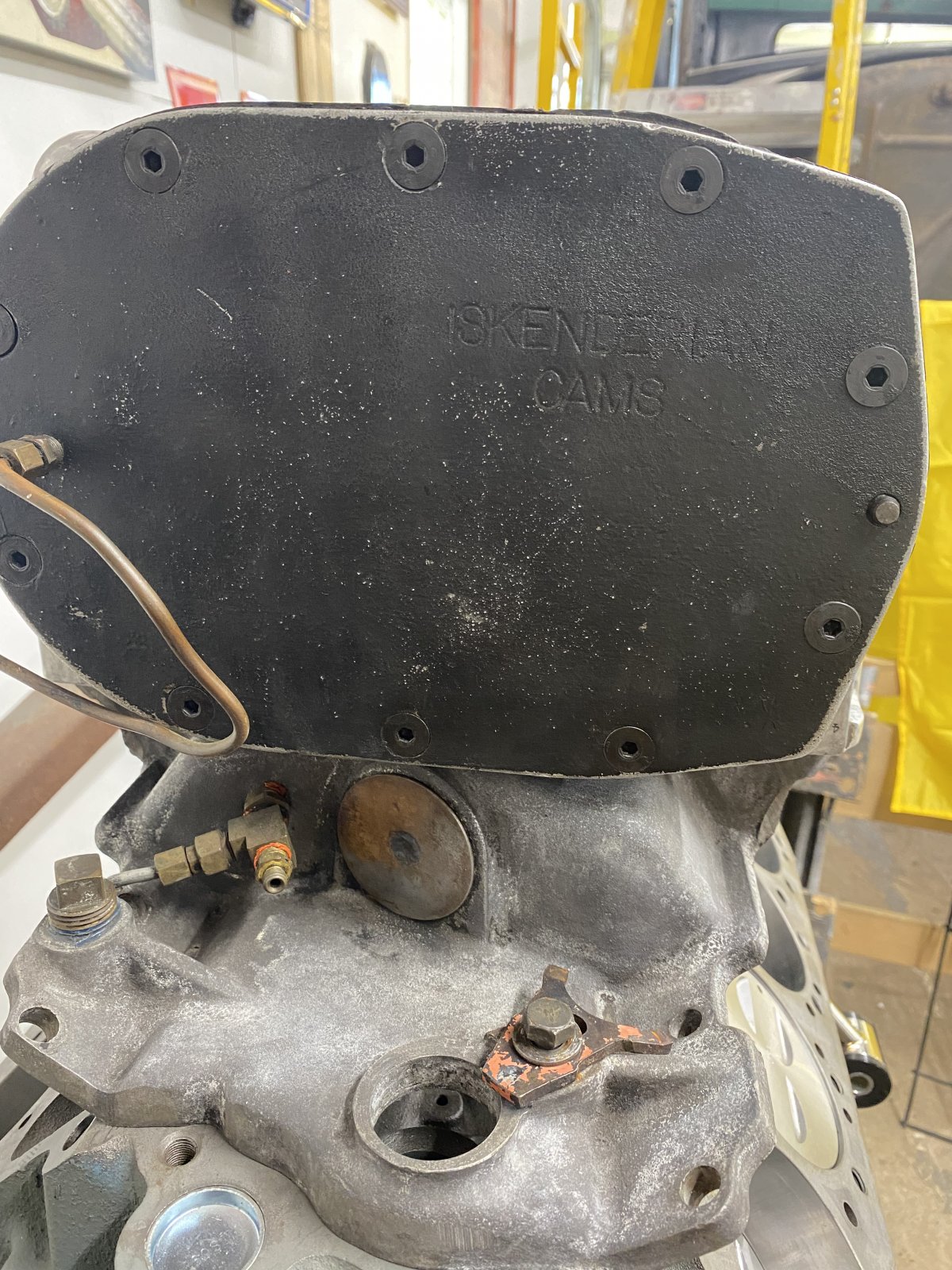

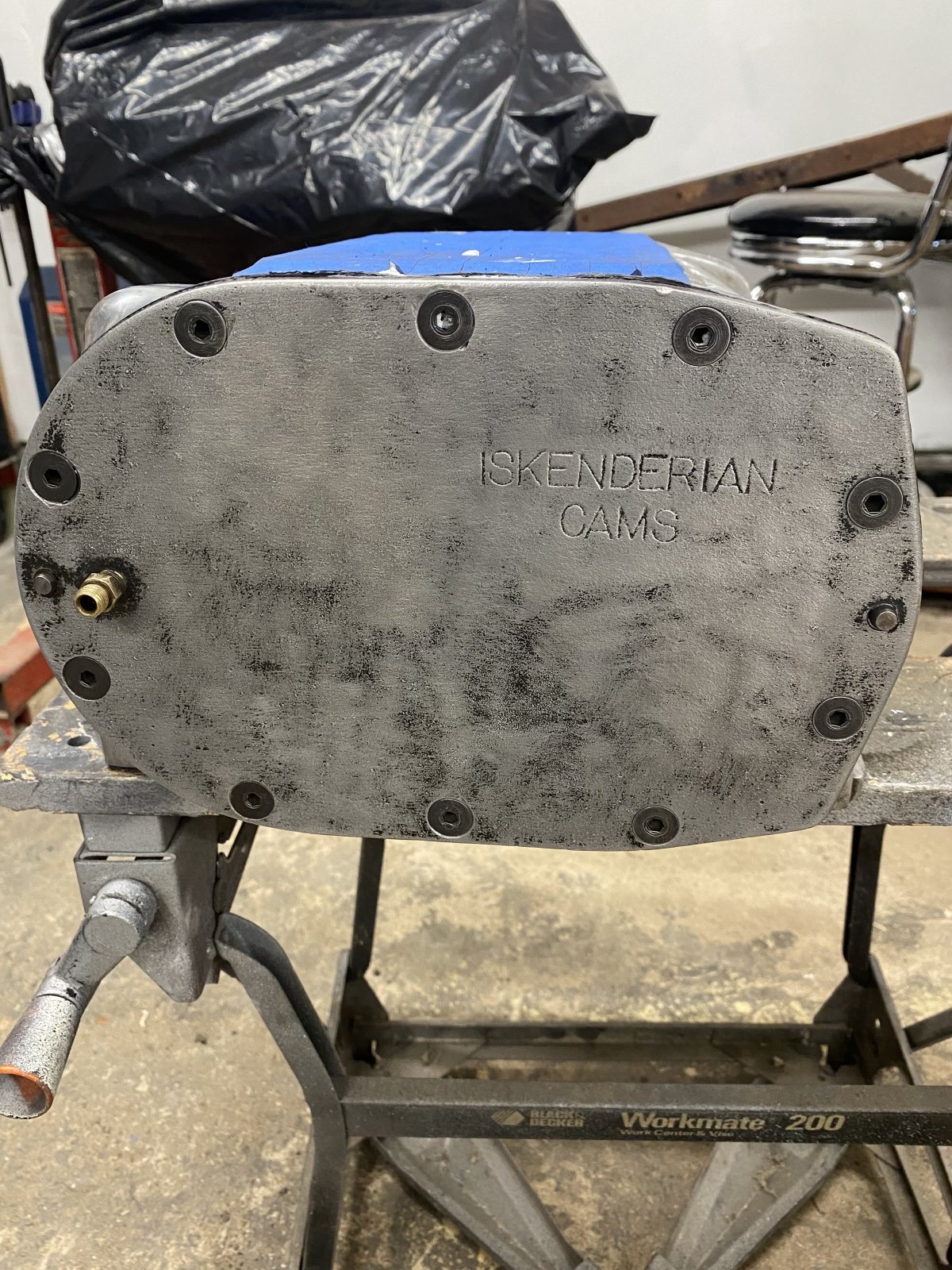

    apparently this rear cover is super rare. Cleaned it up a bit real quick
    E311F5E4-68B5-4EE4-A24D-55FC0FD8922E.jpeg BC4DB201-CBF6-47F8-8E28-F15C45DAEDFF.jpeg

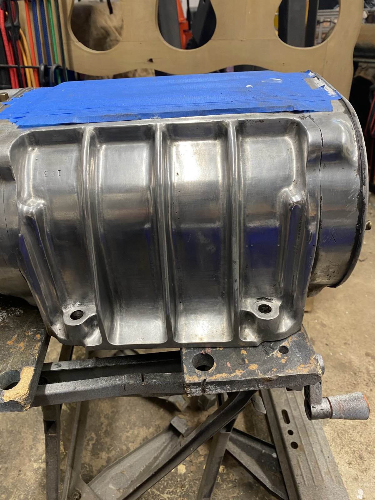

    Blower and manifold were polished at some point, nice and smooth just dirty with some pits. Will polish it as is, will go with the vibe of the truck. One side was hit with some polish and a wheel no sanding. Other was how it started.

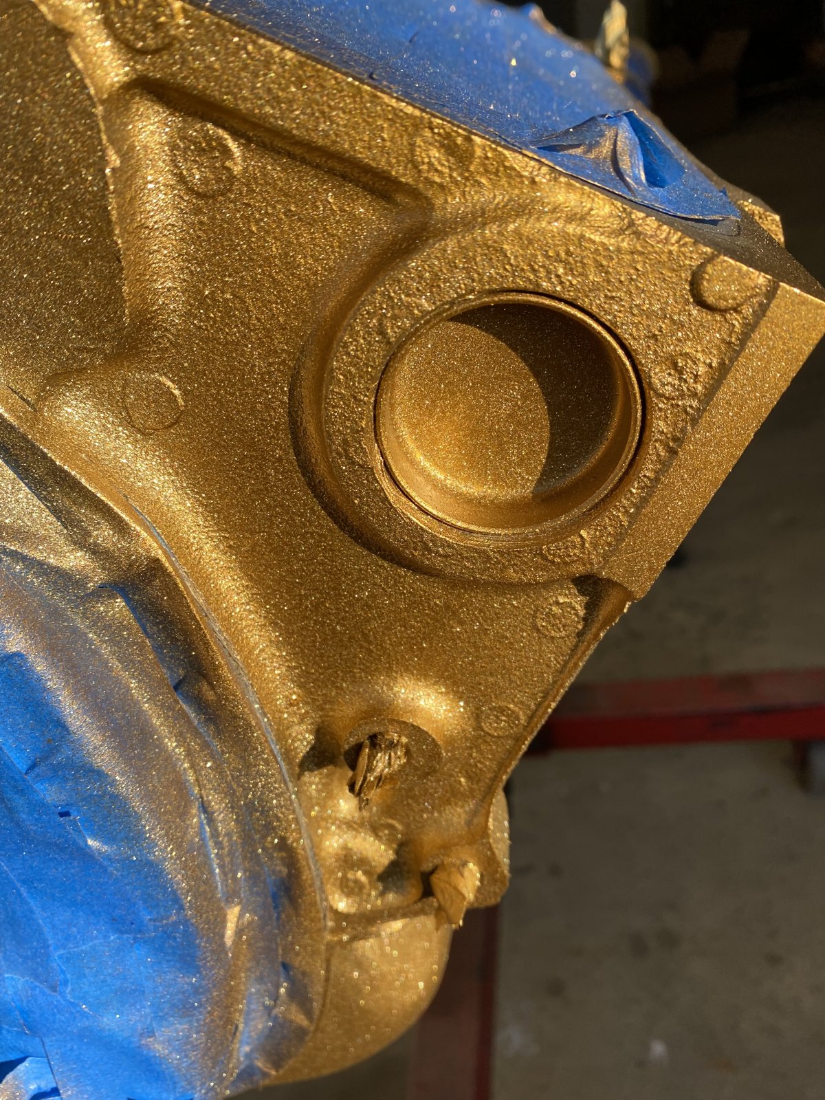

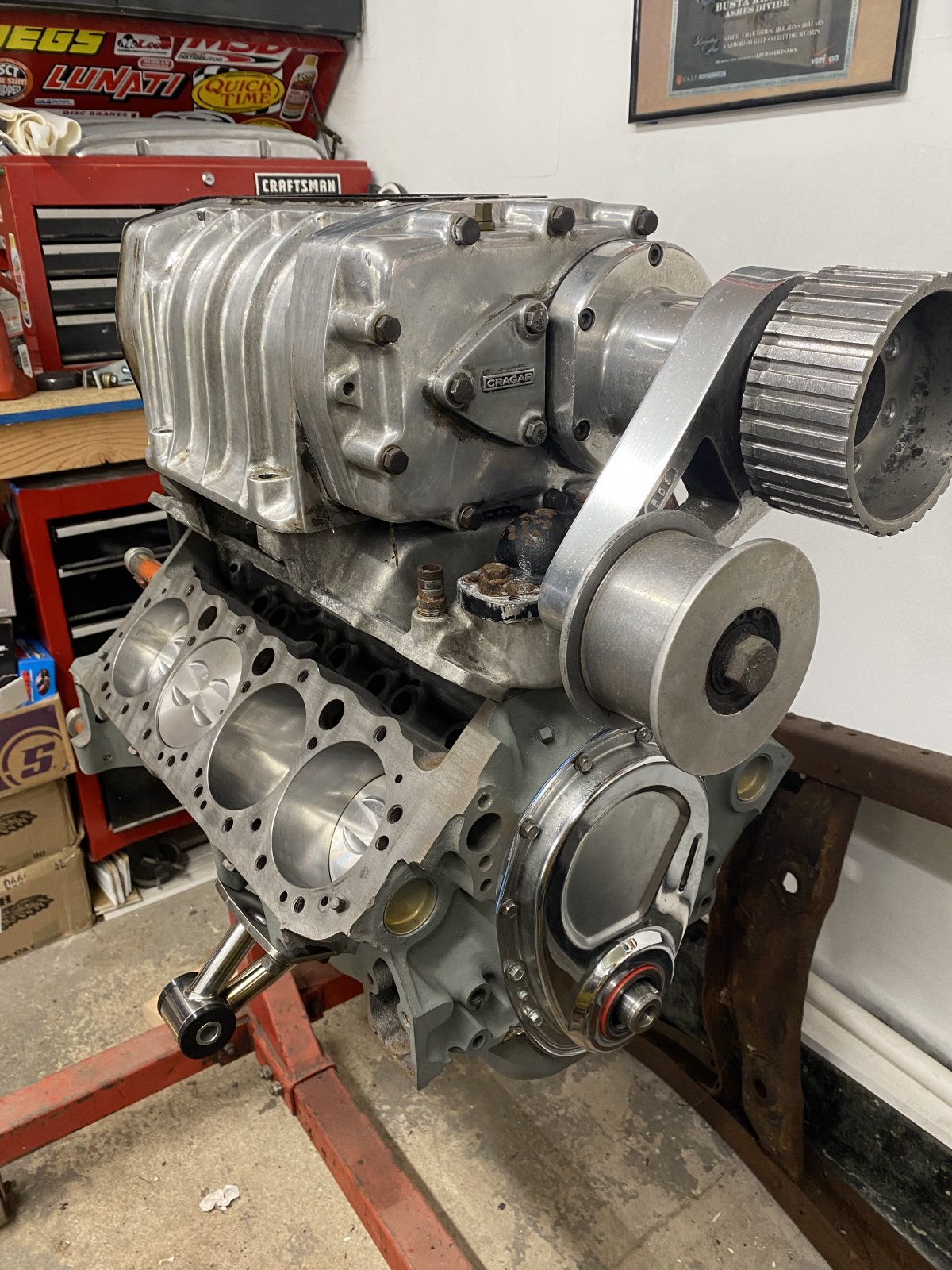

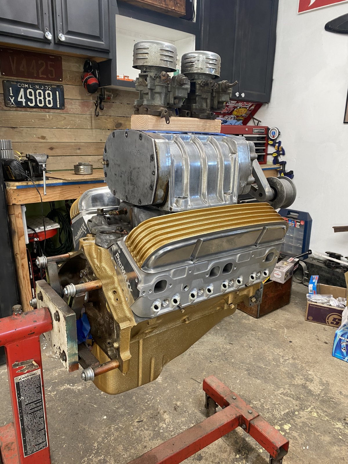

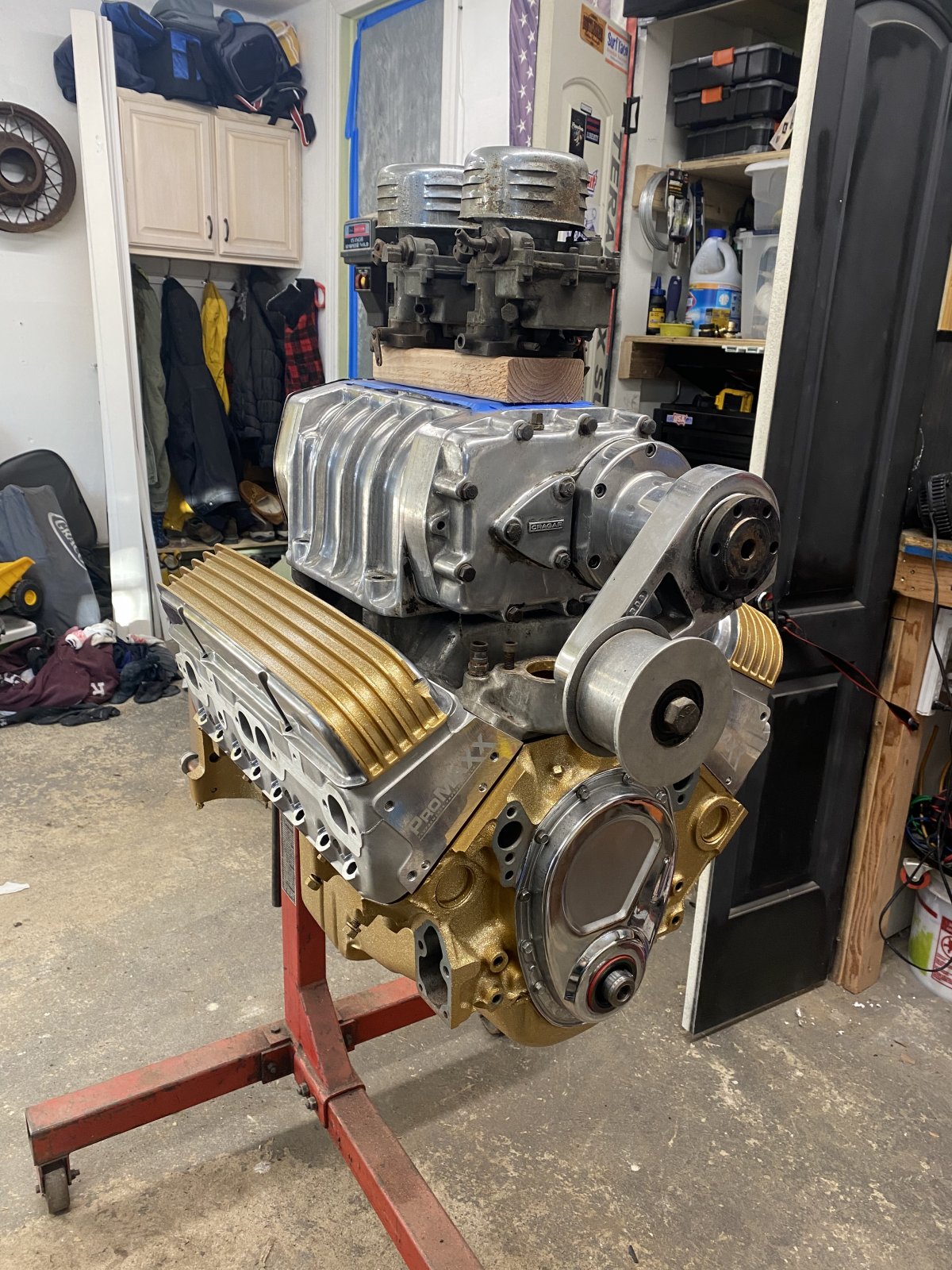

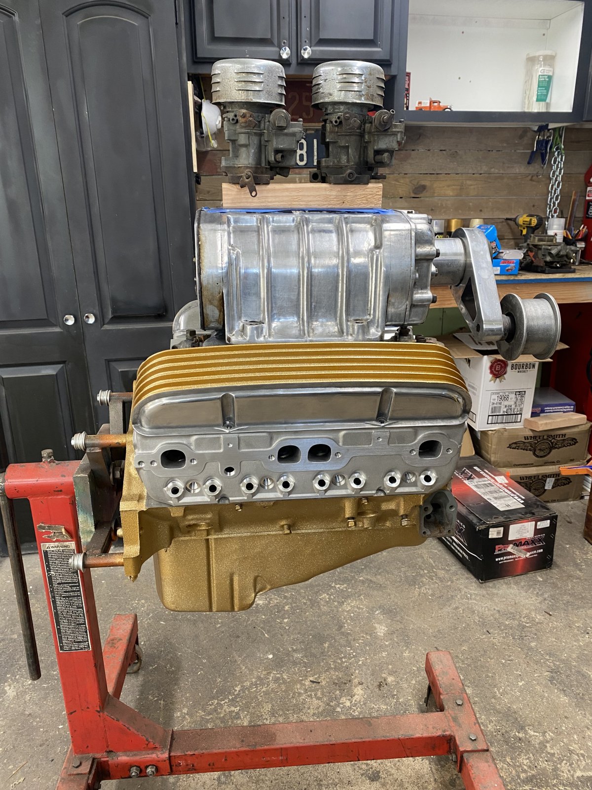

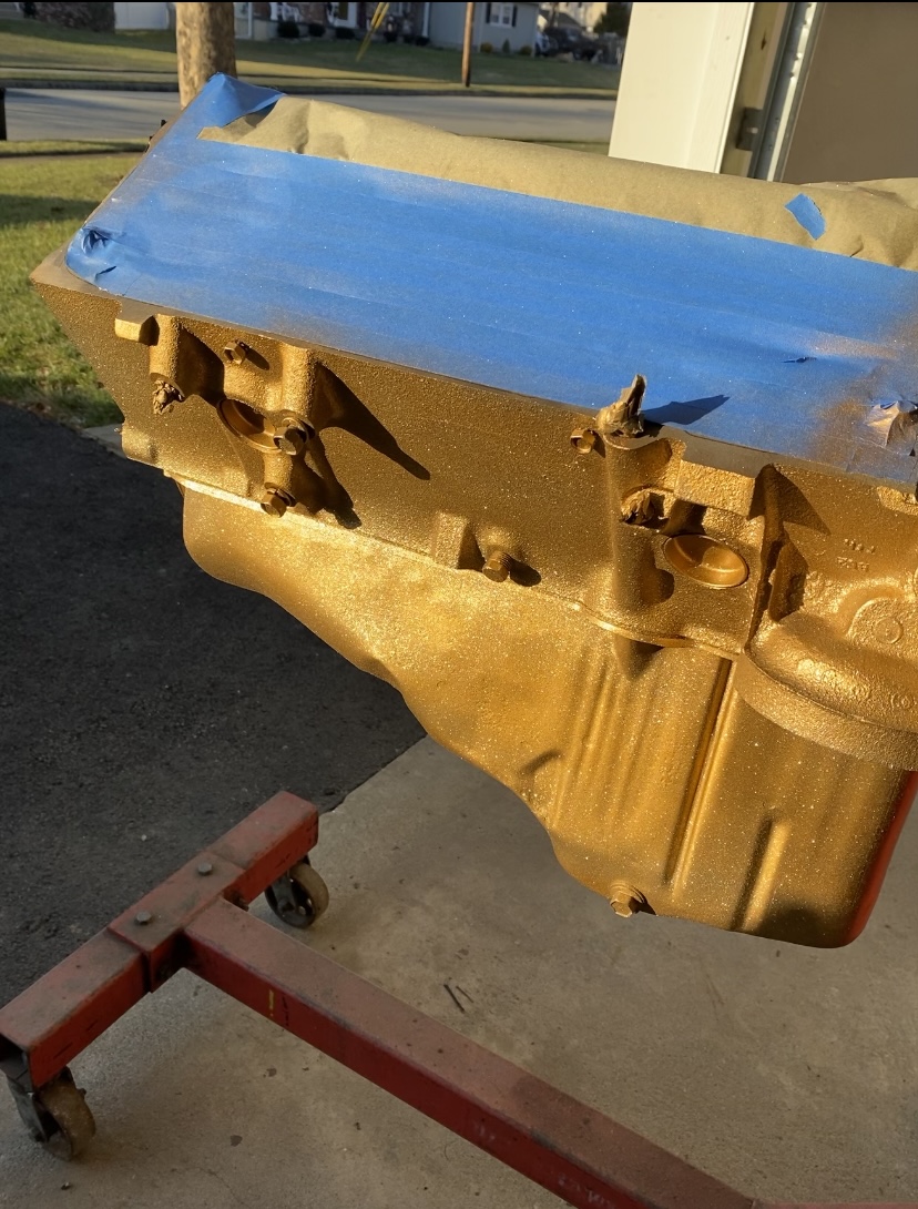

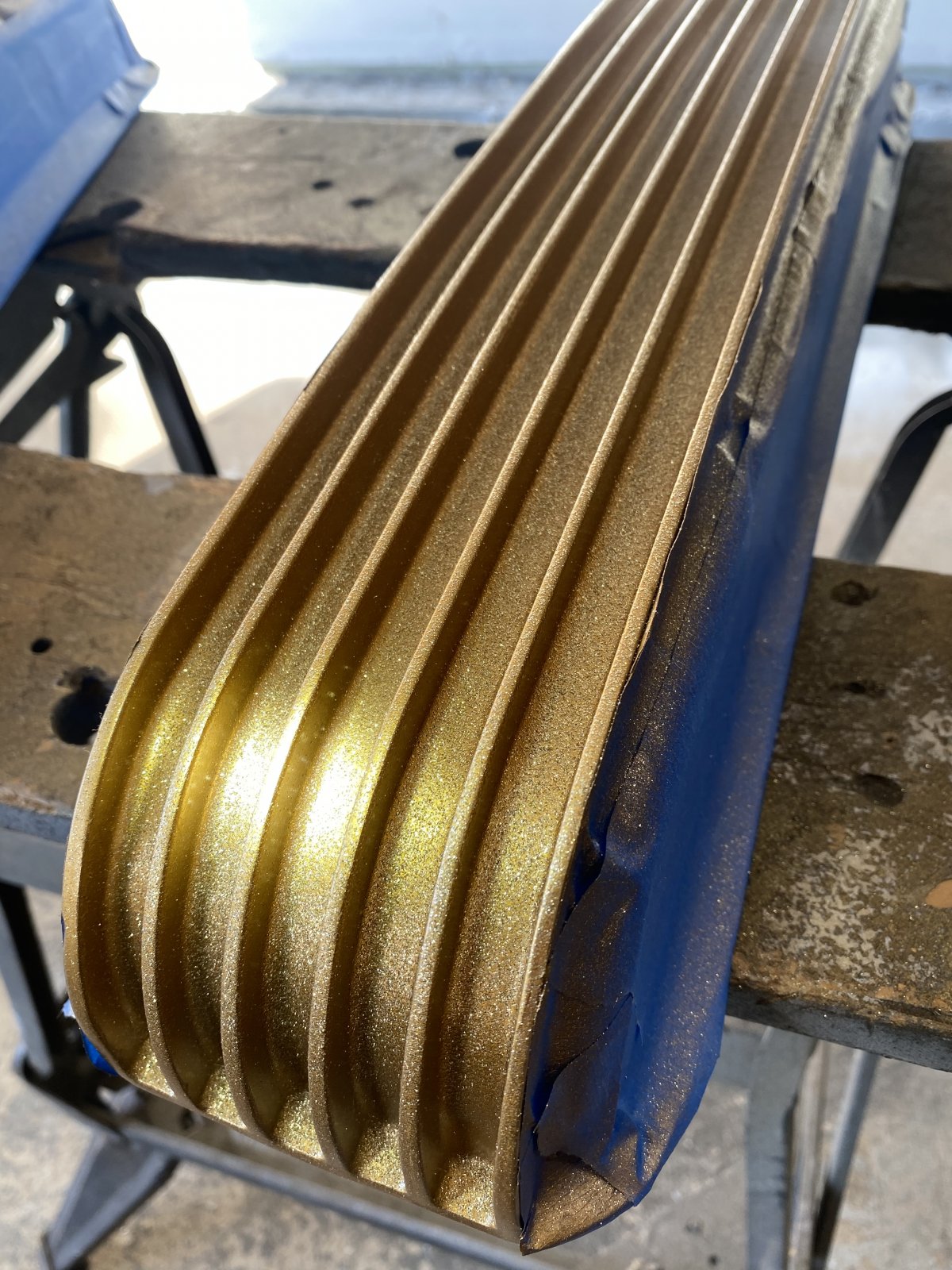

    Painted the short block and valve cover tops today. Gold flake it is! Little hard to get a good pic but the valve covers really show it off.

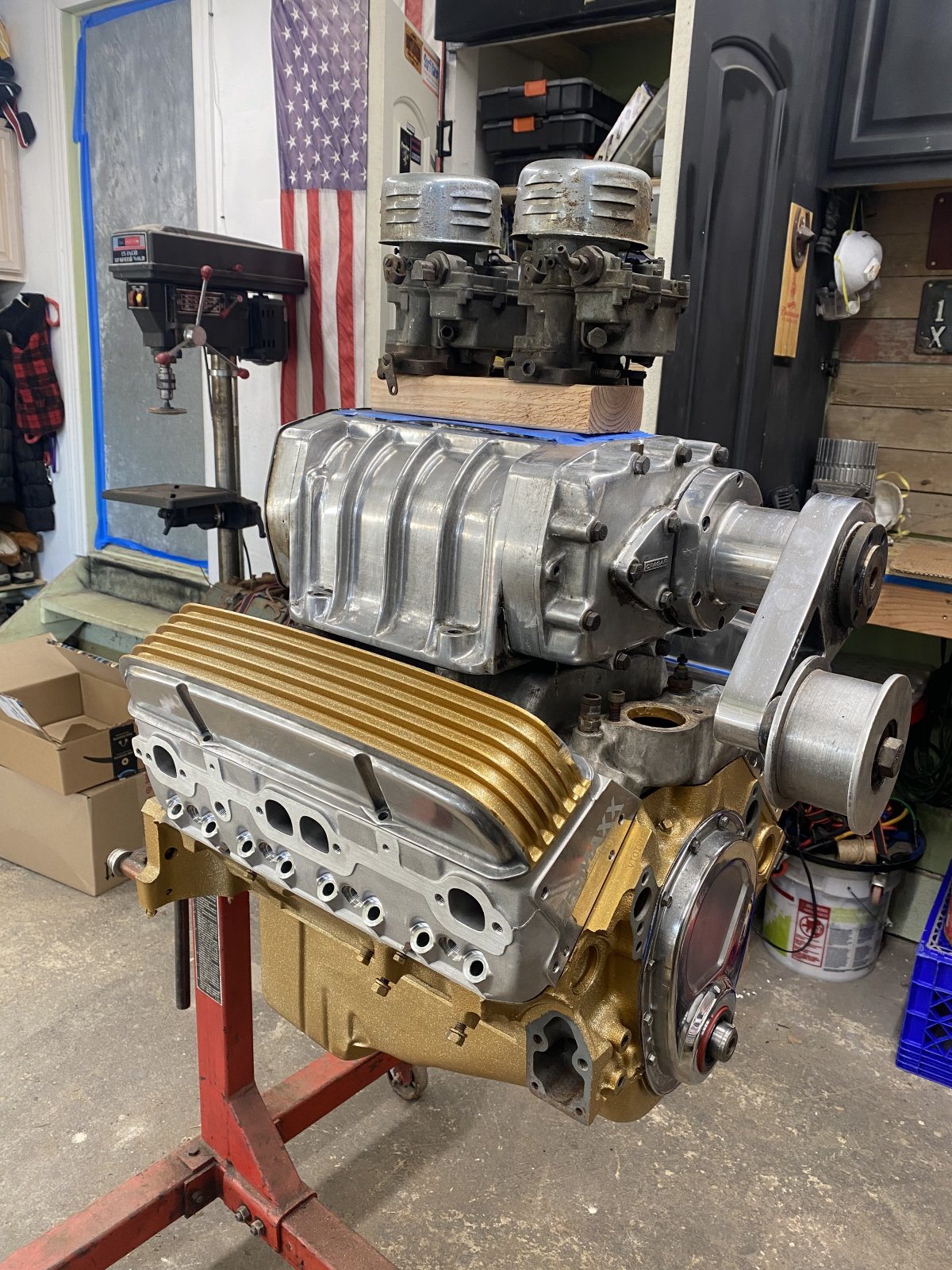

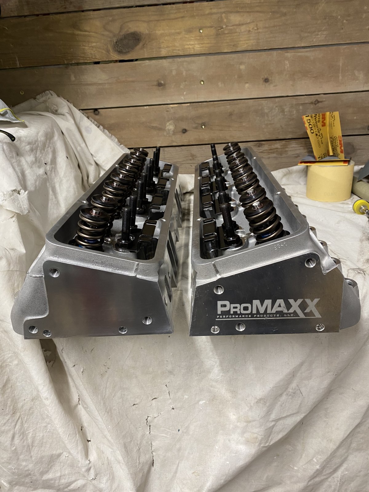

    Well I couldn’t help rough mocking it up after it dried and tearing off the tape. I also have a chrome water pump and pulley, finned fuel pump block off plate. Deciding between Rochesters or strombergs before I buy a top plate but you get the idea. Was debating painting the aluminum heads gold but I’m liking it. The meticulous side of me wants to remove the ‘promaxx’ engraving from the heads.

    Yea I've thought about it a lot. It's lightly engraved, any suggestions how to remove it? I've been thinking of just hitting it with some sandpaper but once you start I have to finish. They are very nice so it kind of pains me to start messing with.

    Belt sander and a careful touch...

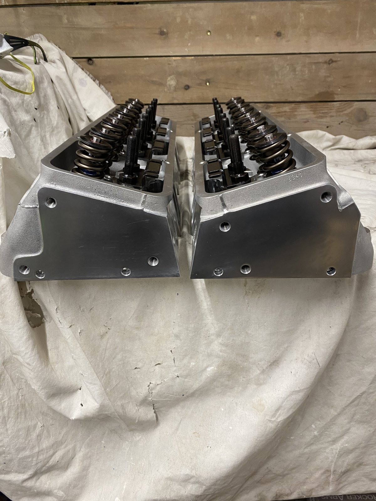

  27. Barbarian
    Joined: May 5, 2019
    Posts: 573
    Barbarian
    from New Jersey

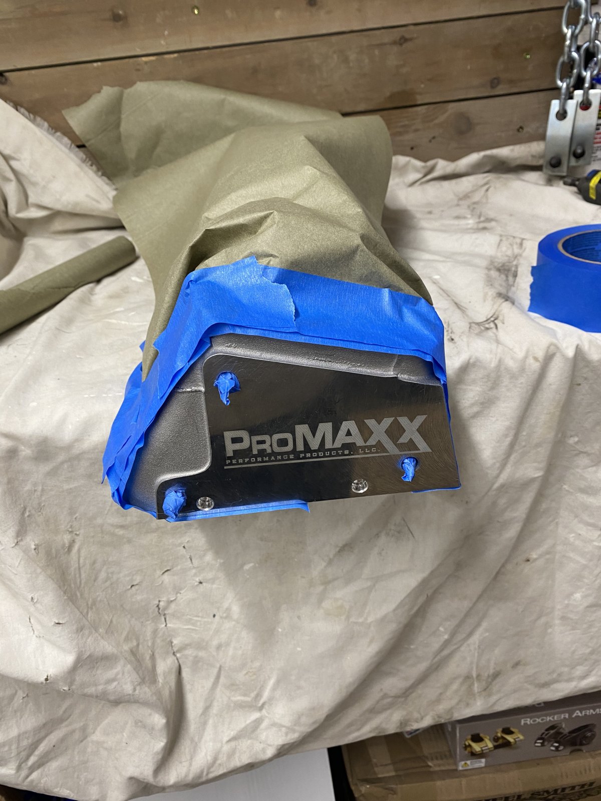

    One more little detail thats been bugging me off the list. Came off super easy, 240 grit removed the text. Then sanded all the way up to 2000, polished and done. One on the left isn’t scratched, some leftover polish compound I guess I missed until I looked at the pic.
    E7B0C390-AF8A-464F-B2B7-9FD1EAB27044.jpeg F4AB7483-3AB8-4F46-9BD1-E458B7241C33.jpeg C8E78ABB-D152-41A8-9E9F-D434E9974986.jpeg
    mad mikey, Just Gary, Chucky and 6 others like this.
