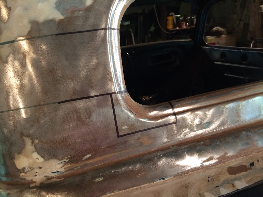

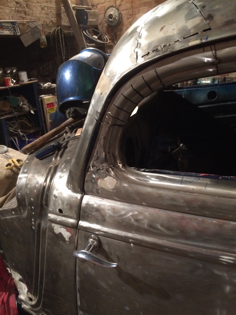

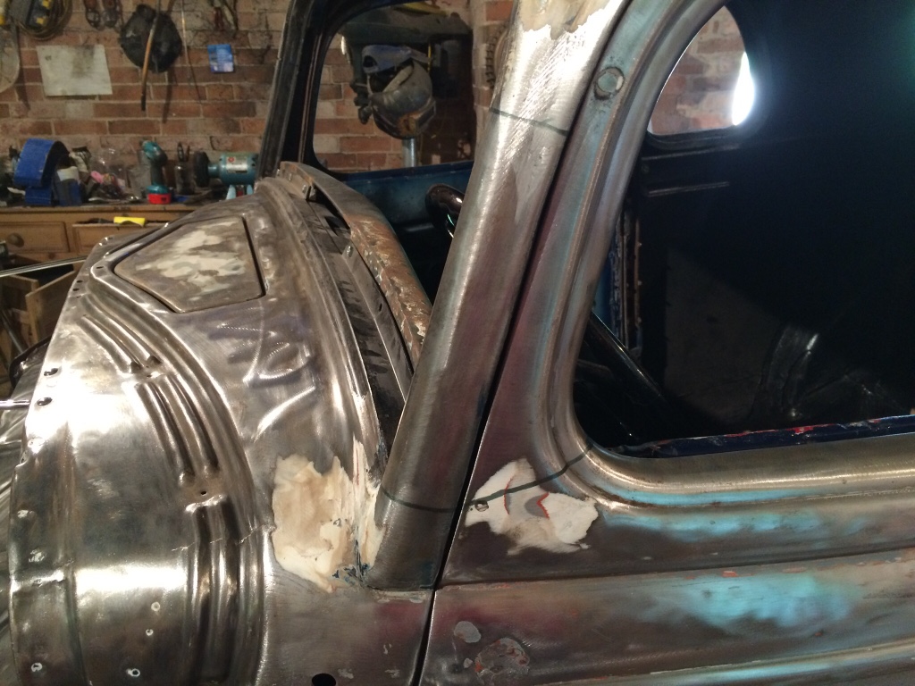

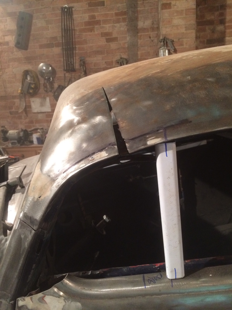

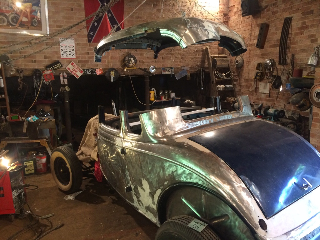

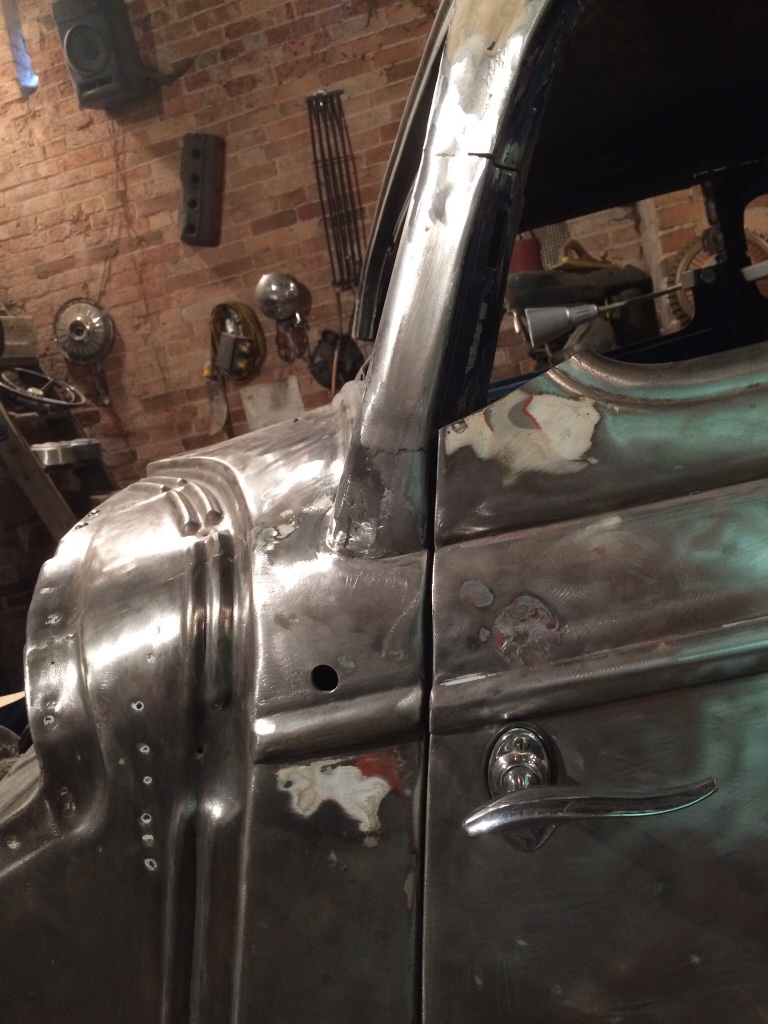

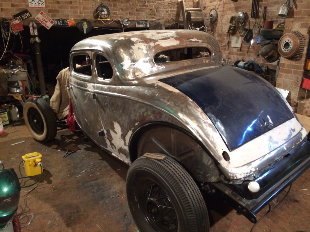

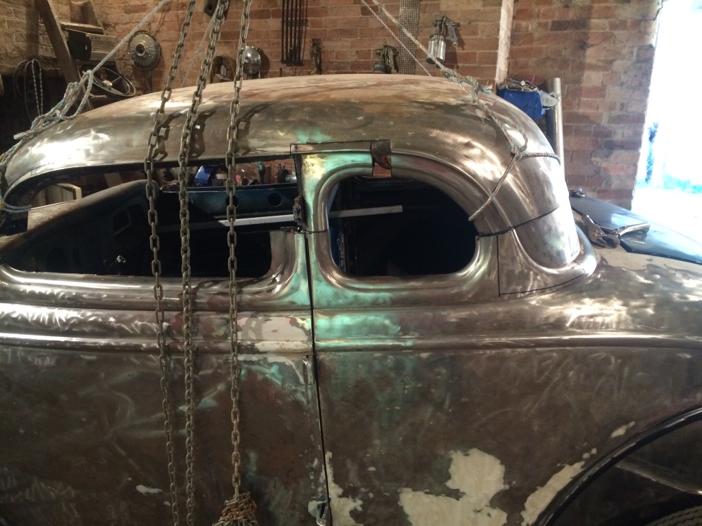

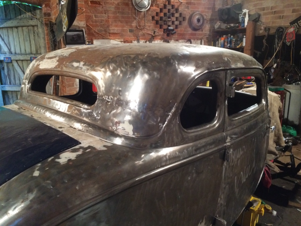

    Here's how I chopped a five window 34 hope it helps , feel free to ask questions ImageUploadedByH.A.M.B.1478982087.115592.jpg ImageUploadedByH.A.M.B.1478982105.650201.jpg ImageUploadedByH.A.M.B.1478982156.832603.jpg ImageUploadedByH.A.M.B.1478982174.638580.jpg ImageUploadedByH.A.M.B.1478982204.828522.jpg ImageUploadedByH.A.M.B.1478982222.745520.jpg ImageUploadedByH.A.M.B.1478982239.913177.jpg ImageUploadedByH.A.M.B.1478982258.028492.jpg ImageUploadedByH.A.M.B.1478982297.344298.jpg ImageUploadedByH.A.M.B.1478982331.101639.jpg

    Back in 1975 I chopped a 34 3W the same way you did. By cutting the A pillar at the base and leaning it back as apposed to cutting across the cowl and laying the whole windshield back. I had a problem with the W/S frame sealing across the bottom due to the change in angles. Do you see any issues there? I did cut mine 4 1/2 inches so you may not have the same problem.
  20. Besty34
    Joined: Sep 9, 2010
    Posts: 413
    Besty34
    I cut my sedan by 4 1/8" , I also dog legged the A post and don't have any issues with water or noise, my only regret was that I didn't put the piece in the base to hide the dog leg like I did with this one .

    Getting ready to do mine next month. When you cut the 4 inches did you cut the b and c posts the same amount so the a is what it is. I always thought the 5 window needed a 1/4 inch wedge to make the door look right. Thanks for the great pics
  26. rpm56
    Joined: Nov 29, 2013
    Posts: 99
    rpm56
    34's look so cool with a nice chop, yours included.
  27. Besty34
    Joined: Sep 9, 2010
    Posts: 413
    Besty34
    No I cut it straight across , I know what you mean it takes some of the taper out of the door window .
  28. 3030
    Joined: Dec 21, 2010
    Posts: 206
    3030
    By putting the a post on an angle does the trick then it looks awesome
