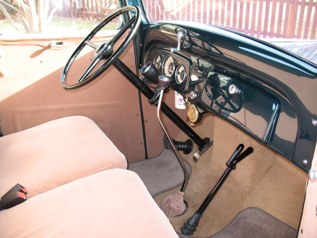

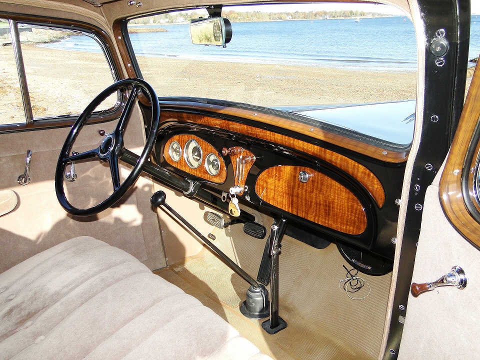

  18. here is my 33 chevy with oe dash. pull hand brake from a 50's chevy anchored to the floor and dash. DSCF4163.JPG
