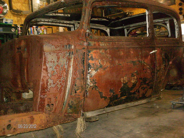

    bonzo-1

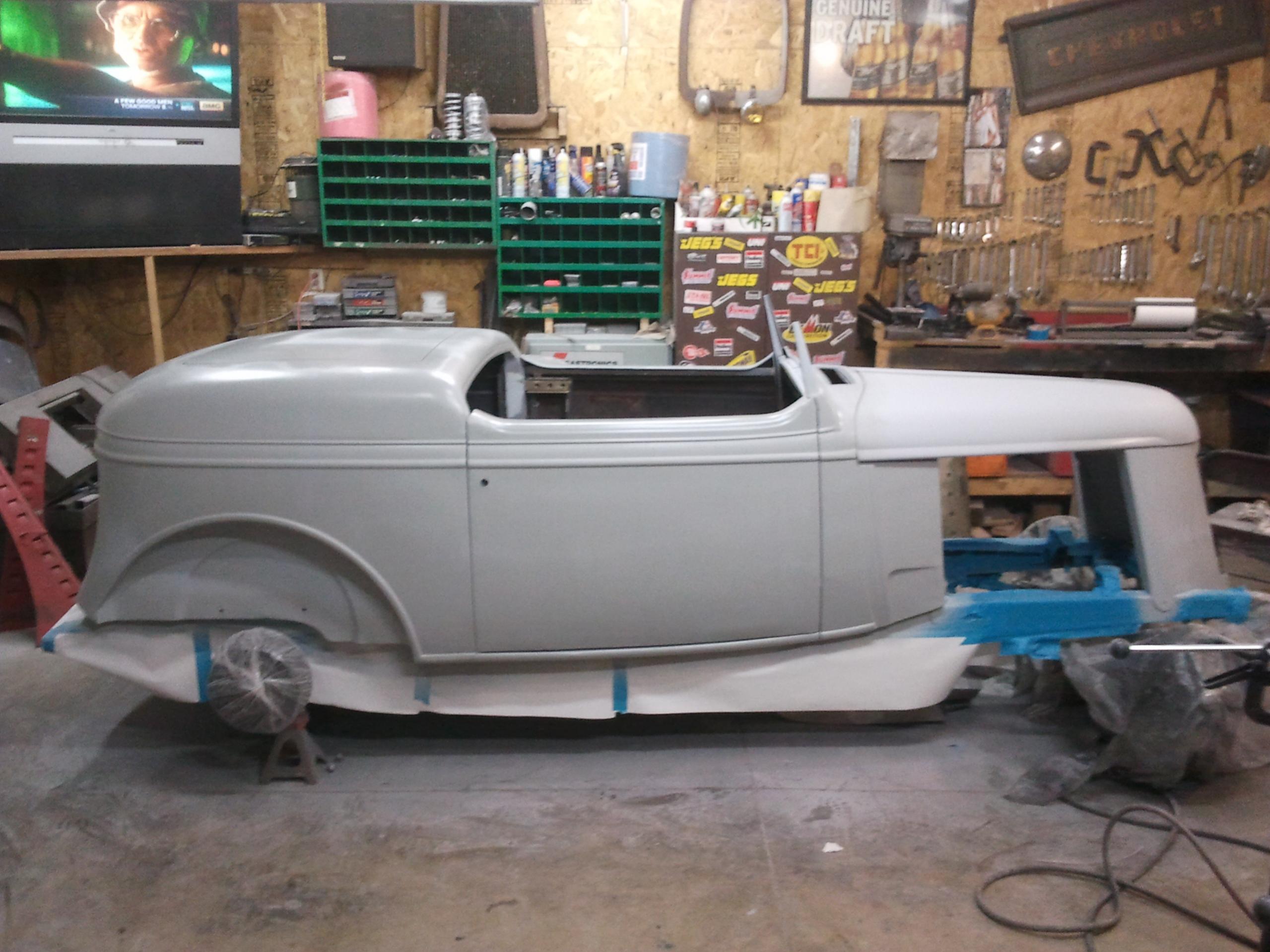

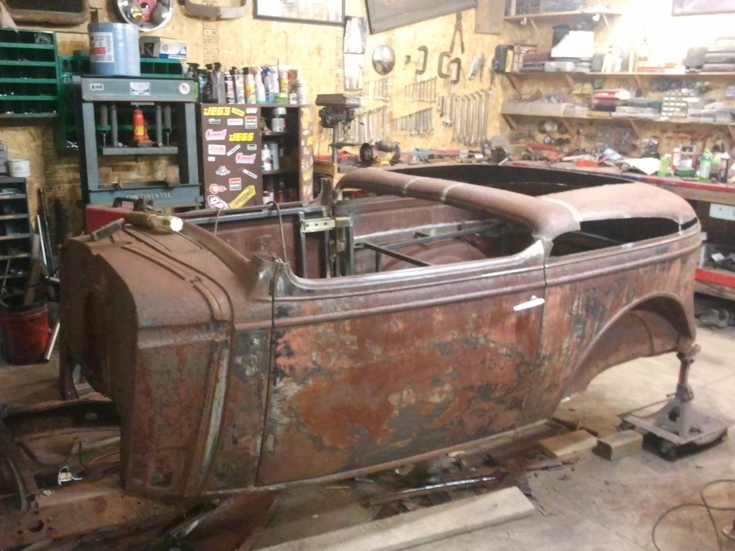

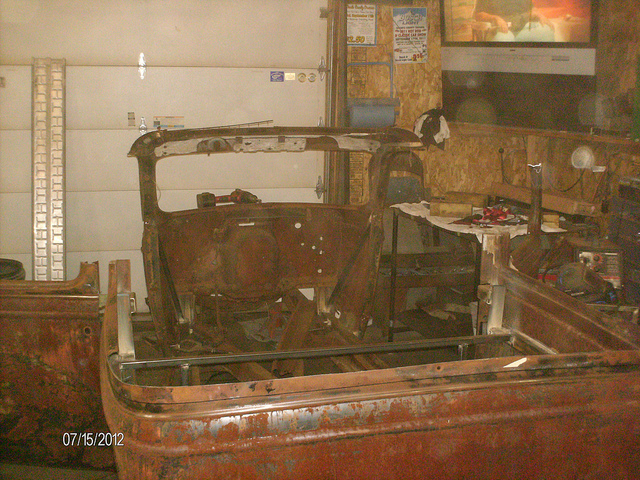

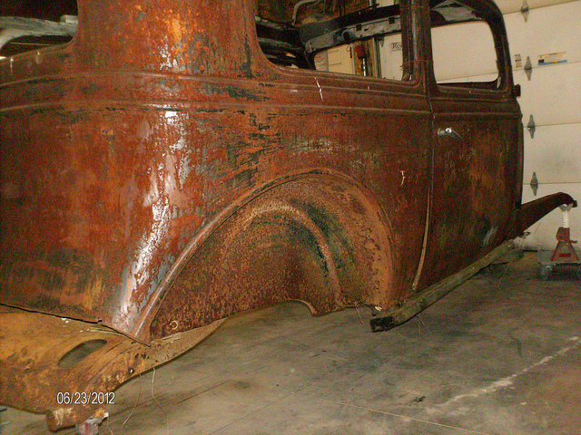

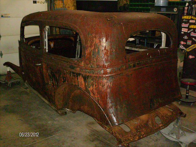

    Starting a thread on my 34 chev sedan build. Well it started as a sedan but going to finish as a roadster. I dont have the hood, fenders or grill shell I only have the body and frame. I dont feel too bad on cutting it up as i already have a 35 standard sedan.
    Starting pics:

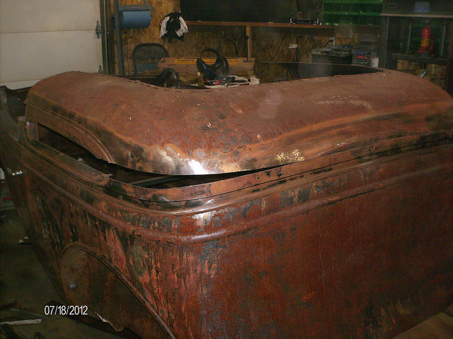

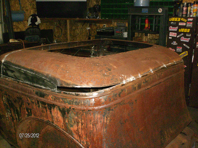

    Pic of top and no top.

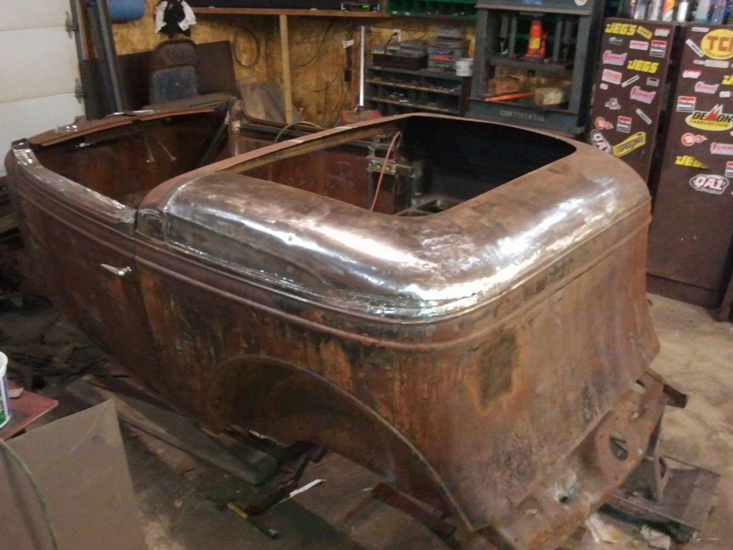

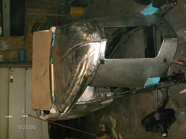

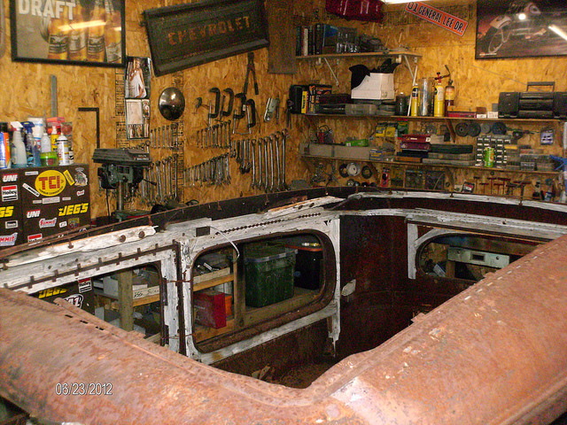

    After cutting to top off I removed the roof sections and assembled them to be the new top of the body.

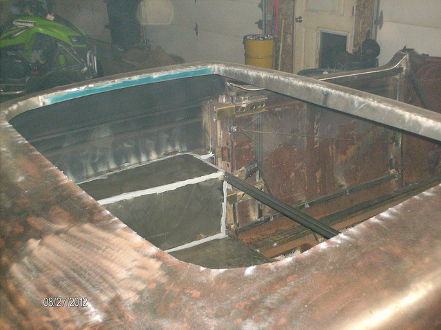

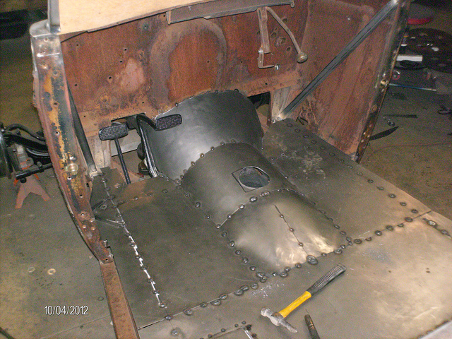

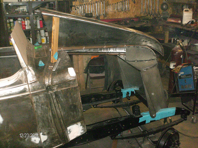

    Pics of the flange around the trunk opening and building the new floor. The body is 2 inches lower on the frame than stock.
    Rear floor is finished and sealed next is the front floor.

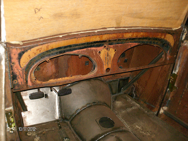

    bonzo-1
    Getting the floor finished up and fitting the dash panel

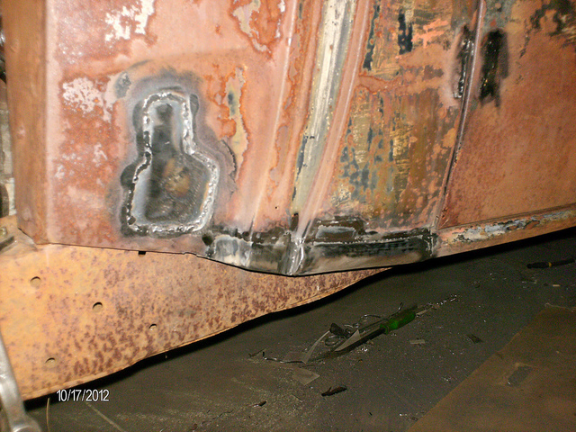

    bonzo-1

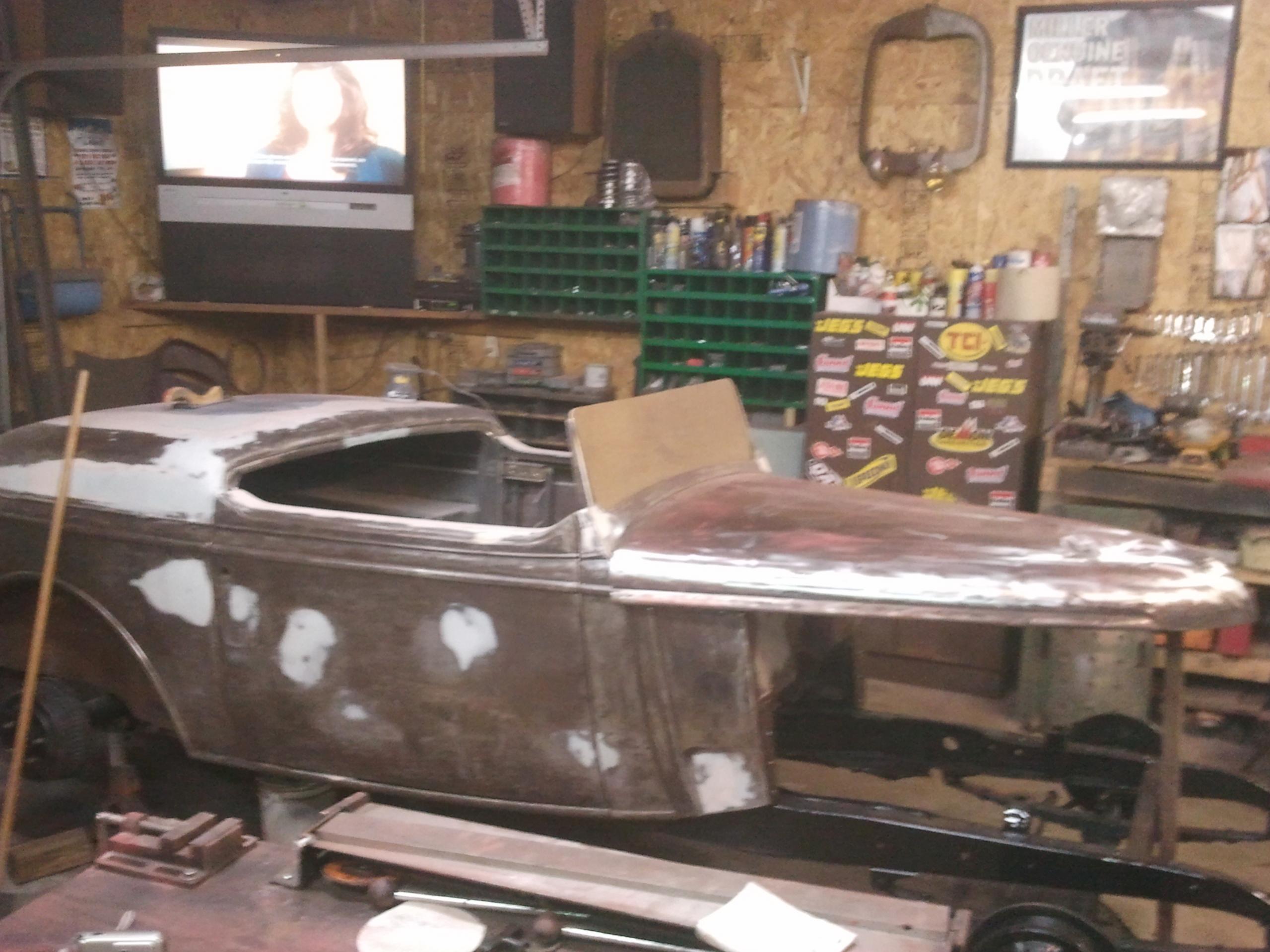

    Filling in the hood side latch holes and some rocker panel repair

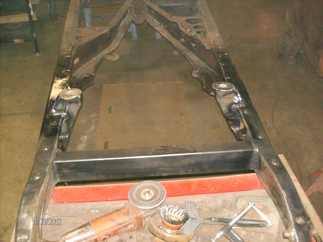

    Boxing frame and front motor mounts.

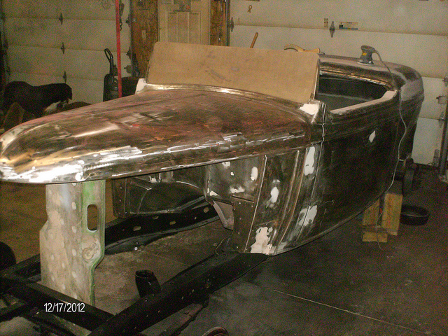

  13. bonzo-1
    Joined: Oct 13, 2010
    Posts: 328
    bonzo-1

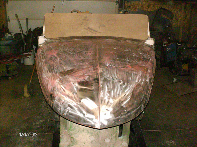

    Building the grill shroud. The hood butterflies like the original but with no hood sides.

  15. bonzo-1
    Posts: 328
    bonzo-1
    Grill fitted to grill shell The grill is made out of chrome tube from a tube grill I had from a 1980 shortbox scottsdale.

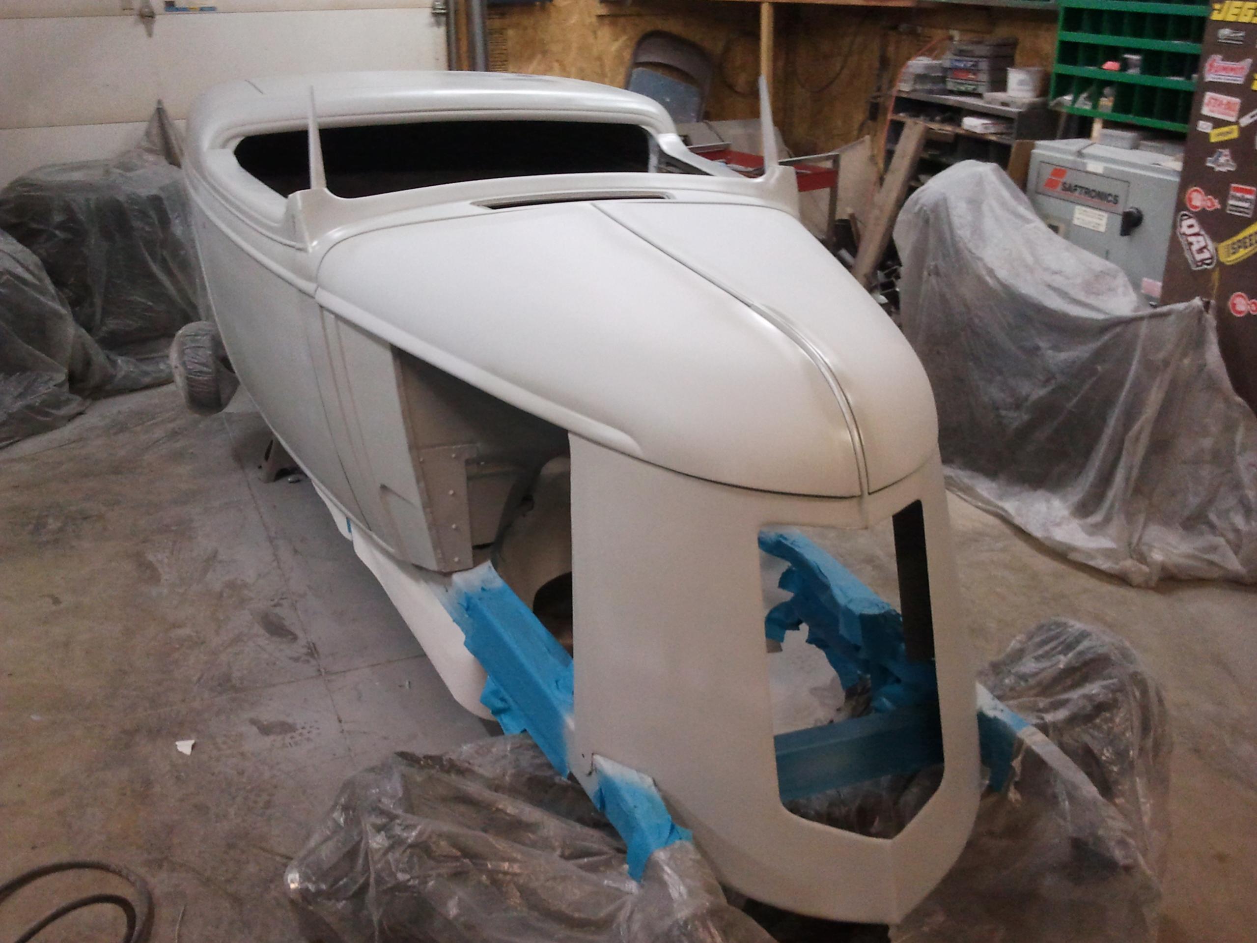

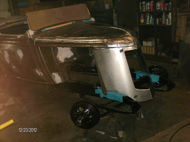

  16. bonzo-1
    Posts: 328

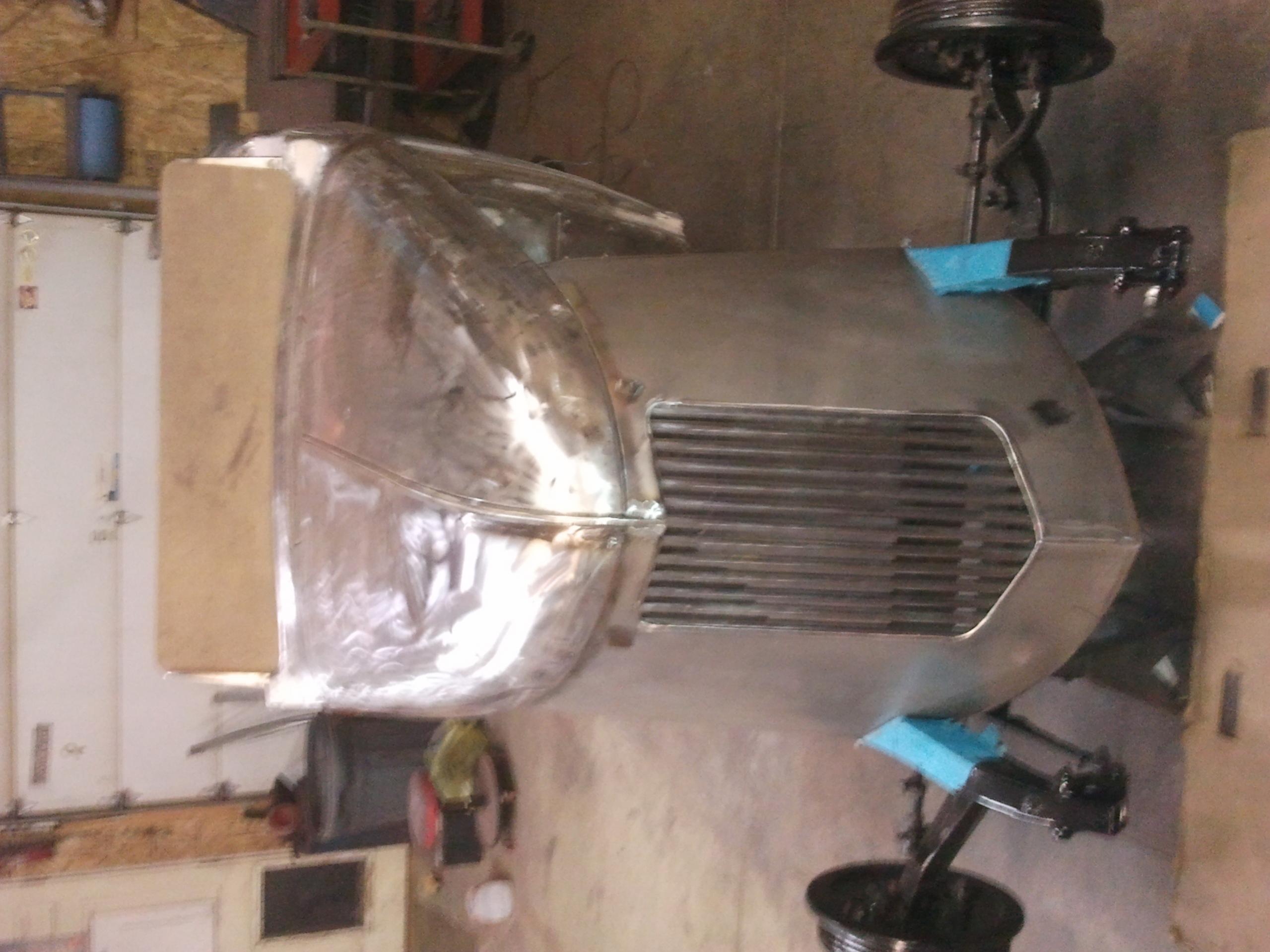

    bonzo-1

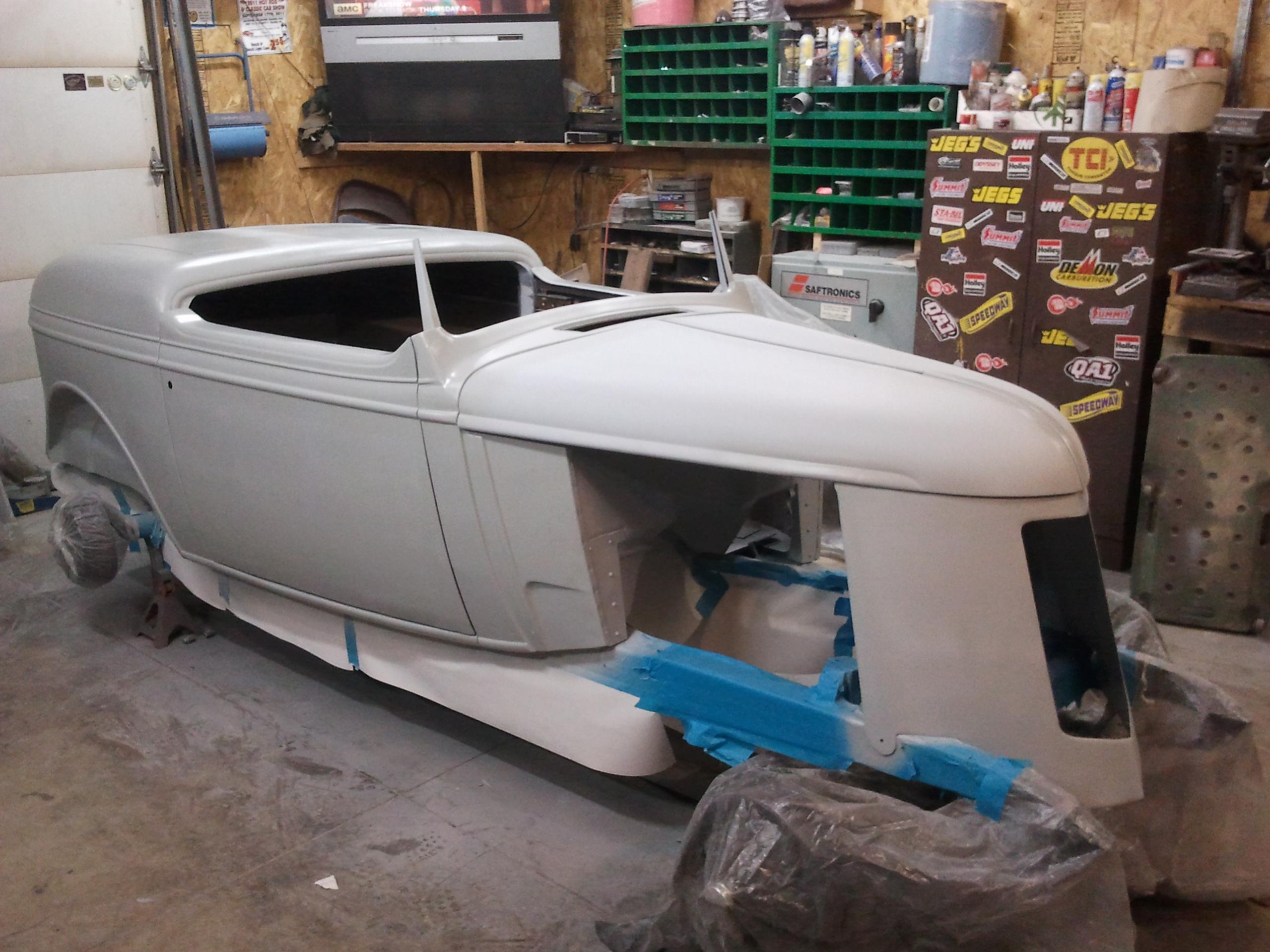

    Bent and plug welded a piece on the back of the grill shell to fill in next to the radiator on each side. Dollied all the edges to give them a rolled edge.
    Finally primer!
  17. bonzo-1
    Posts: 328

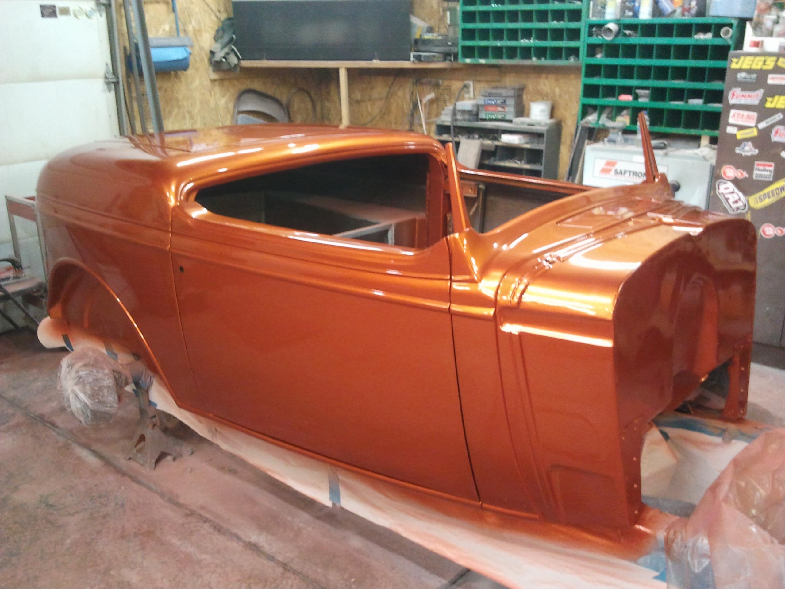

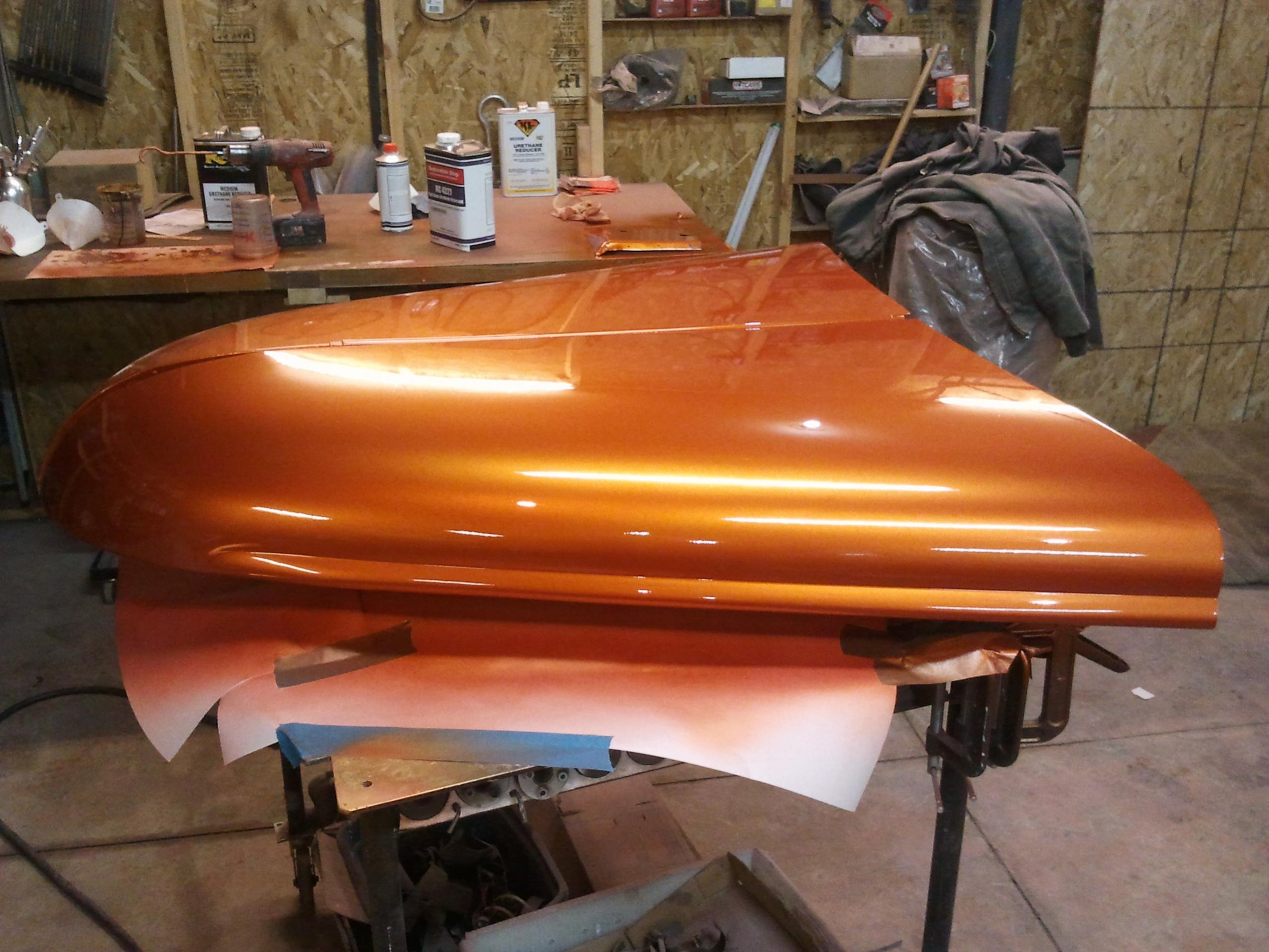

    Getting some paint!
    Ghost flame layout.

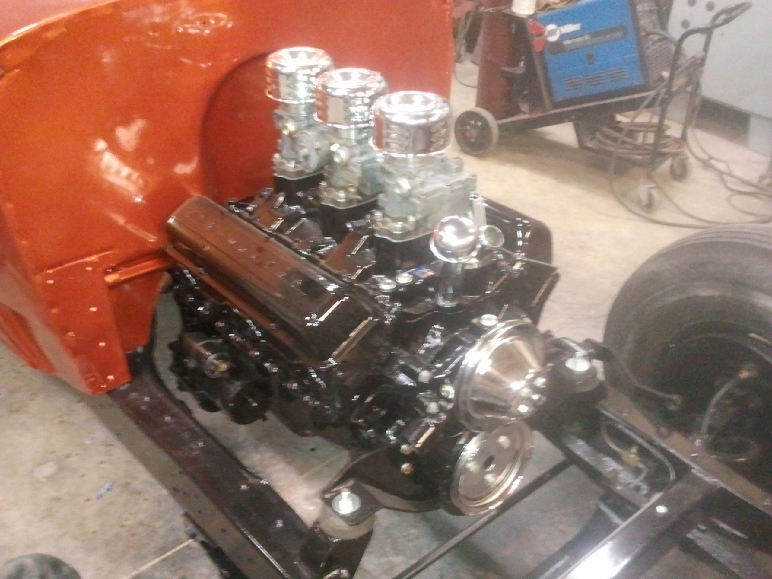

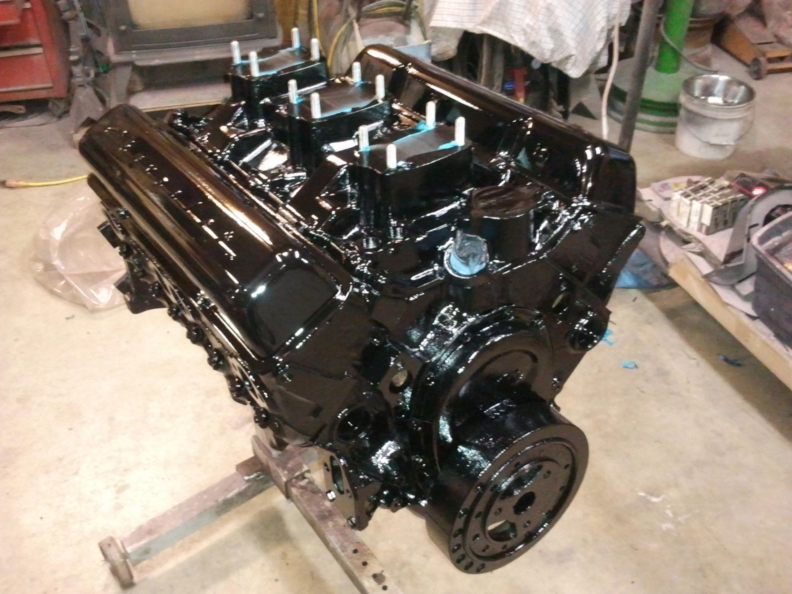

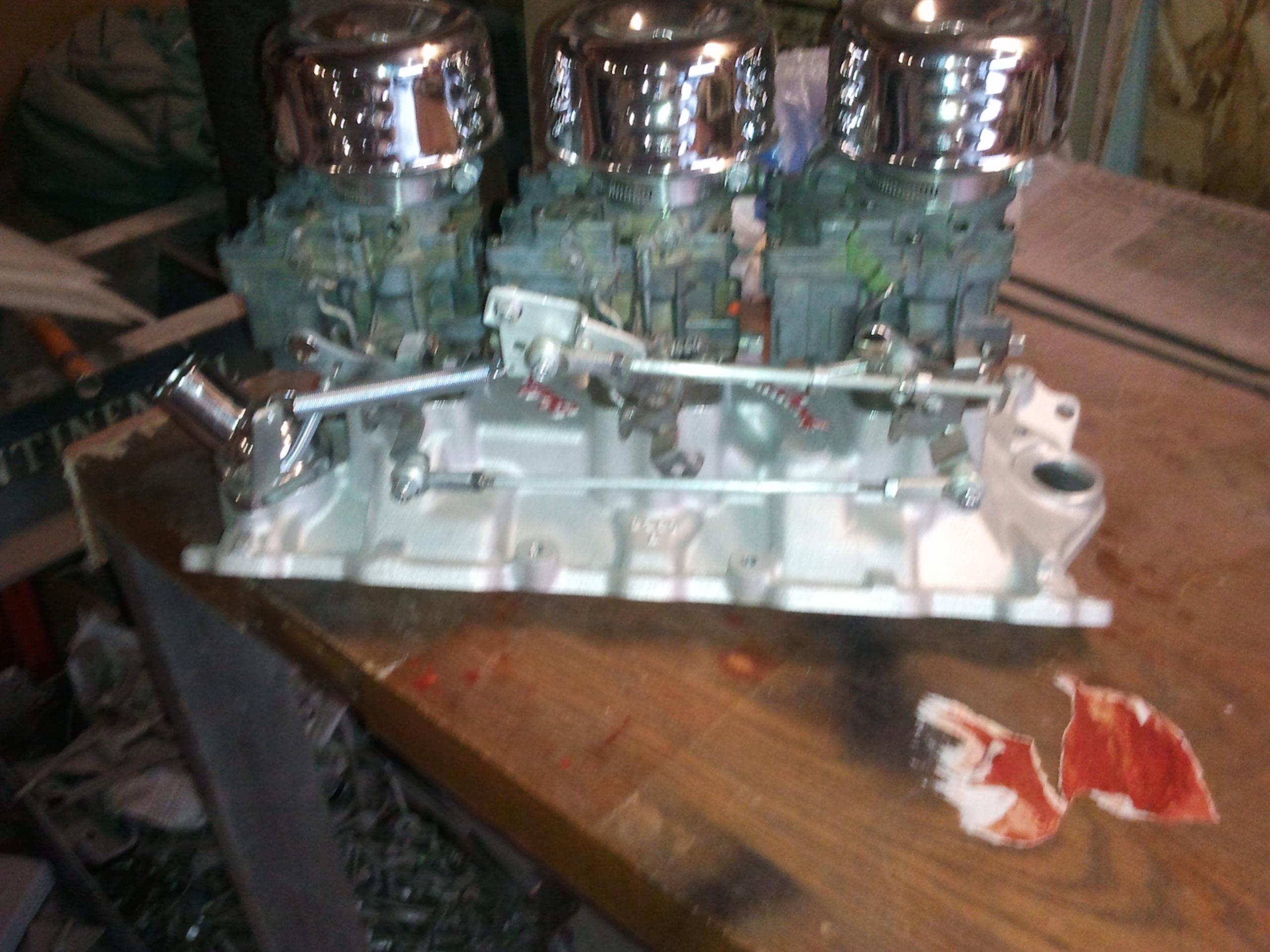

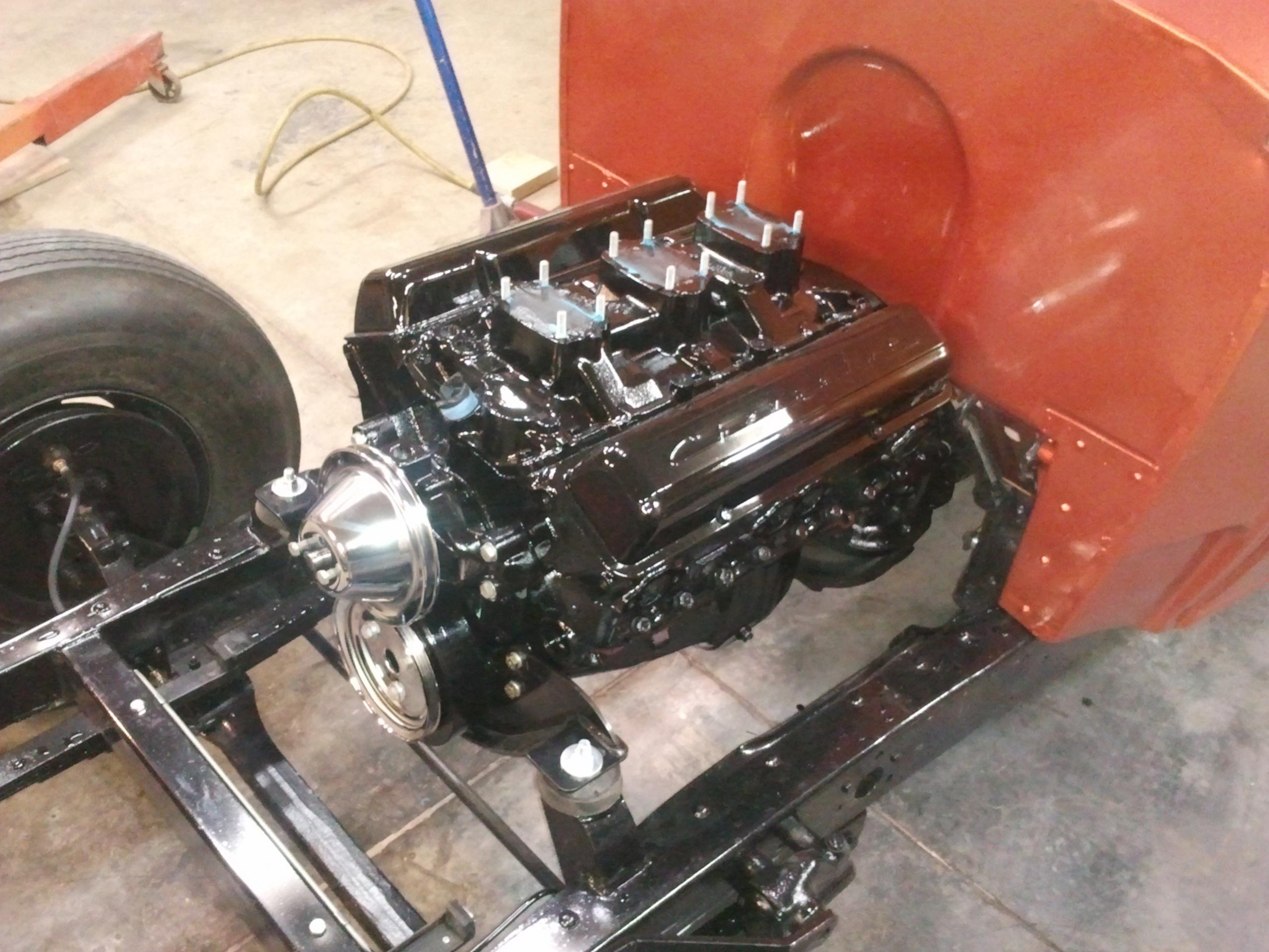

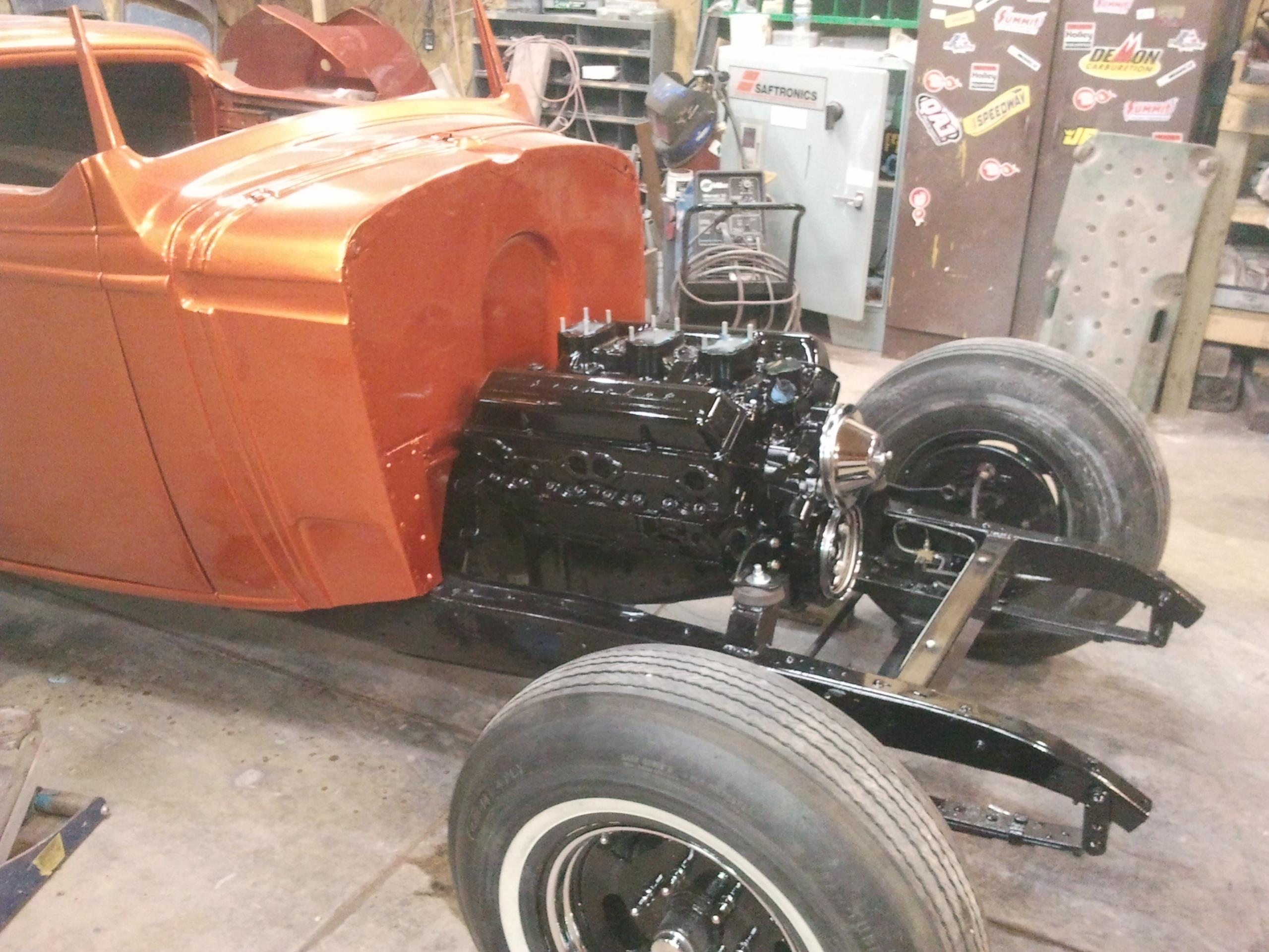

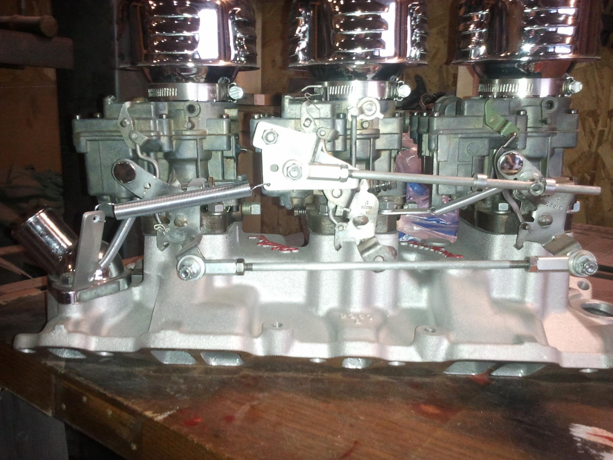

    Picked up a tri power setup at Jefferson
    Had to take a pic so I can reassemble the linkage after painting.
    Painted and cleared motor.
    New flywheel, clutch and pressure plate.
    Mounted five speed nv3500 and set it in.

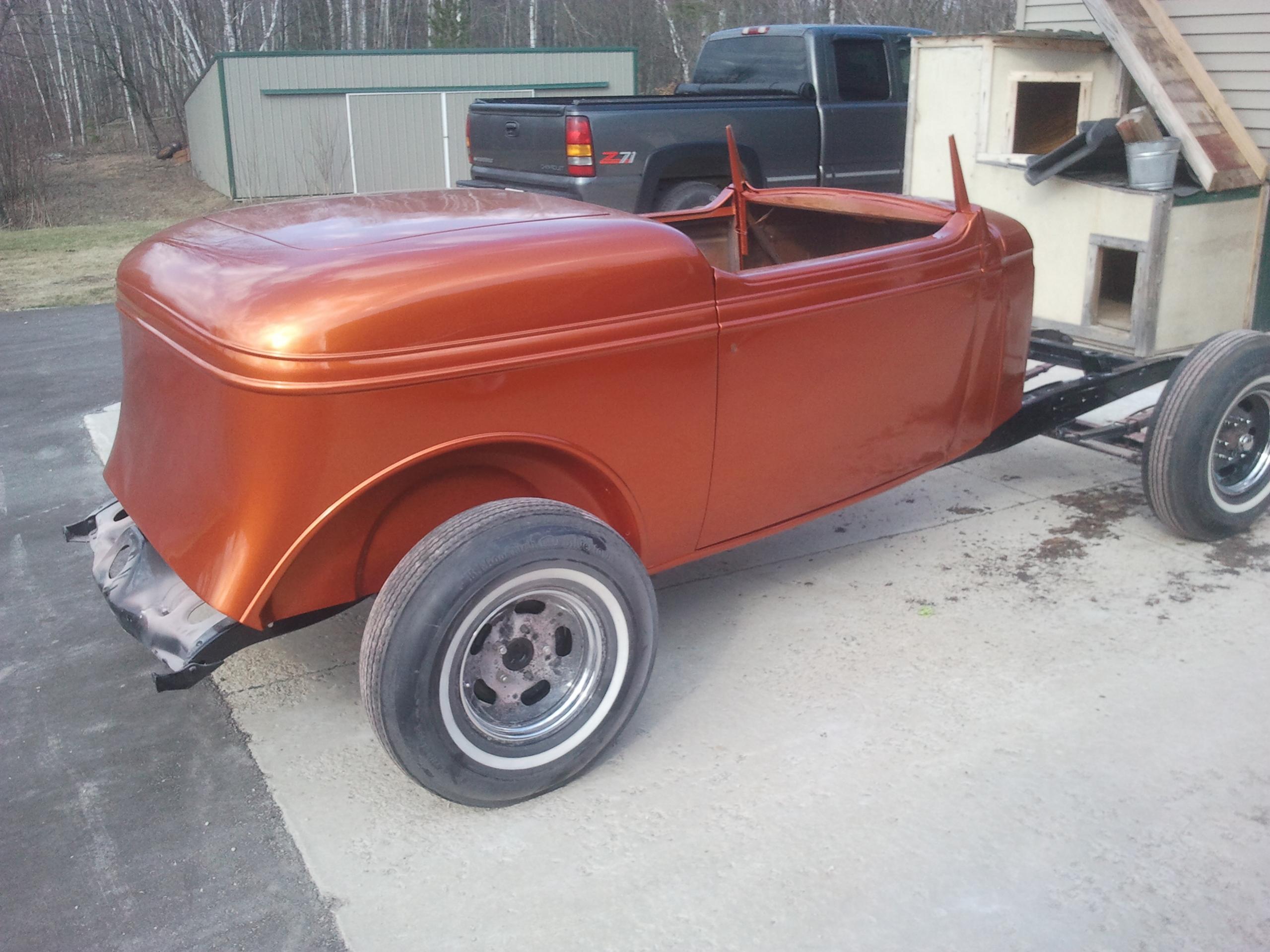

    I am going to run the ones that are on it for now, they are BF goodrich silvertowns.
    I have two different wheel patterns 5 on 5 in the rear and 6 lug fronts. I redrilled and welded up the old patterns on these steel slots to match what I need. The bad part is they are 14s. So tires are very limited. I have found a 27.5 inch tall pie crusts but the $500/pair is hard to get over.

    Carbs rebuilt and mounted, also brake lines installed.

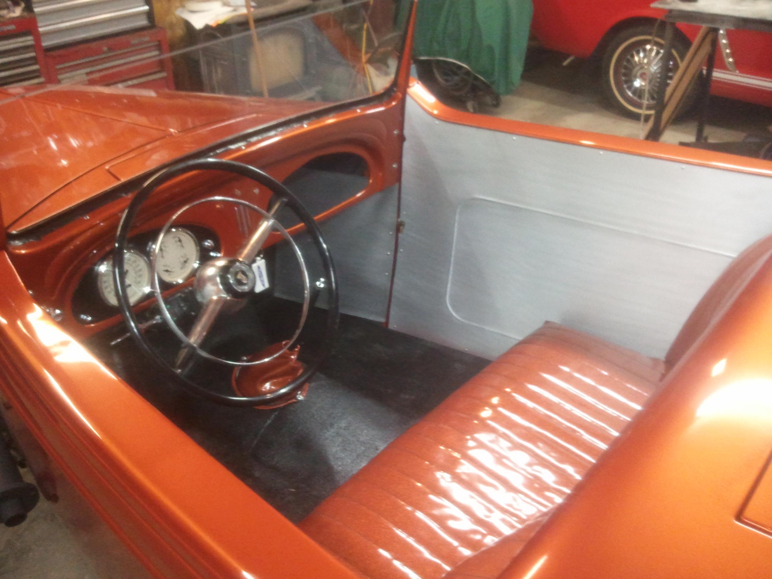

  30. bonzo-1
    Posts: 328

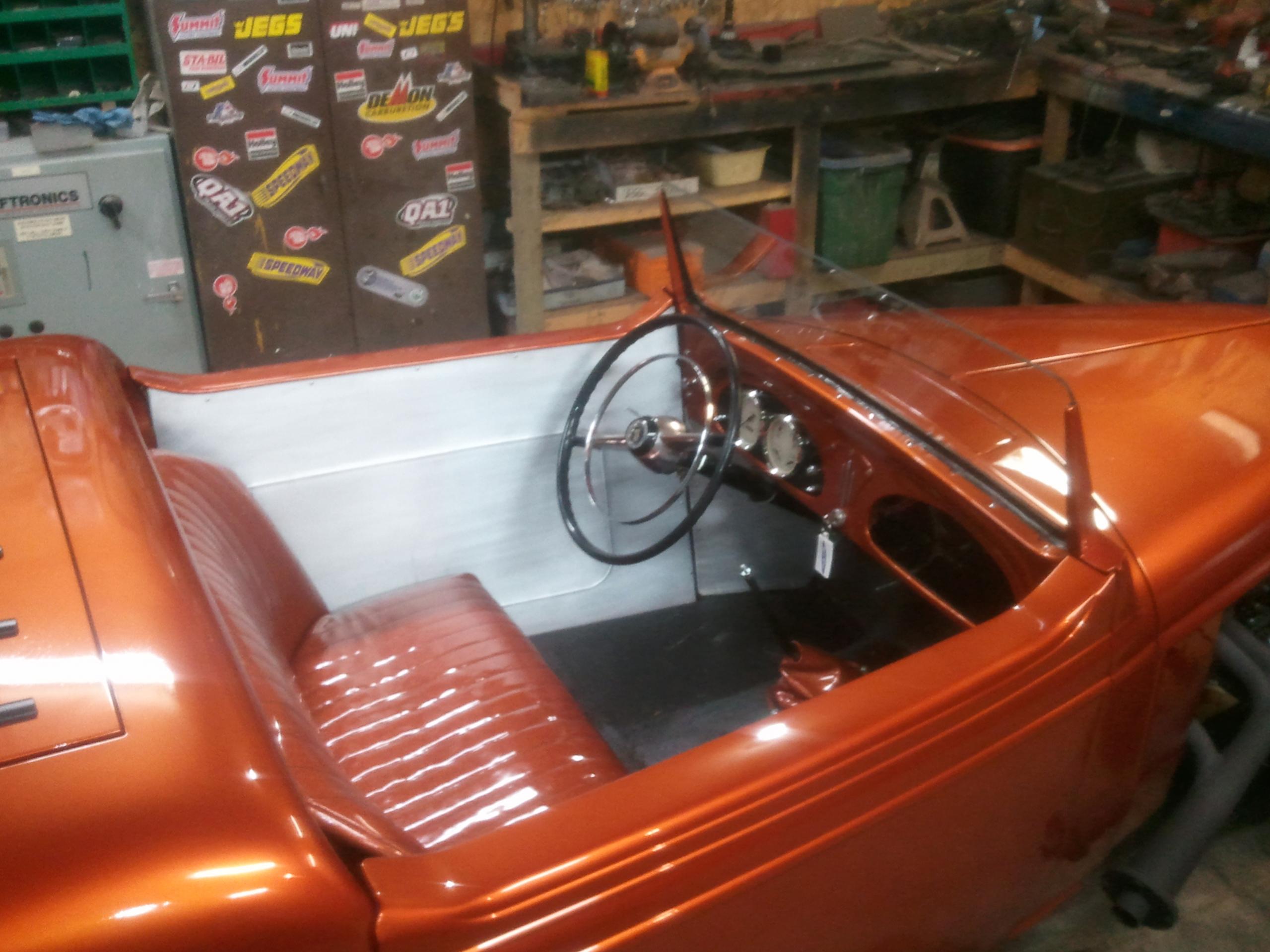

    bonzo-1
    A few odds and ends to do this week to make the shakedown.
    Built my seat. Spent a few nights with the sewing machine.
    Shift boot done.
    Seat belts in.
    Aluminum door and kick panels done.
    Here is some pics from my cell. I will have to take some nice ones outside with a real camera.
