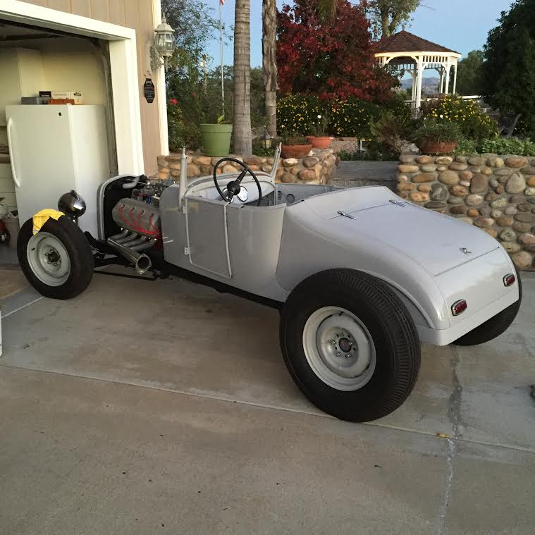

    I have a 1954 331 hemi that was given to me by my very generous uncle, along with a 1927 roadster, all original Henry Ford steel.
    The motor was completely rebuilt by a reputable machine shop, then sat for a couple years before I completed the car. First fire up, primed the oiling system, set the ignition timing as close as possible, and it started up and ran beautifully. Shortly after, the body came off for paint and when I put everything back together I have been chasing problems ever since. Ive rebuilt the entire engine by now and had a machine shop go over the heads and do a regrind and had valve guides done. So theres no issues there
    So this brings me to last night. Pulled a plug and noticed there was a little bit of oil on top of the pistons, it wasn't soaked, but there were multiple wet/partially wet drops of oil. Pulled the valve covers off and looked into each plug hole and noticed the same thing, oil was getting on top of the pistons from somewhere. I noticed a spark plug tube that seemed like it had been stretched out where the plug seats. Come to find out that when the tubes were seated in the Hot Heads valve covers, they were still a half inch away from seating in the head. So there was a poor seal there, plus my 3/4 reach plugs were nowhere near being in correct proximity in the combustion process. Im guessing this is why I was getting weird readings on plugs and it just didn't sound right to my ears.
    I had been getting the 426 tubes from Bob at hot heads, which were supposed to be the correct tubes for their valve covers on my engine, which obviously they weren't. After some research, the tubes for my engine compared to the 426 tubes were about a 1/2" difference. Nothing against Bob or hot heads, I've done lots of business there and am a happy customer, its my fault for not doing the research on my end and communicating that to him.
    So Im just looking for some piece of mind that the tubes are the cause of the oil, and the fact that my plugs were nowhere near seated against the head?
    p.s. I did a compression test with engine cold, before I knew my plugs were 1/2" from being seated and properly sealed, trying to rule out bad or worn rings. Compression was low, 100, but it was pretty consistent on all 8 cylinders. No sign of bad rings, no smoke and not burning oil, I just wanted a little piece of mind
      65.8 KB
      208

  3. By the way, cool little roadster.

    Ya I have seals at the valve cover, just wanted to see if this oil leak made sense to someone besides me, since there wasn't a seal at the plug tube/head.
    And thanks for the compliment

    I had thought of putting aluminum valve covers on the 392 in my '32, and I had heard of similar problems with tube length when using aftermarket valve covers.
    Thanks for confirming what I had heard, I guess I'll stick with the stock valve covers.
    By the way, that is one really sweet T, very nice build.
