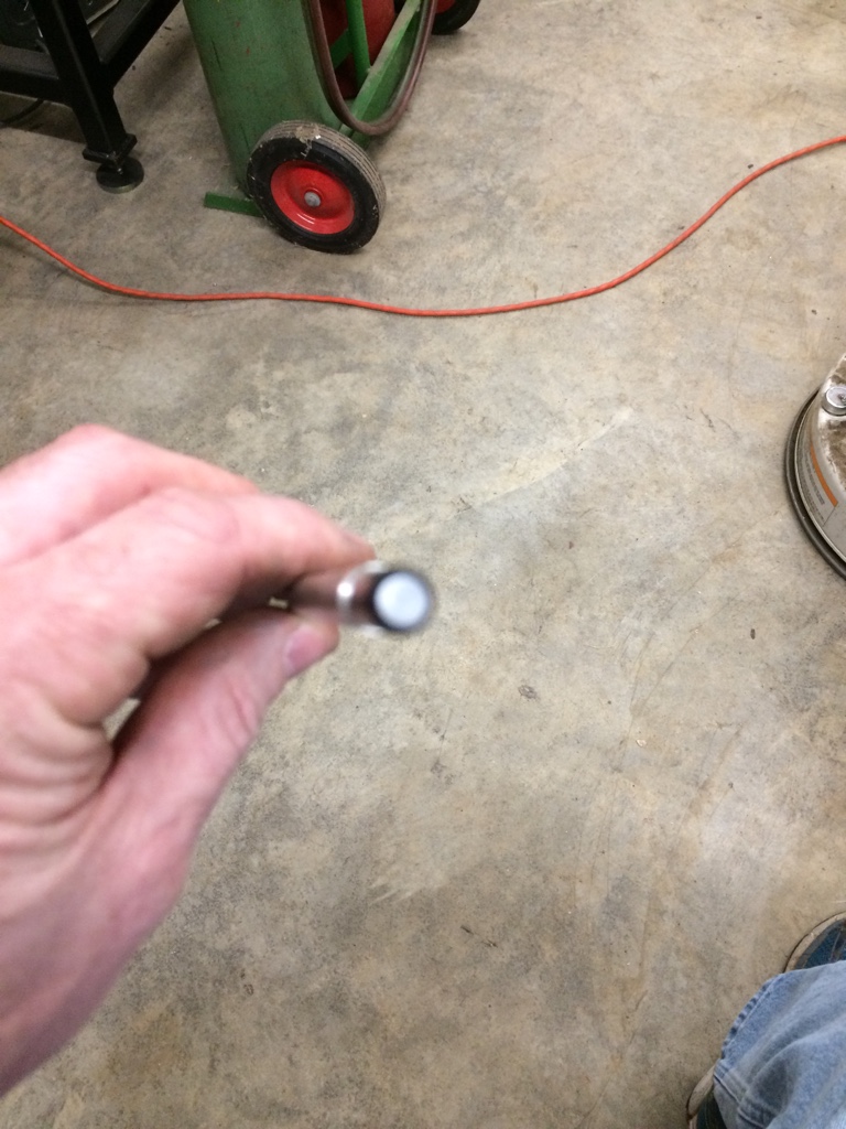

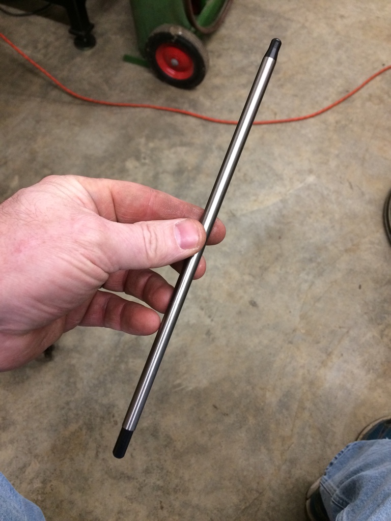

    I'm new to these engines, and have not disassembled or built any before. I've got the short block assembled, and am trying to get heads on, but have come across something I wanted to ask you guys here:
    '55 331 has hydraulic lifters, and I bought new set and dropped in block. I also ordered a set of Falcon pushrods for this year motor off eBay... I was in process of putting pushrods in, and noticed these don't have a hole in center of them... I'm just wanting to check and make sure I'm not screwing up, and gonna break something... here's a pic of pushrods:
    [​IMG][​IMG]
  2. RichFox
    Joined: Dec 3, 2006
    Posts: 9,761
    RichFox
    Don't believe the Cad oils through the pushrods. hence, no need for a hole.
    ls1yj likes this.
  3. Cad like the Olds feeds oil up thru the rocker stands then thru the rocker shafts to each rocker arm I believe.
    Clay Belt, ls1yj and clunker like this.
  4. Those are the correct pushrods for a Cad...
    Did you tear the rocker arm assemblies apart? If so, be damn sure you're got them back together correctly!

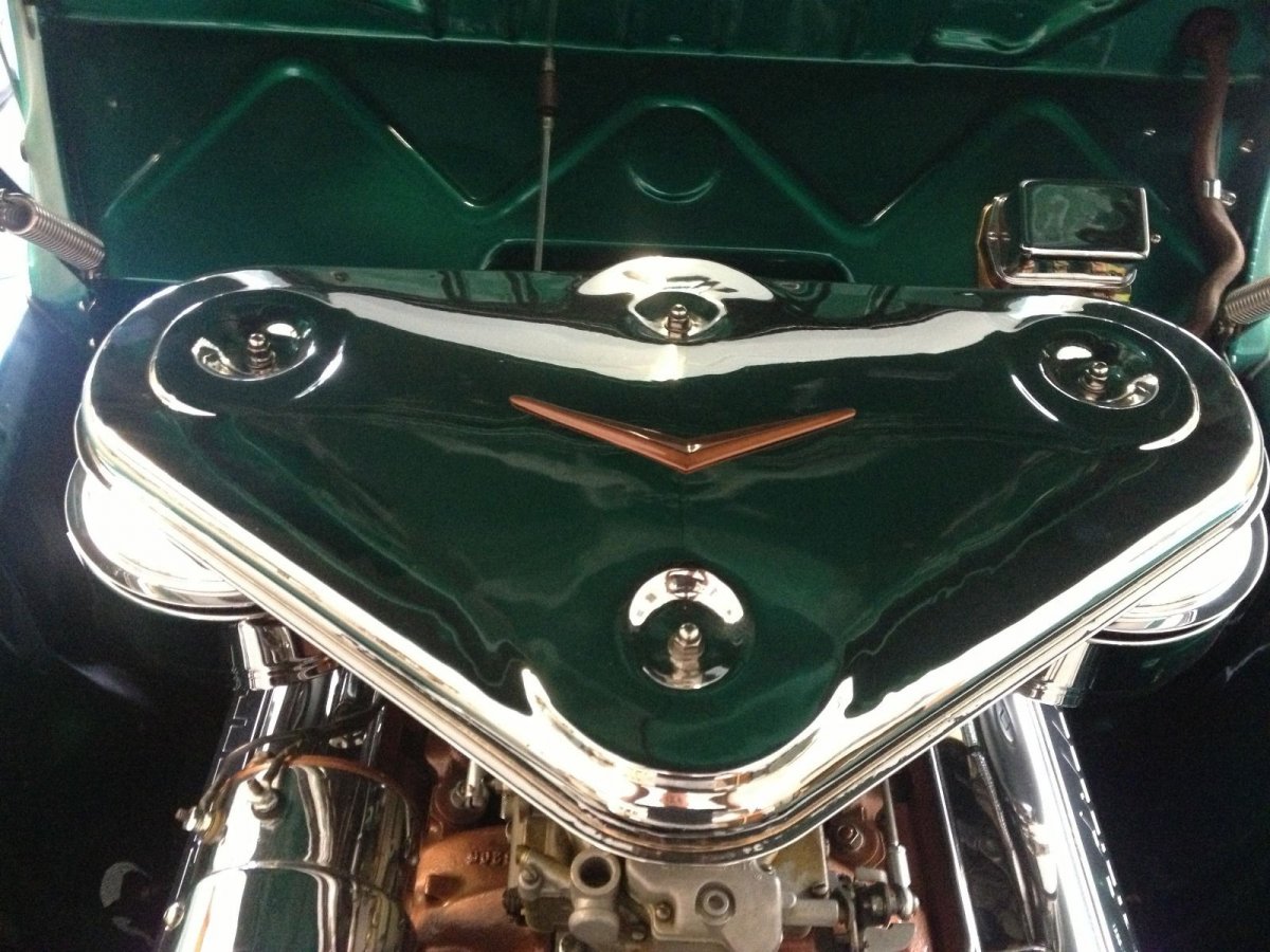

    I'm confused as to who posted the mill with the Eldo dual quads and the polished batwing air cleaner, but that whole set up rocks, well done. (Blown35?)
    ls1yj and cretin like this.
  18. Blown35
    Joined: May 20, 2008
    Posts: 203
    Blown35
    [QUOTE="clunker, post: 11919963, member: 142481"
    I'm confused as to who posted the mill with the Eldo dual quads and the polished batwing air cleaner, but that whole set up rocks, well done. (Blown35?)[/QUOTE]
    Yes - That's my 39 Coupe with the '51 Cadillac / Eldorado Dual Quad set up - thanks - Blown 35

    I don't think polishing that intake will ruin the value as long as you leave the logo and numbers. I polished mine and people still try and buy it left and right. Just a note: They made two versions. You have the "Cold Series" with no heat risers. Watch out for the carbs icing up :)
    ls1yj, clunker and cretin like this.

    DreadyBear, That thing is just awesome and it says "hot rod" without a doubt. Thanks for posting the photo.

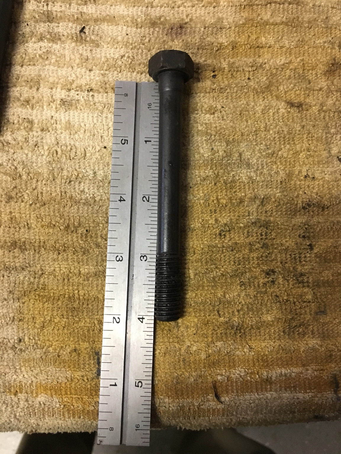

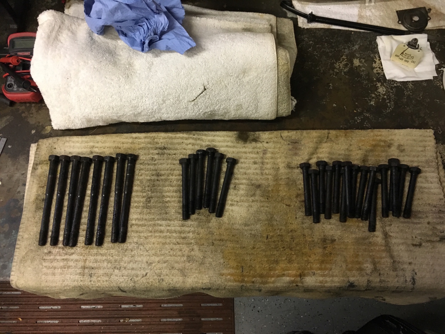

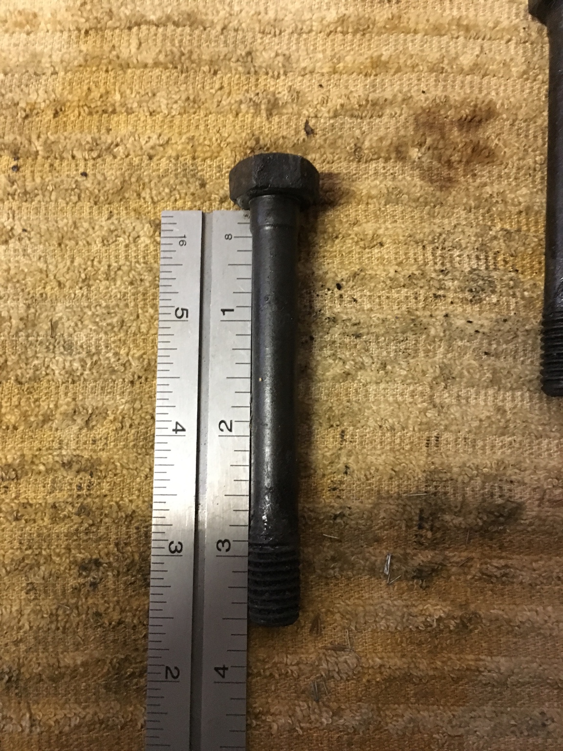

  28. ls1yj
    Joined: Sep 14, 2011
    Posts: 476
    ls1yj
    from Kentucky
    DreadyBear,
    Did you chrome your exhaust manifolds? They look great!!! And shiny!! ;)
  29. cretin
    Joined: Oct 10, 2006
    Posts: 2,857
    cretin
    No problem.
    Since everything is apart, and I failed to label everything. I just grabbed the bolts I have, and measured them all to make sure you got what you need.
    I have a total of 34 bolts.
    16 that are 3 1/2" in length.
    These have an upper shank that is .25 in length with a diameter of .436, so call it 7/16".
    The lower shank is 2 1/2" in length, with a diameter of .388.
    Leaving a 3/4" long threaded section.
    10 that are 4 1/16" in length.
    These have an upper shank that is .25 in length with a diameter of .435, so call it 7/16".
    The lower shank is 2 11/16" in length, with a diameter of .387.
    Leaving just about a 1 1/8" long threaded section.
    And 8 that are 6" in length.
    These have an upper shank that is 2 1/2" in length with a diameter of .435, so call it 7/16".
    The lower shank is 2 1/16" in length, with a diameter of .388.
    Leaving a 1 1/16" long threaded section.
    Hopefully that helps you out.
    ls1yj likes this.
