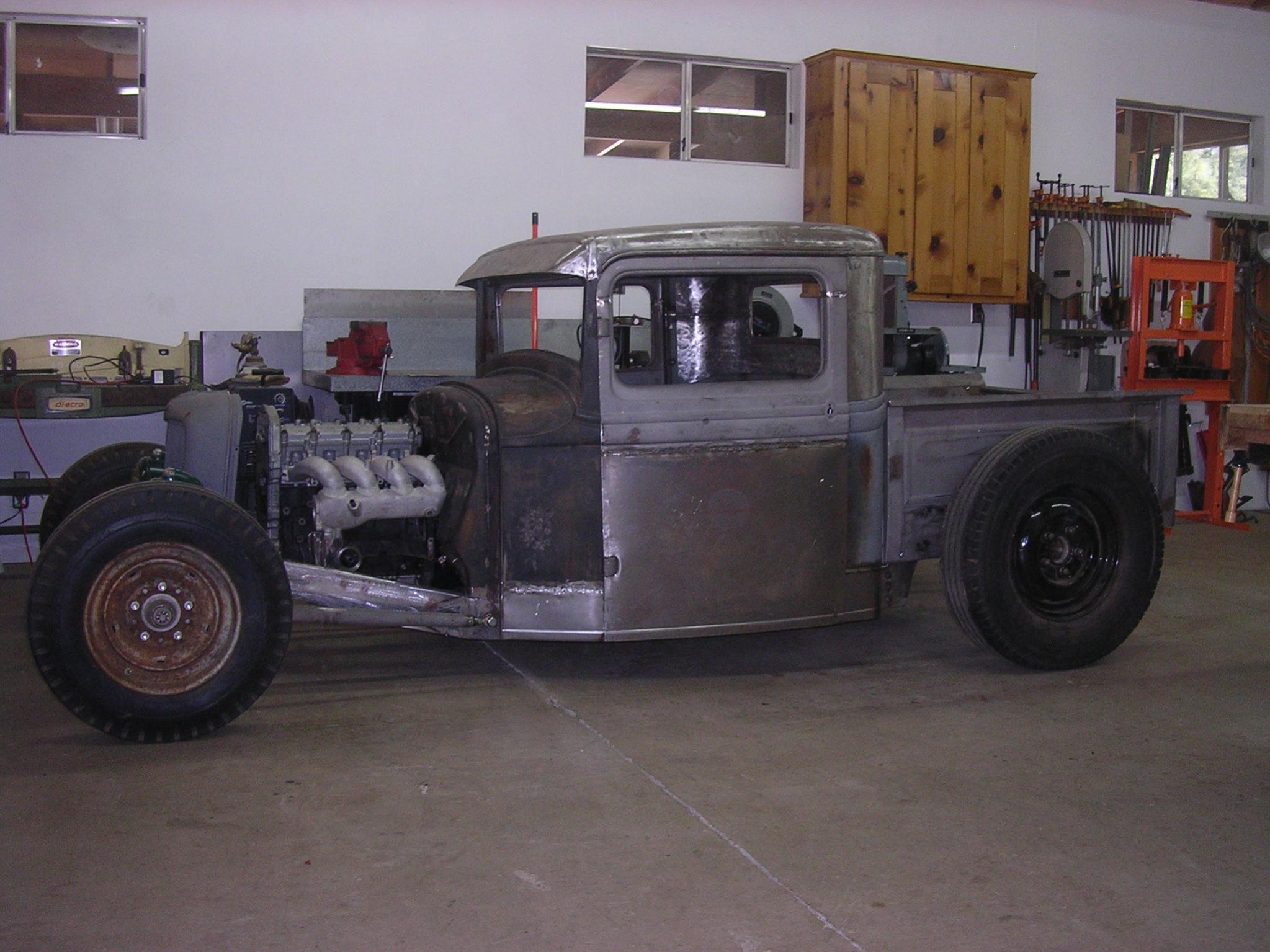

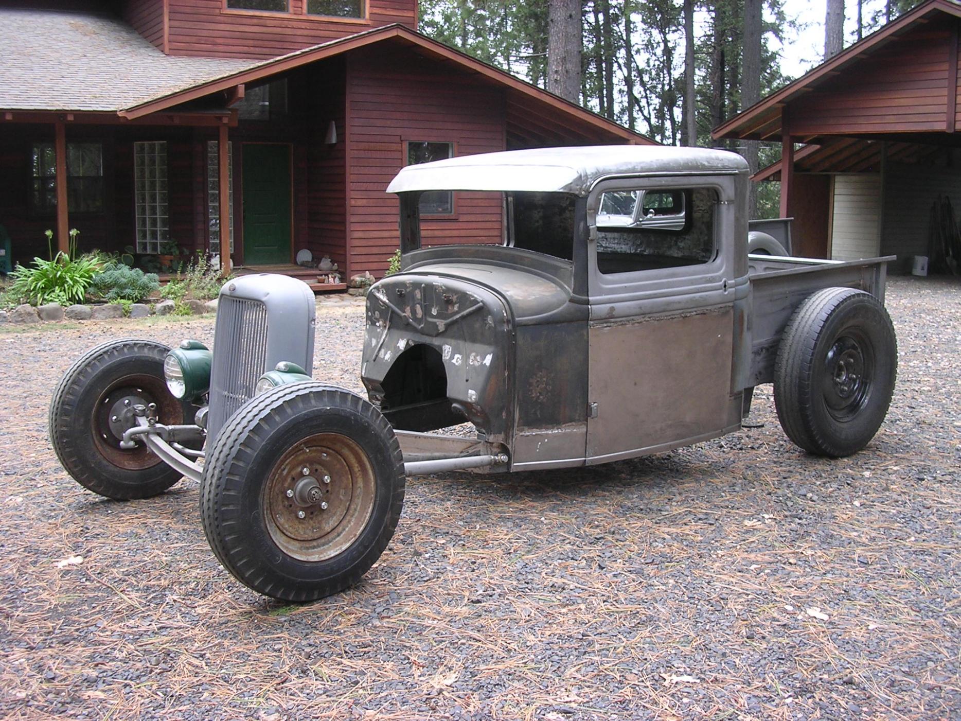

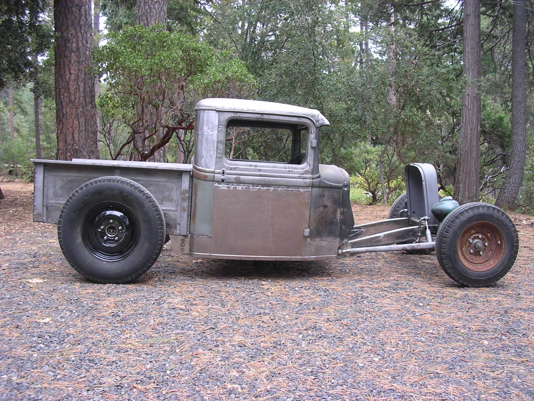

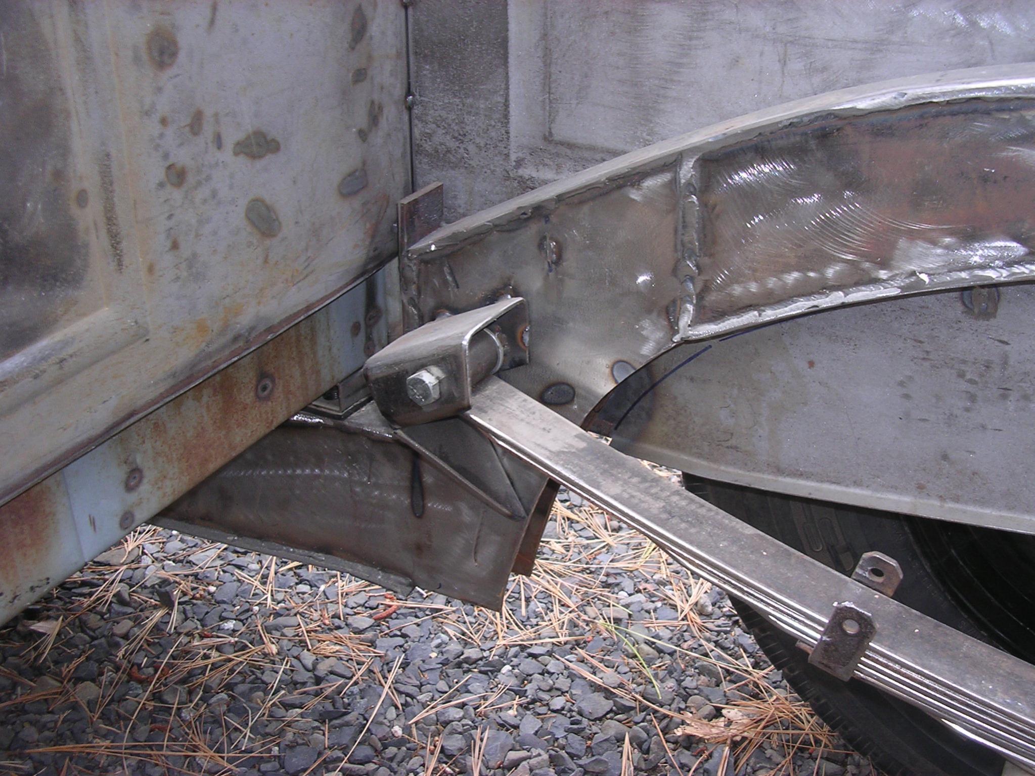

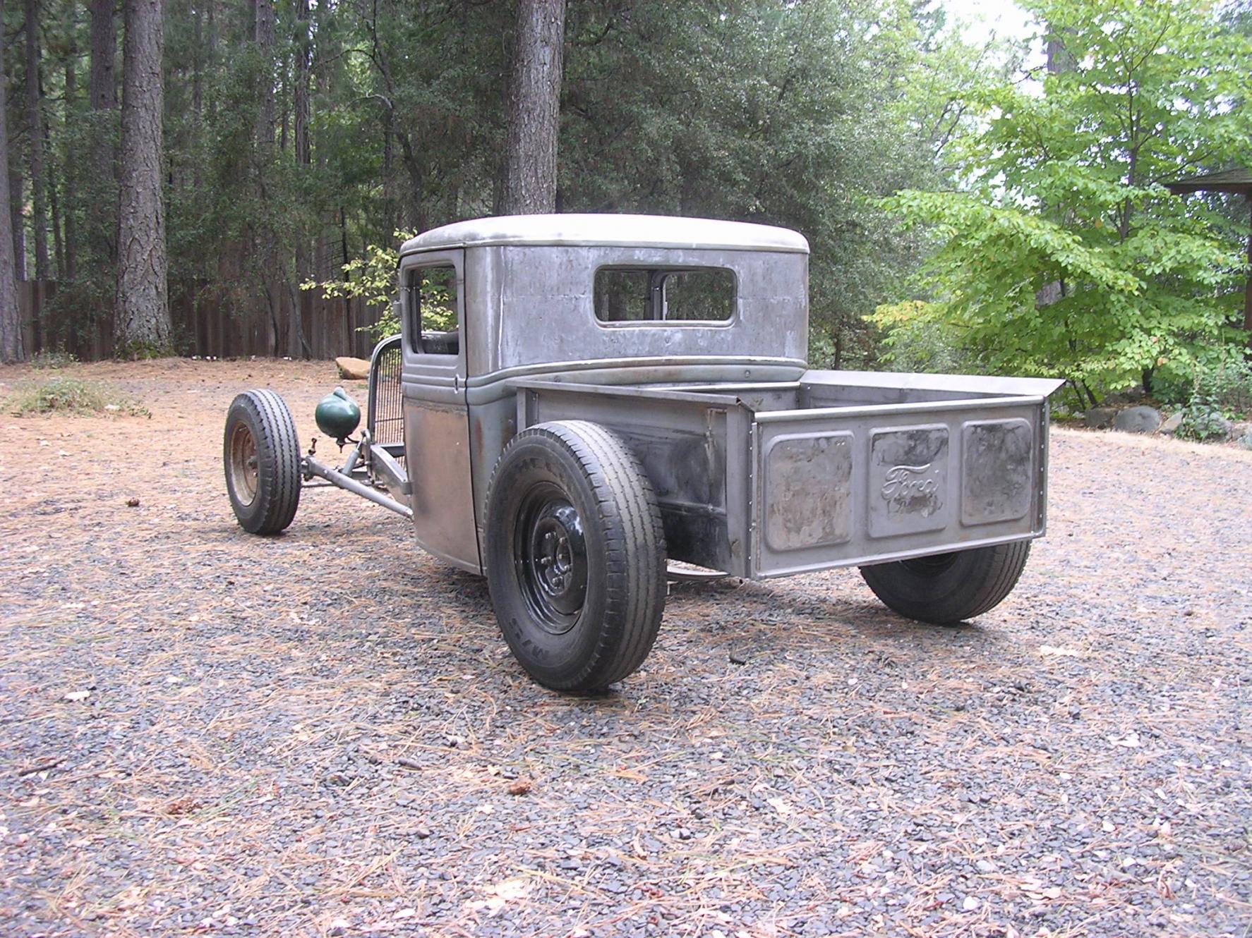

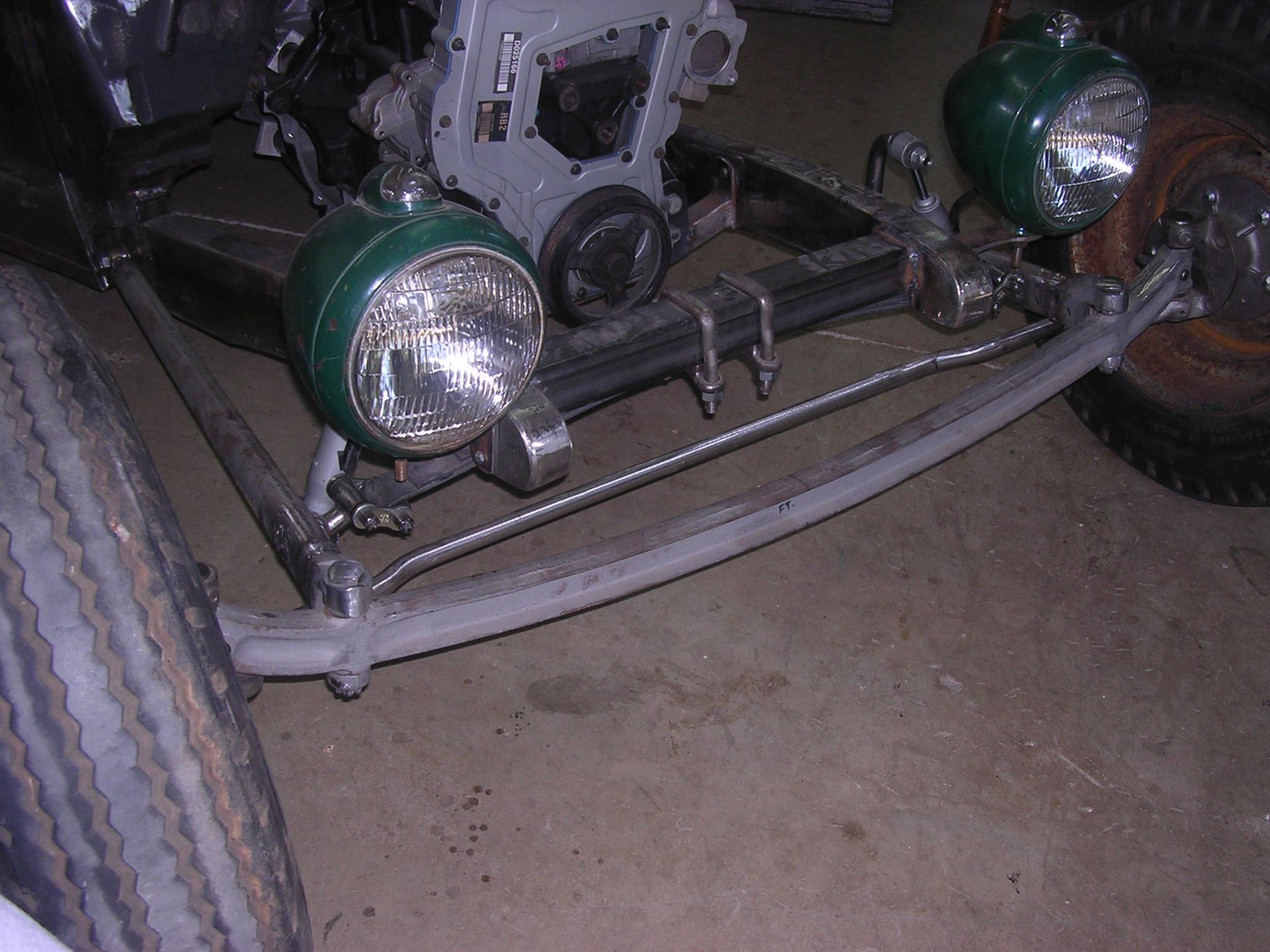

    Here are some pics. of my current project. I picked up the 1933 Ford pickup cab on ebay kind of by accident. This is the first time it has been outside so I can stand back and take a look. There is still a lot of work ahead, lowering the grille for one. The frame is a modified 1940 Ford that I had around along with the front axle, bones and spindles. The 8.8 is located with some leafs I removed from a trailer I had sitting in the back 40.
    I'm really trying to use up stuff I have around and keep it as low buck as possible. I do not have an engine yet but plan to use a QUAD 4 with a T-5.
    I have chopped the cab three inches and the bed is of unknown origin that I shortened up.

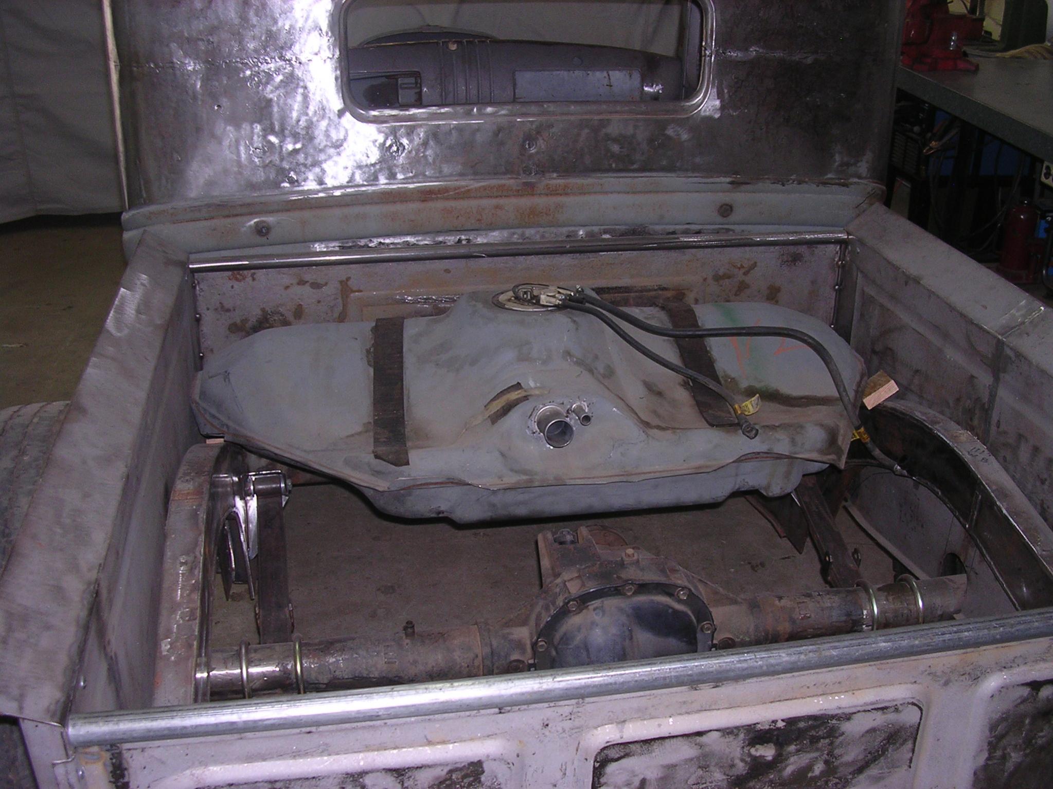

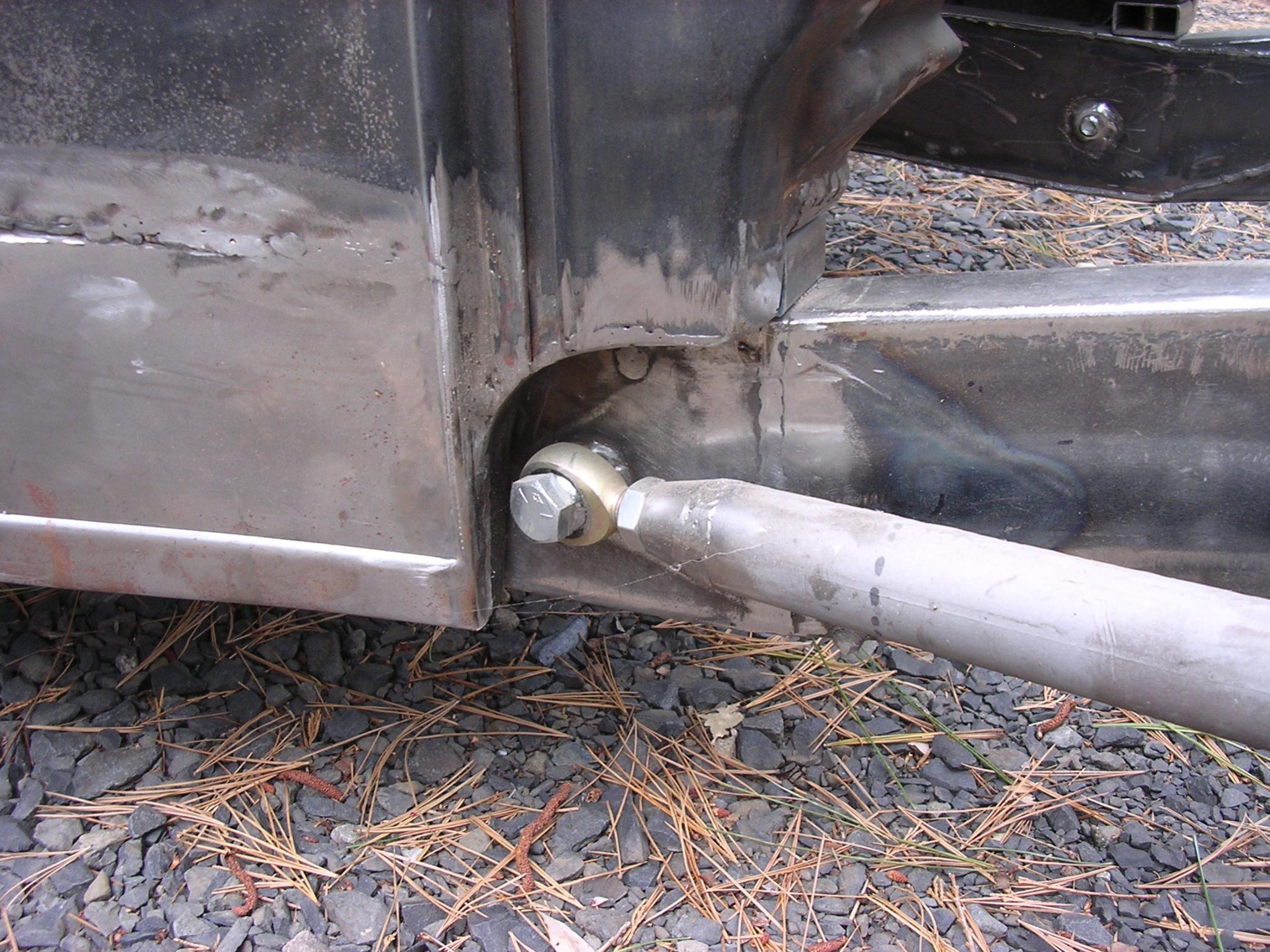

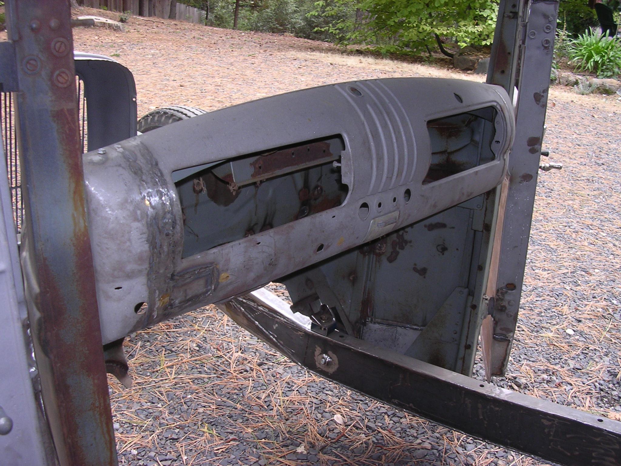

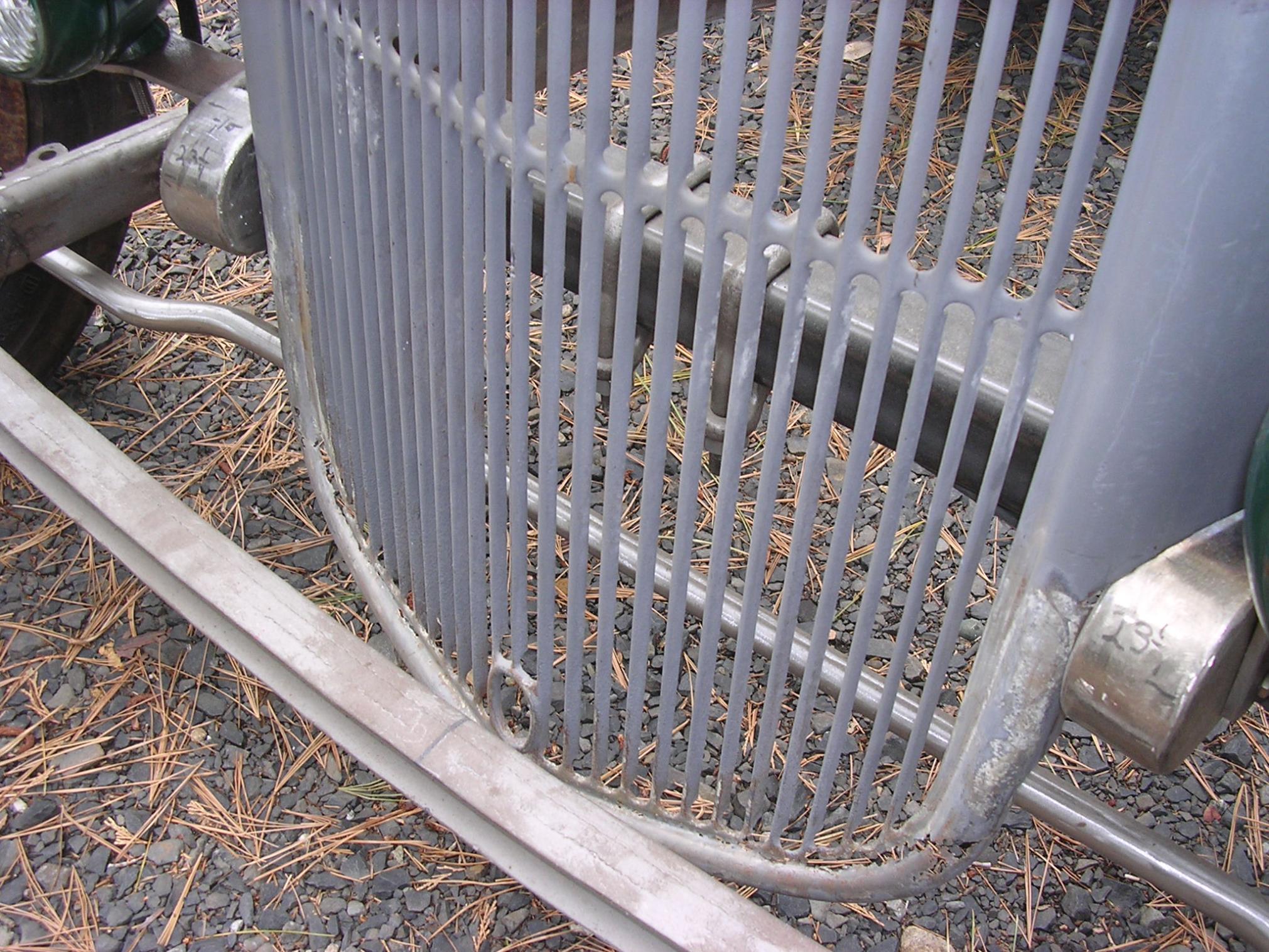

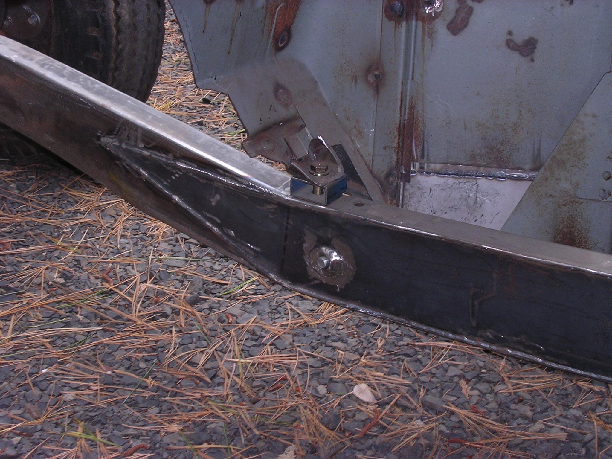

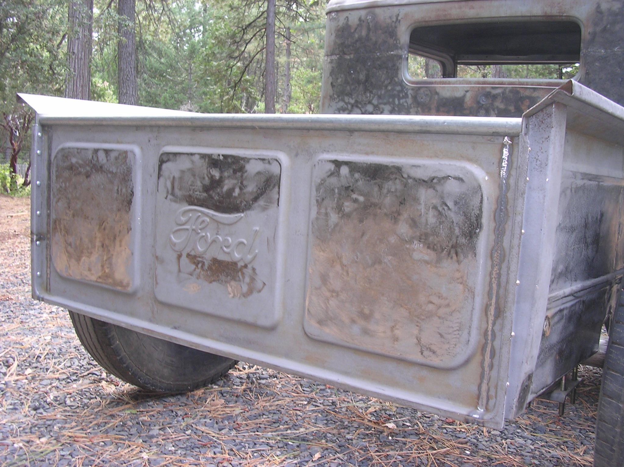

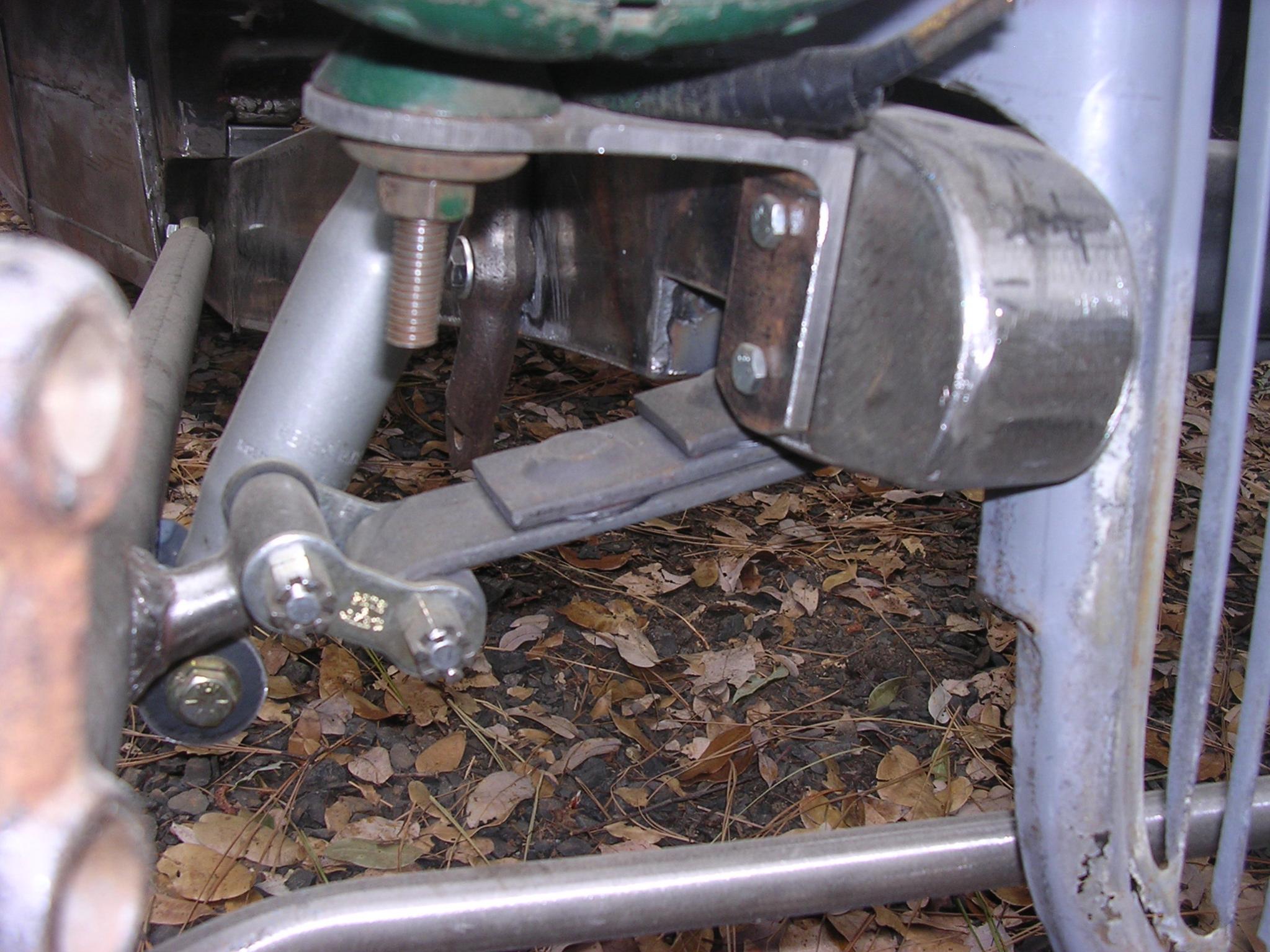

    A Few more pics. Tailgate is from an F-1, shortened and narrowed and a mid '40's GM dash.

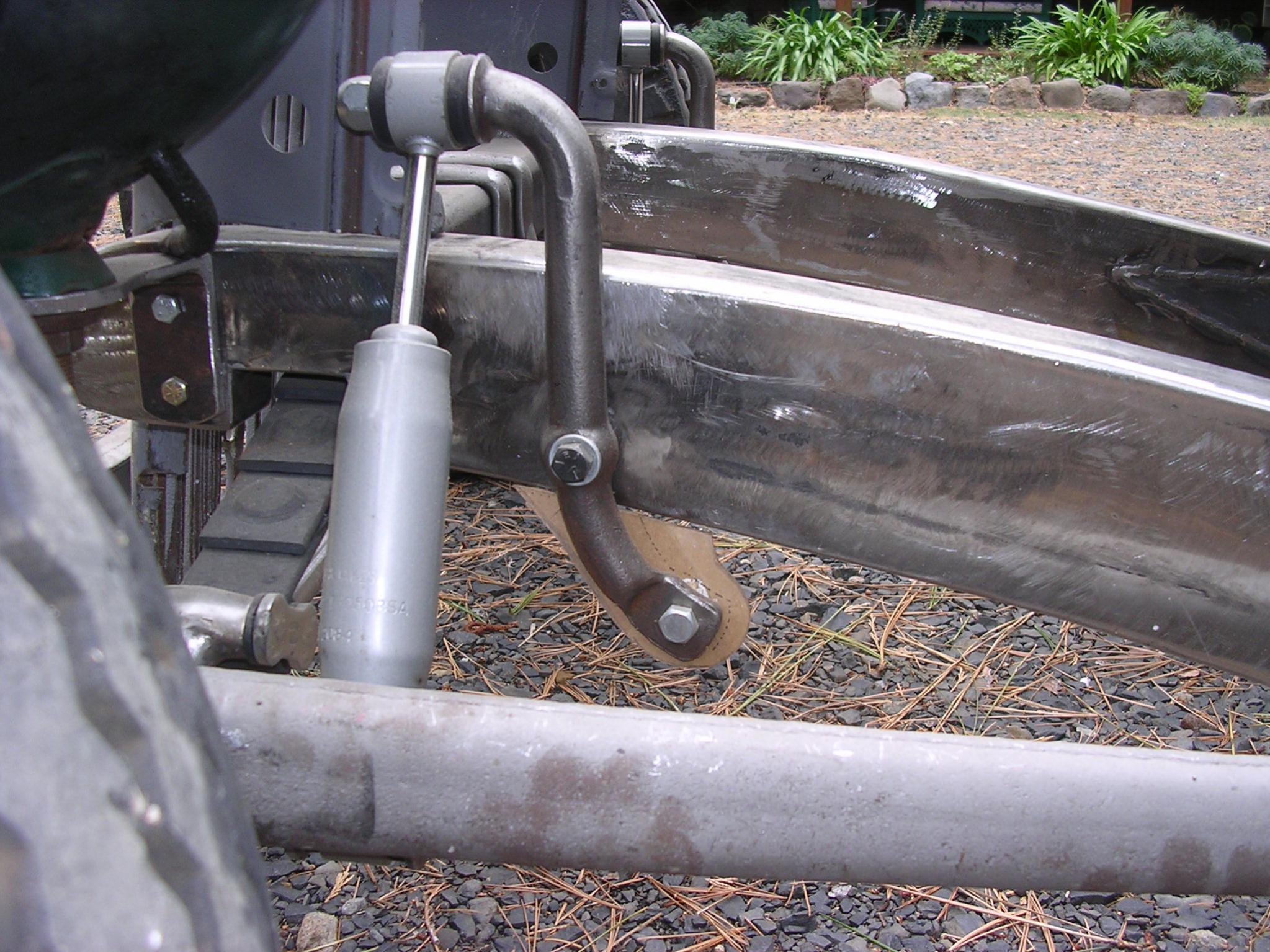

    It is all mig welded together with a lot of hammer and dolly and shrinking disc work. The tie rod is made from 7/8" DOM that I bent to go behind the grille shell. the front frame rails are made from 2"X5" .125 rectangular tubing.

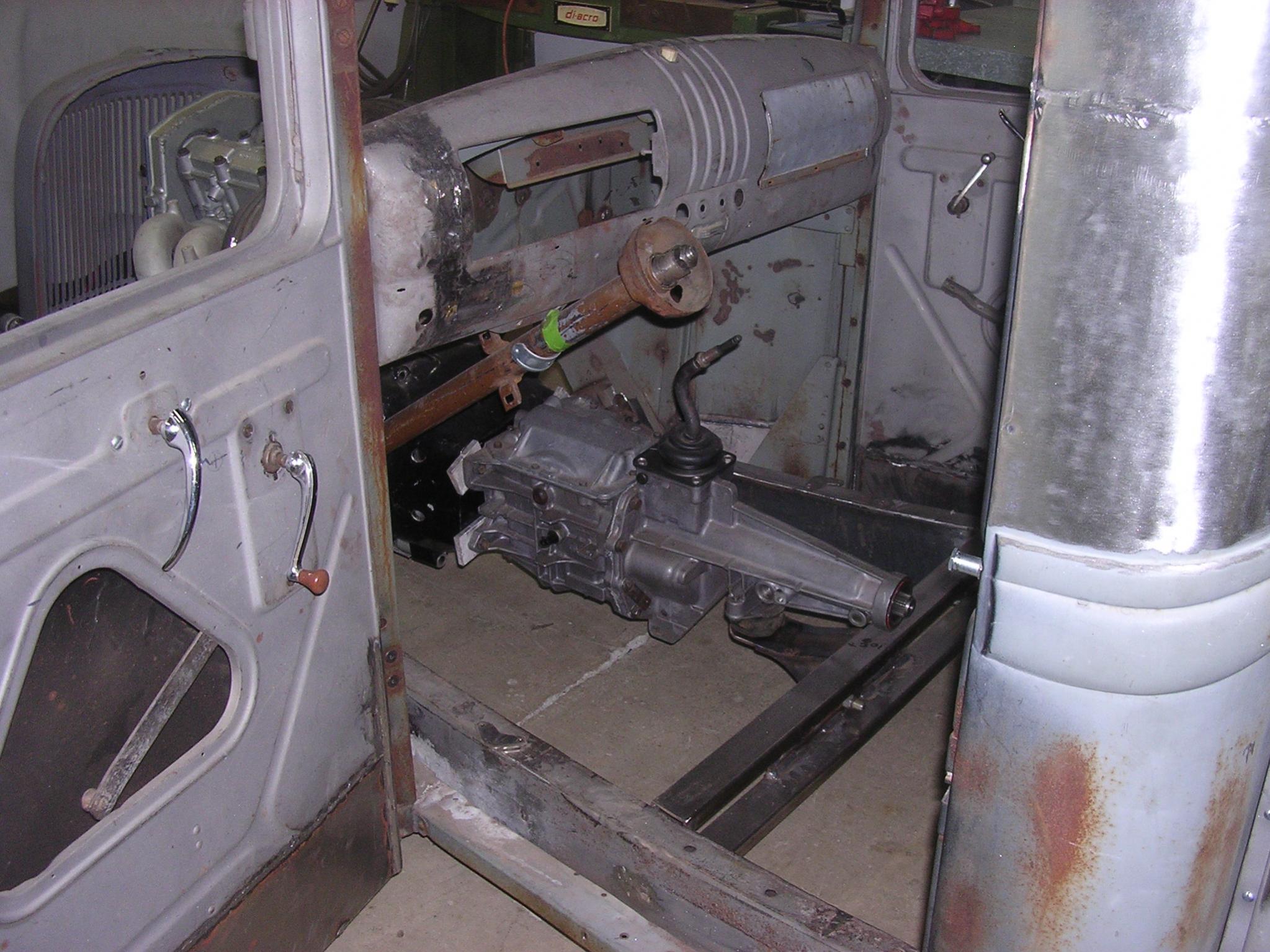

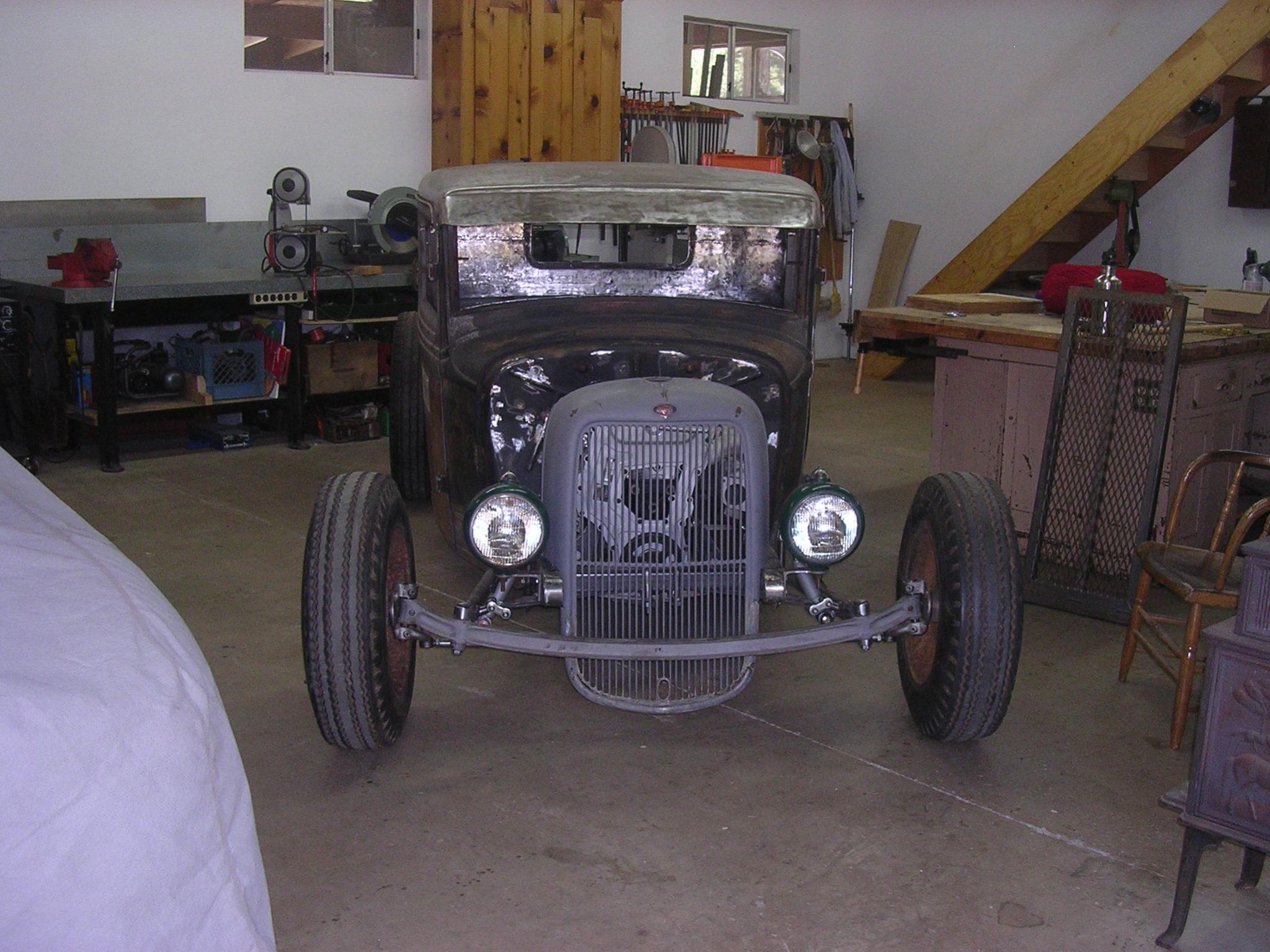

    I'm moving a bit slow on this project but have made a little progress. I found an adapter for the T-5 and the engine and transmission are in. I plan to use the gas tank from the donor vehicle, electric fuel pump and all. As I had to set the caster on the axle any way I decided to shorten up the wheel base by 4 inches at the same time. Now at 108". Also got the grille shell lowered to a more proportional location. Still quite a ways to go!!
