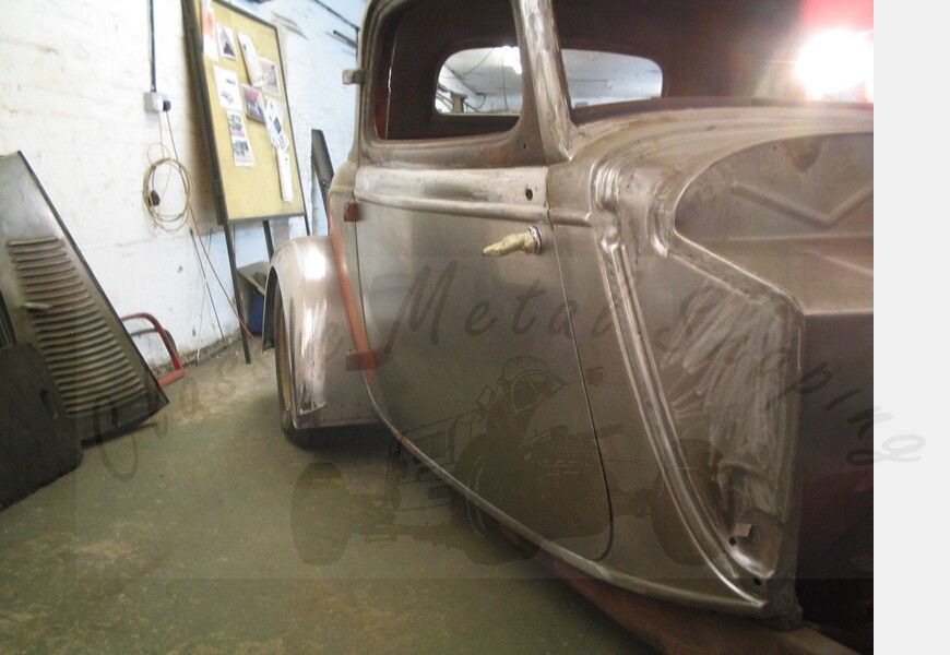

    I have been asked several times about the car in my avatar so I finally got round to sorting out some photos of the work I did on it.
    The work was done for a customer. It was quite a while ago and I can't find any photos of the before at the moment. It had all the normal rot around the bottom but it must have spent some time upside down with the side in the photo above being the lowest point because the panels had all rotted from the inside including the top of the rear quarter, the roof and the top of the door skin. I made every external panel in this photo the only original part of the skin in this photo being the yellow area of the door window opening and the rear screen surround/ roof area above it but even that had to have quite a bit of work done to straighten it out.
    I have some more photos I will post when I have time and I will try to find some build photos.
    David

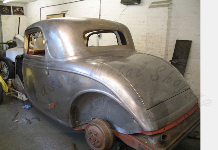

    I also made rear fenders for it.
    David
  11. Mindover
    Joined: Jan 18, 2009
    Posts: 1,645
    Mindover
    from England
    Here they are fitted to the car.
    David

    Thanks to everyone! I have been doing this for a long time, more than thirty years. I don't get to work on Rods all that often but it was hot rods that got me into this type of work.
    Thanks again for all the nice comments.
    David

    The other side was not as bad, I made a new lower door skin and some local repairs...
    David

    Here is a close up shot of the new door skin I made, the side window frame is new on this side as well (apart from the yellow section) the new rear quarter is visible too.
    The main skin was made in two pieces joined just above the bead and the widow surround was made from another two sections.
    David
