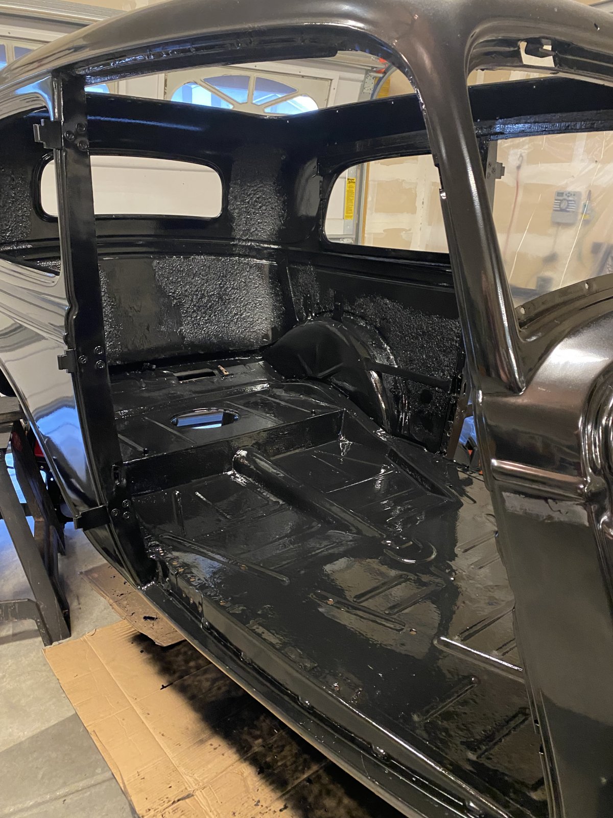

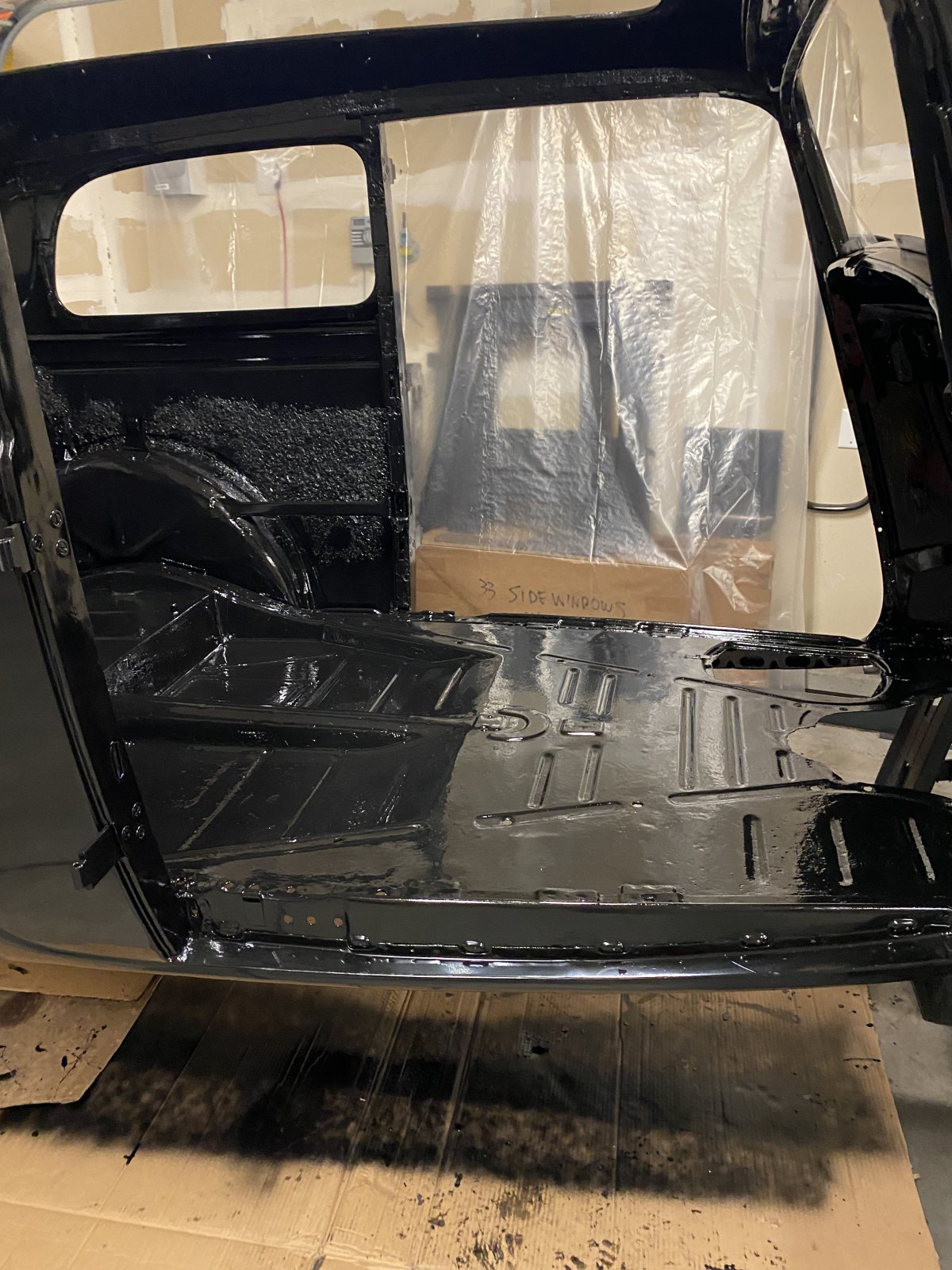

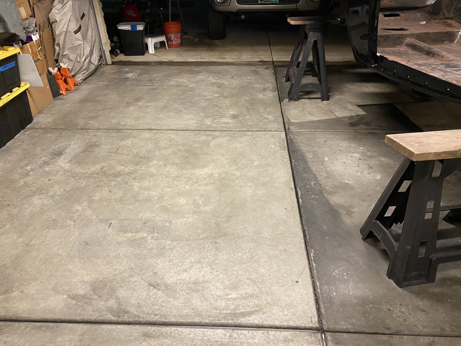

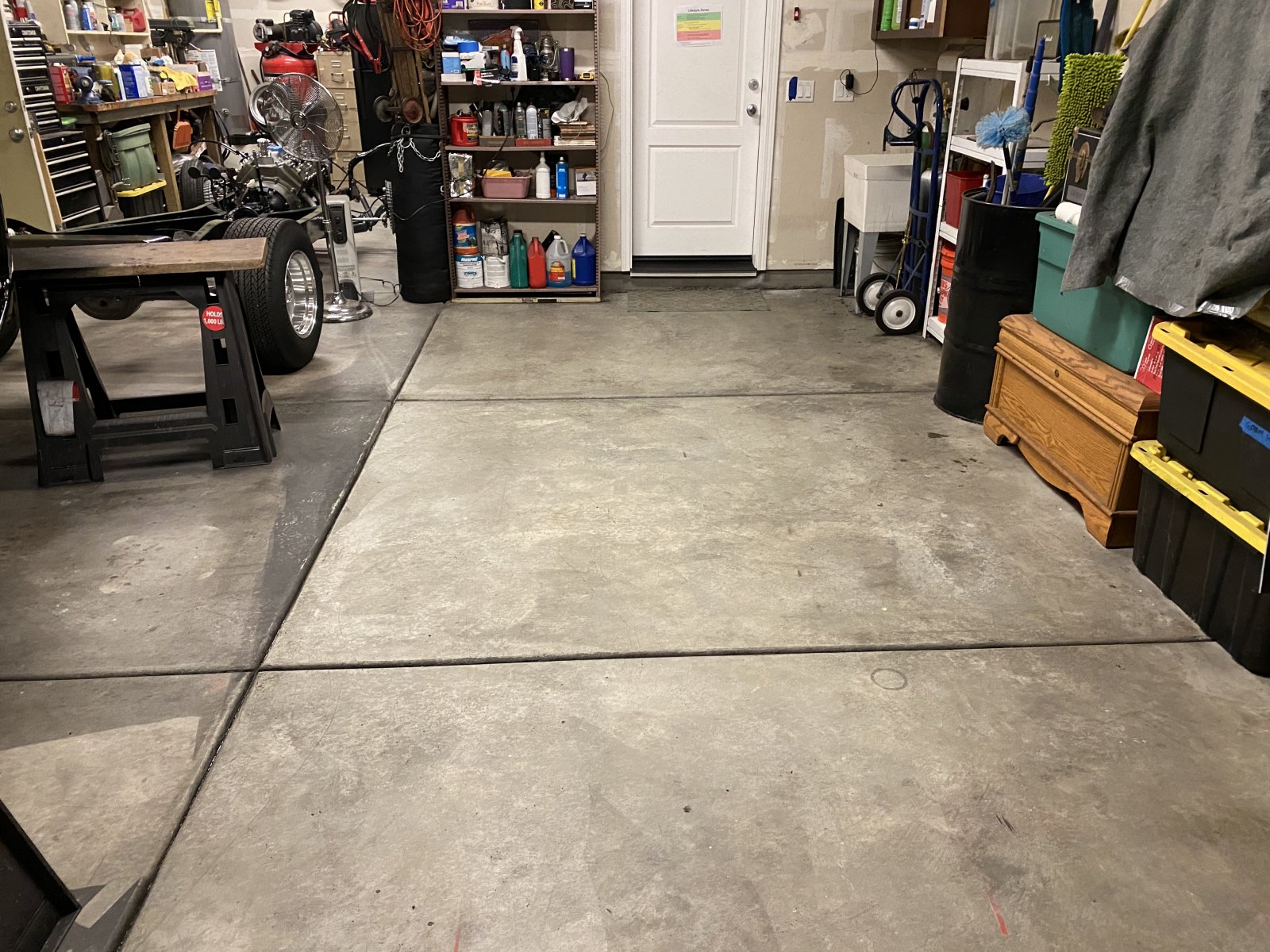

  3. 33Doll
    Joined: Sep 27, 2019
    Posts: 1,378
    33Doll
    487B6958-C92B-49C8-AC1F-63D7476D19CF.jpeg 22469C6B-69C1-4378-A473-AD7465F4AEEF.jpeg D6EABC3D-8F61-4BB2-AA44-F4DE52E9BD72.jpeg C991BB3D-FD5F-4ED1-81FC-D7DA3A8D33D0.jpeg I saved My Bacon!!

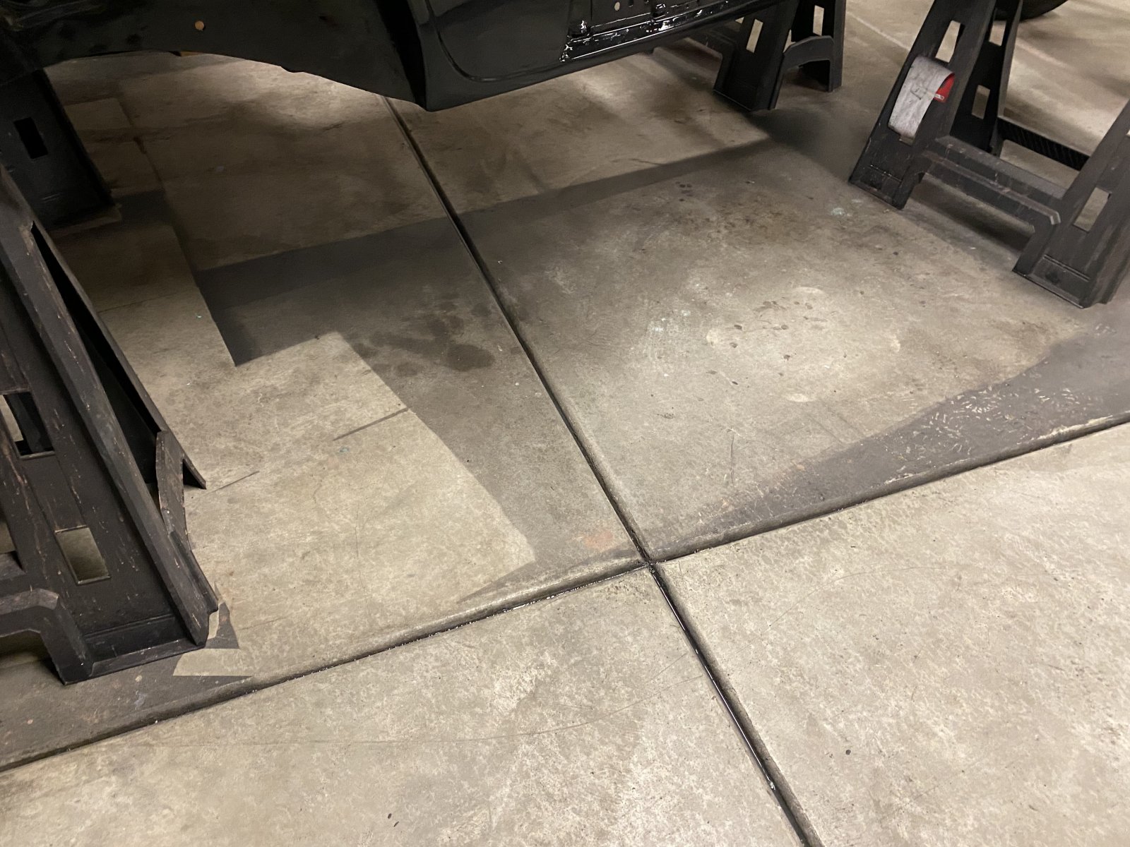

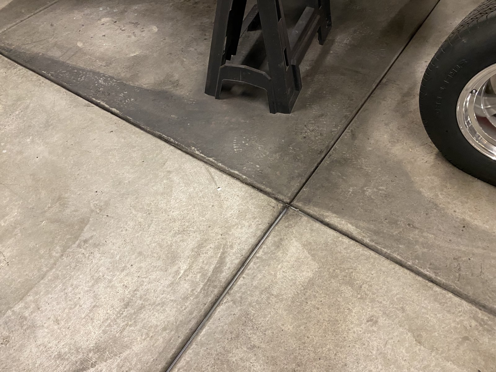

    Cleaned the wife’s parking Spot!
    Trial and error, but a combo of Jasco smeared one square at a time, with a wet Hot rag, and a little water as it thickens. Then use a bristle brush in circles, and keep add ing water to dilute it. Then Rinse several times with a mop!! A lot of work took about 2-1/2 hours, including trying several methods first!!!
    Stogy, Jim Bouchard and loudbang like this.

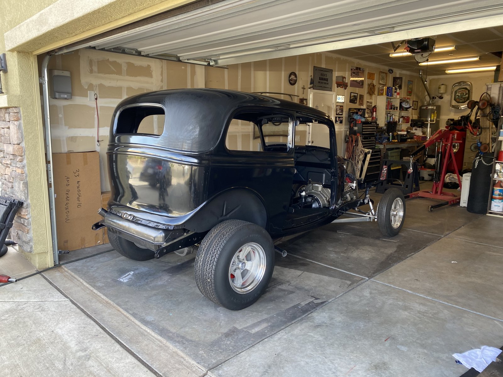

    5918E8C8-C050-40AC-AD2C-606740B0F67A.jpeg B8A5D060-665B-4566-9B04-A00BD1F5B062.jpeg 3B03AE0E-60BD-4405-8B40-39511220788C.jpeg 21259C60-DA9F-4364-87E9-FF0DD87DB4E1.jpeg 7E93DE4F-CB49-4C14-9267-B5BB60FE60AA.jpeg 656A318B-4217-4DC7-A99B-BAF0845FBAF6.jpeg THE 2 SHALL BECOME 1 SOON!

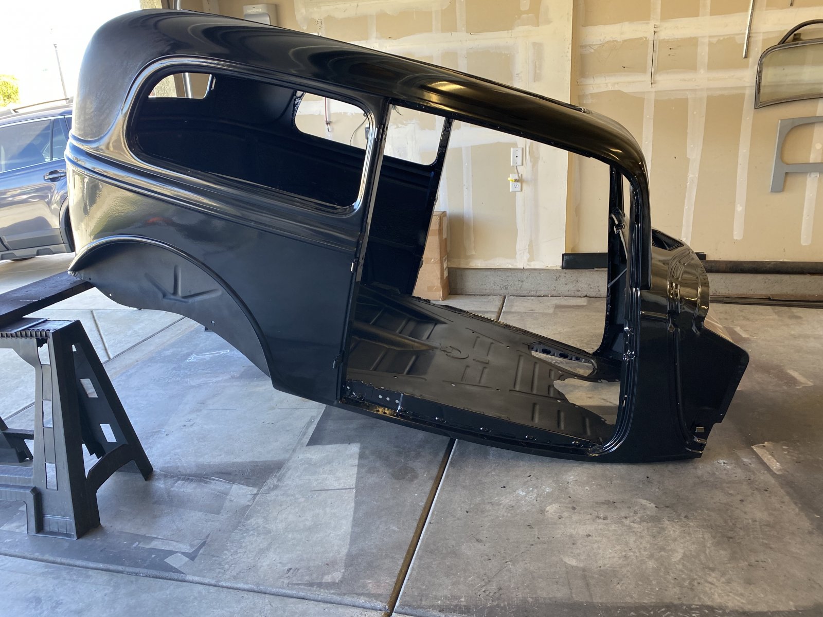

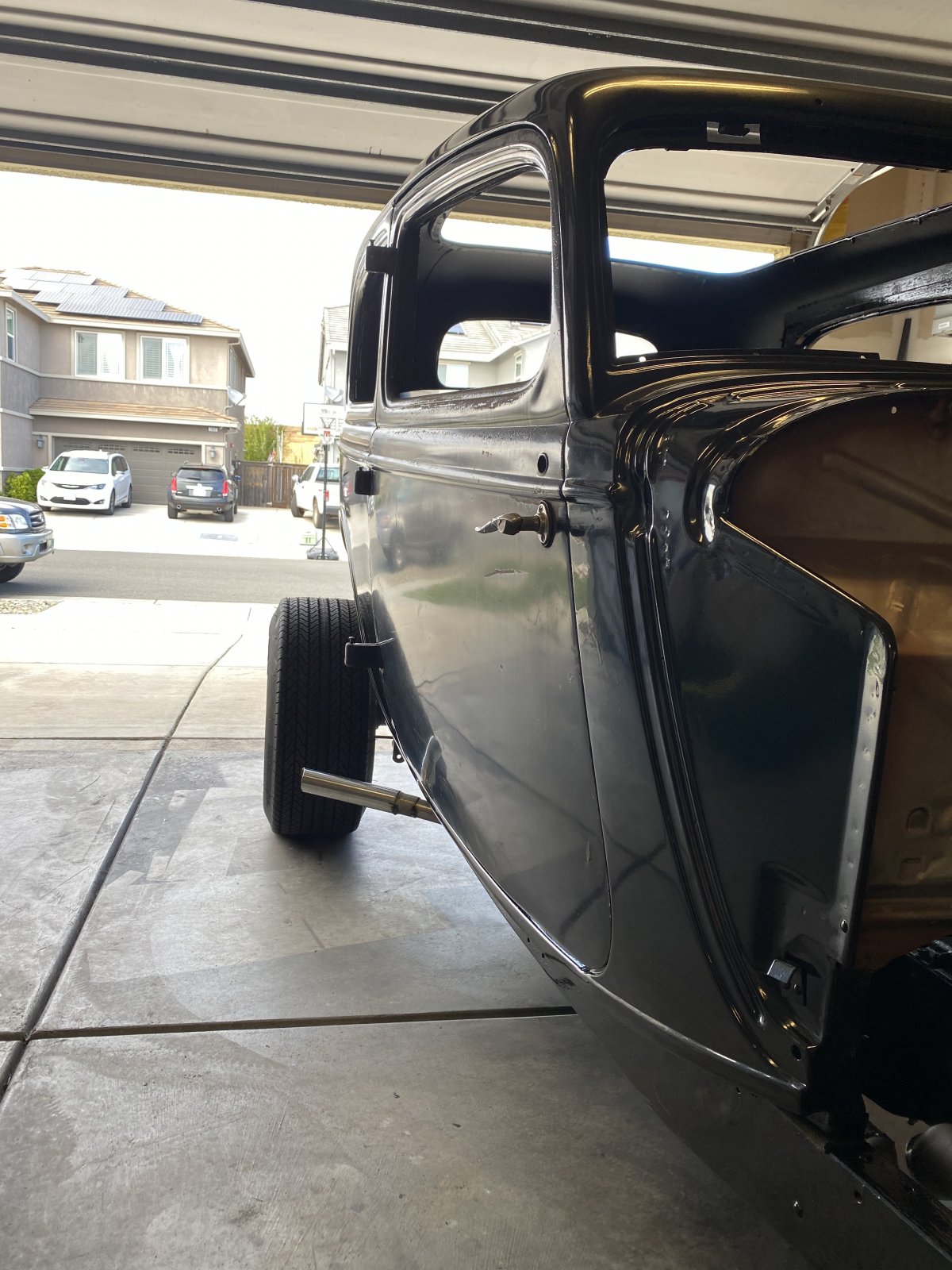

    Getting Closer!!!
    Now that the paint cured, I baked it with 2 radiator space heaters all night last night, it was like A Warm chic-key Incubator garage in there!!!
    The Darn Rattle Job turned out so nice, I'm not even gonna sand it!
    Im just gonna cut and buff the orange-y areas!! I can always Wet sand it later after the car is together and running!!!
    (I just wanna cruise Man!!!)

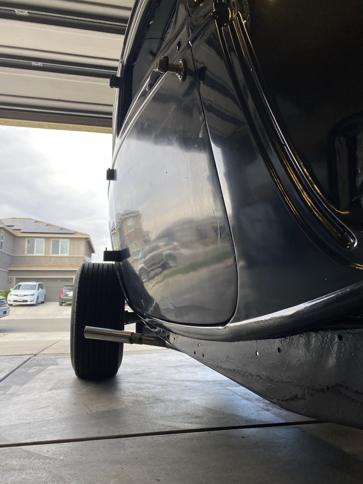

  6. 33Doll
    Posts: 1,378
    33Doll
    She did say, wow you could see the house across the street in the paint!!
    I can’t believe how far spray can technology has come!
    All I know is a Rustoleum has my stock!!

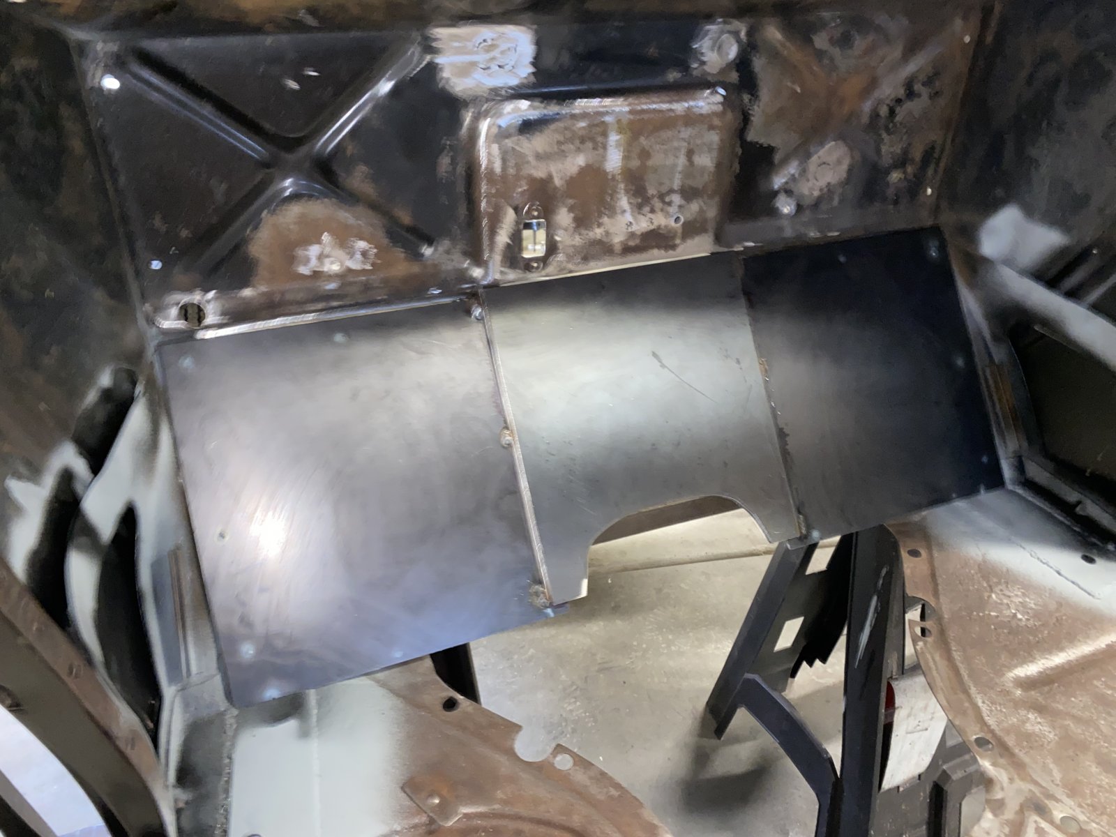

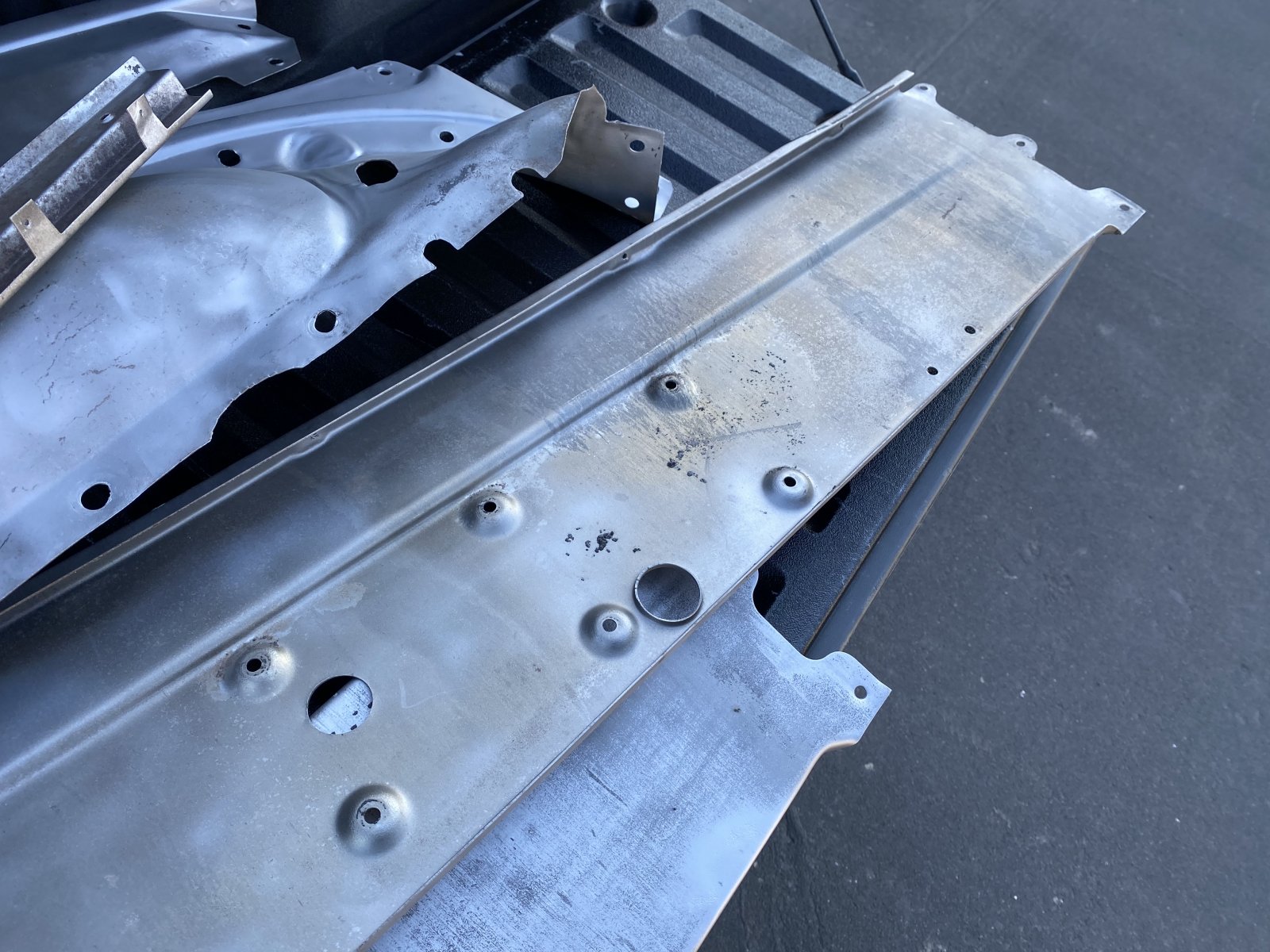

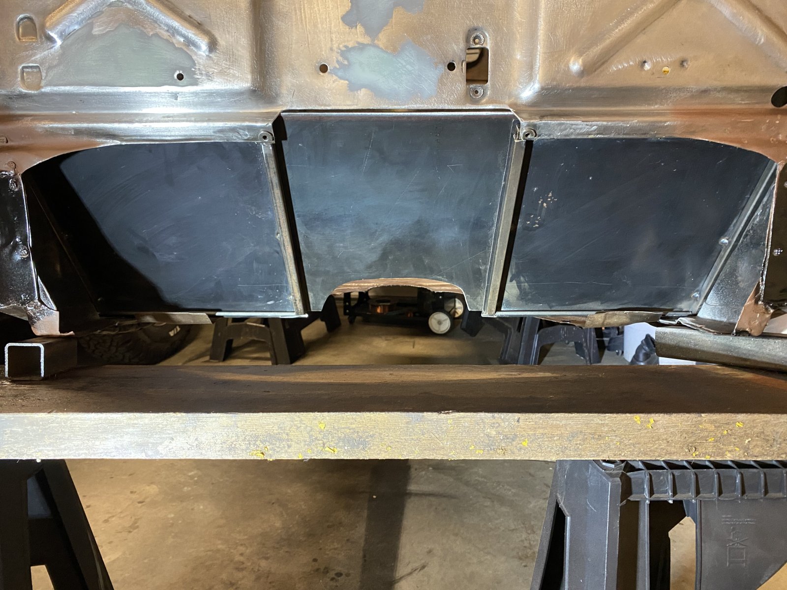

  10. 33Doll
    Posts: 1,378
    33Doll
    270EC91C-4312-438F-9CDA-291C91F7234D.jpeg CBA97049-DBCA-4383-9EE1-ADECFFCFC3A4.jpeg 73871804-759C-41F6-BE69-F251C2FFA70D.jpeg 4D647858-E662-4145-8CFF-3E957AFA51F8.jpeg 05D0359C-B6AD-4A85-9D42-1DFC48DA147D.jpeg 63368C47-43CE-4FB6-9F1D-433CBB0C2662.jpeg DA28E149-62A2-4AC9-B0AD-D1EC80E24955.jpeg 008745AC-7D1A-4D3B-8FB7-CFDEDFBC2E99.jpeg Wife has been having me do too many honeydews on the last couple weekends!!! So I haven’t been able to sand and buff the paint!!!

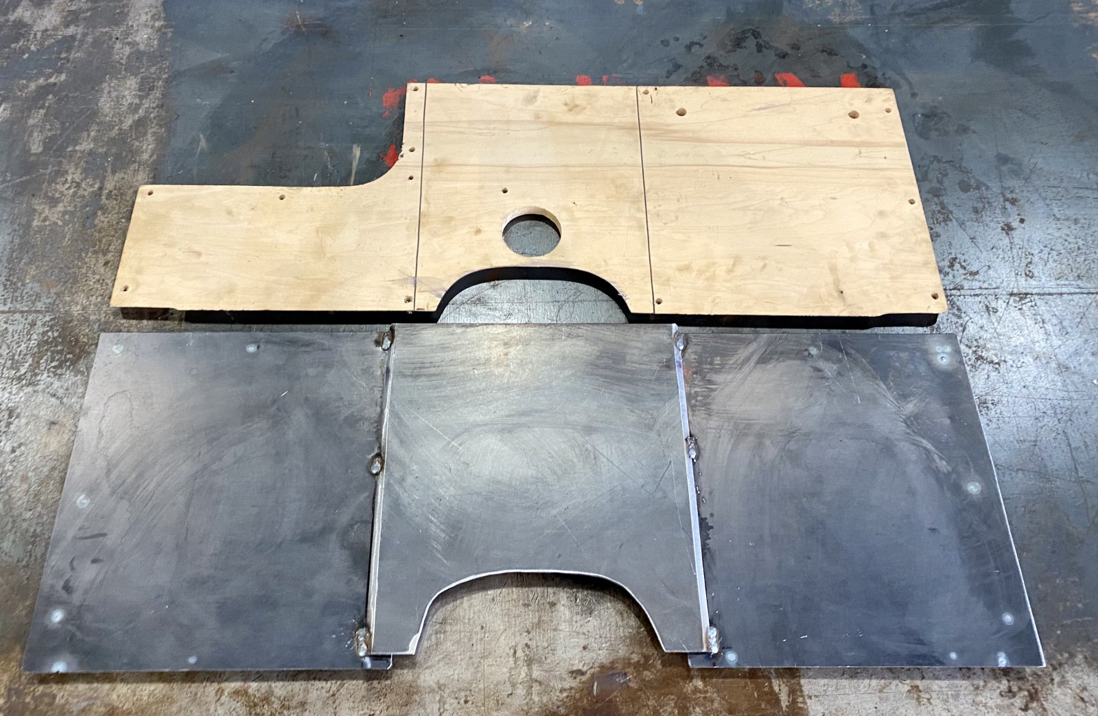

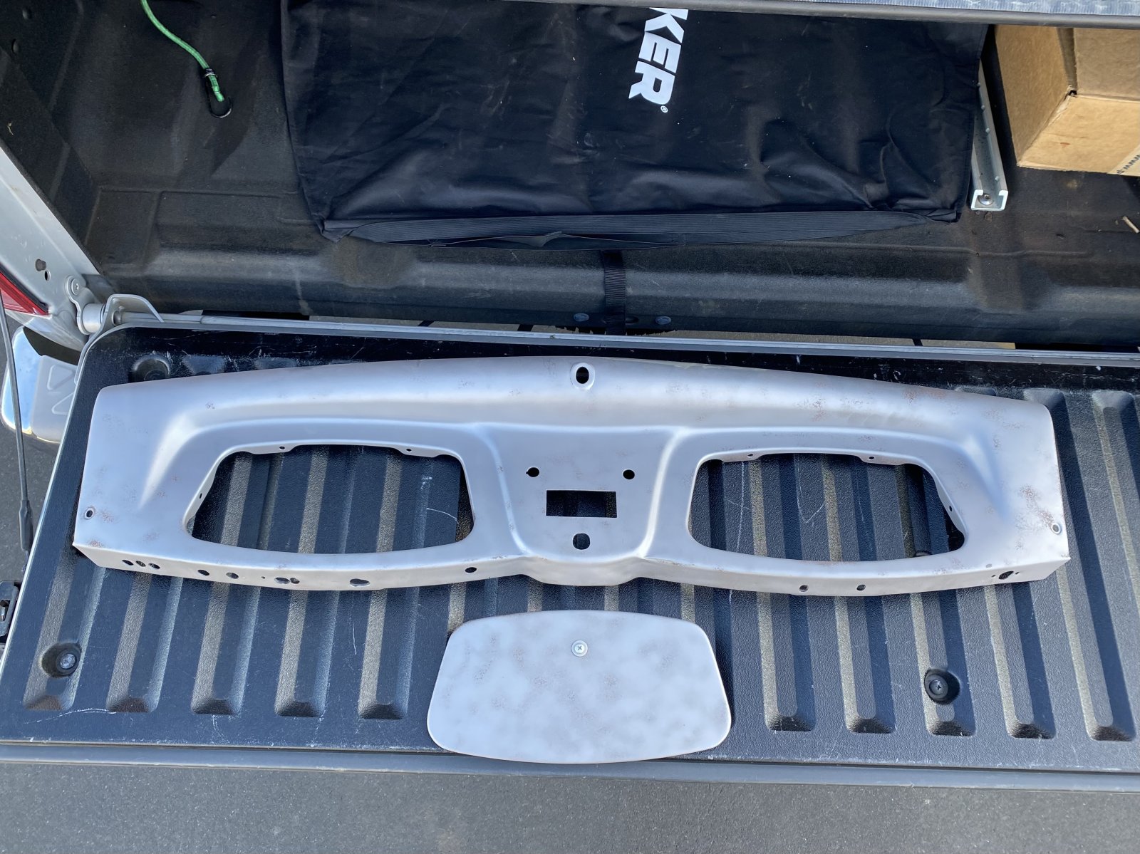

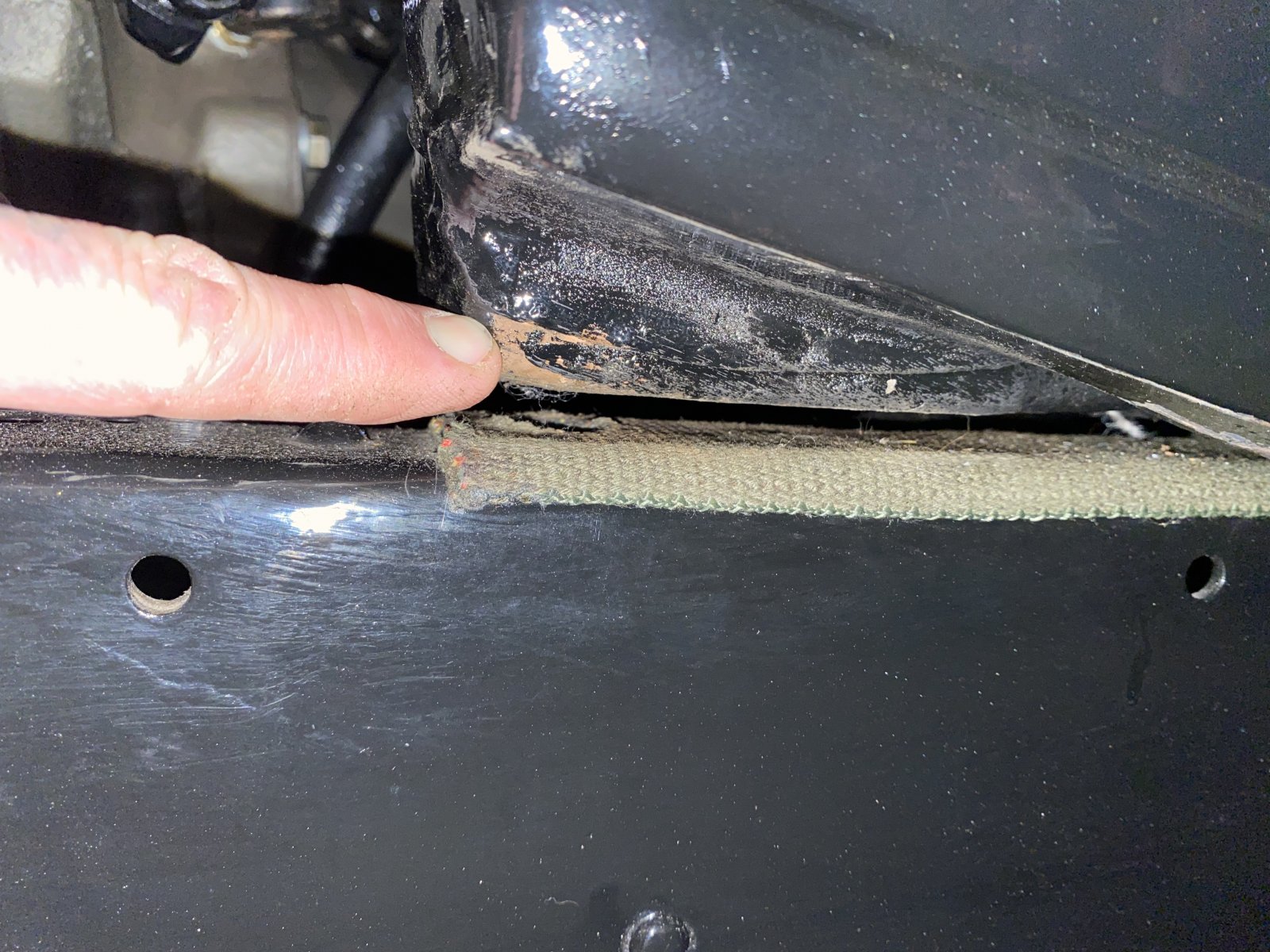

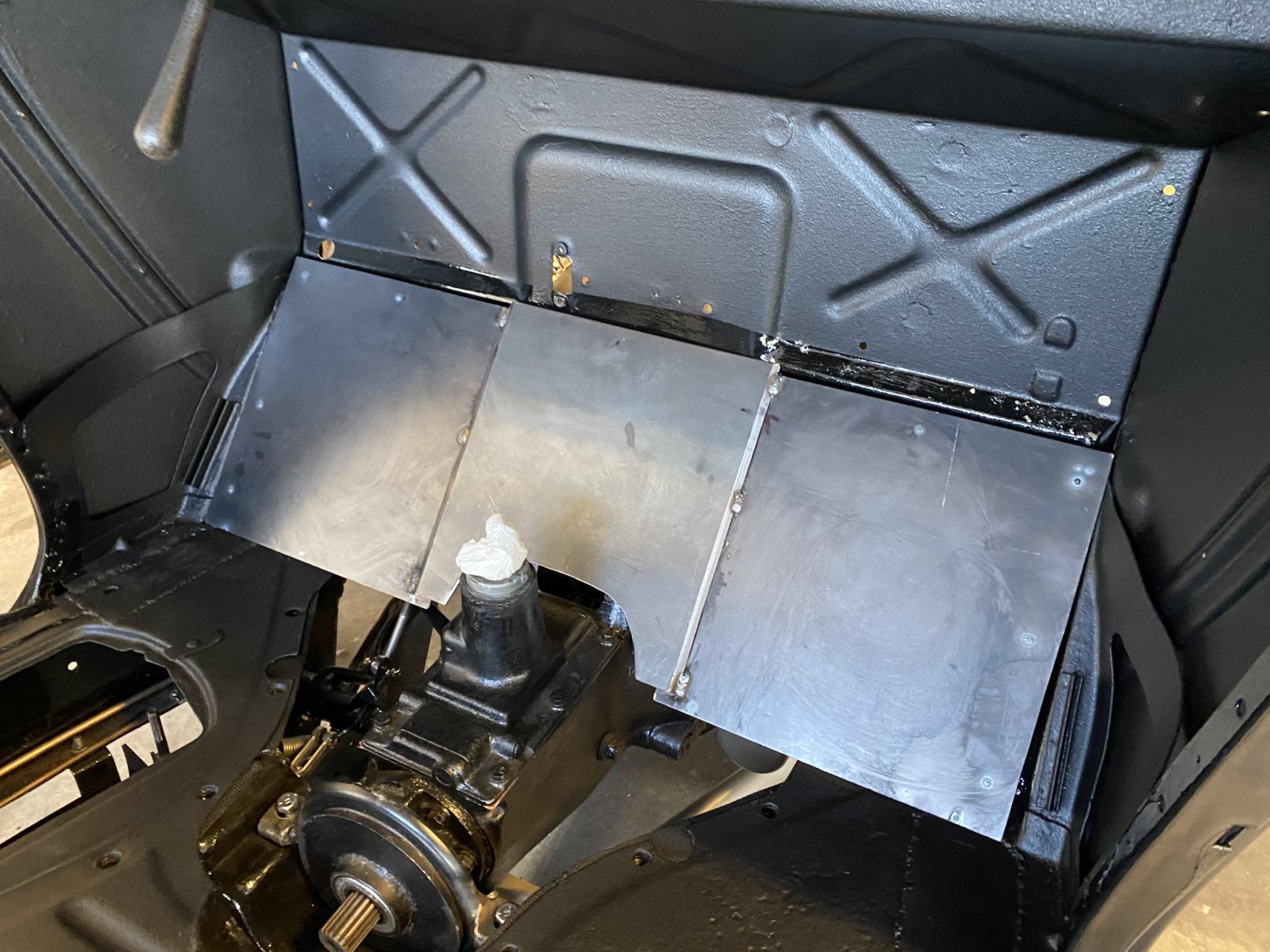

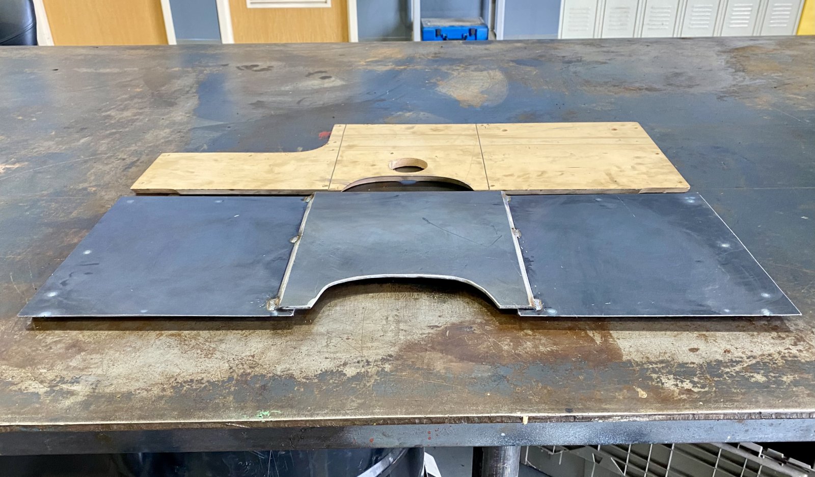

    So I made a new metal toe board at work on breaks!
    To simulate the thickness of the wood and still be removable.
    The 8 BA flat head was rubbing on the back of the firewall and the tranny vent cover was rubbing on the wood, so now I got some space!!
    Stogy, brEad, dwollam and 2 others like this.

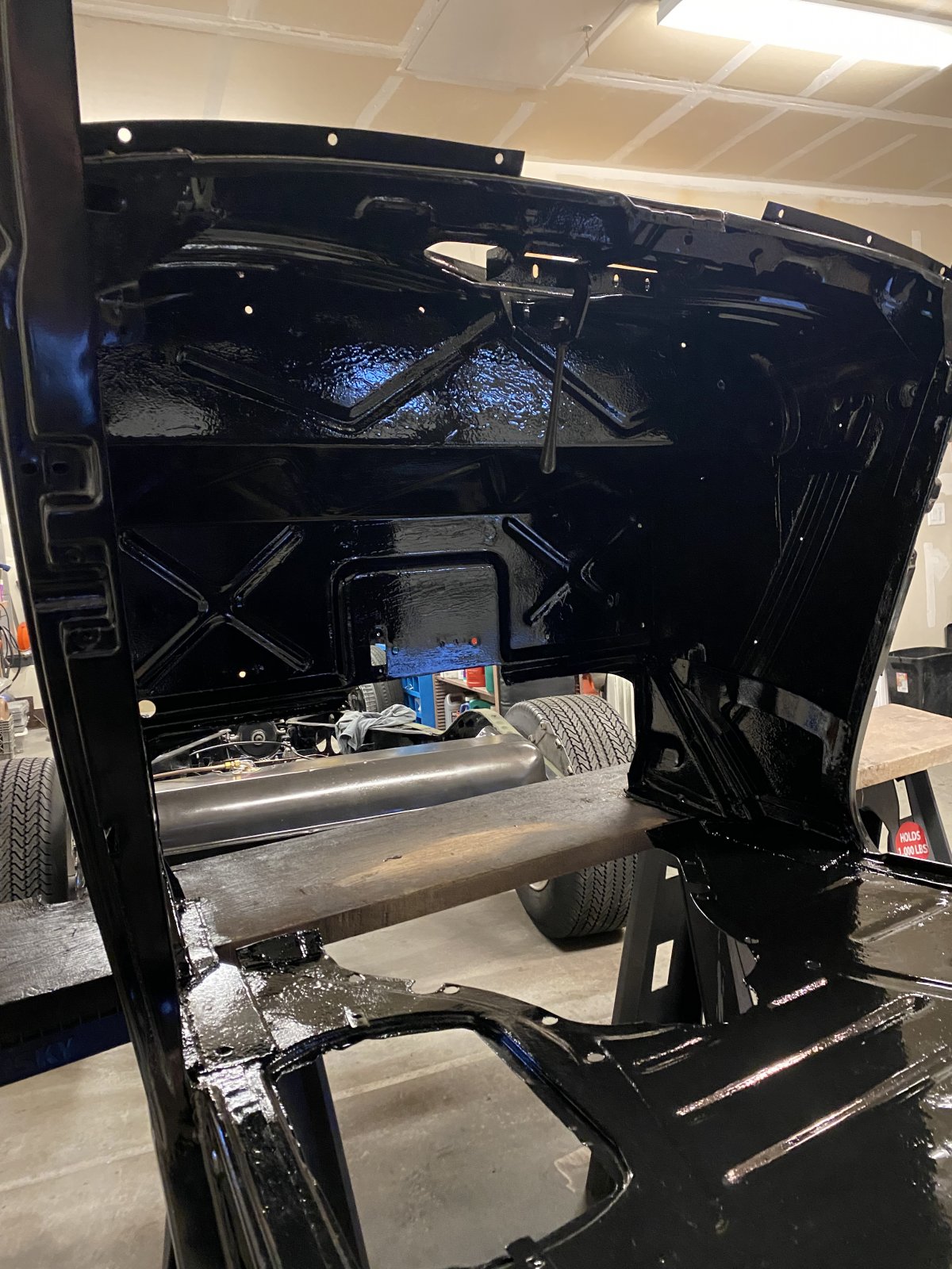

  11. 33Doll
    Posts: 1,378
    33Doll

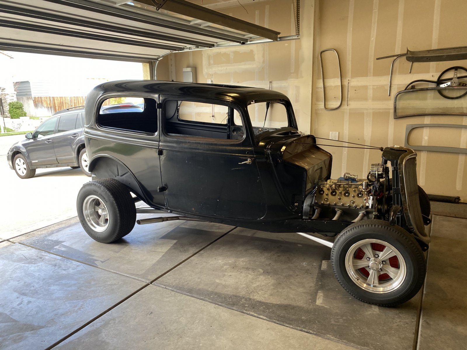

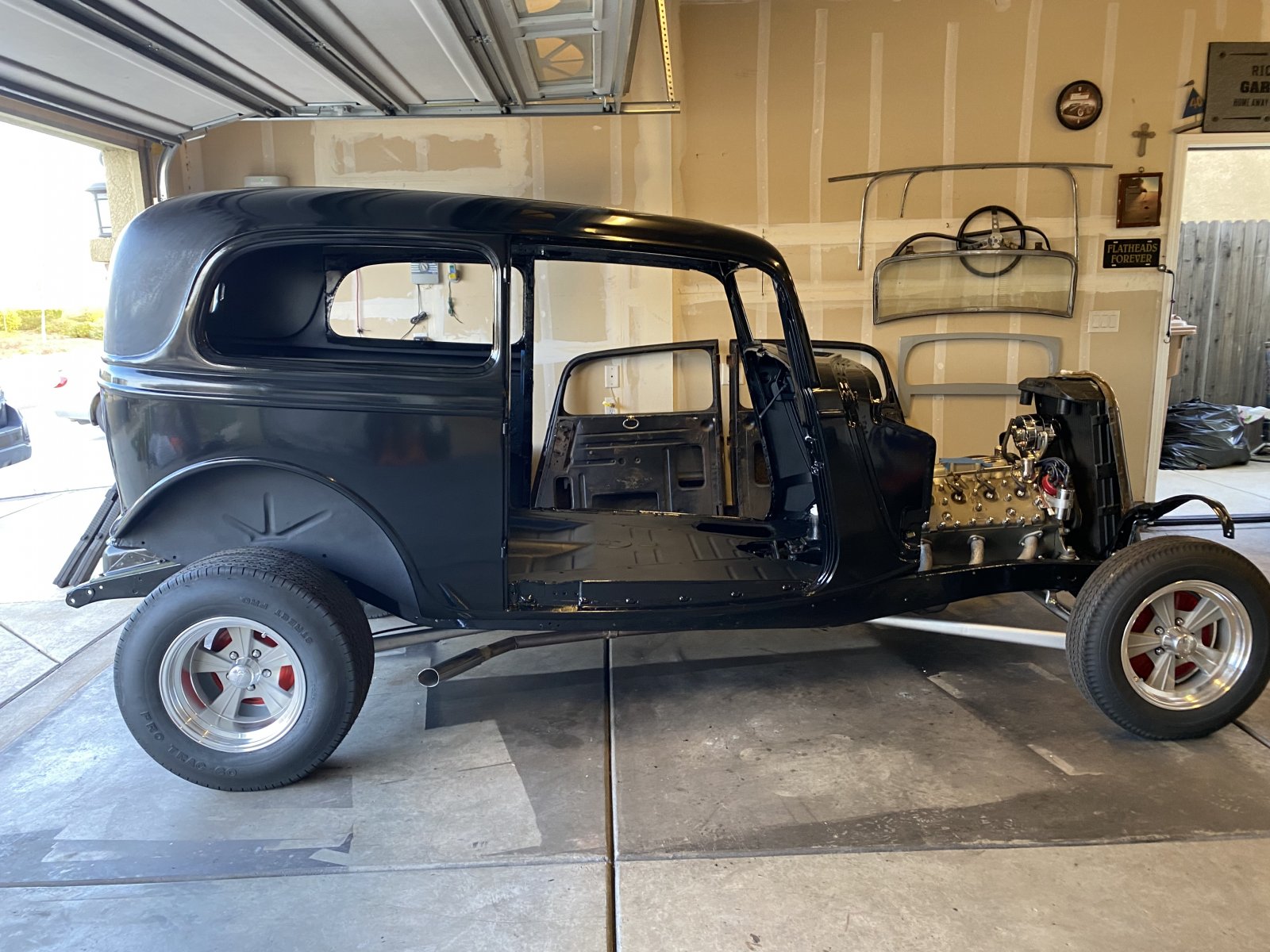

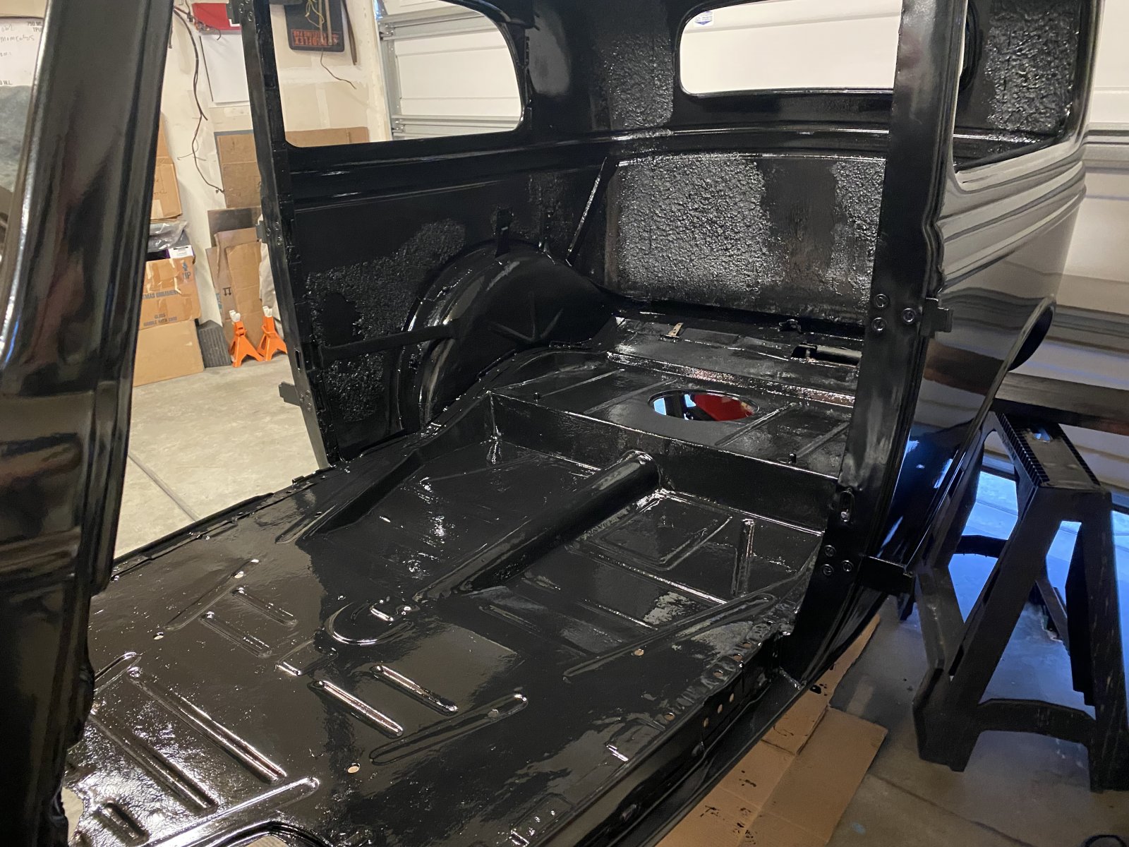

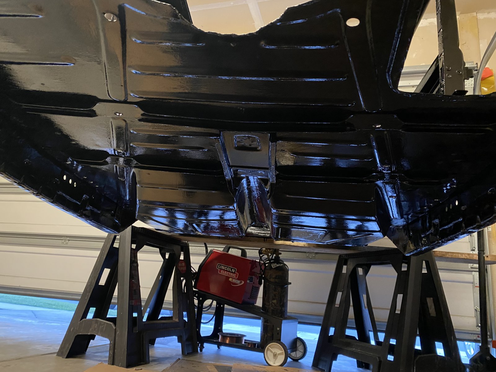

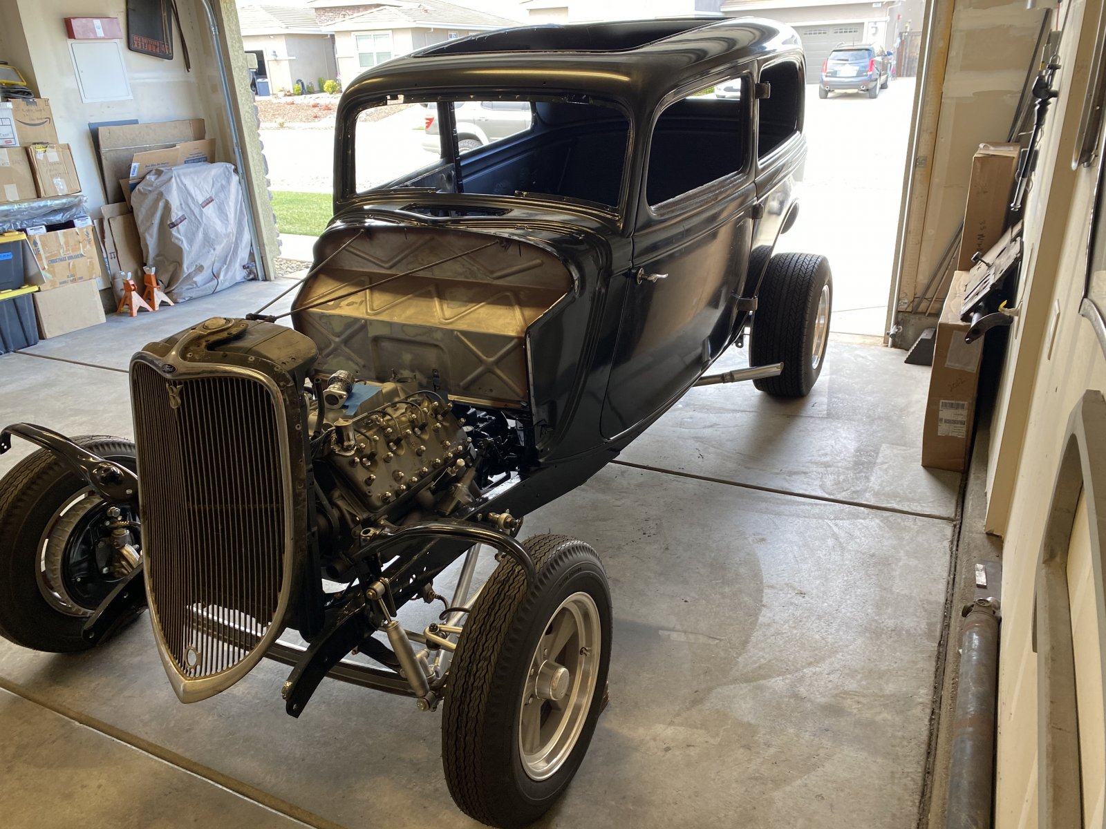

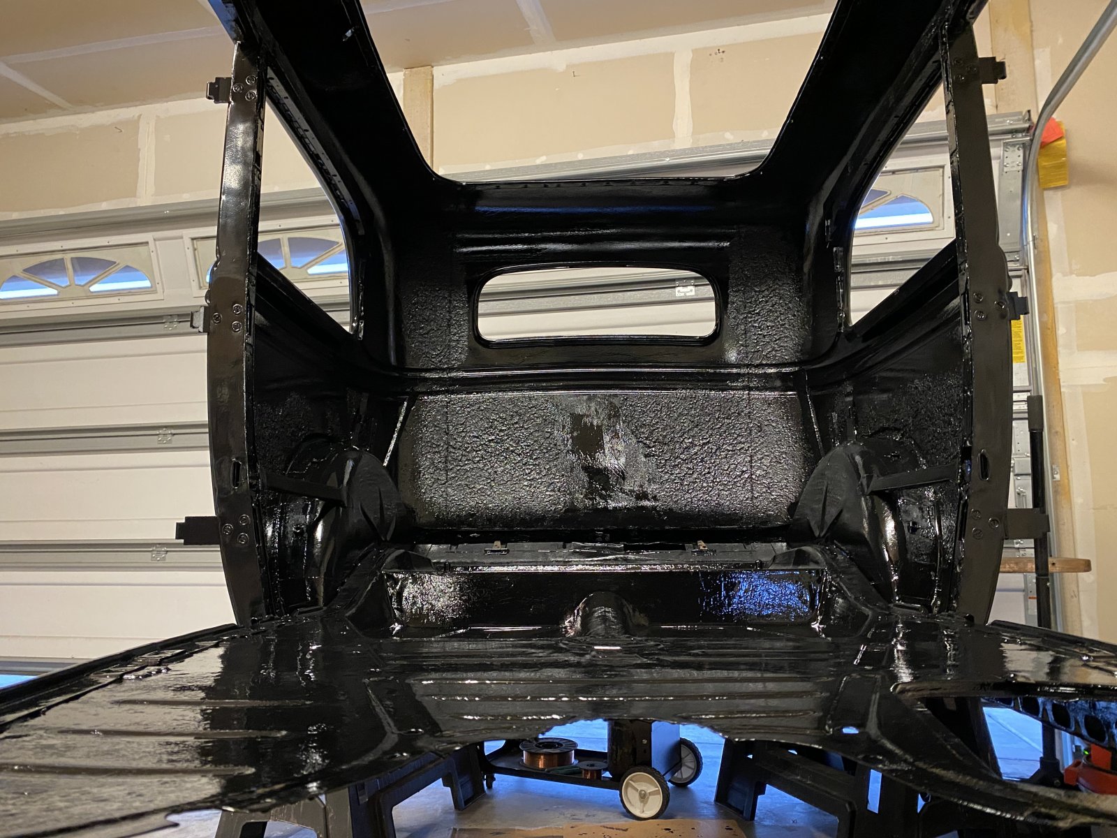

    Got the body inside and out all painted now!!!
    Just need to undercoat the floorboard on both sides and then I’m ready to put the body on the chassis! Yay!!

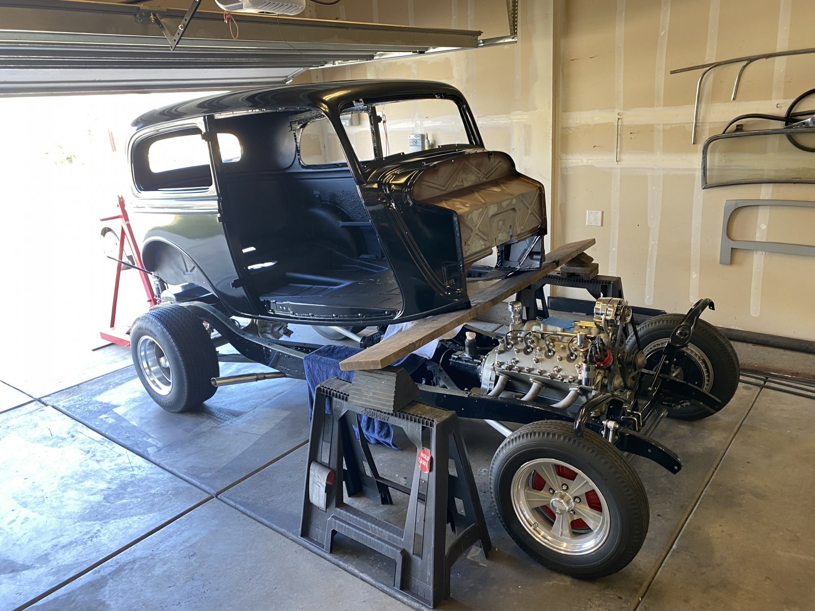

  15. 33Doll
    Posts: 1,378
    33Doll

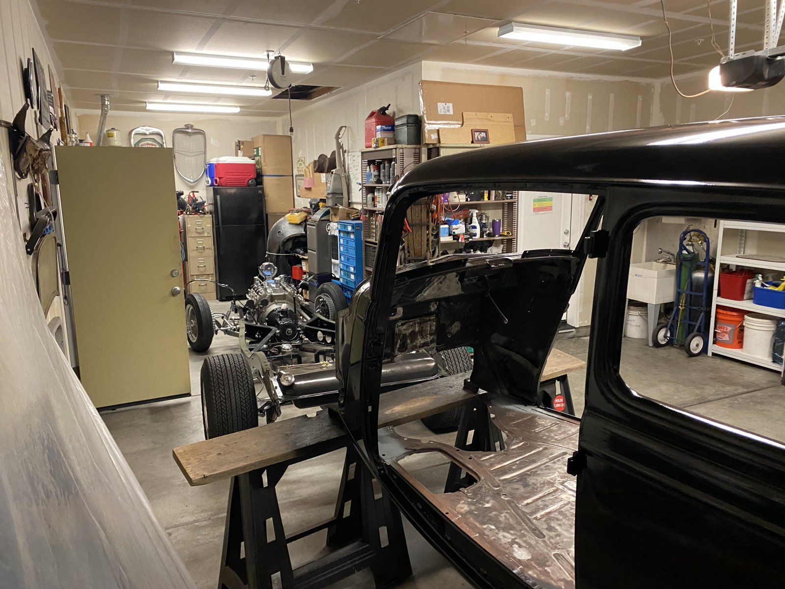

    E23342D9-E4F2-46C9-B63A-B2F934D4FCAC.jpeg 8379C9DA-45E2-4047-A136-6E236B598E9A.jpeg 8264C932-747B-4648-9A9C-0A5B7C64CBD8.jpeg 41E3D532-E6FC-470E-A99B-400AB04587AD.jpeg 056DB0AC-7FBA-456E-AC72-074E7E7F4ACB.jpeg 9CF999FE-4DCA-495B-B01B-EBA1BBAD3A22.jpeg E23342D9-E4F2-46C9-B63A-B2F934D4FCAC.jpeg 8379C9DA-45E2-4047-A136-6E236B598E9A.jpeg 8264C932-747B-4648-9A9C-0A5B7C64CBD8.jpeg 41E3D532-E6FC-470E-A99B-400AB04587AD.jpeg 056DB0AC-7FBA-456E-AC72-074E7E7F4ACB.jpeg 9CF999FE-4DCA-495B-B01B-EBA1BBAD3A22.jpeg Been Busy!
    The body fell off the saw horse in the last pic. Luckily it landed on the front body mounts, just a stress crack in the bondo.
    But now the 33'Doll
    Is "Rick-a-fied!

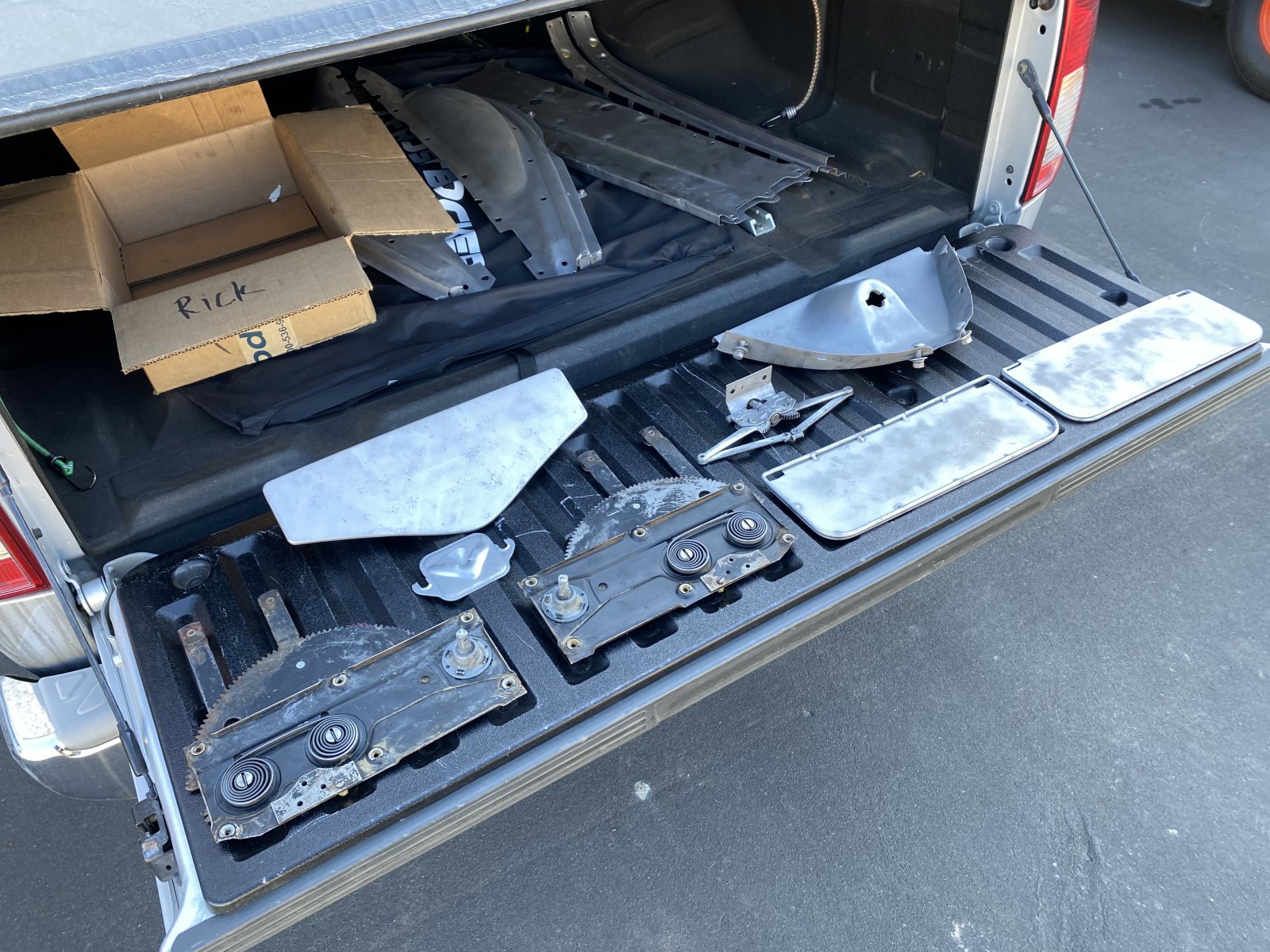

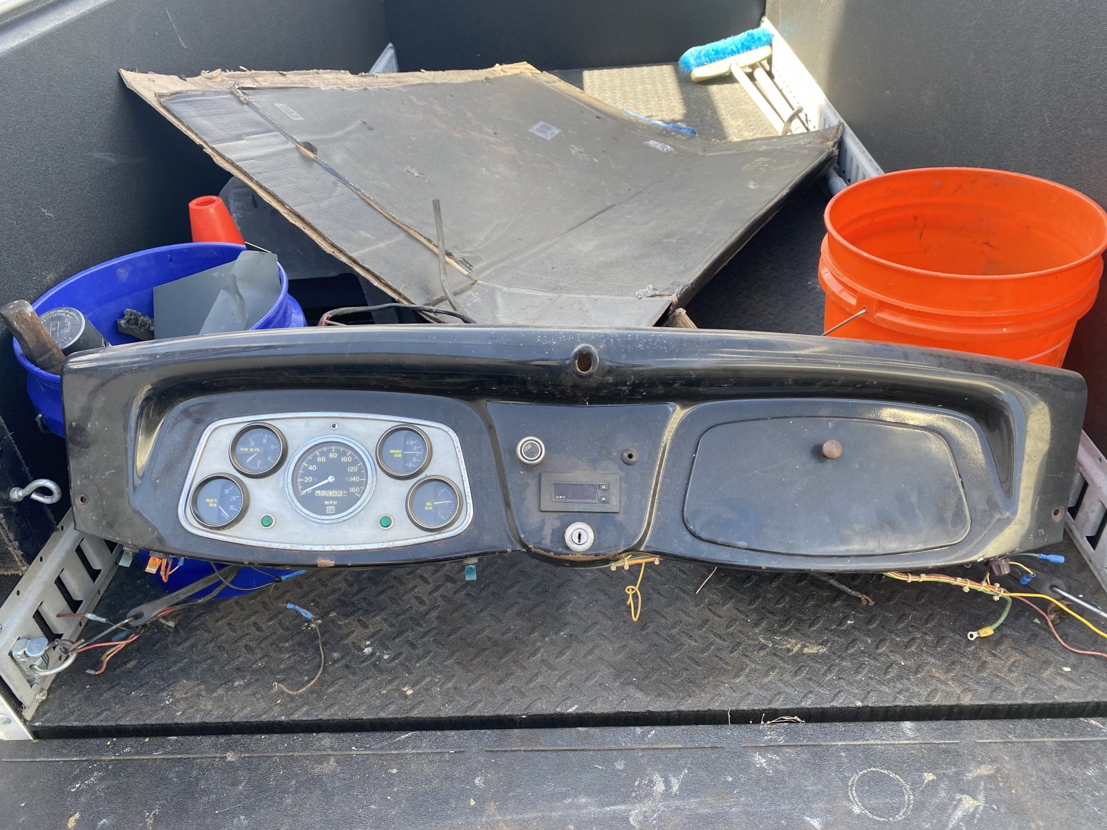

  17. 33Doll
    Posts: 1,378
    33Doll

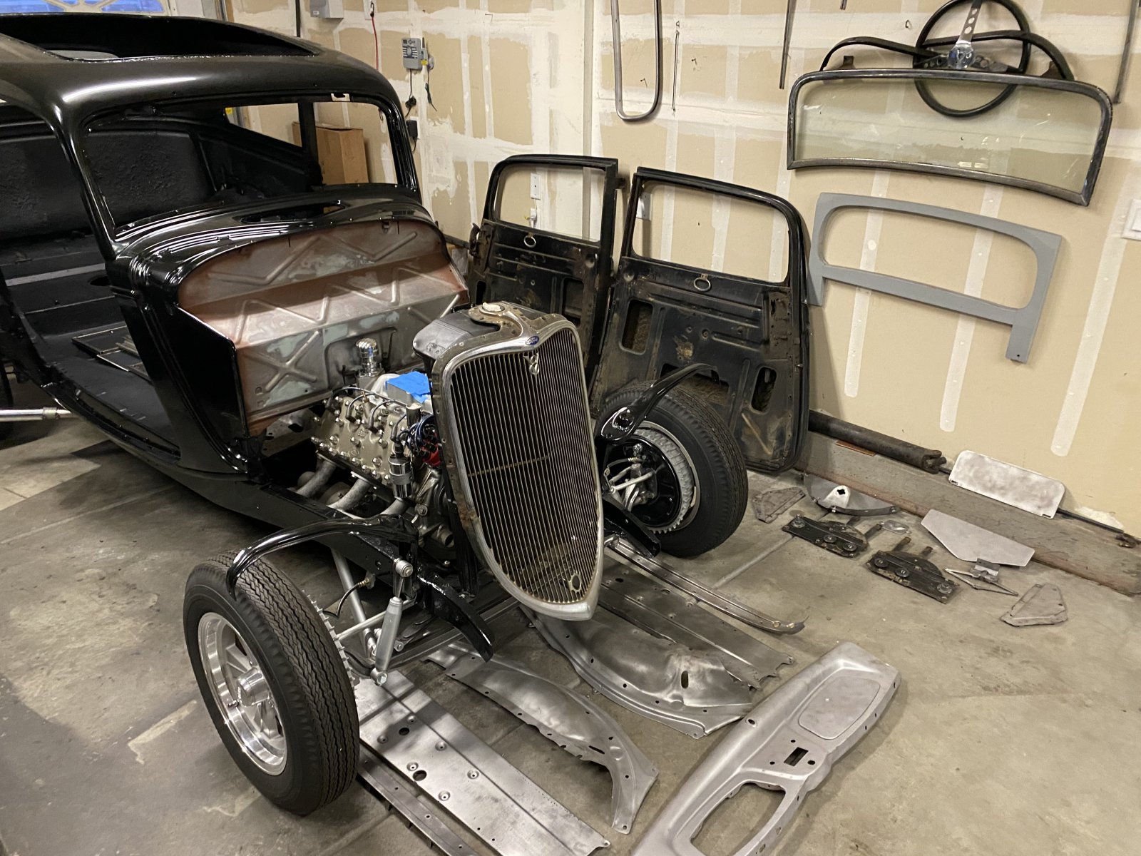

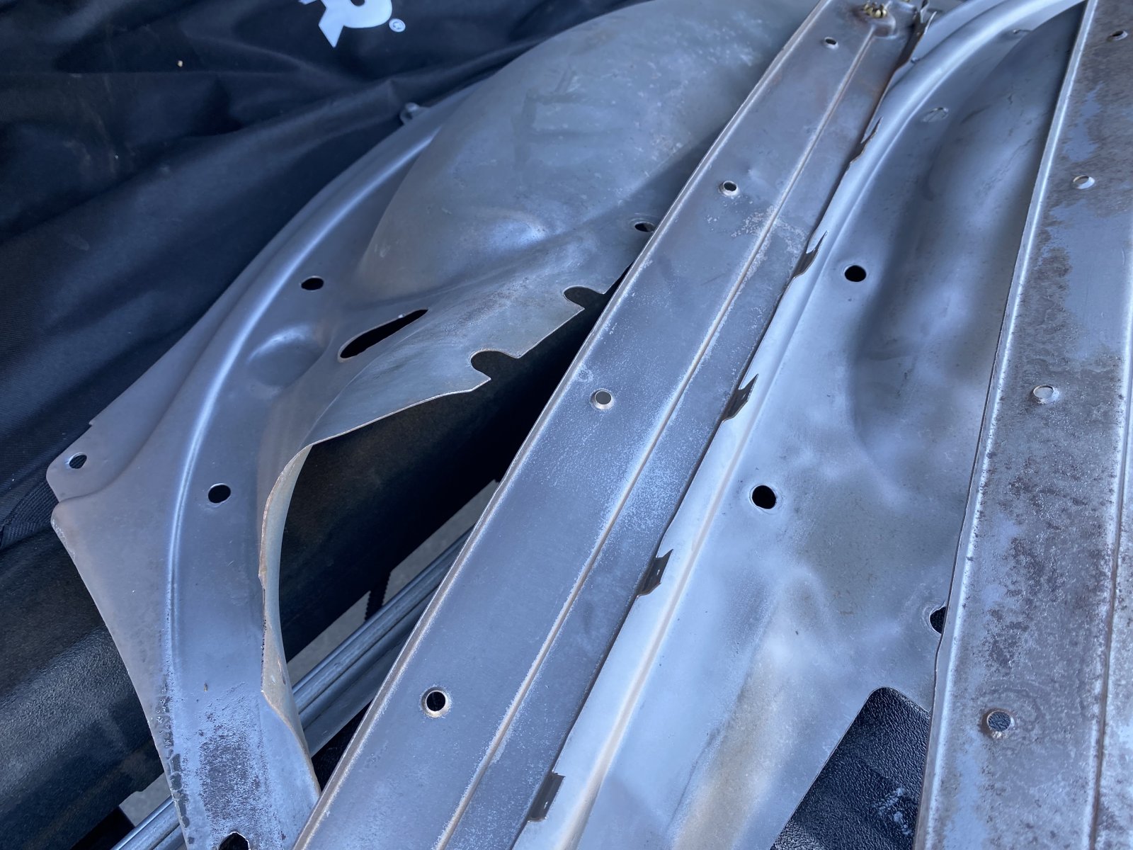

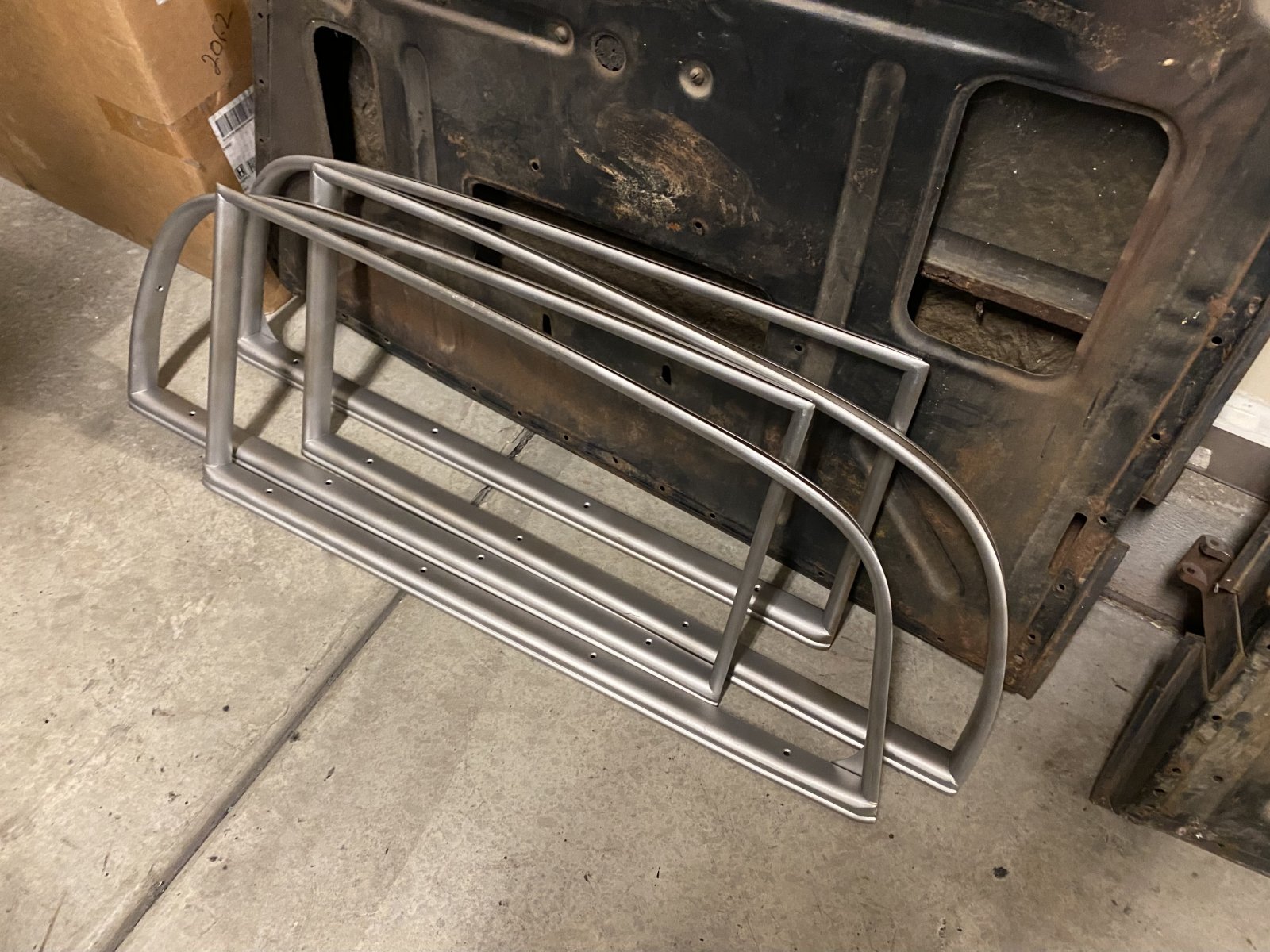

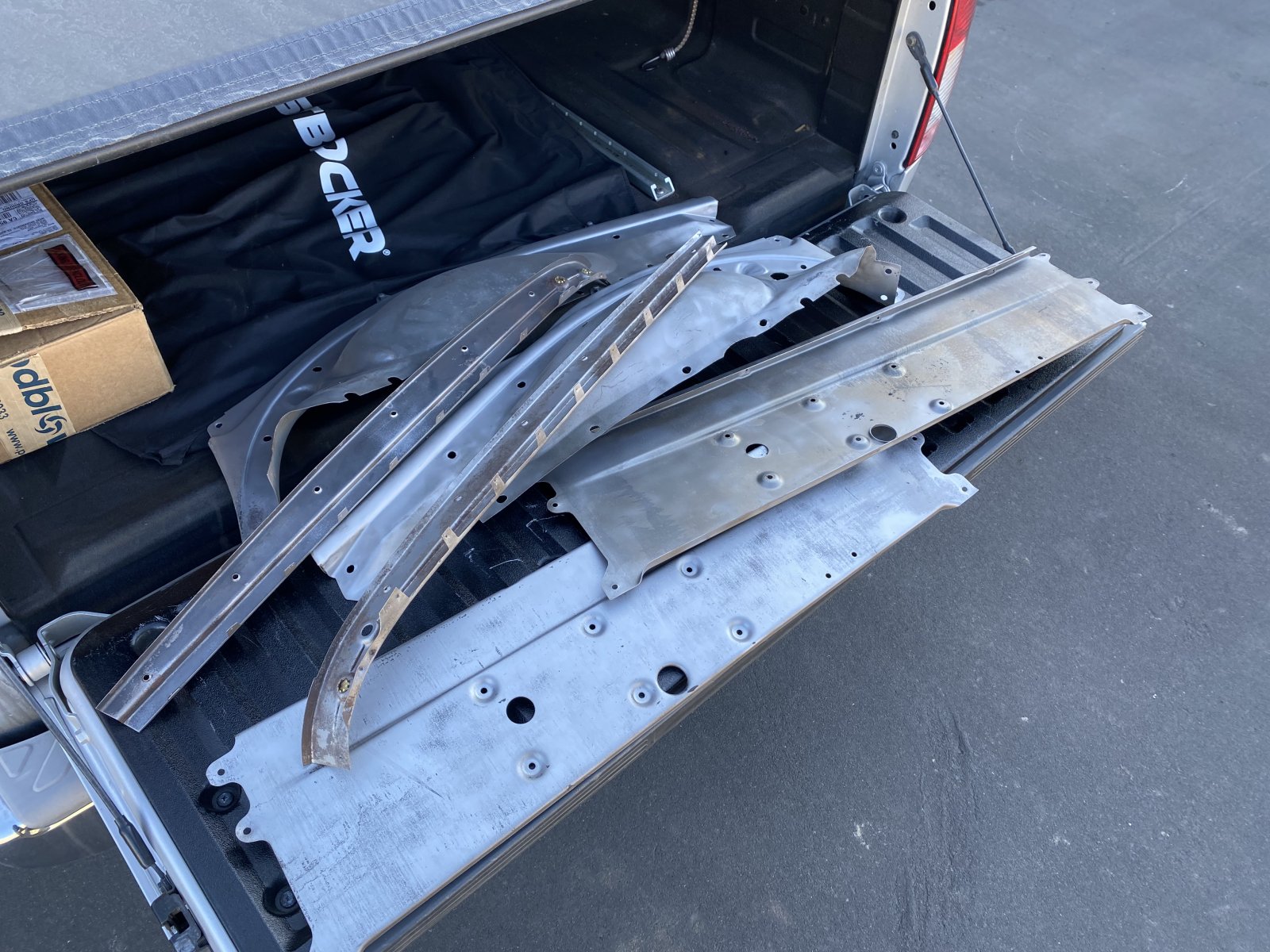

    On the Back stretch now! I do believe that the dashboard is the last thing to bead blast! I’m gonna have to to strip the doors, fenders, hood. But that should be pretty easy.
    It’s so cool taking apart this car and then finding brand-new metal and paint behind things!
    I stripped of gunk off of the windows regulators. And blast the paint off the door tins the intervennders and the rear pans that hold the regulators.
    And by golly those things were Zinc Plated back then!! The paint came off real easy and it was nice and Zinkee looking. The next thing is to finish the toe-board to set up the steering column and holes for the pedals so I have to strip the dash in order to mount it!
    Front seats are on order but back ordered till April at least.
    Getting excited!!!!

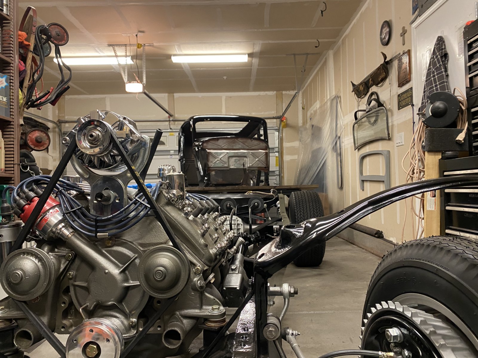

    CB5D4C81-0778-4F33-918D-FA03552172F9.jpeg D462963A-2E58-454C-A615-315E180FE5FD.jpeg 1BA96DDC-A7A9-41D6-92F7-9251A8875F5A.jpeg Everything is blasted!!!
    Just need to do some painting and wiring and a little bit of fabbing!

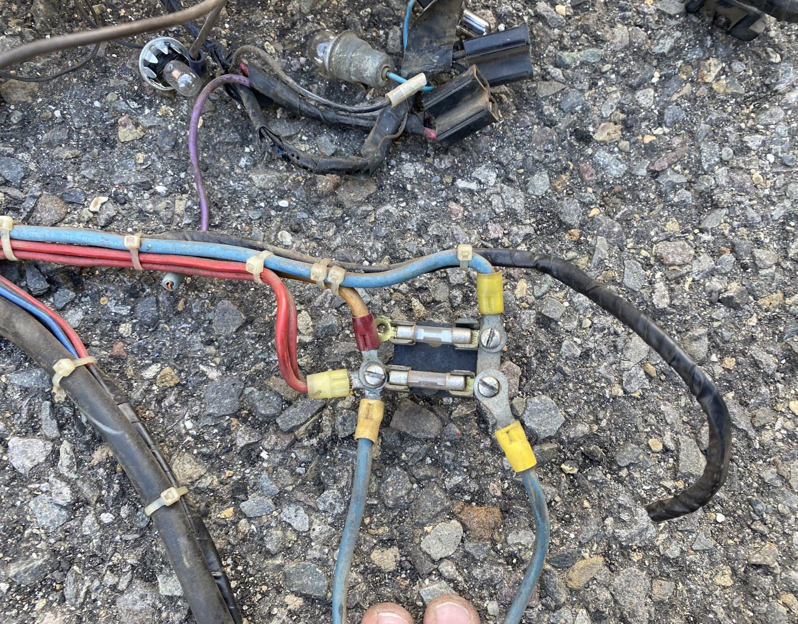

  25. 33Doll
    Posts: 1,378
    33Doll
    A2A9CEA6-F243-484A-A20B-811F658F02CC.jpeg FAF098E8-4F46-40CF-AE0C-A75B9A95C5A5.jpeg E76D2DFF-3F40-4A68-BA7E-9398962C0E8D.jpeg 9E2481B8-CBEB-48C2-99D4-10D93086B97B.jpeg So… I preserved my Pops Wiring.
    Should I Make a Shadow box for his Birthday?
    Look closely…. There isn’t a fuse box….except for two fuses….. Maybe I’m going crazy maybe not… but… Doesn’t it look like one fuses jumped in the other ones not even hooked up?
    So there’s no fuses in this wiring whatsoever??? All I see is a junction block heat sink. Am I missing something?
  26. Ford blue blood
    Joined: Jan 4, 2009
    Posts: 758
    Ford blue blood
    Nope, he used the fuse block as a junction block. Remove the dark blue jumper, move the yellow wire to the other fuse. The light blue wire the power source for the fuses?
    Given the outstanding work you have done to this point I would give serious consideration to re-doing the wiring to prevent a possible fire. Time to do this is now. Understand your desire to "preserve" the original aspect but losing it all because of a "glitch" in the existing wiring makes no sense to me. Yes, it worked for years but, Murphy don't care about originality.

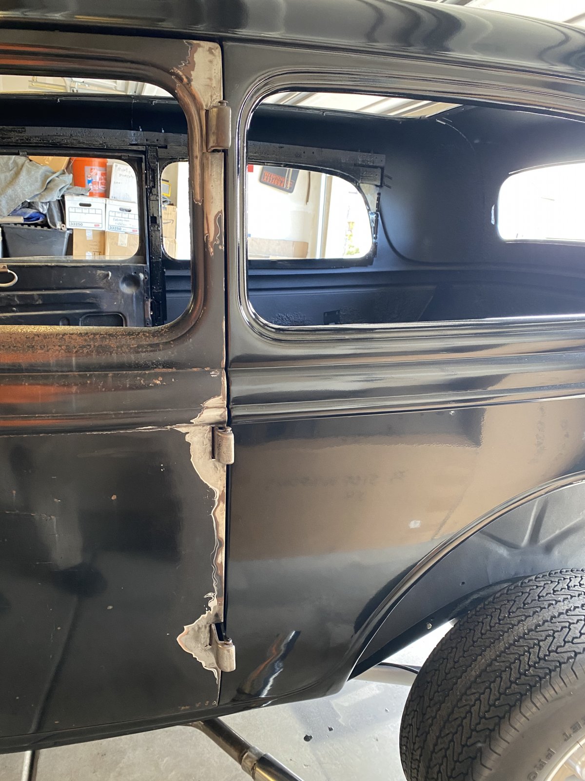

  29. 33Doll
    Posts: 1,378
    33Doll
    EBE7A5D0-71E9-4D34-A38B-5C618EDF37D9.jpeg 214909F0-03D7-43B9-8F80-9590EAA68DF5.jpeg 7CA64552-E7EF-4611-B003-4258283DACAF.jpeg D49D9CBB-9858-4774-BD2F-7D136DC3DED9.jpeg D72945B9-8AE2-4445-9243-FDCC83735BAA.jpeg C92681BF-6D23-4386-B173-5C404A46F304.jpeg 93C1475B-0FAD-4678-BF69-D77B70FD2EA2.jpeg 8F401E9D-34E2-430F-907A-1B305F6CAFCF.jpeg 3AD6B707-70F1-4C29-8CF2-EE5022FAB729.jpeg 82444B9C-9FC4-49A2-8BD1-E4B7FCAC571D.jpeg F7571A7C-5CB6-4254-8AAC-033A42567822.jpeg 5C6D7AE1-3A3B-4A35-955B-9155F6E04A20.jpeg BFF3123A-7157-425F-9488-E938CBCD8A8F.jpeg 6BE9796F-FD37-4E84-B00A-DBB6ACA9F1DB.jpeg Welp got the body bolted down. And it sits flat... thank God!! Didn’t get damaged from the fall!!

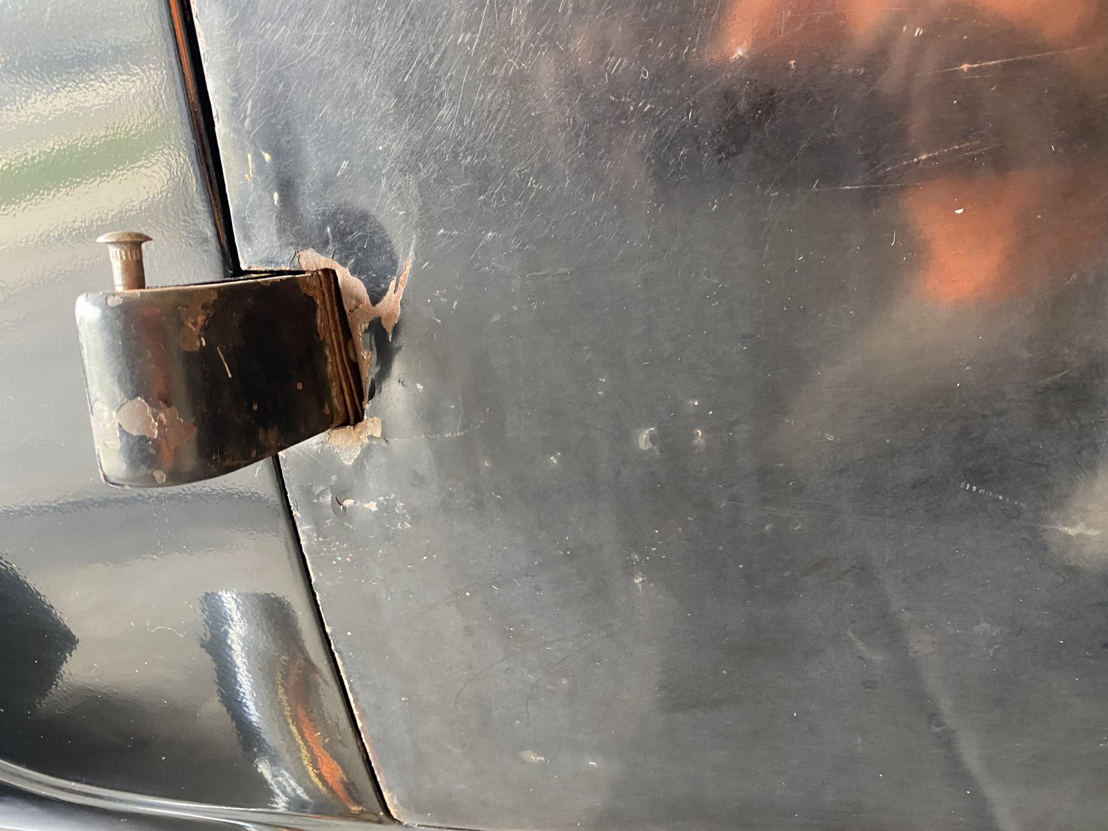

    And I got the doors as aligned as I'm gonna get them!
    they have just been sprung so many times the hinge area on the door is starting to rip on the skin so I'm gonna have to beef it up and weld the skin and add a filler piece, straight to the hinge, and then just fill it. Its been welded before. It is what it is…at least the doors shut now pretty good and the gaps aren't too bad. Just need to fix a few dents also. It won’t be perfect but the cars not perfect anyway.
