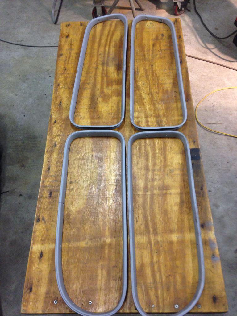

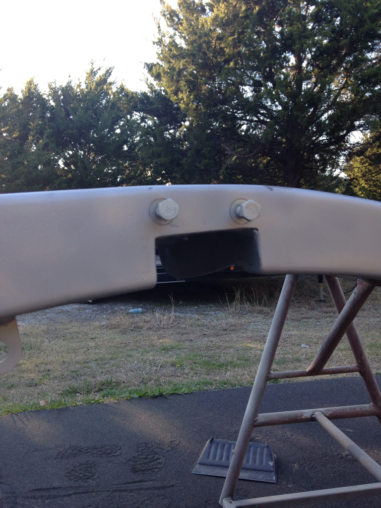

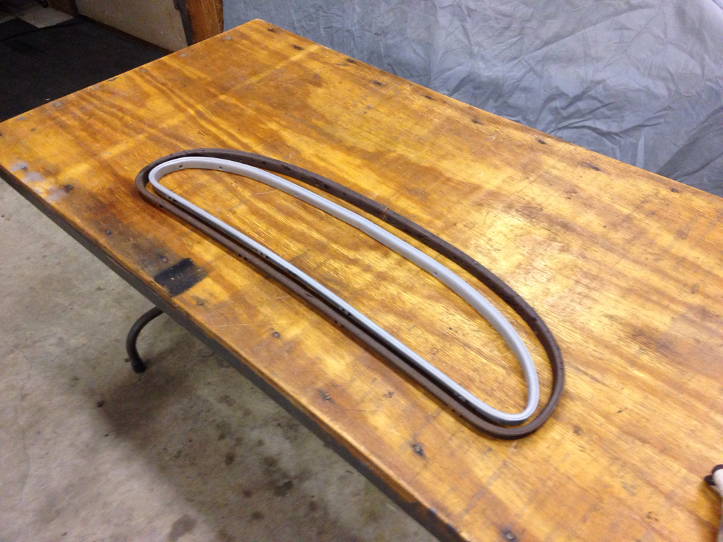

    I've made some progress here lately. I finished the doors and and cut the window garnish down to size. ImageUploadedByH.A.M.B.1453072686.519801.jpg . I only had 3 of 6 pieces of garnish between 2 bodies on the original purchase. Then found all 6 pieces on EBay. But when they arrived I noticed they were the same except the rear side pieces were 1 inch shorter. So I had to lengthen one side with the drop off pieces ImageUploadedByH.A.M.B.1453073145.801992.jpg ImageUploadedByH.A.M.B.1453073174.771439.jpg ImageUploadedByH.A.M.B.1453073213.652392.jpg not sure what they were originally on but close to the Eagle. Got finished sandblasting and coated with DP40 today ImageUploadedByH.A.M.B.1453073520.819769.jpg ImageUploadedByH.A.M.B.1453073562.369165.jpg ImageUploadedByH.A.M.B.1453073652.038831.jpg ImageUploadedByH.A.M.B.1453073734.257596.jpg ImageUploadedByH.A.M.B.1453073791.389248.jpg

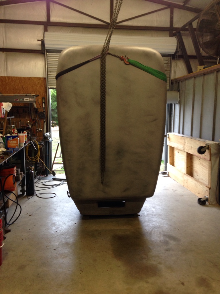

    I had also tossed around the idea of getting the hood louvered. Did some searching here on the ol' reliable HAMB and found the number for a source near me. Called Don Ross Fabricating and took it to him one morning and picked it up the next day ImageUploadedByH.A.M.B.1453573667.333734.jpg ImageUploadedByH.A.M.B.1453573700.568795.jpg ImageUploadedByH.A.M.B.1453573731.833932.jpg ImageUploadedByH.A.M.B.1453573935.267045.jpg got it mocked up without the center hinge

    Thank you gentlemen. Started removing the body for the last time. There's a little welding left and notching the frame for the rear end. All along I had planned on painting the chassis the same color as the body, but I've changed my mind. I think black will be way more fitting

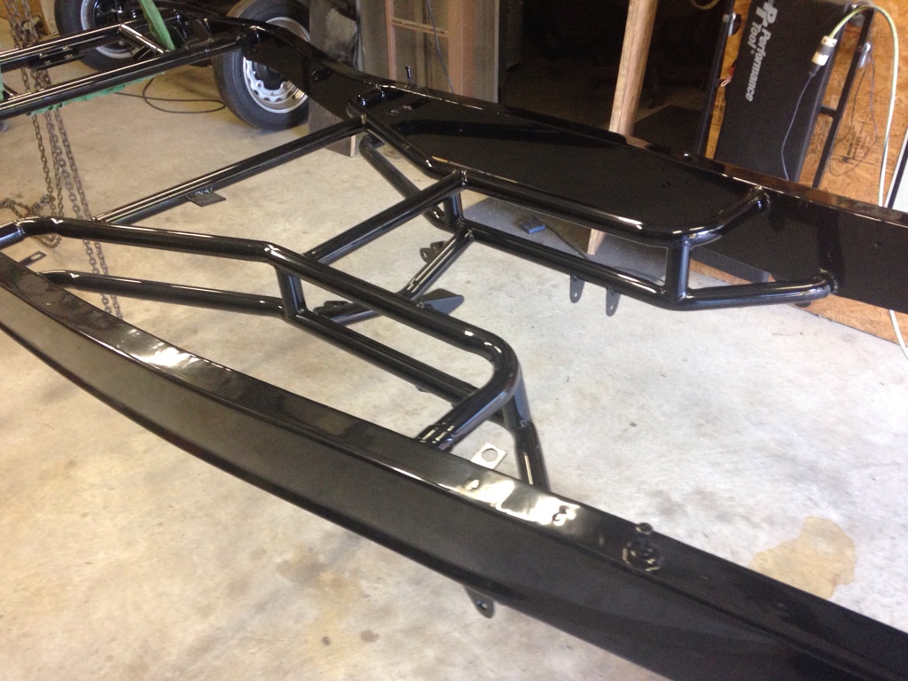

    Got the frame completed. Finished adding the front and rear notches and the dreaded sandblasting done. ImageUploadedByH.A.M.B.1456627948.930542.jpg ImageUploadedByH.A.M.B.1456627977.913348.jpg ImageUploadedByH.A.M.B.1456628001.328825.jpg

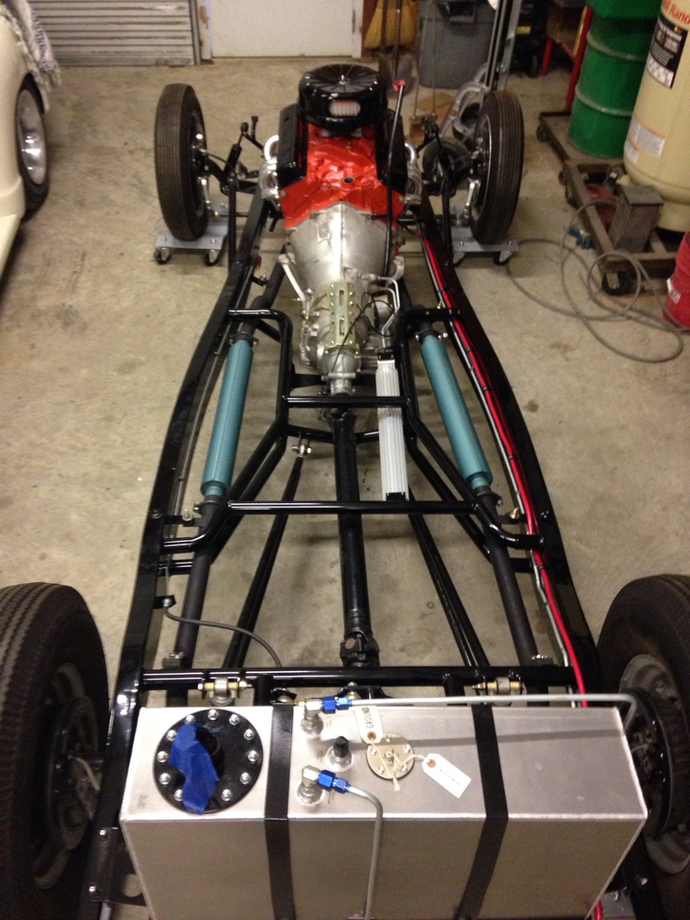

    Worked on the chassis all weekend. ImageUploadedByH.A.M.B.1457911583.112054.jpg ImageUploadedByH.A.M.B.1457911615.810975.jpg ImageUploadedByH.A.M.B.1457911634.977659.jpg .
    Some of this build was based on hope? I used this trans cooler hoping it works well? Anyone used this set up before? ImageUploadedByH.A.M.B.1457911808.111183.jpg ImageUploadedByH.A.M.B.1457911828.611453.jpg

  17. I'd be interested to see how that trans cooler works. Do you plan to runs a trans temp gauge? Chassis looks great!
  18. bigheadbaxter
    Joined: Feb 18, 2007
    Posts: 229
    bigheadbaxter
    Good question. I really hadn't planned on it. It's a stock converter and trans. I'll be lucky if the stock 350 even makes 250hp. I really think it should cool fine according to what I've read.

    I ran a cooler like that on my 39 ford with a turbo 350. Mine was smaller, worked great.

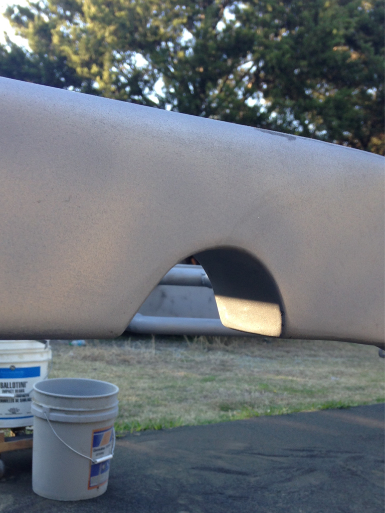

    Well I finished spraying the skin of lizard inside. Both the sound deadener and the heat barrier. And while avoiding sanding I jumped on something a little lighter. ImageUploadedByH.A.M.B.1461022369.149646.jpg ImageUploadedByH.A.M.B.1461022407.631553.jpg

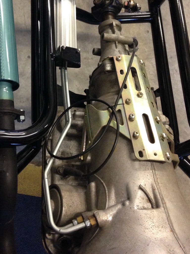

    Just a concern with the 24 inch rigid tranny cooler lines to frame mounting...
    Will there be some hose between?

    Thanks Mike. Are you thinking I need more flex? Or cushion between the two lines? Do you think there will be movement there? I was thinking there would be very little if any. I can move the lines a little with my hand. I took a pic this morning before I left ImageUploadedByH.A.M.B.1461070510.467990.jpg

    A newer factory line would have about a 6" section of flex line in it somewhere. prevents work hardening cracks and such.
  28. i hate rubber lines and avoid them if possible. i might be tempted, if it was mine, to mount the cooler to the two shifter mounts.

    Point well taken my HAMB brothers. I may get fancy and work in some more flares and braided hose and fittings
