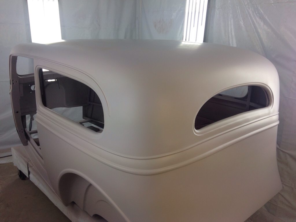

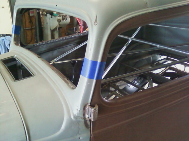

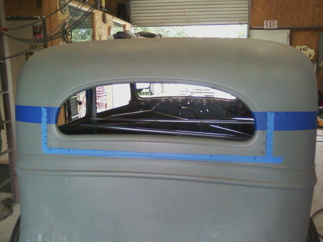

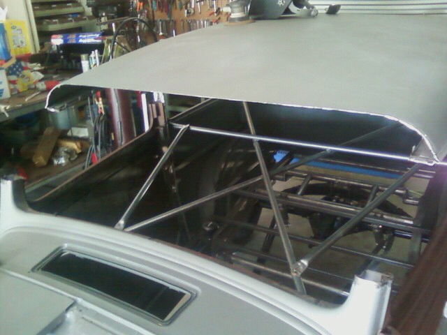

    The next step was one I've never attempted THE CHOP! I read all I could and talked to people that had successfully done it. It was time to make a move. Marked it off with 3in tape, I had it figured to only take 1-1/2in. Out of the back window ImageUploadedByH.A.M.B.1410305471.446396.jpg ImageUploadedByH.A.M.B.1410305663.479888.jpg ImageUploadedByH.A.M.B.1410305714.063901.jpg . I cut it right below that A pillar body line. Chopchop

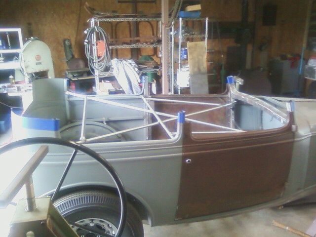

    Finished welding the lid back on ImageUploadedByH.A.M.B.1410311313.698646.jpg ImageUploadedByH.A.M.B.1410311367.315965.jpg

    That chop doesnt look half bad. Pretty cool.

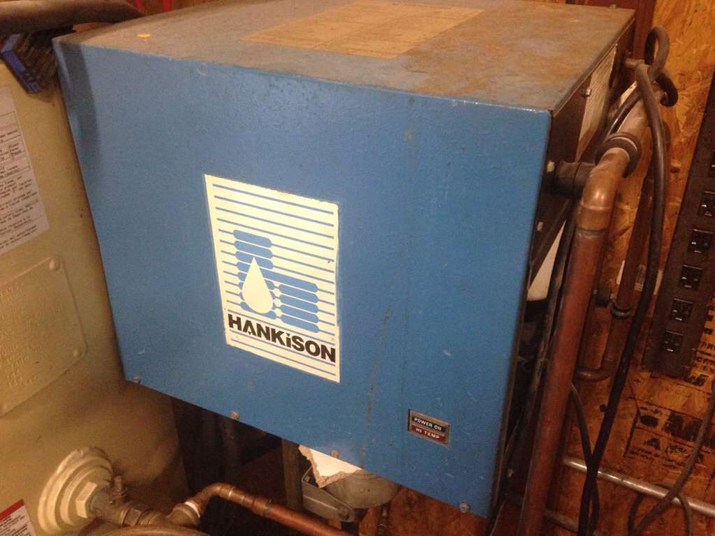

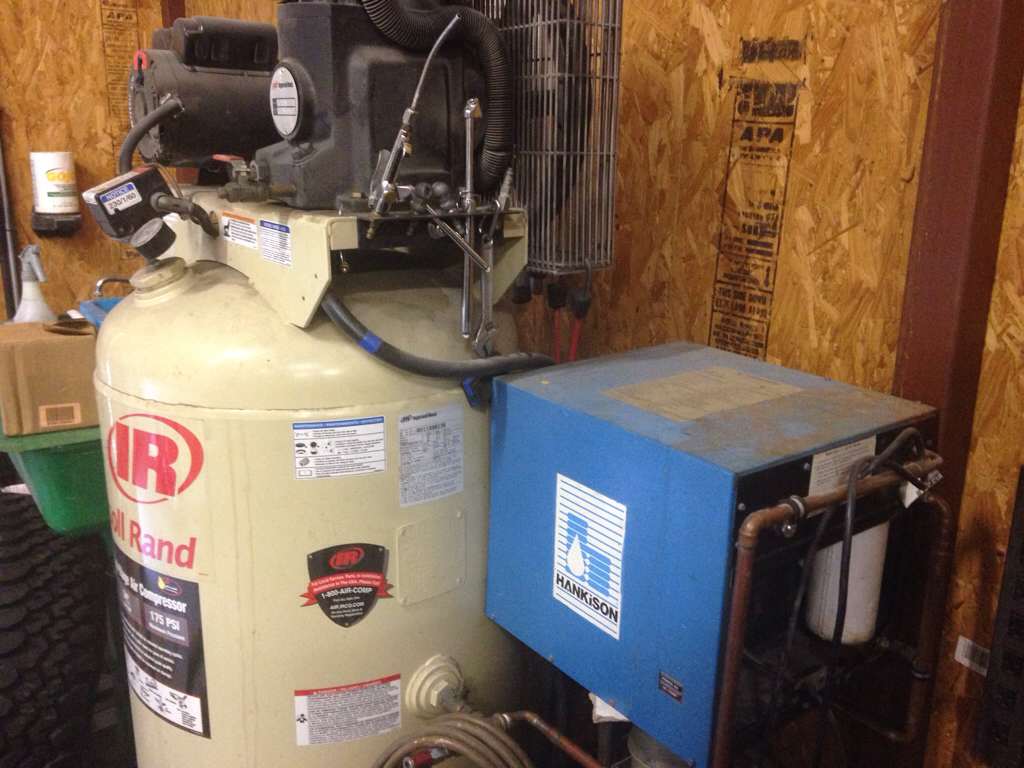

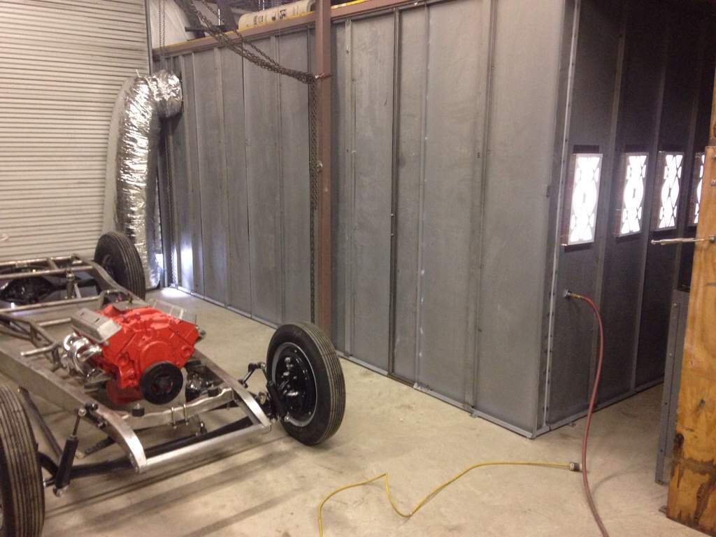

    The saying ' Being at the right place at the right time ' holds true with me. I just try to be resourceful , if I see something I think I can use now or down the road I will put forth the effort to drag it home. Shit just cost to much, especially steel. The Liebert I spoke of in a previous post had some discharge air riser panels on top of them, they were being scrapped and I spoke up and said I wanted them. Not only was I saving the customer money I new I would put them to use someday. So once I finished the body work on the body shell it was time to put it in primer. I've sprayed in the shop before and it just makes a mess of everything. Then it clicked-I remembered the panels ImageUploadedByH.A.M.B.1410353364.851546.jpg ImageUploadedByH.A.M.B.1410353395.201305.jpg ImageUploadedByH.A.M.B.1410353421.801056.jpg ImageUploadedByH.A.M.B.1410353461.151202.jpg ImageUploadedByH.A.M.B.1410353484.834624.jpg ImageUploadedByH.A.M.B.1410353532.318028.jpg I had stored in my steel rack. I'll just make my self a booth. That's a fan from a 4 ton split system out of the air handler, I thought if it moves air for a whole house it will be perfect for one room. It creates the perfect cross draft

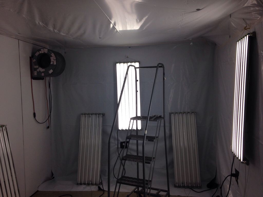

    I have less than $200 in the booth. I found the lights on CL , was just kinda strange I was told they came out of club they have a mirror back and 6 bulbs per fixture. I bought 6 @ $10ea. The plastic is black on one side and white on other. The ImageUploadedByH.A.M.B.1410355283.339933.jpg ImageUploadedByH.A.M.B.1410355297.590177.jpg description said it was for grow rooms ?IDK. anyway I found it on eBay for $40 bought some roll on enamel and threw it all together. Another trashed find was this refrigerated air drier I carried home and repaired it. It defiantly saves the life of my pneumatic tools needless to say makes spraying ideal.

    When you did the chop, did you lay the A pillar back a tad or extend the roof section a bit to aline the A pillar again?
    Would like to see pics of that if possible, as I'll be doing a chop on my 33 coupe soon.
  22. bigheadbaxter
    Joined: Feb 18, 2007
    Posts: 228
    bigheadbaxter
    I expected this question to come up. I really wasn't sure what to do at first, since I had already filled the roof opening. After heavy thought I decided to cut the roof and move it out to the A pillar since I had the donor car roof section. I felt that leaning back the A pillar would mean more work on the precious Chevy doors. I can't say I would do it same if I had it to do over. But I am pleased with the out come. ImageUploadedByH.A.M.B.1410362215.253439.jpg this is the only pic I have. The roof was so rigid before cutting to lengthen. after welding completely I had some shrinking to do.

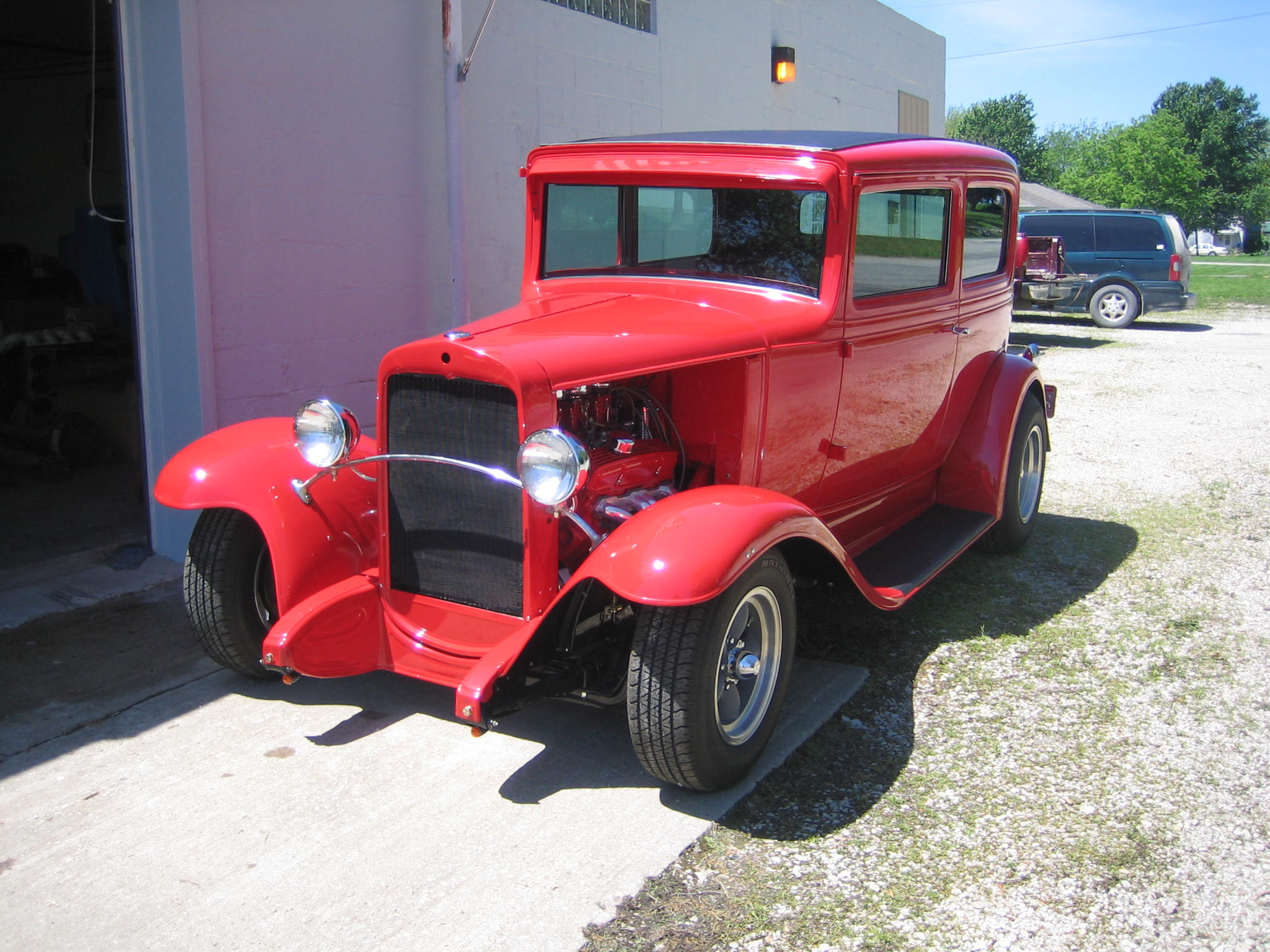

    Chevies of these years don't normally have the "look". I think it has a lot to do with the front springs and frame. Yours without a doubt, has the "look"! The chop is well thought out and executed, the stance is just right, and those rear wheels tucked in makes it look so mean. What a great looking car, and not one you see too often. Well done!

    What a nice build, car looks great, and the build it yourself blast cabinet and spray booth came out really nice. Bob

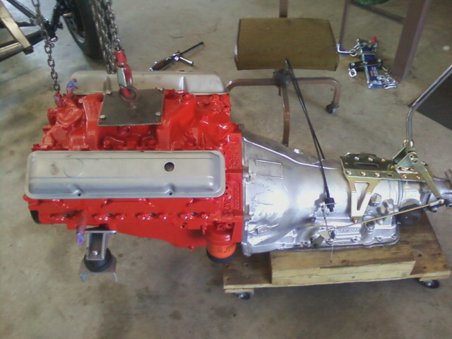

    Thanks again guys for the compliments. This place called the H.a.m.b can be intimidating, that may be one of the reasons it's taking me so long to get involved. I knew I was eventually gonna have to go off topic, and that would be with the 350/700 combo. Yes I did it. Looking for reliability and lower cost, don't get me wrong big blocks and vintage speed parts are the coolest. But I plan on going the distance in this car. I will apologize to all the haters. Ok since I got that off my chest let me show you some more pics. With the body off AGAIN I got a chance to work on exhaust, brake lines and fuel system ImageUploadedByH.A.M.B.1410387258.314547.jpg ImageUploadedByH.A.M.B.1410387275.799031.jpg ImageUploadedByH.A.M.B.1410387322.498199.jpg ImageUploadedByH.A.M.B.1410387352.597923.jpg ImageUploadedByH.A.M.B.1410387373.081742.jpg ImageUploadedByH.A.M.B.1410387419.664529.jpg that is a tri 5 air cleaner that I cut the bottom out of and welded in one that fits a 4 barrel to the top side of the lower half. So I guess you could say it's channeled to hide the new edelbrock

    I too really like the way that Chevy body sits on the ford chassis. I'm guessing the Chevy body is a bit wider than the ford body and even more so at the rear, Judging by some other pics here.
    That rear wheel just looks so right to my eyes. Body sitting low and channeled a few inches at the rear wheel tucked in a little and the quarters didnt need cut and reworked. Maybe its just me, but when the tires sticks out and the tire rides over the wheel well lip it really looks like a major fuck up. Ruins the looks of the whole car for me.
    You know the only time a ford really looks " Oh so good" is with a whole bunch of work! When the frame gets stepped at the rear, wheel wells get deeper tires tucked and then the 1/4 is cut and the lip moved up in the quarter. That's a lot of work and if you notice only the highest of high end cars have this work done.
    I stuck some Chevy rear 1/4s on a ford body and on a ford chassis. To get every thing right I had to raise the rear kick in the frame a fair amount. I noticed that you said you raised / leveled the rear tails too. That's not that much of a job to do but its one of those things that make the general public say that it can't be done - HA!
