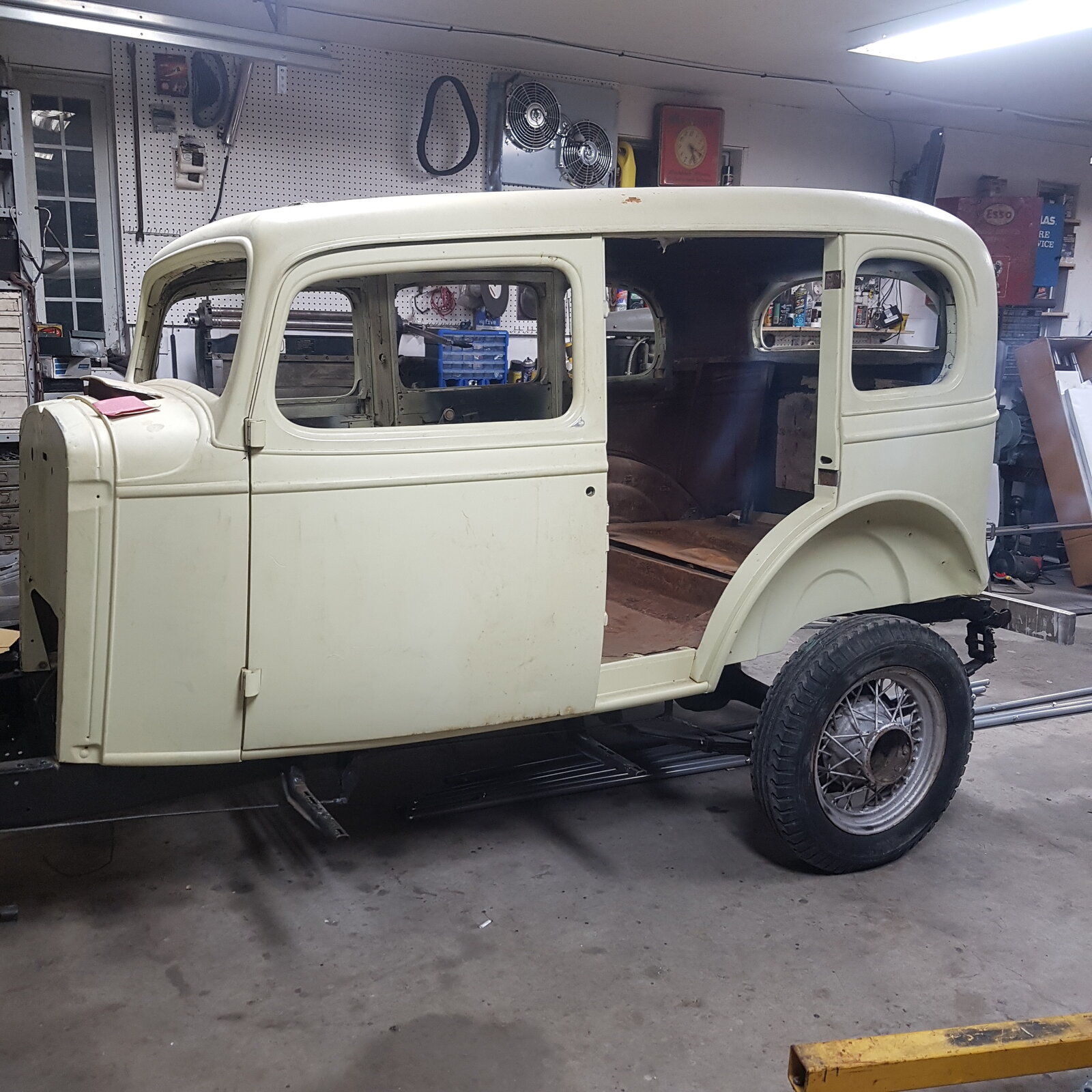

    Anyone have any reference pics of a 33 chevy sedan chop.. i habe a 33 and the roof line is way too tall.. thinking about taking a few inches out, would just like 20210605_184851.jpg to see where some guys have made their cuts and splices to give me and idea

    That is beautiful!! If you post a direct side profile maybe one of the photoshop wizards can photochop it for you. I’d give it a shot.

    I'll see what i can do for pics.. i am thinking 3"

    if you chop it slant the A pillars..it will save you a lot of cutting and welding , you can drop it straight down and dowel the wood like a model A ...i made steel plates and also bolted the wood together..

    A guy near hear chopped one about 1 1/2 in front and 2 in the rear without changing the size of either front or rear glass. Looks great. I think his was a Master though.

    Theres no wood left in this old girl.. the previous owner took it all out and used tube

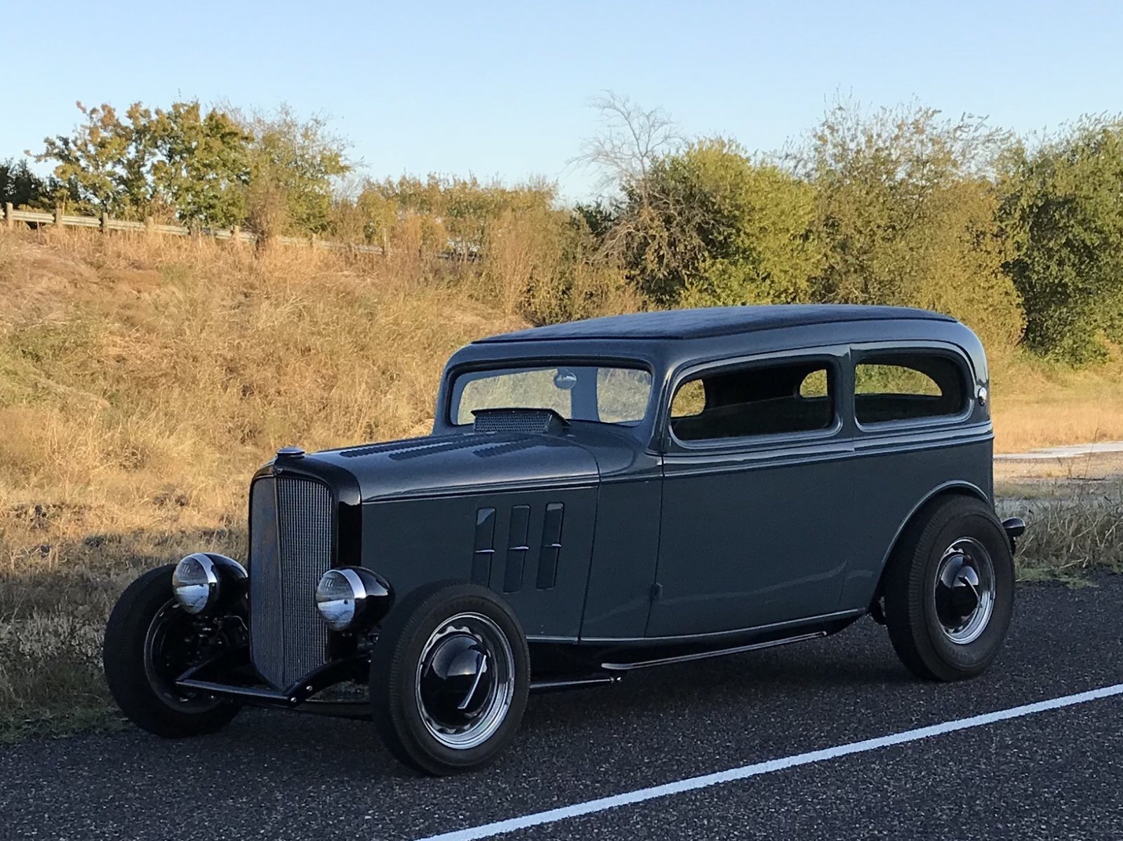

  11. Nice looking Chevy....Here's how it might look with a mild chop...

    Now thats what I am going for

    The biggest issue I see is WOOD .Bow Ties built like stagecoaches , wooden structure until very late ‘36 , and all of ‘37 .

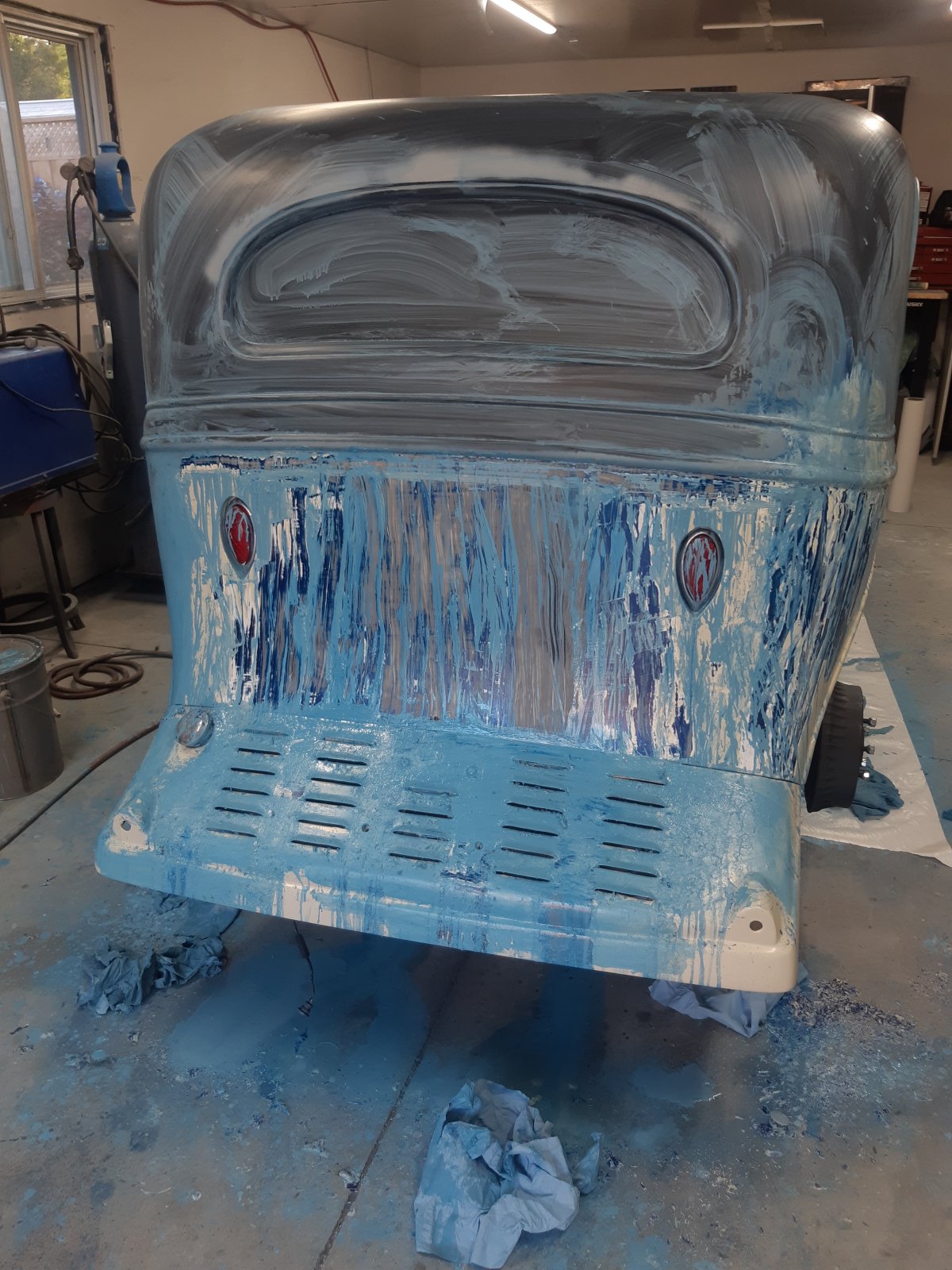

    I like the Vannila color as well. It was Cool Vannila last week. I got a weak batch of activator for the single stage and it never dried completely ... had to wash it all down.... 20210625_100845.jpg 20210624_132212.jpg 20210703_195039.jpg 20210703_195234.jpg

    Yessir. 3” around and 1.5” for the rear window

    Your car would look great with a good chop, BUT there is a lot of wood in those old chevys that is why you don't see to many of them. I would think you have to take the wood around the door and windows out ,chop the steel body and then cut the wood at the joints to fit it all back together BIG JOB with all the wood

    The original builder took all the wood out in my car and replaced it with steel already
