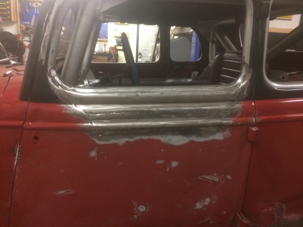

    Another piece to the puzzle...
    @603norm was kind enough to donate a passenger rear door from a Fordor to help fix the drivers side.
    I was a little reluctant to use it because it was a pretty decent door (hope nobody reading this was looking for one!) and I wasn’t sure if I was clever enough to make it fit.... But I think it’s turning out decent:

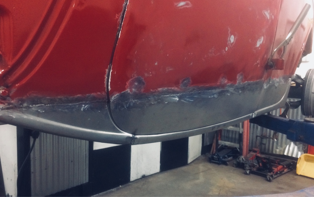

    Final patch panels arrived, along with 12” of snow...
    Overall no big surprises with the body... but I now remember a few other aspects that need to be fixed. Not sure if I should have the gas tank cap exposed, or lower the tank and have to open to trunk to fill it?
    They certainly didn’t forget the red wrench with the rear end of the car either. Of course I cut the top weld where the trunk met the tail piece, and now the “deck lid” is too short.... Looks like they added an angled filler piece at the bottom.
    Should I pound out the dent and weld on another filler, or just make a new deck lid? Planning to make it easily removeable this time.

    I think you answered your own question add a 2" piece and you're done...what about repairing the sail panel and moving the filler neck slightly back so it's a just a hole in the lid? that way the basic shell is mostly original, you retain race car flavor, and don't have to open it every time you re-fuel
