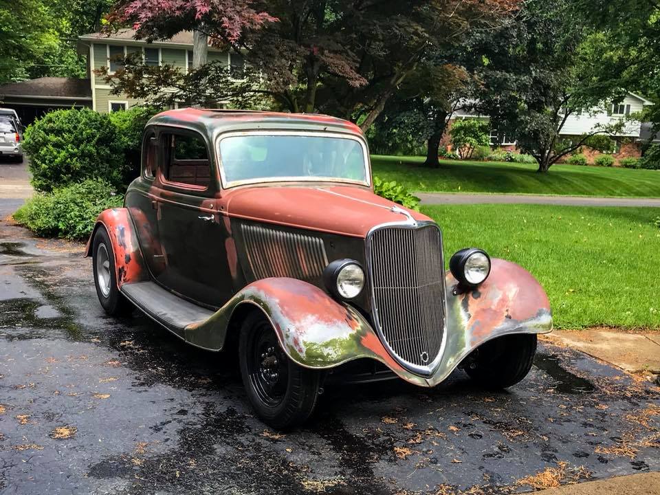

    I've had this car for a little bit, so it's probably time that I pull together a build thread to document the work......
    I started keeping an eye out for a Model 40 coupe last year. I'm impartial to a 3w or a 5w, but a '33 was higher on the list than a '34. My main goal was to find a nice car that didn't need a lot of repair work, allowing me to get started on the things I wanted to do.
    A friend of a friend had his '33 5w for sale in the southwest. After a call to get the details, I knew the car would be the best one I could find. Aside from some emailed photos, the first time I laid hands on it was when it was unloaded from a carrier (I bought it sort of sight unseen).
    Supposedly, a Southern California car, it had been updated to an Olds V8, Hydramatic, and an Olds rearend on parallel leafs in the '60s, before moving to the southwest. The front suspension consisted of a dropped stock axle, split wishbones, and a F1 steering box. The body has never been repaired, nor did it need any repair work. The only alterations were a cut firewall to accommodate the Olds.
    It was last configured for a sbc and a NV1500 trans. The x-member was nicely repaired from the Hydramatic, and the Olds rear end remained. For anyone who knows Model 40 stuff, grilles can be a money pit, and this car has an extremely nice grille, with what I believe is original chrome.

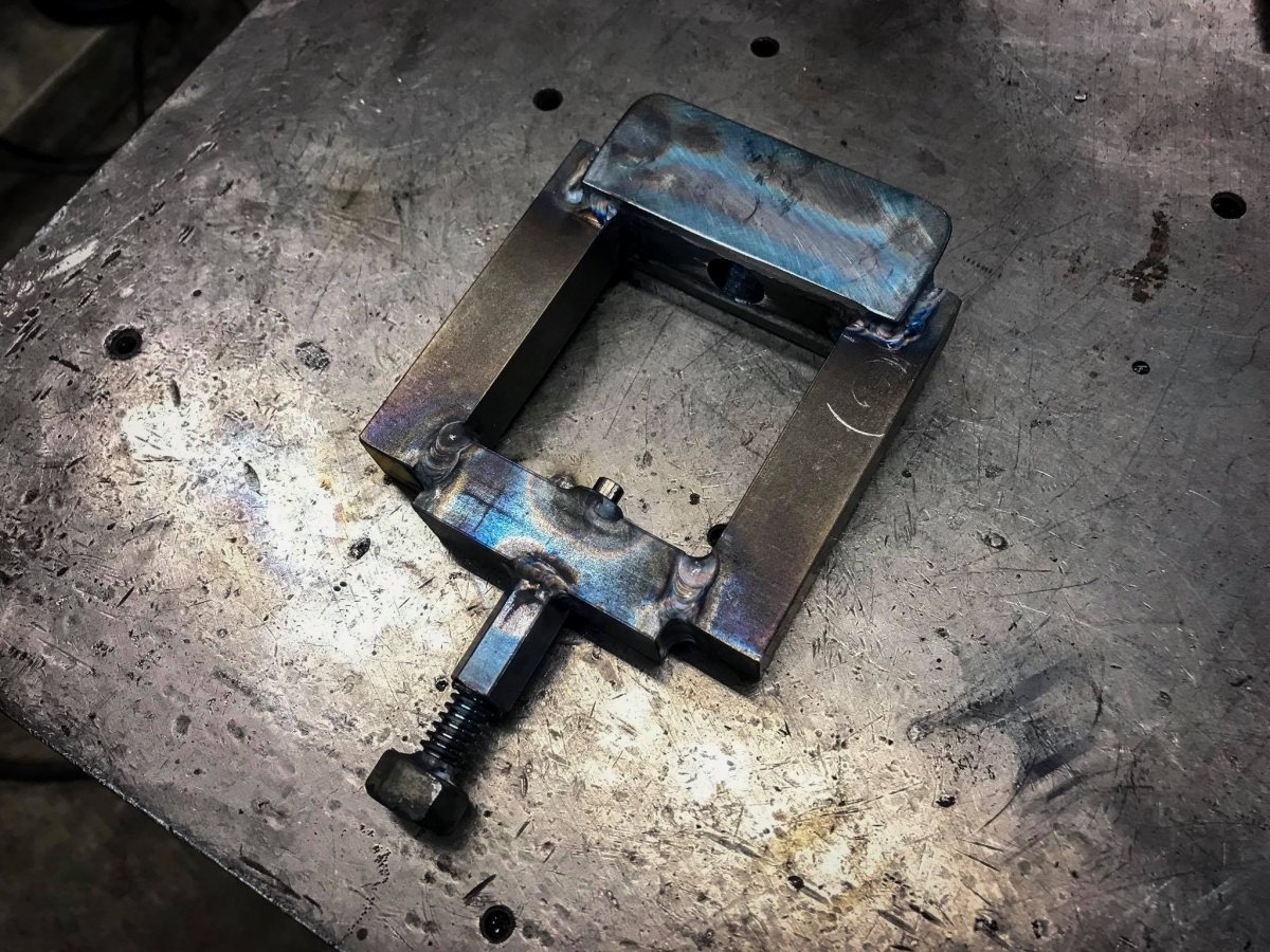

    '33-34s seem to often suffer from door misalignment to the quarters. I followed some tips from Bill Ganahl to cut and offset the hinges to correct the issue. I measured the offset on each door, and got to work.
    First, I fabbed quick and dirty, but heavy duty, hinge pin press. All but one pin came out with ease. The one that put up a fight had apparently been broken inside the body side hinge for some time, and had to be drilled.

    Once the hinges were off, I clamped some blocks to my welding table to act as a quick fixture. It kept the length (in and out flushness) of the hinge the same, and allowed me to offset the soon to be cut pieces with shims of the necessary amount. With the pieces clamped in, I TIG'd them back together, dressed the welds, and rehung the doors to confirm good door alignment.

    Great tech and pin removal tool.
    I just did the same thing on a 5 window, I converted 4 door hinges to 5 window coupe. I ended up cutting the completely apart as you did.
    CTaulbert, kidcampbell71 and loudbang like this.
  12. Nice project-again!
    I like the hinge pin press. Is that a section of pin punch in the tool, that the drive bolt pushes against?

    That's actually the end of the acme screw turned down to slightly under the OD of a hinge pin.

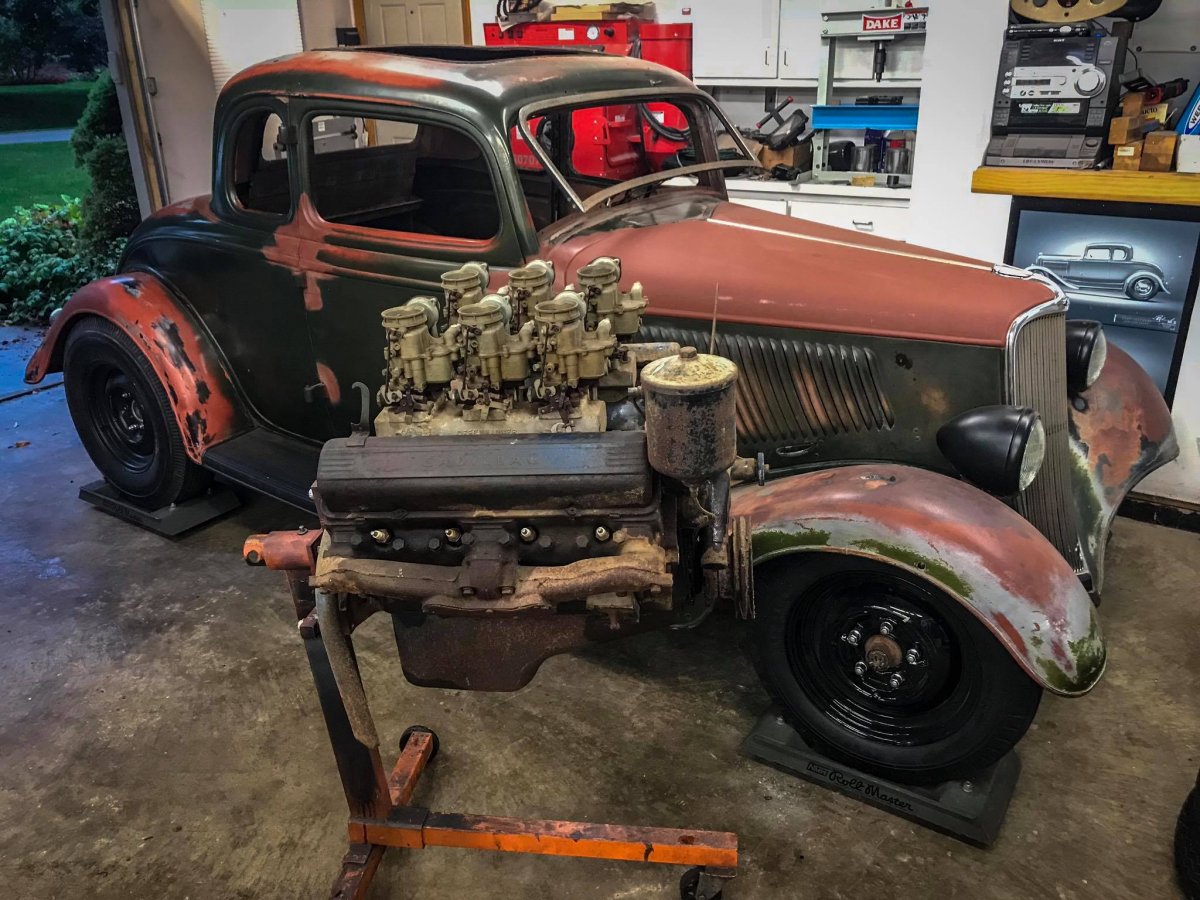

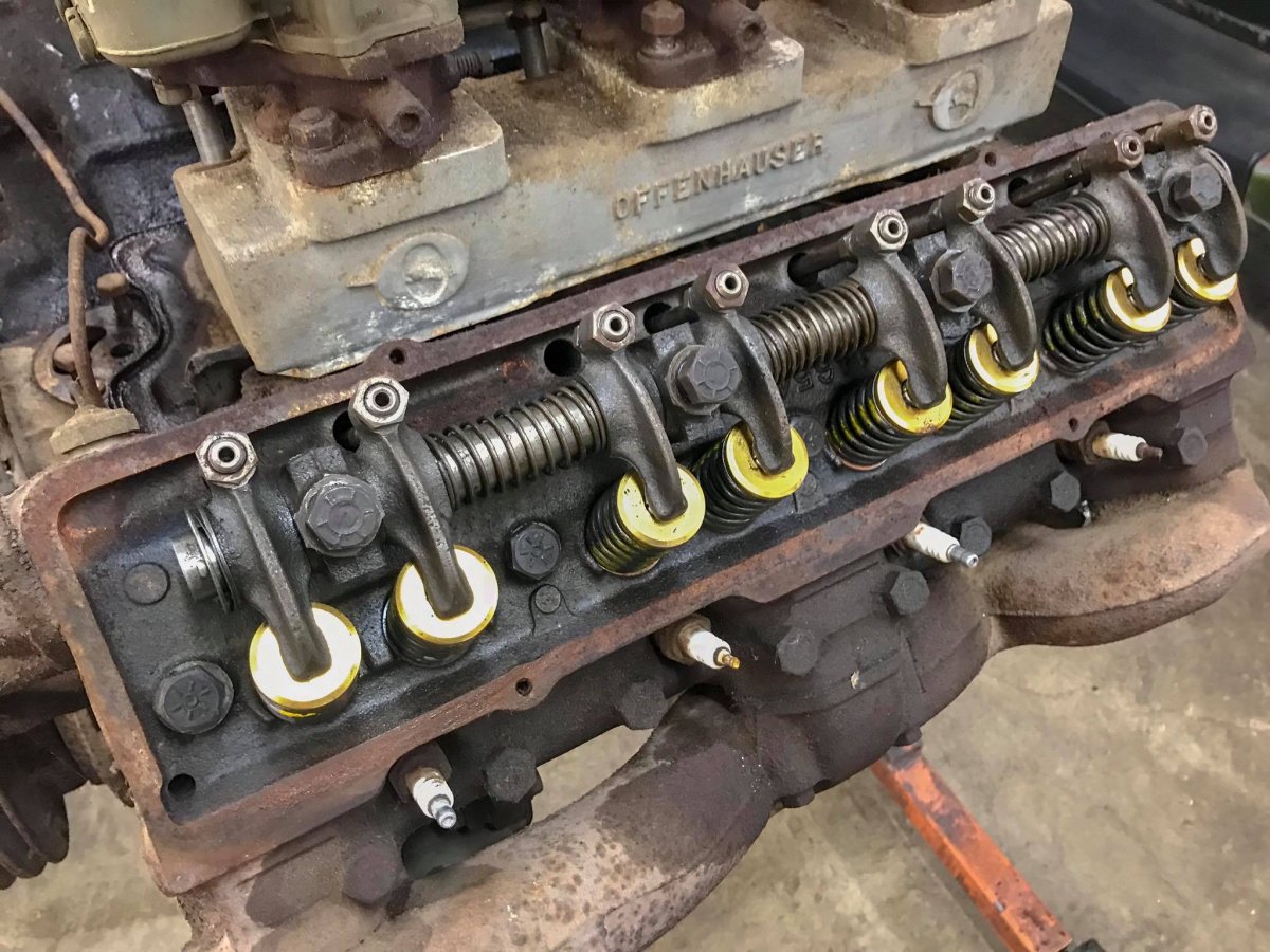

    My first plan for this car was to build a big cubic inch flathead for it with an OT induction system, though an early Cadillac has always been in the back of my mind. Driving through the Eisenhower tunnel at nearly 12,000' in the roadster made me revisit the OHV idea, especially with a heavier car and more frontal area. When I got back from the trip, I mentioned the Cadillac idea to a friend, who just happened to have another friend with one for sale locally. I went to check out the engine, and decided to pick it up.
    The back story on this engine is that it came from a '33 Chevy coupe project that had been sitting dormant since the early '70s. The engine is a '57 365, with an Offenhauser 6x2 manifold, Holley 2110 carbs, a Mallory RevPol distributor, a Trans-Dapt Cadillac to Chevy trans adapter, and Weber aluminum flywheel/pressure plate/disc. The car had been set up for a Muncie and Olds rear end, so I'm thinking the builder may have had serious intentions?
    When I went to look at it, the owner pulled a valve cover, exposing a set of adjustable rocker arms. Initially I suspected Studebakers, but after some research, they appear to be Gotha rocker arms.
    43245326_10100124474828779_5763497733549719552_o.jpg 43331083_10100124474868699_6300601132129452032_o.jpg
    AHotRod, Shadow Creek, BigO and 12 others like this.

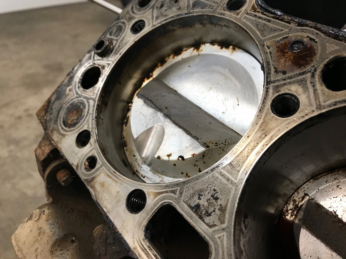

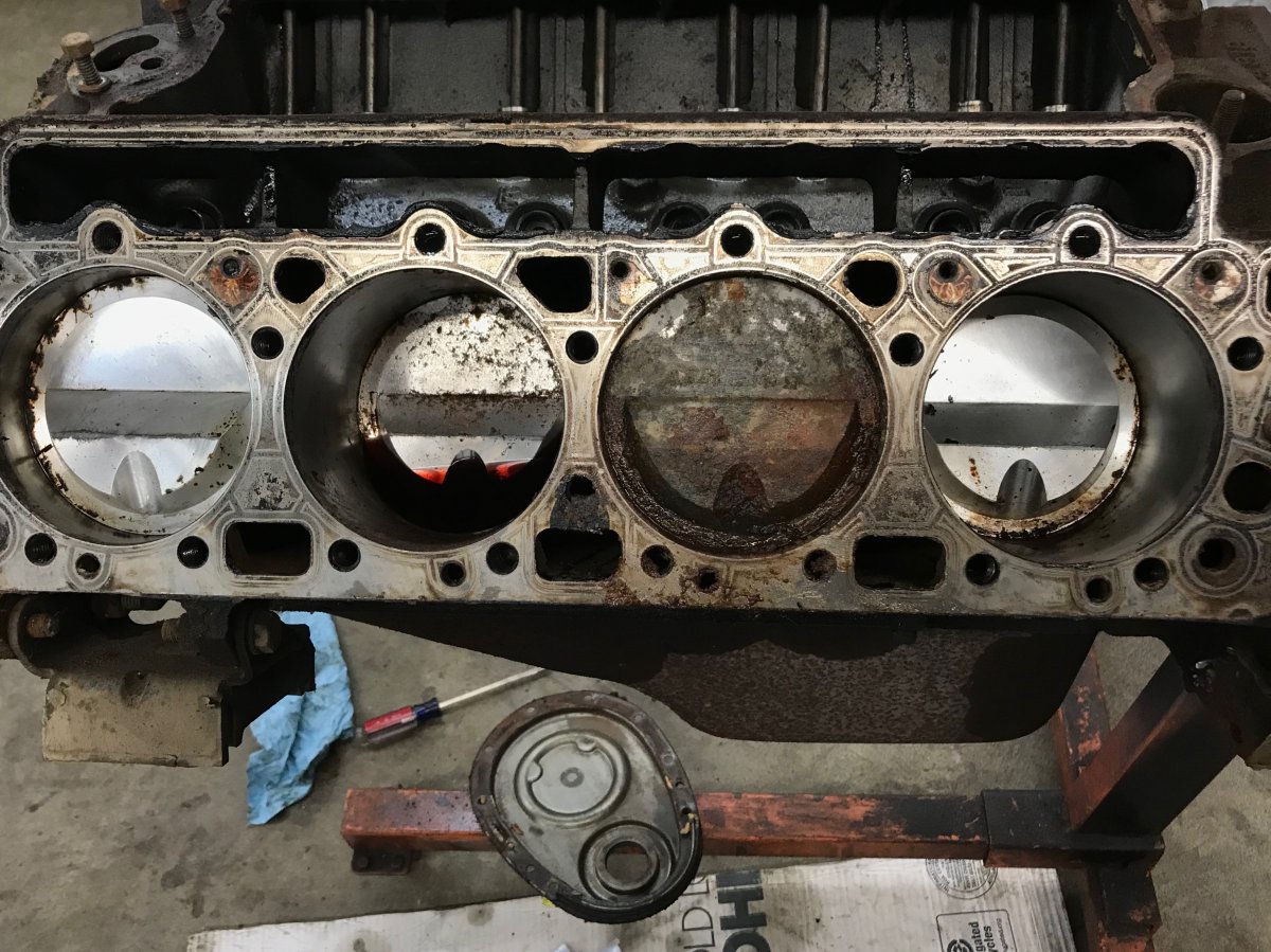

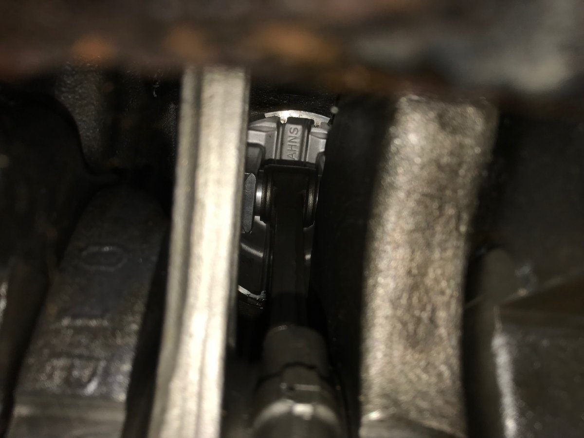

    The bad news was that something leaked overhead, and water got into a couple of cylinders. Even if the block turned out to be no good, I figured it could serve well as a mock up engine at the very least. What interesting is that this engine was never fired. Once I got it home, I decided to pull a head and the cam to investigate what was inside:
    43243406_10100124474913609_4481380520302739456_o.jpg file1-8.jpeg file-20.jpeg file2-4.jpeg
    The Jahns pistons have some serious pop-ups! I'm not sure what the compression would be, but considering stock form is 10:1, this would've been pretty nasty. The bores are 0.060" over, and I have no idea how thick the walls are on these engines, but maybe it would clean up at 0.080"? The pistons would need to change anyway for something more streetable. The crank and rods are still 365 parts, so this would come in at 375 cubic inches in this configuration.
    I pulled the cam, and found it to be a Crane M282-8 grind. I called Crane to get the specs at 0.050":
    248/248 duration
    0.486"/0.486" lift
    108 LSA
    I think I'll be shooting for something more tamed down, so many of these parts may not make it back. I'm thinking about a 390 crank and rods to get as much torque as possible too.
    AHotRod, Shadow Creek, BigO and 7 others like this.

    Hopefully you can find another 365 block. Or just buy a 390 and transfer over the top end stuff.
    But a Sonic check would give you the final decision for sure...

    Super Good score on all the Cad stick parts, and the rockers. That stuff is not easy to find in original vintage pieces.
    I have no idea what your driving use plan is, but I know these Cad/Olds motors have tons of torque without a need for a longer stroke in a small Ford body.
    I was looking at the pressure plate...it looks like early Olds. I'm not sure if the fingers would line up with a chevy TOB? I never tried that.
    CTaulbert, catdad49 and kidcampbell71 like this.

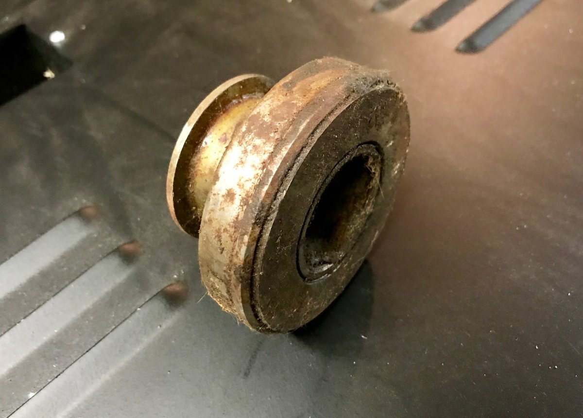

    The TOB bearing looks like a large Ford, but fits the small fork with the Trans-Dapt setup. I'll most likely have this flywheel drilled for a GM diaphragm pressure plate, and will run the matching TOB.
    loudbang and F&J like this.

    Good thinking on the GM cover drilling. With the adapter, fork, and tranny being Chev type, best to use diaphragm cover and matching disc.
    That LOVELY '33 deserves the Cad, and the best driveline for it!
