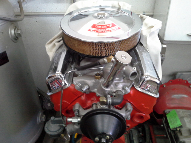

  16. I have seen mini breathers mounted in various places 20220529_114238.jpg 20220529_114247.jpg

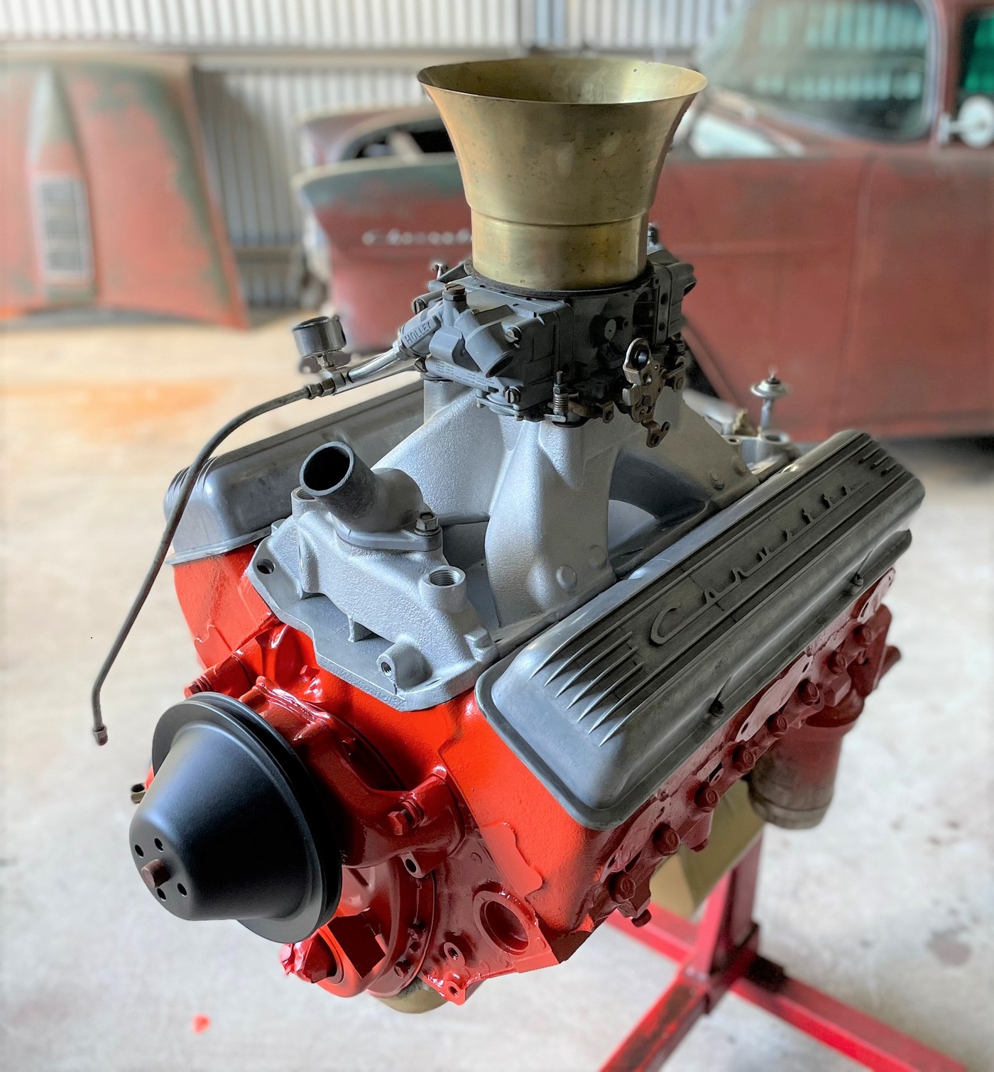

    If I was to put the oil separator canister back on and run a remote style breather? My thoughts - drill and tap the valley, run a fitting with a flexible hose to which a breather is fitted to the end? Here's a pic of the engine.

  26. jugheadjones
    Joined: Jun 6, 2011
    Posts: 182
    jugheadjones
    Not ideal removing a valve cover to add oil but I'm happy to do this if I need to. I use phillip head bolts for the valve covers. Super easy to remove in my case. The cork gaskets given they're not crusty and dry have lasted me years off and on so far.
    I was thinking of putting the oil separator canister back on and build a remote style breather? Drill and tap the manifold, run a flexile hose to a breather?

    Team G manifold ?

    Mr48chev
