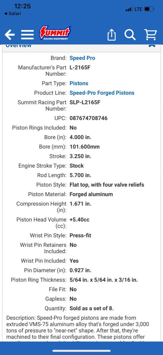

  18. Fieldcar_56
    Joined: Jan 22, 2014
    Posts: 77
    Fieldcar_56
    from New Mexico

  21. Ericnova72
    Joined: May 1, 2007
    Posts: 602
    Ericnova72
    from Michigan
    Basically the same piston spec but without the lost .020" reduced height, so it would be better from that standpoint. Also forged, it is a lot stronger piston.
    If you deck your block .020" and keep the pistons you have you would get the same resulting tighter quench and 0.4:1 higher compression those L-2165 pistons would get you in the undecked block.
  22. Ericnova72
    Joined: May 1, 2007
    Posts: 602
    Ericnova72
    from Michigan
    Run the numbers through a compression ratio calculator...undecked block, .015" thick gasket, 5cc relief, 64cc head says 9.7:1 compression.
    The thing I don't like about the H660CP hyper is you are only $25 away from getting the much stronger L-2165 forged piston.
    Fieldcar_56 likes this.
