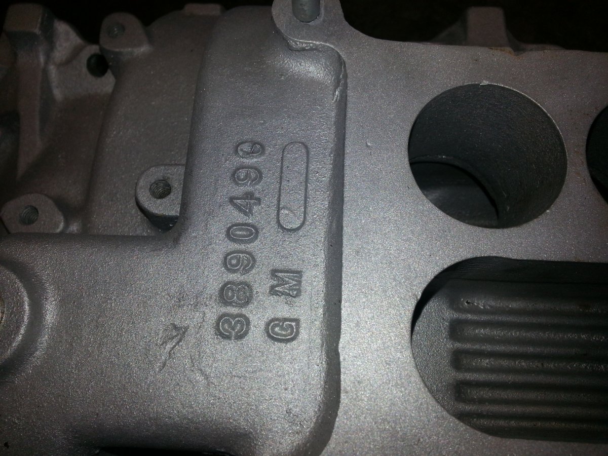

  22. DDDenny
    Posts: 19,265
    Yup, listen to these guys.
    Two castings, both great intakes, both pricey nowadays.
    64-65 casting # 3844461
    66-67 casting # 3890490
    Biggest difference is the direction of the oil fill tube and water neck orientation.
    If you can get the one from racer x at a reasonable price I'd grab it.
    One thing though; if the OEM fill tube is missing, be aware that some of the reproduction tubes Do Not Fit.
    Instead of using a road draft tube, the "fresh air tube" is reproduced, it goes where the
    road draft tube goes, get the GM period pieces (66-67), for the pcv system in repros, like the intakes, these NOS pieces are $$$.
    65 did not use a pcv system.
    This is my 67 style l79, sorry, don't have any better photos within reach.
    At least two styles of fresh air tubes are being repopped.
    Straight style 65 Corvette and Chevelle
    Curved style 66-67 Nova, Chevelle, and 67-68 Camaro.
    This is my 67
    You will also need this valley baffle if it's missing, still can find used or in reproduction.
