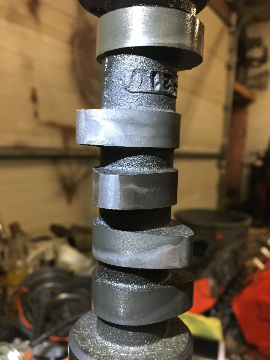

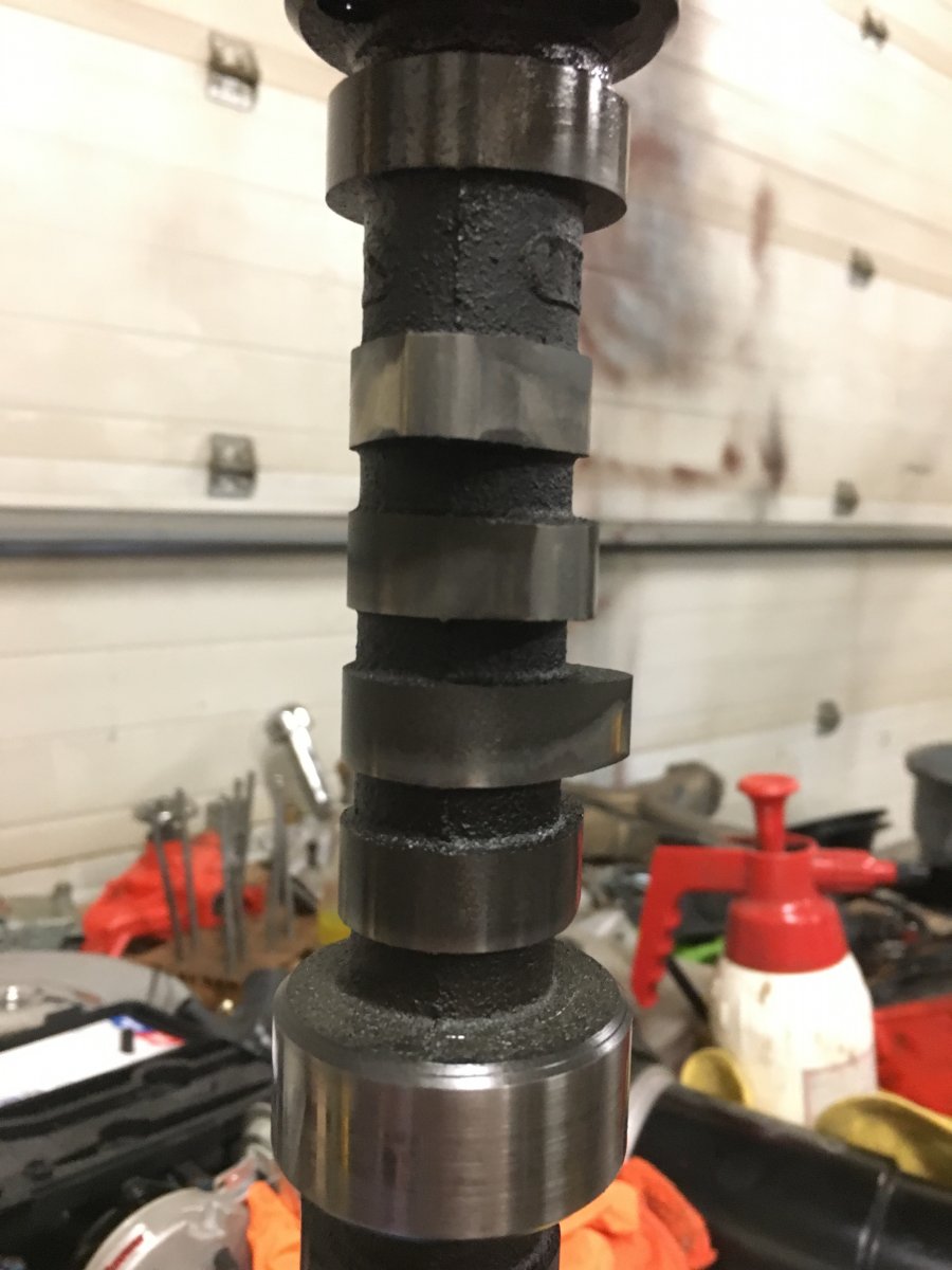

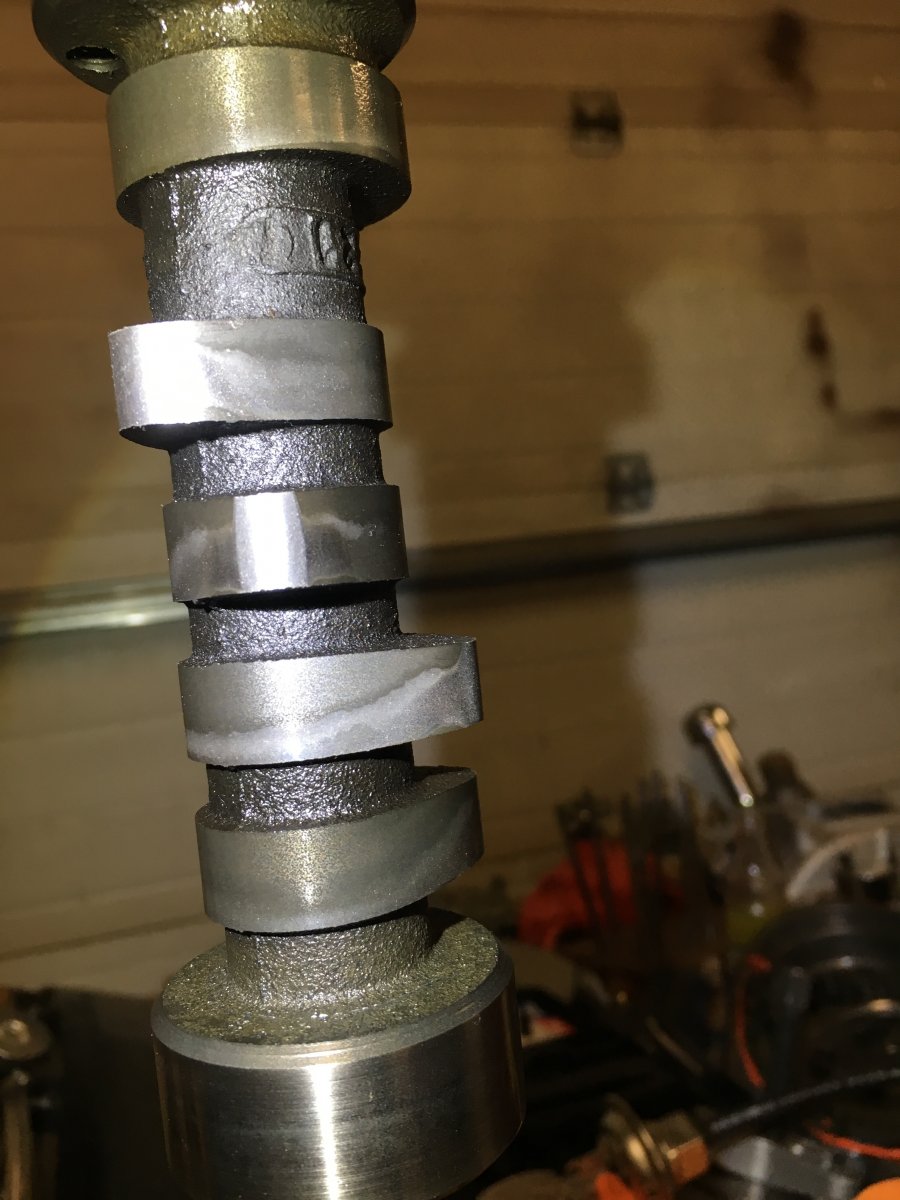

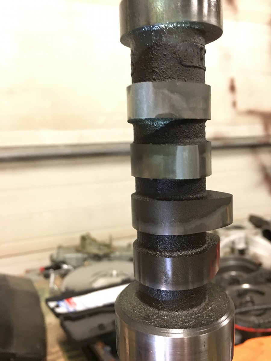

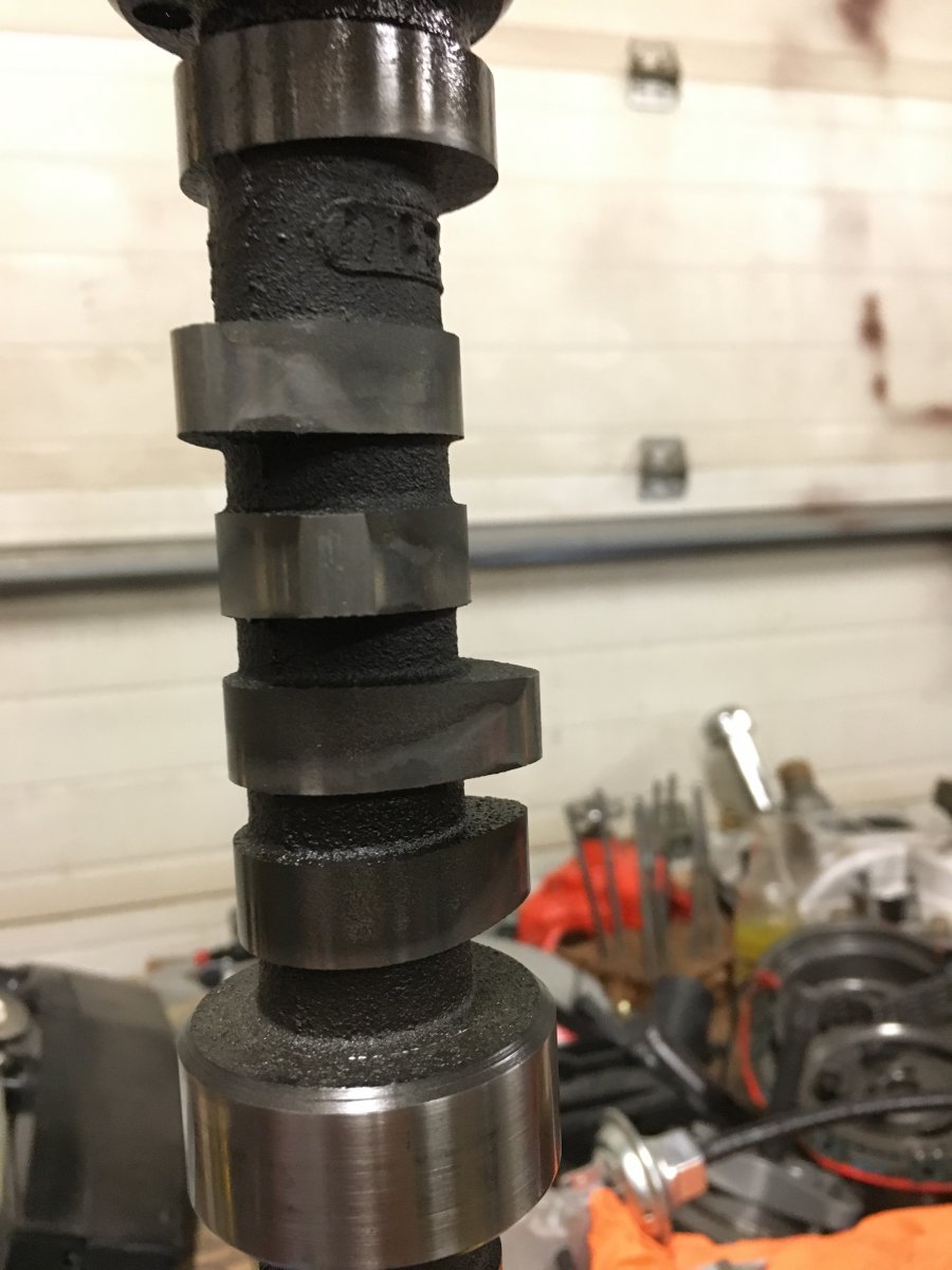

  27. I had emailed lunati asking for advise and their thoughts on the cam. I also sent them my measurements and asked what they thought of the wear. They never responded, typical.. I had the same response from them when shopping for a cam. Not sure why I bought from them in the first place....
    Since I don’t know the base circle initial measurement, I’m taking the current bc and taking that away from the total lobe to get total lift. Then taking that and multiplying it by 1.5 to compare the advertised lift. I don’t have my measurements with me so this is all irrelevant at the moment, but it showed noticeably less lift than it should have across the board, with the intake have greater wear than the exhaust.
    What I’m wondering is what everyone thinks about the wear pattern, is that a normal wear pattern? Just looks odd, like it wore a coating off irregularly or something. The bottom of the lifters look fine and flat as far as I can tell, no evidence of wear what so ever.
    I had wanted to send the pics to lunati for their thoughts but like I said they couldn’t be bothered to answer my emails, so I am permanently done with them. Comp has been helpful though.

  28. Hi Fry,
    To just look at the pics it looks like lack of lubrication to some extent.
    When I enlarged the pics it appears to have some journal wear or at light markings of wear.
    I don’t think it should with only 2500 miles on it?
    Maybe the oil was missing an ingredient or something,,,maybe a bad batch?
    When I looked at the lobes there seems to be wear down the side where the Parkerizing is missing,,,, I have never seen that with that low of miles.
    I assume you assembled the engine? Were the lifters easy to rotate in the bores?
    If they don’t spin it will wipe out the lobes very quickly,,,,,(at least they spin in a flat tappet cam engine). If no rotation,,,it literally scrubs the lobe right off.
    I saw your post where number 1 is reliability,,number 2 is to have fun and enjoy the car.
    I agree completely.
    You can’t get much more reliable than a good 327 with a hyd. Cam.
    If you have the money to spend go for a roller,,,,but it sounds like you want it to be dependable and not have to sink a fortune in it.
    The heads are the main problem,,,it pulled out a stud and has bad side wear on a couple of valves. That could have been missed by you if you didn’t do the head assembly?
    The guides could have been improperly serviced and/or the liners not installed correctly?
    If the guides had been replaced maybe the tops were not trimmed down and the retainers were bottoming out?
    Those heads are excellent castings,,,some of the best GM made.
    Good luck!
