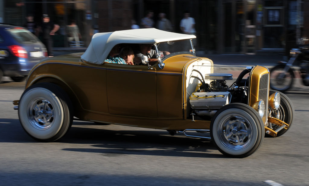

    I used to run a 2" and several years ago went to a 3". I bought it from Barry Lobeck........ Click to enlarge. Click twice for full size.

    I have a 3" chop from Brookville.
    //Stefan
