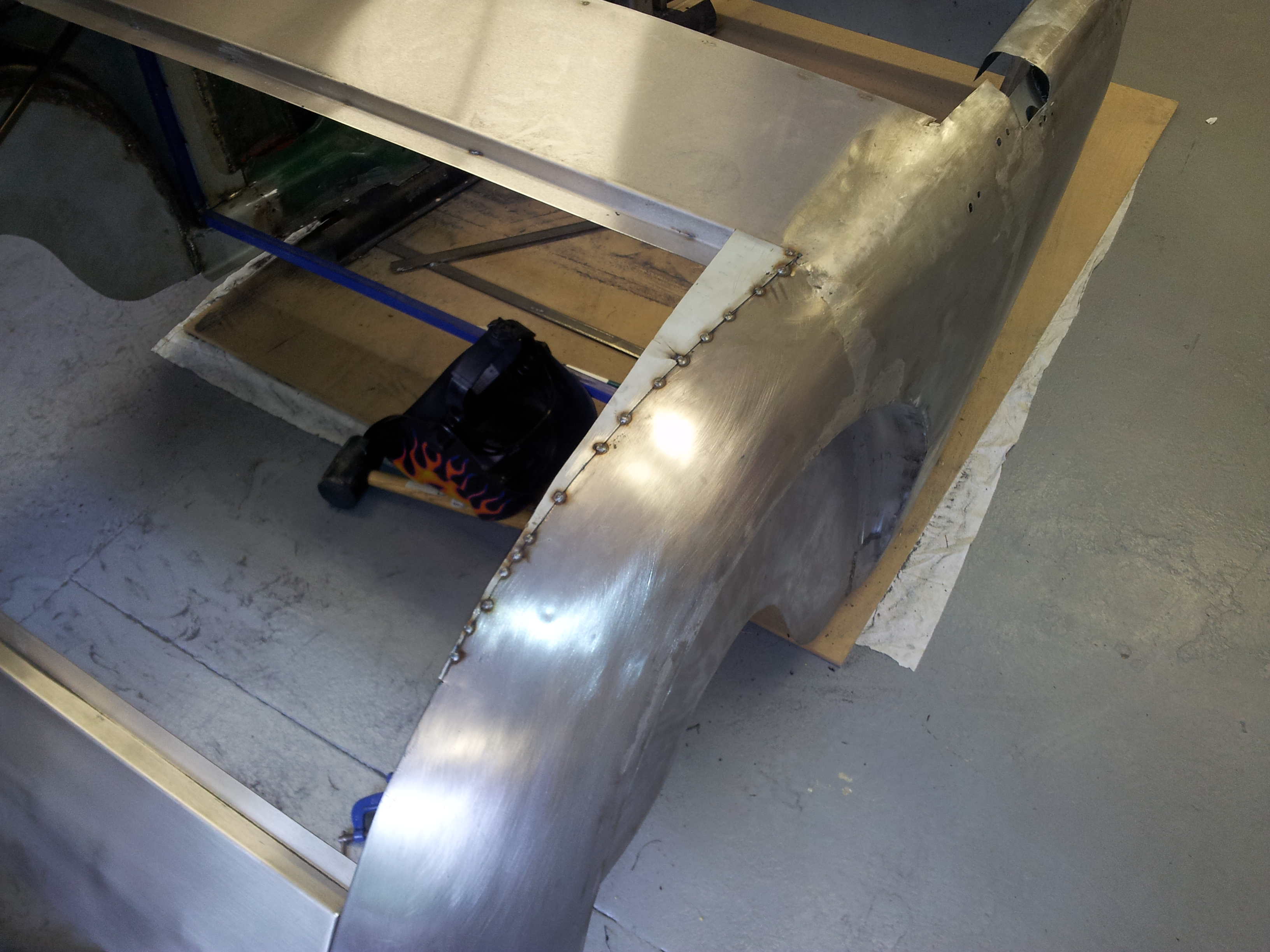

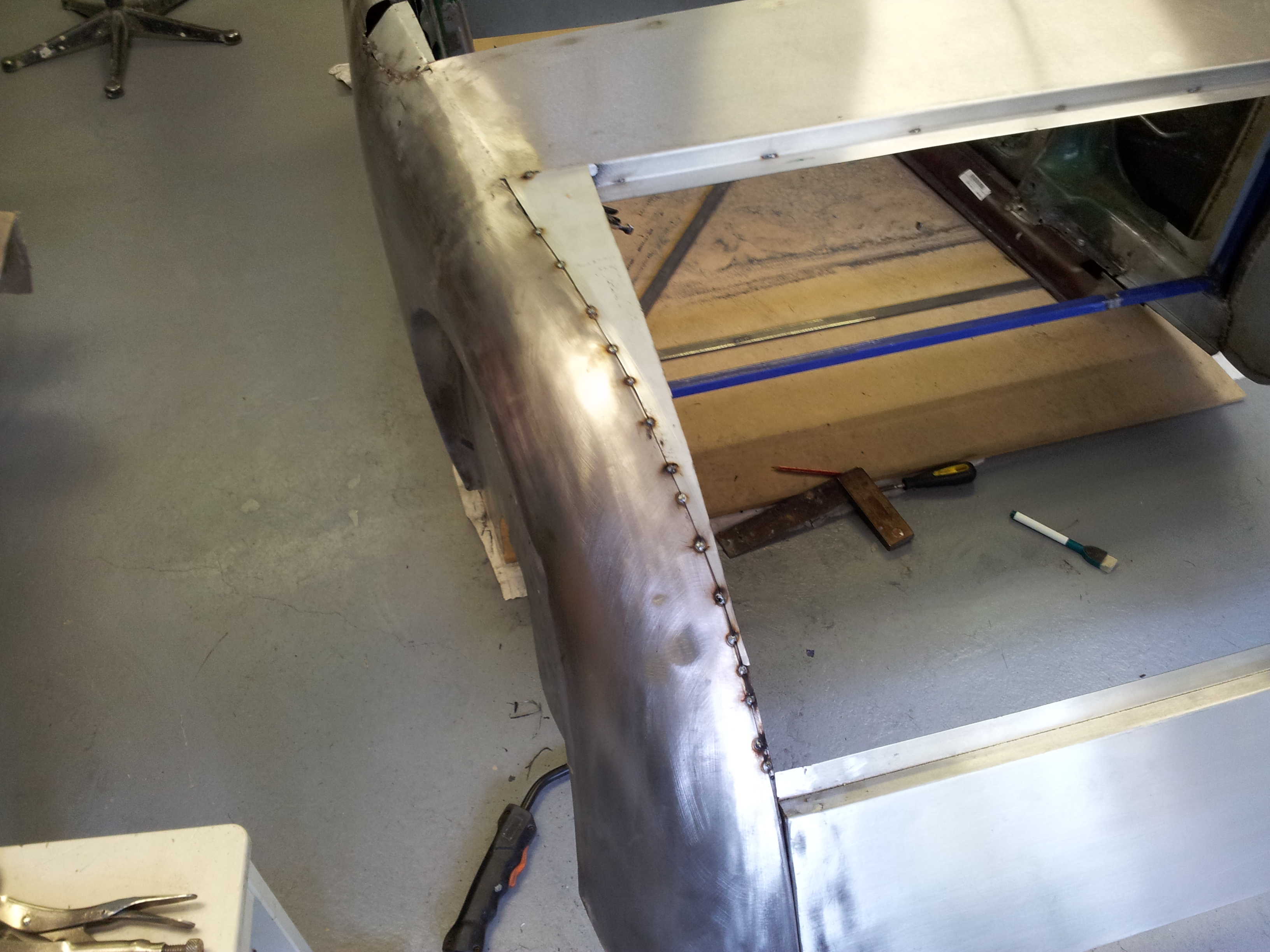

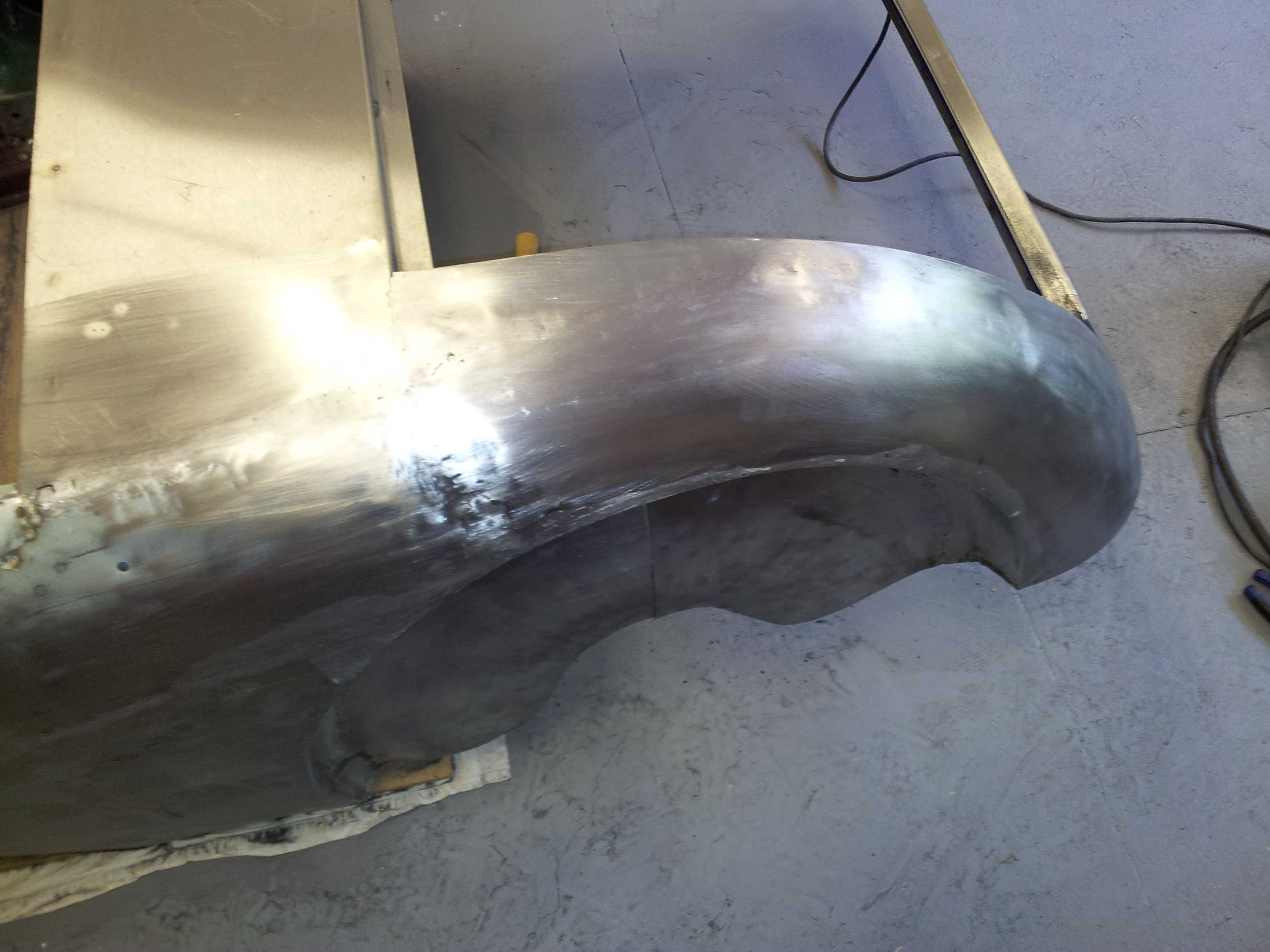

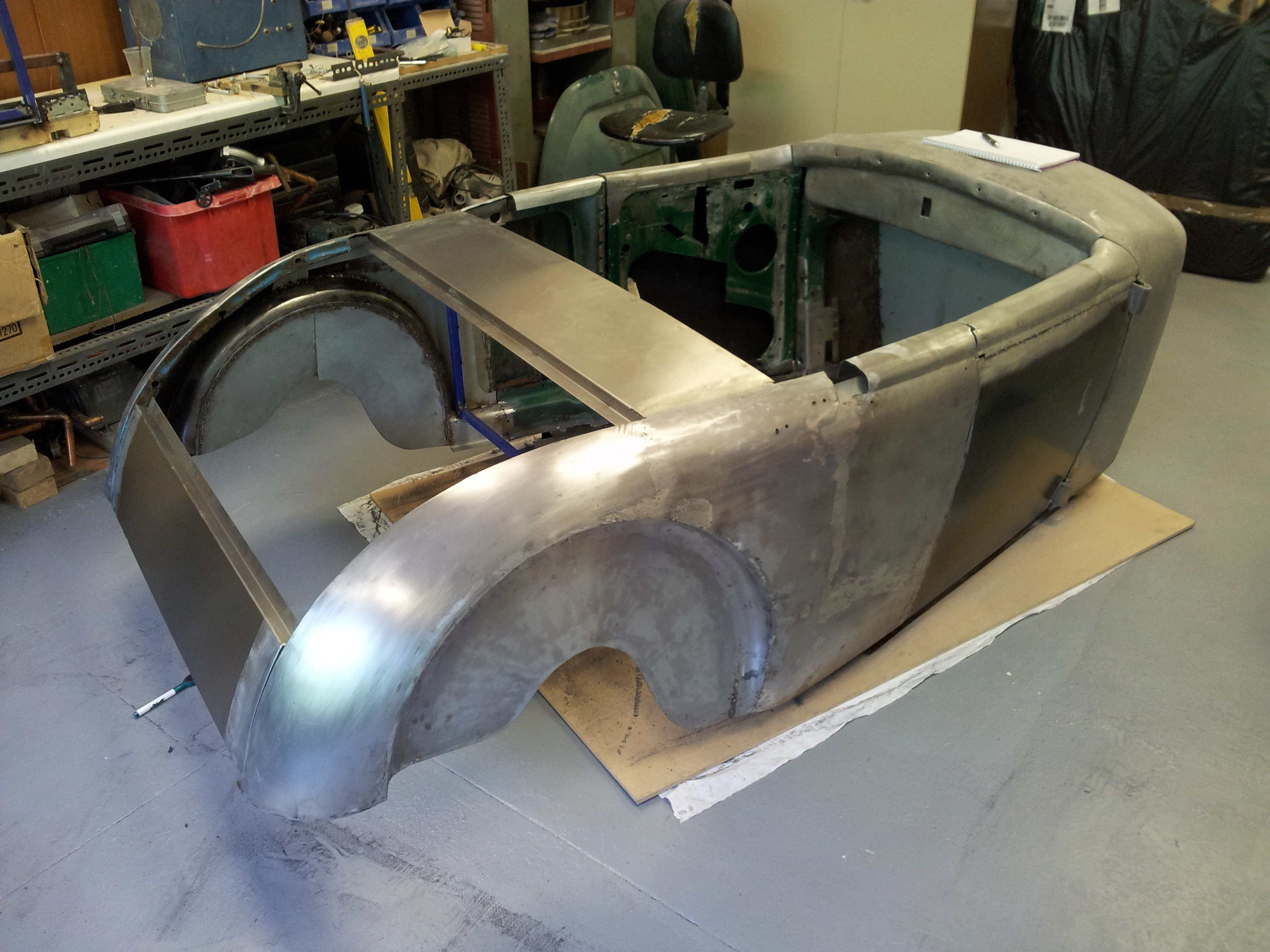

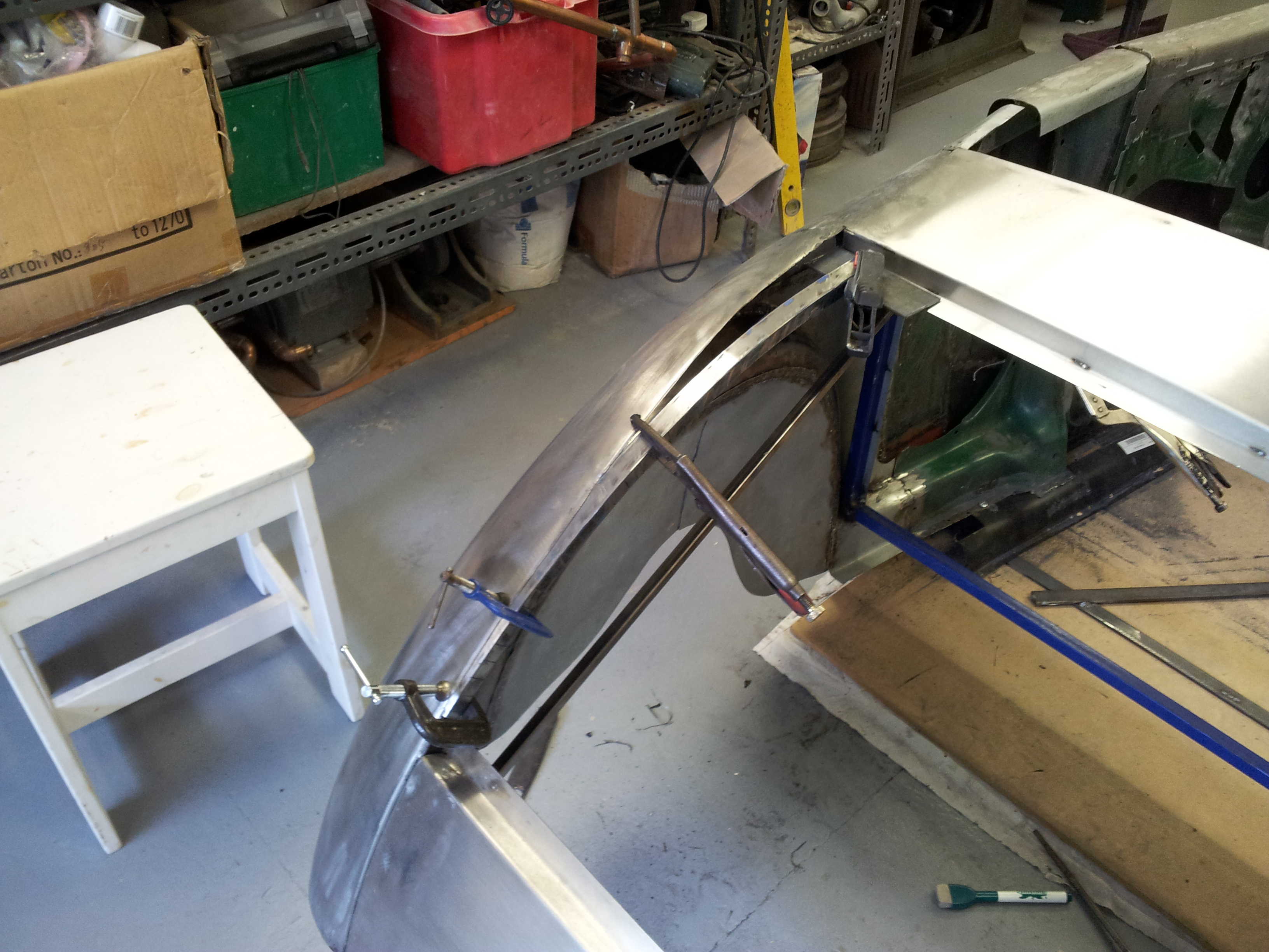

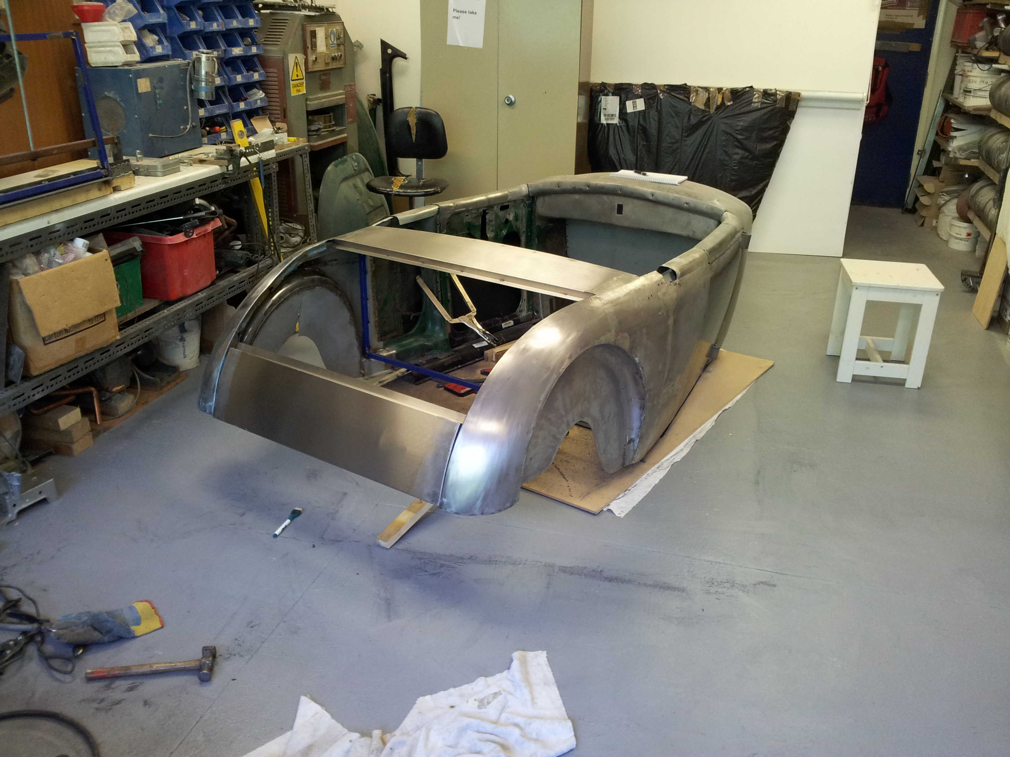

    I was then able to bolt the new panel in place.
    It did take a bit of adjustment, hence the small piece of timber at one end.

  2. english gent
    Joined: Jun 20, 2012
    Posts: 225
    english gent
    from England

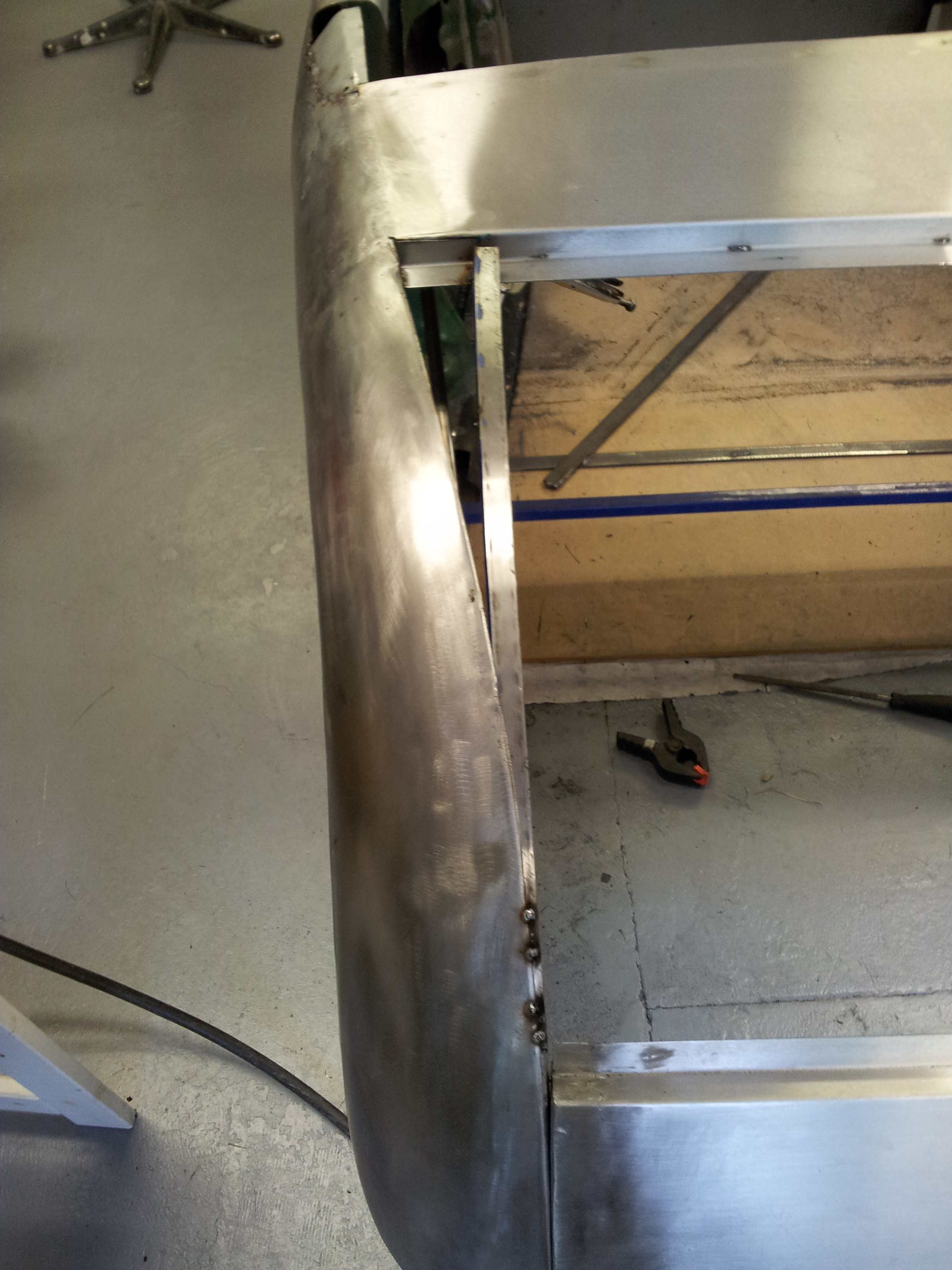

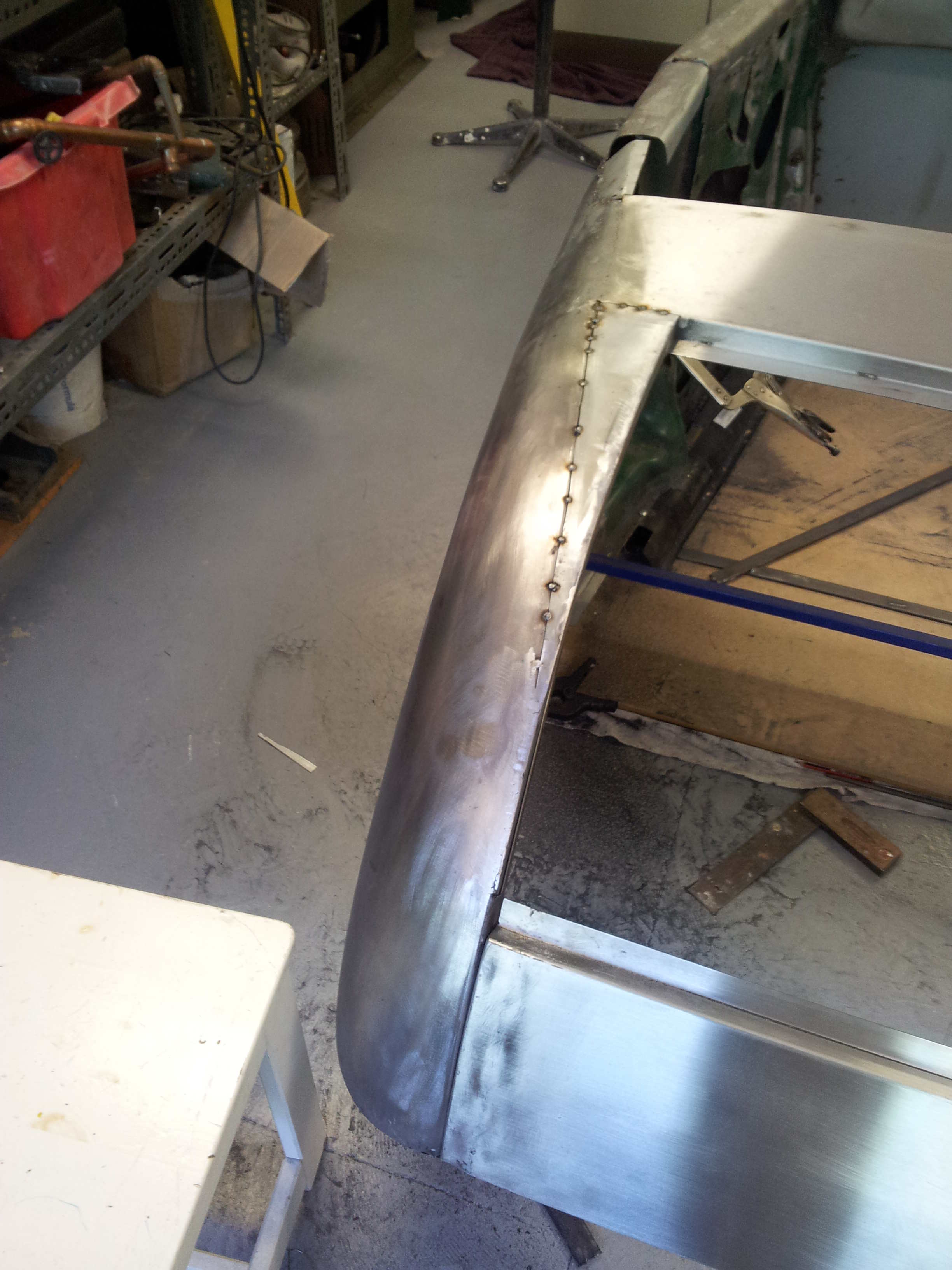

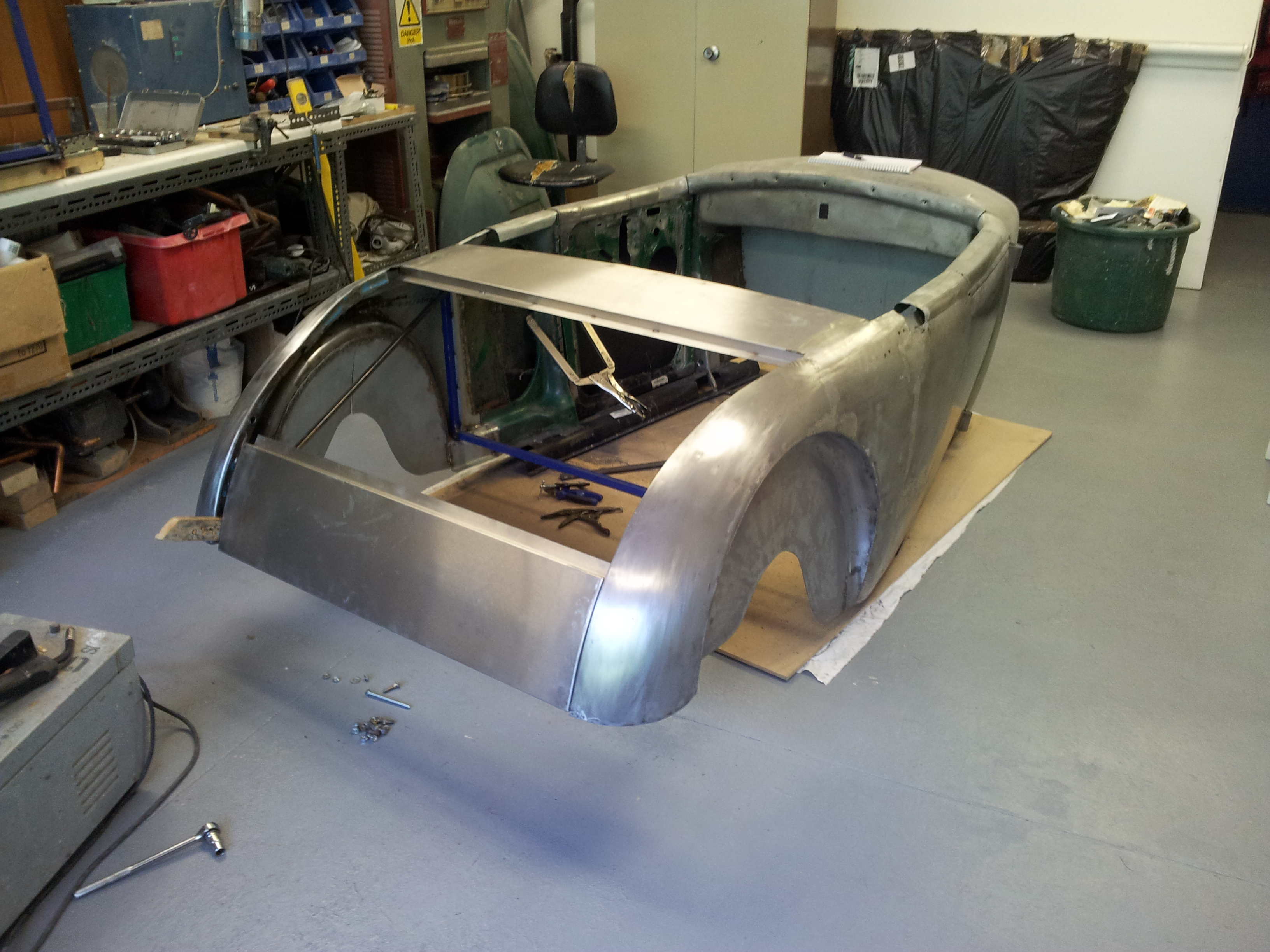

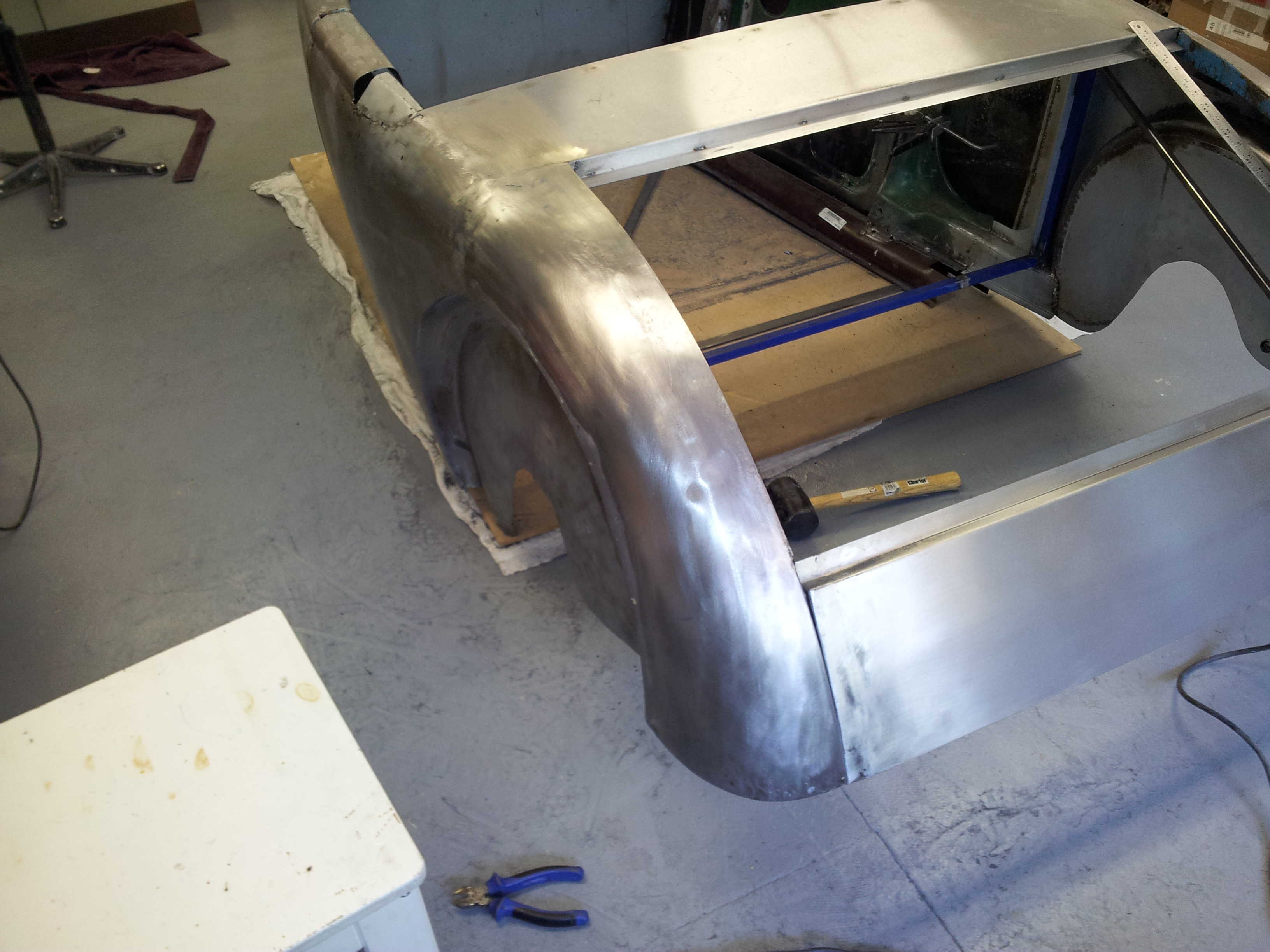

    Eventually I got it lined up.

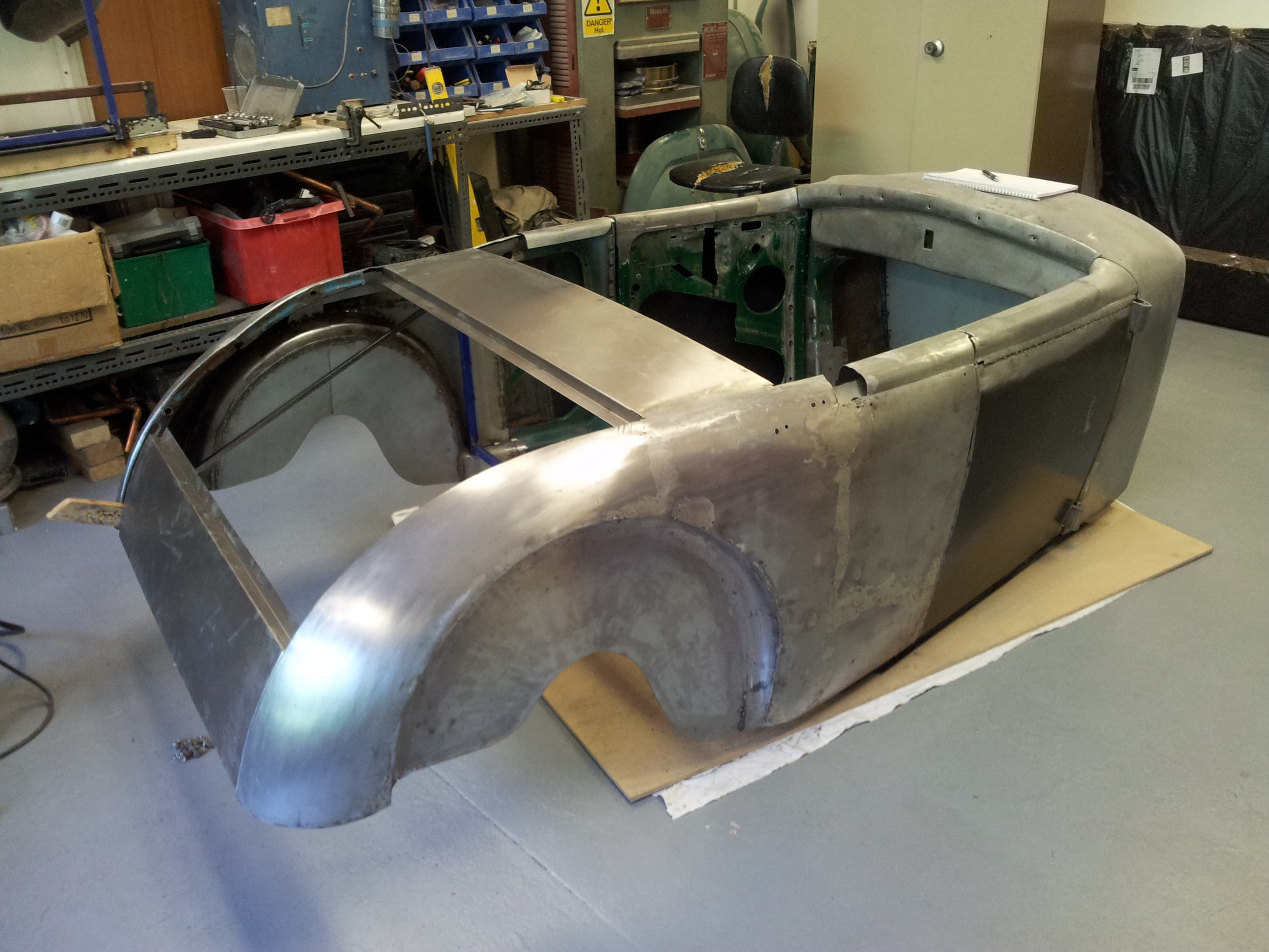

  4. Bruce Lancaster
    Joined: Oct 9, 2001
    Posts: 21,681
    Bruce Lancaster
    Well, there it is. Not finished, but it is perfectly clear that he has done it! Started with a VW September 30, I think, and a little more than 3 weeks later he has a slightly miniaturized body that I believe would look good to most fans of real '32's.
    If you look in at the side rails, it looks like it will have good structural strength once flooring goes in, and everything seems to flow very successfully.
    This is an amazing tour-de-force, some of it accomplished with technology from outside general automotive practices.

    How does the width and length of the body compare to an original?
  11. english gent
    Posts: 225
    english gent
    from England
    I've got a measurement of 88'' from firewall to rear of body and a width of 51.5'' at the widest point behind the doors.
    From the information I can find, this is within a couple of inches of the original body.
    kidcampbell71 likes this.

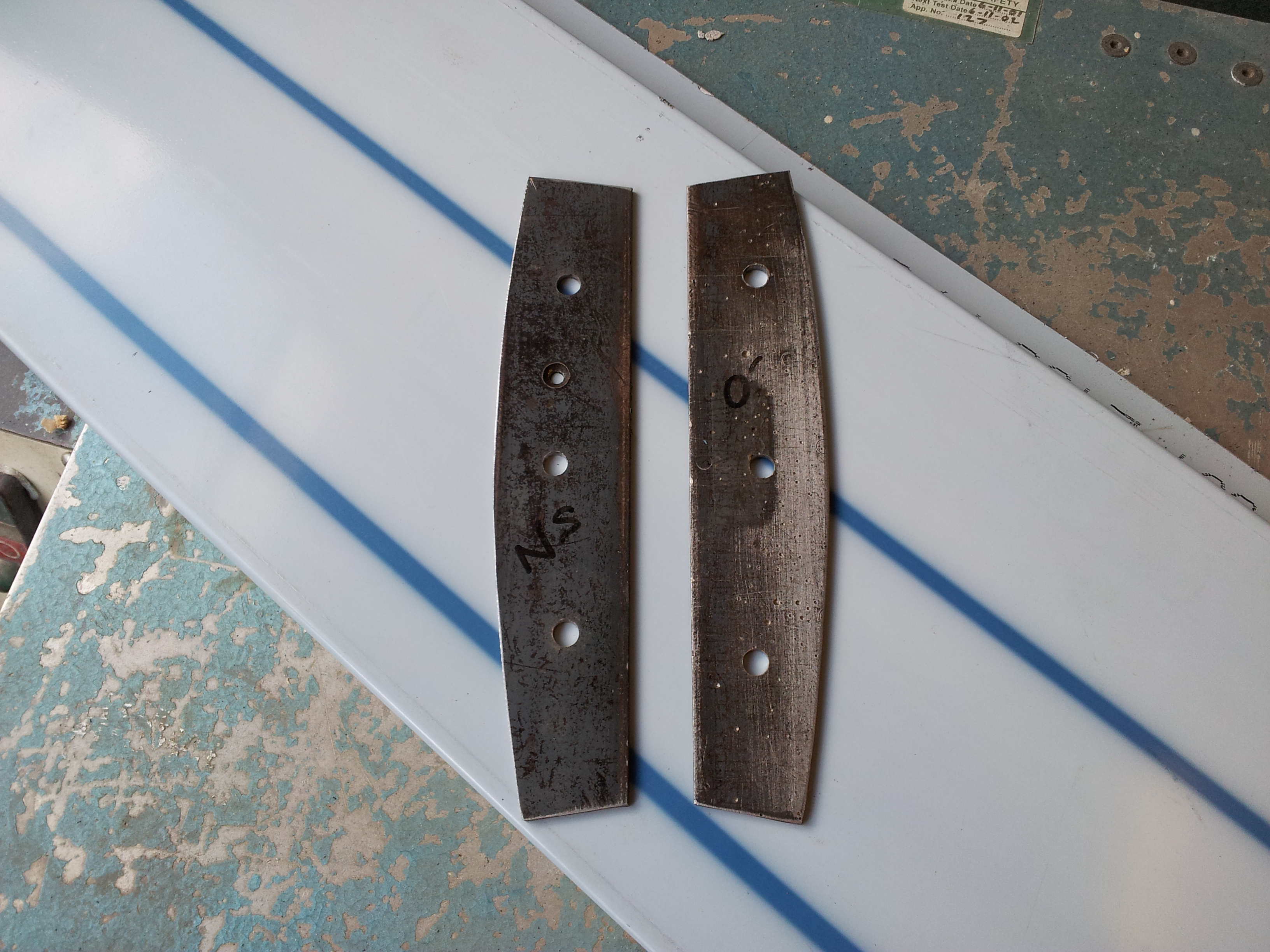

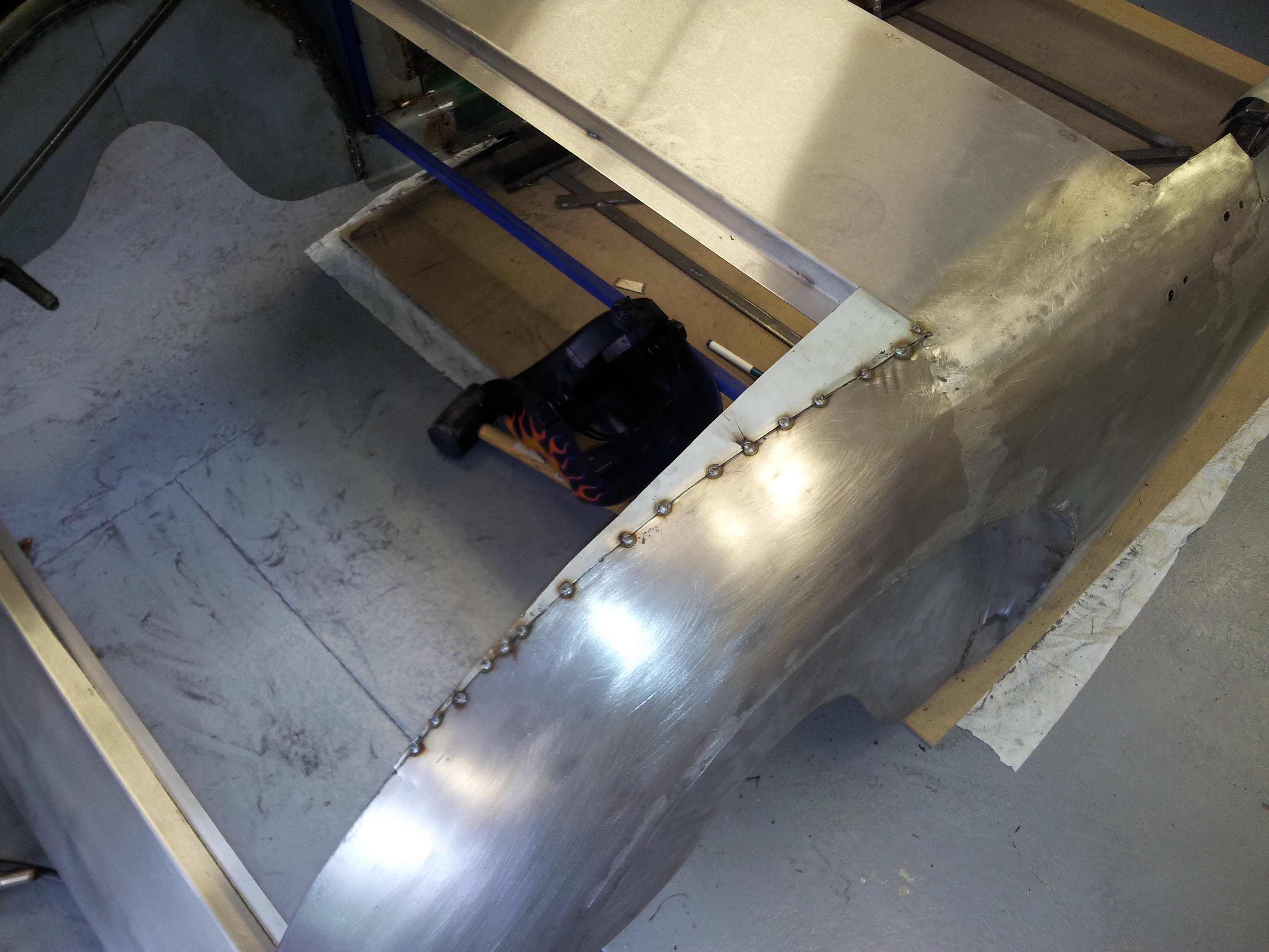

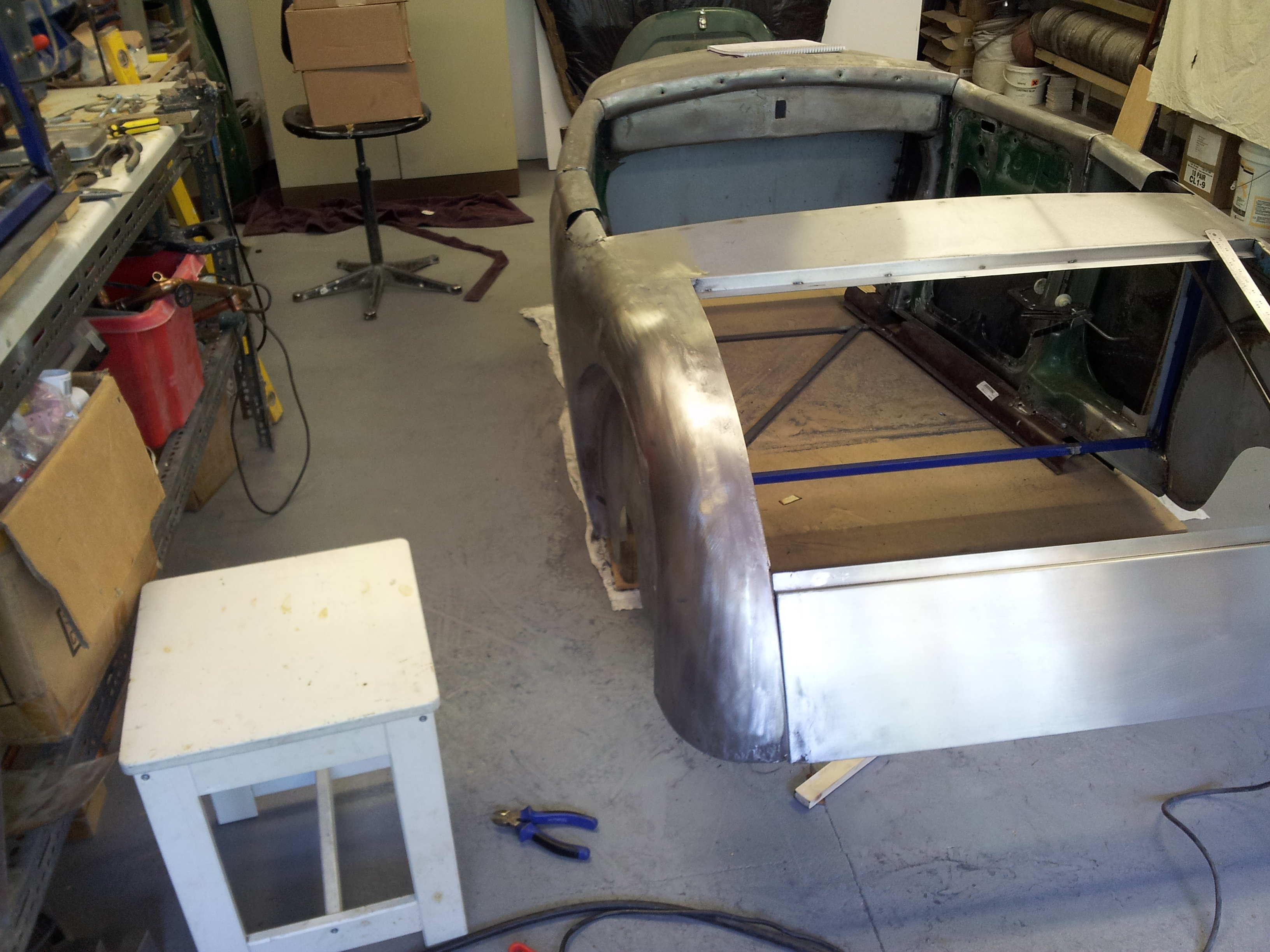

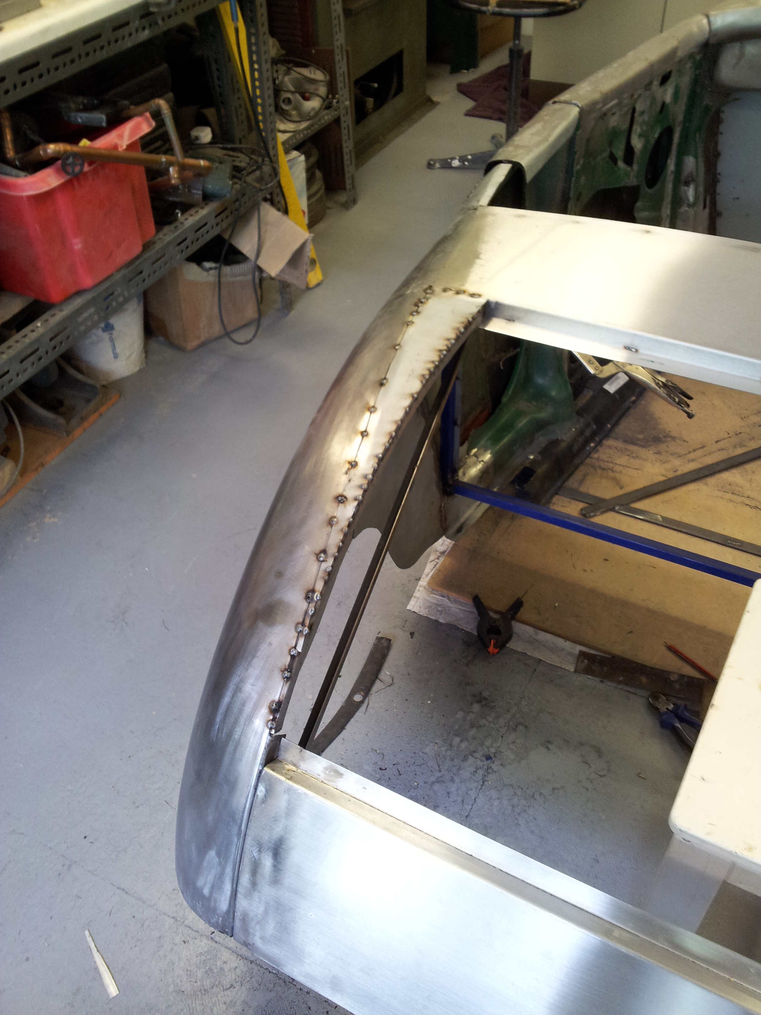

  26. english gent
    Posts: 225
    english gent
    from England
    Hi guys, welcome back.
    The opening for the trunk lid isn't square, and requires an insert to address this.
    Here we go....

  27. :)
    I'm telling ya, there's a bunch of metal and metal work in a deck lid opening.
    It's like it never ends.
