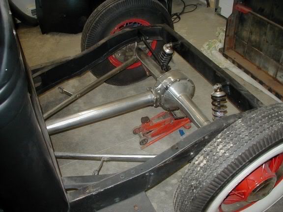

Here are pics of my home made setup in my 34 pu. It is about 1 1/2" further back than stock (cab is moved back). I don't know what the springs are from. They are 46" long with weight on. Setting shackle angles is kind of a guessing game. Straight up and down with no weight is probably a good starting point but I would just tack the rear brackets until you can put some weight on it and see what you have, at least that's how I did mine.
here's my MUCH less technical mock up minus some additional bracing. took me a while to get back to the shop Sent from my SM-G920R4 using The H.A.M.B. mobile app
