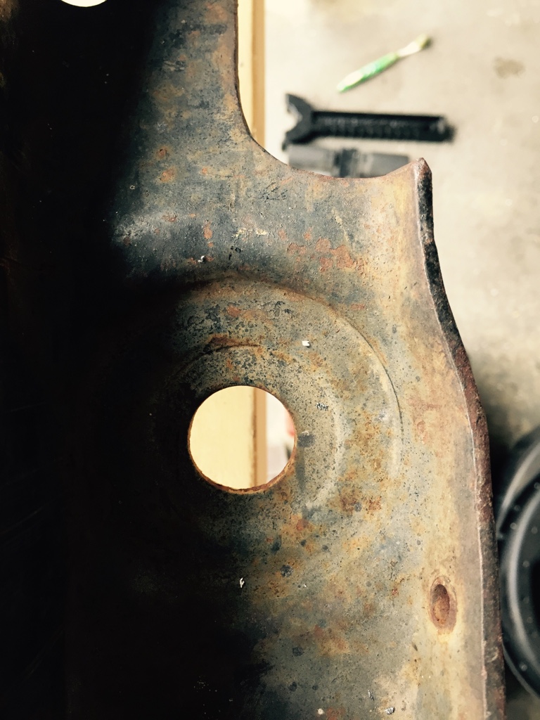

    Can anyone in lighten me on the situation with 1932 front crossmember motor mounts?
    I am running a stock front 32 crossmember and am making my own motor mounts that come off the block in between the water pumps like the stock cast type. This is to customize my engine placement which at minimum will be raised.
    So I have the cliche generic aftermarket biscuits you get from Speedway and everyone else. The don't fit the pocket well.
    Do I need to ditch the zinc plated steel cup? It drops down in there then. I would think the cup is engineered to support the rubber portion correctly.
    Or do I need a specific "32" biscuit?
    Thanks in advance for any help I know it's not a earth shattering dilemma, sometimes this is the fastest solution.

    Iffn you have an early '32 crossmember it will take an even specialer biscuit. Does your crossmember have the slight circle for the biscuit with another impressed circle in the middle of that? Or only one circle?
    Either way, try it without the wide dished washer. And, if you have the cheapo Speedway biscuits you will find they flatten out a bit after a year or so, so you might do as I did and place a stack of thick washers inside the hollow underside to prop em up a bit.
    Maybe just go to the Drake catalog and order the proper set of 1932 Ford front motor mount biscuits and be done with the worrying.

    Looks like a regular '32 crossmember, with a clearance notch for your pulley already applied.

    That's probably got a Ford part number...'32 crossmember with standard Oldsmobile notch!

    Yes, ditch the lower zinc plate and all will be well, if you have the right bisquits? There are at least 2 types sold by various vendors
