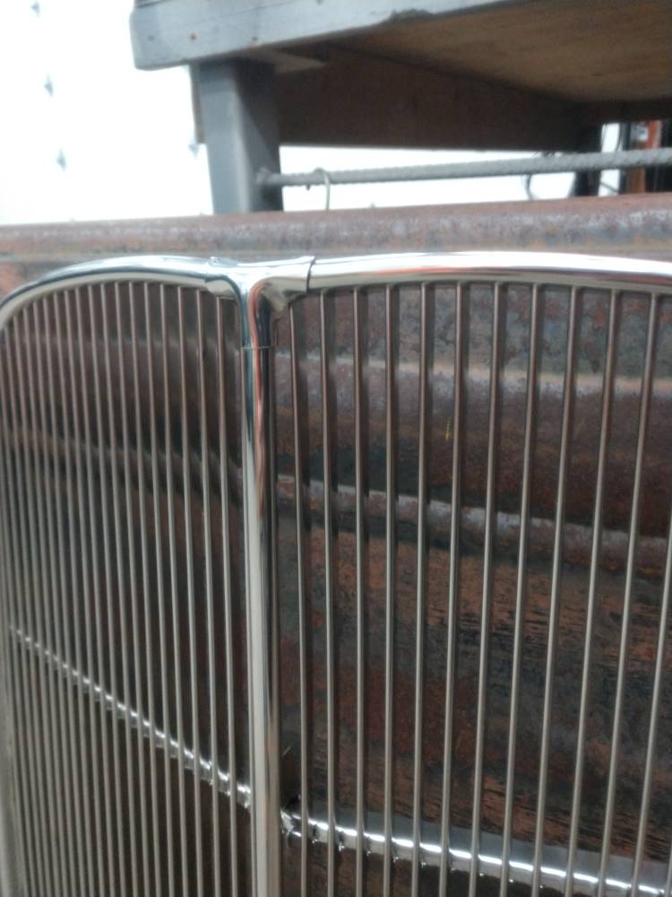

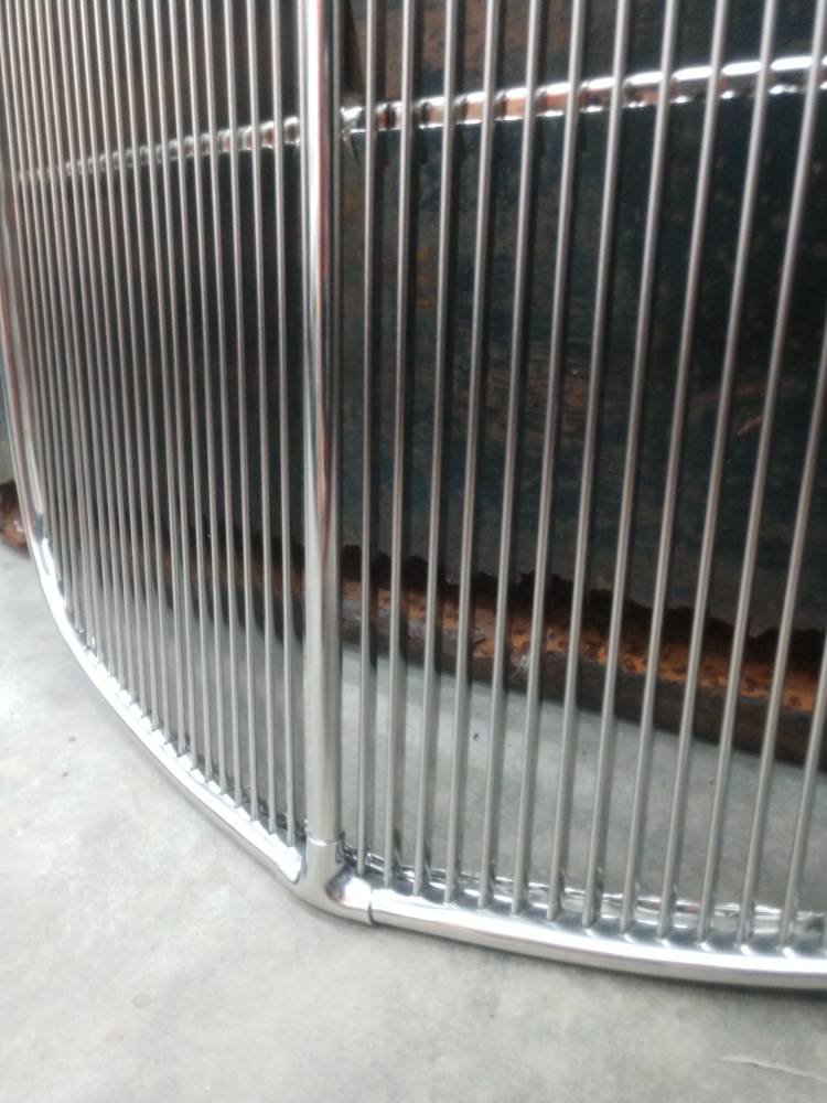

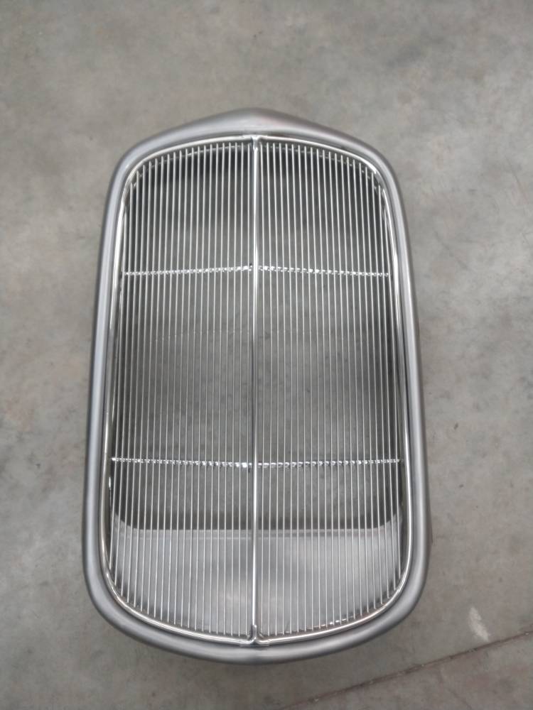

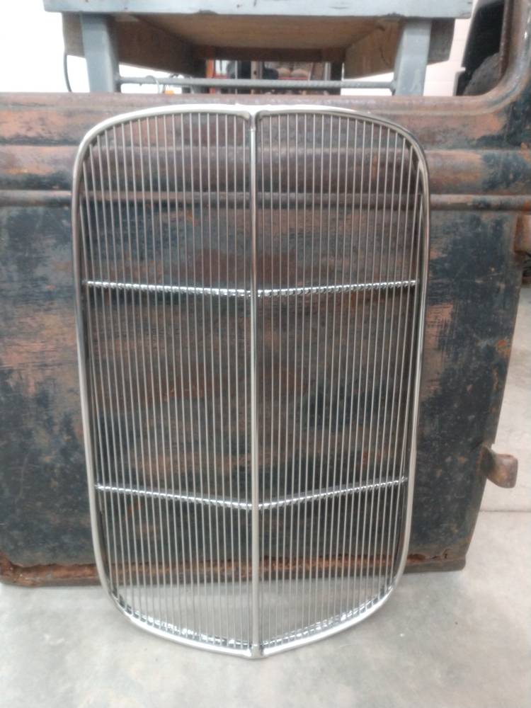

    I've been working on a cheaper alternative to the alumicraft grille with the center bar. I love the look but not the price. And I figured I would show what the finished result looks like. IMG_20191213_192725253_MP.jpeg IMG_20191213_192735572_MP.jpeg IMG_20191213_192740352.jpeg IMG_20191213_174103742_MP.jpeg

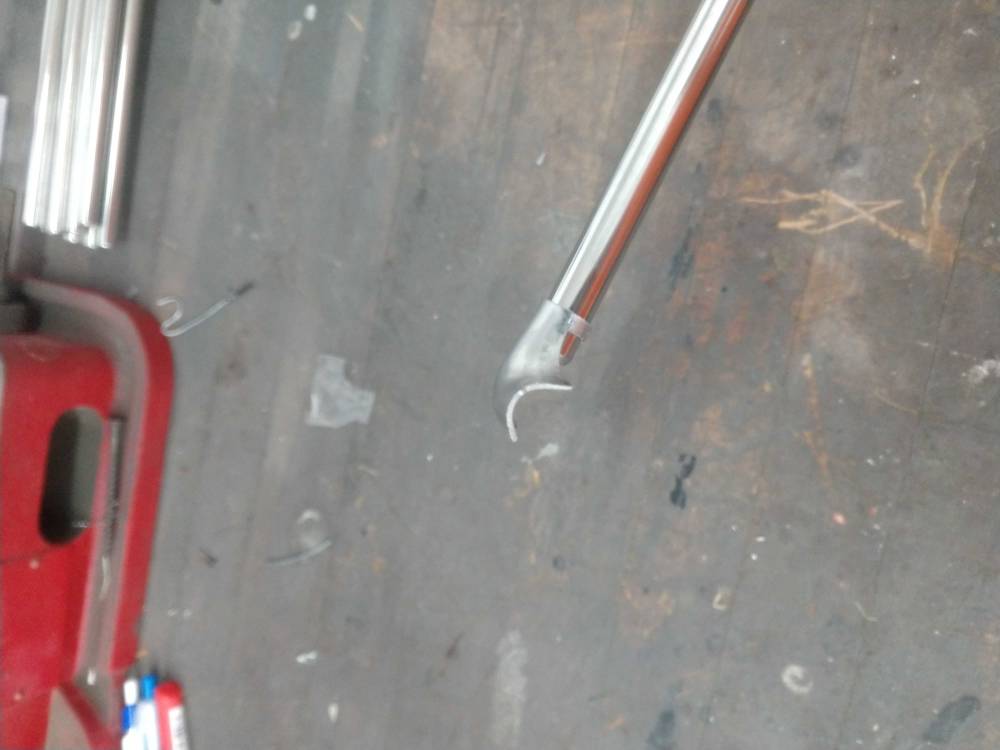

    This would work with a crank hole. All you would have to do is remove the original center bar and notch the top of the crank hole bezel and use just one piece on the top. Either way is going to require a couple of tack welds. Here's a couple more pics 1576289936462.jpeg 1576289971369.jpeg 1576290061096.jpeg

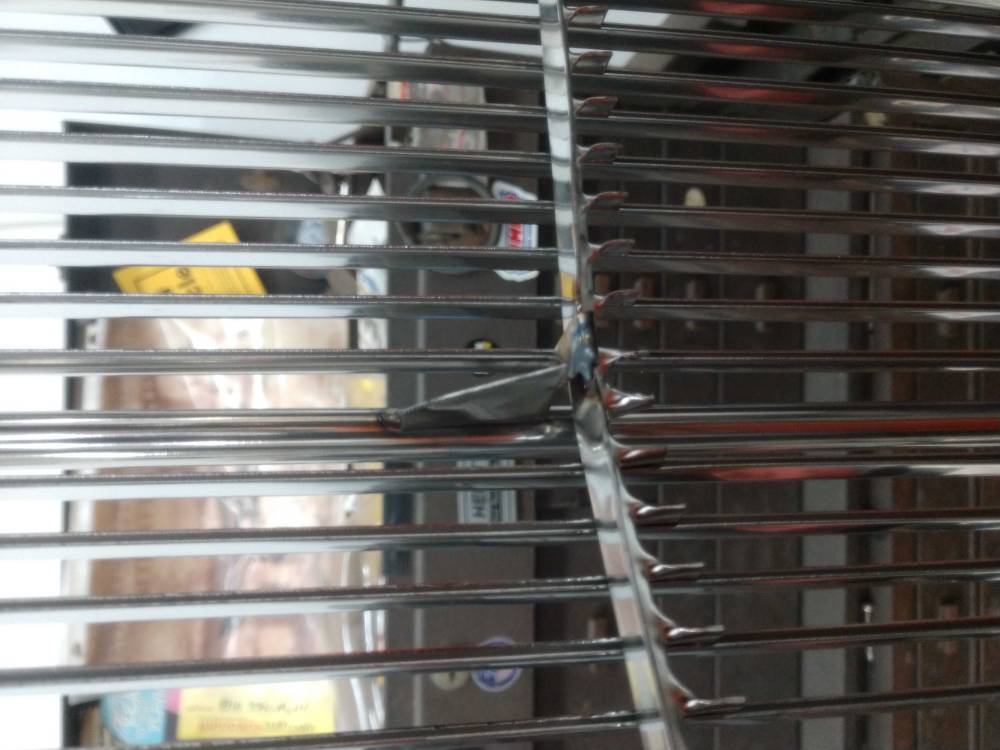

    KOOL!! Great work! Nice looking! I would take one without crank hole if you should decide to sell them. I'm assuming that it is stainless ? How do you attach it to the insert? Bill

    I put 2 tabs on the backside of the bar that are tack welded to the support braces to keep it in place.

    And yes it's 304 stainless

    When I first made it that's exactly how I attached it but it needs a little something extra to hold it.

    That's kinda what I was thinking if someone doesn't have access to a welder or doesn't want to weld it.
