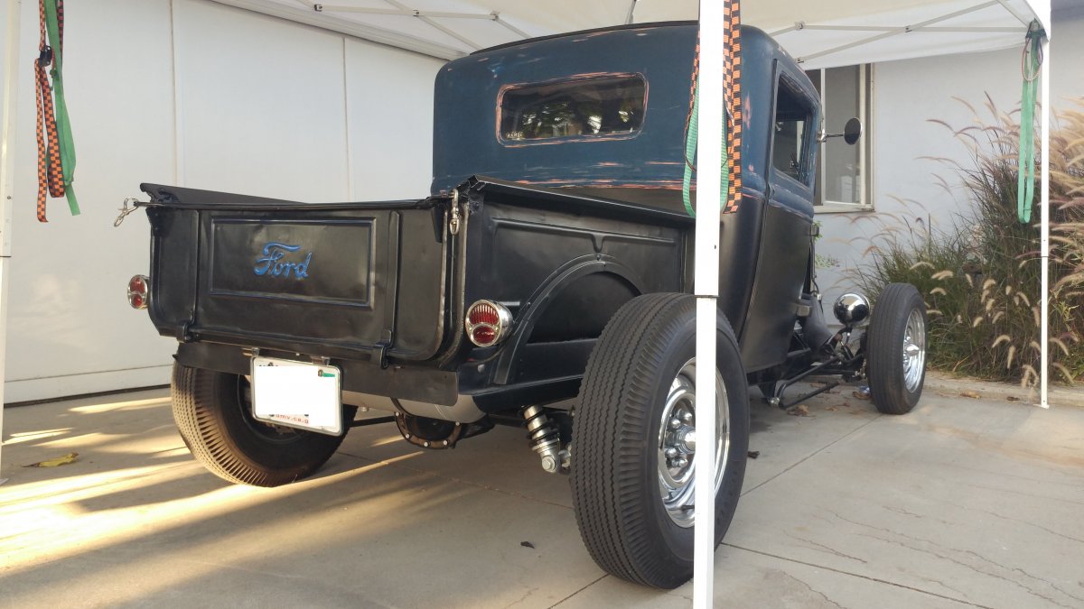

    7A7359D0-C836-47C8-B8B1-E0B95BD8CC52.jpeg Buy a pair of 32 rear frame repair pieces and add them to your frame and just bolt in the tank. I did mine in about 4 hours.
    catdad49 likes this.

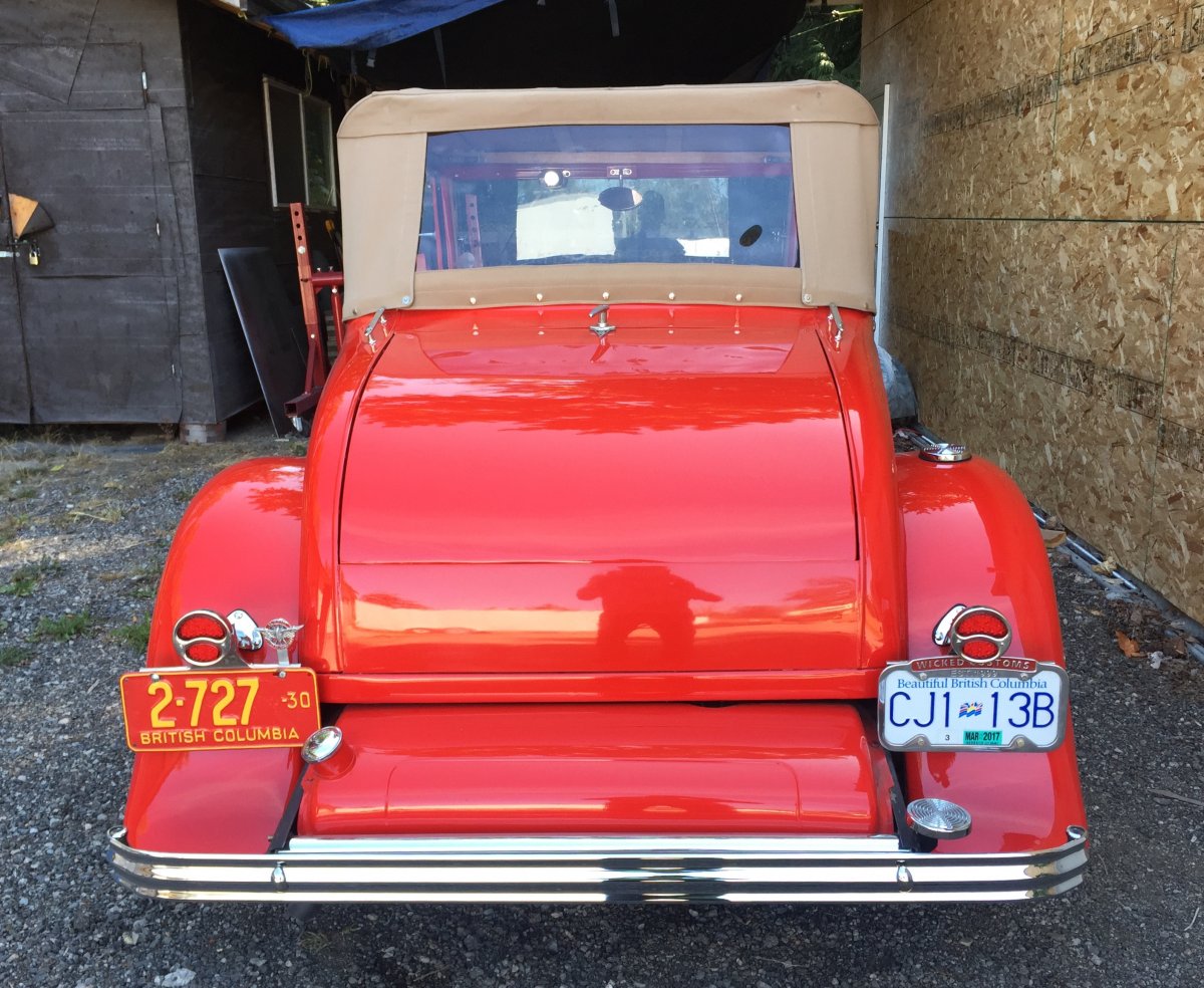

    red roadster 44.jpg I'm removing the '32 tank from my current fenderless '30 roadster project (this is a "before" photo) because it just doesn't look right back there. The body on this car was not modified to allow the tank to sit higher like on a '32 and I considered raising it but don't think I'd like it even then. Makes the car look too "heavy" in the rear. I also had concerns about safety. So I am going with a Tanks behind-the-seat tank instead.

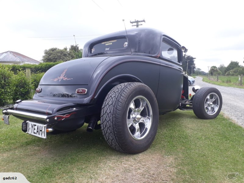

    For example.
    Bandit Billy likes this.

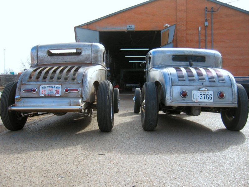

  6. There are just no words to state how wrong this looks, and a 32 at that. HRP
    da34guy and Bandit Billy like this.
  7. GordonC
    Joined: Mar 6, 2006
    Posts: 3,157
    GordonC
    Thats an interesting photo. It looks like the guy did a decent job on the car except for the dual antennas, 4 bar, choice of wheels, and the placement of the tank. How can you be tuned in on the rest of the car and miss the point so much on that tank? Think thats a foreign plate on it?
