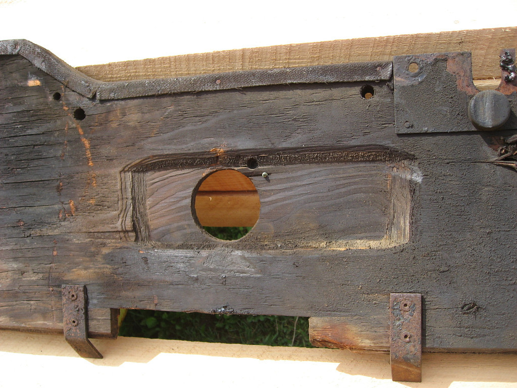

    If you want them to fit correctly you can figure a few hours labor and you will at least need a router to do the job.
  7. Here s a photo of an original toe board showing the routed out area. You do not need the round hole unless you are using a actual '32 transmission.
