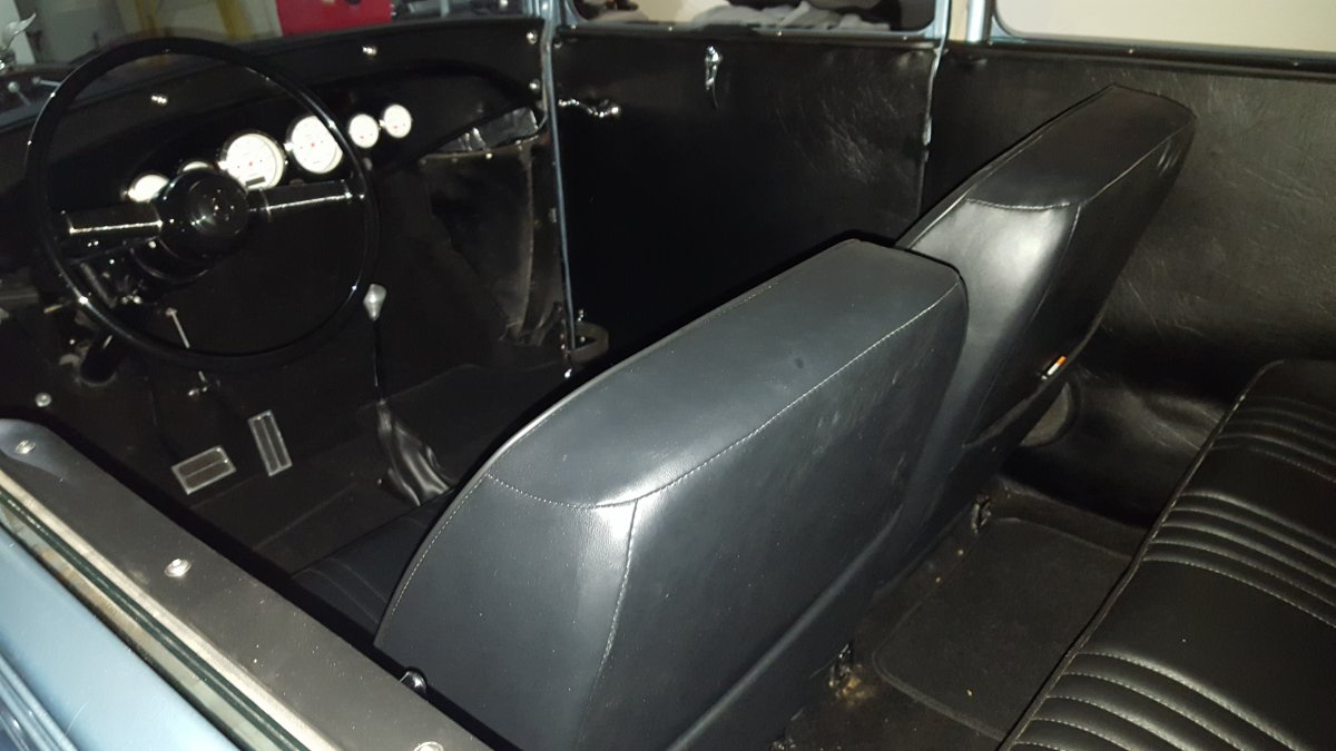

  4. 2935ford
    Joined: Jan 6, 2006
    Posts: 3,843
    2935ford
    Here's mine (Brookville).....stock dash rail.....just bolted to the existing stock location.
    kidcampbell71, bct, Fern 54 and 2 others like this.
