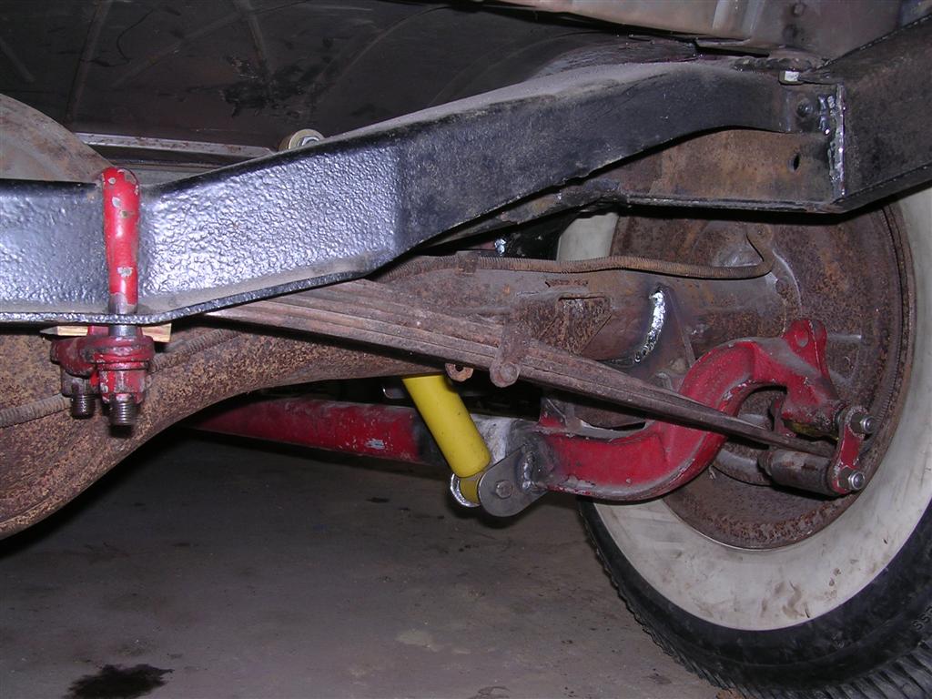

    I doubt it. The rear cross member for a 32 is curved at the spring pocket. My Deuce roadster has a newer rear cross member....35 up. Unless your are using a 32-34 spring the later cross member is probably what you want and if it is not a "Deuce" part it will be much cheaper along with the spring for it also. JMO
    I noticed it because it was bolted into the frame by some long ago hotrodder. I welded it in and kept on driving.

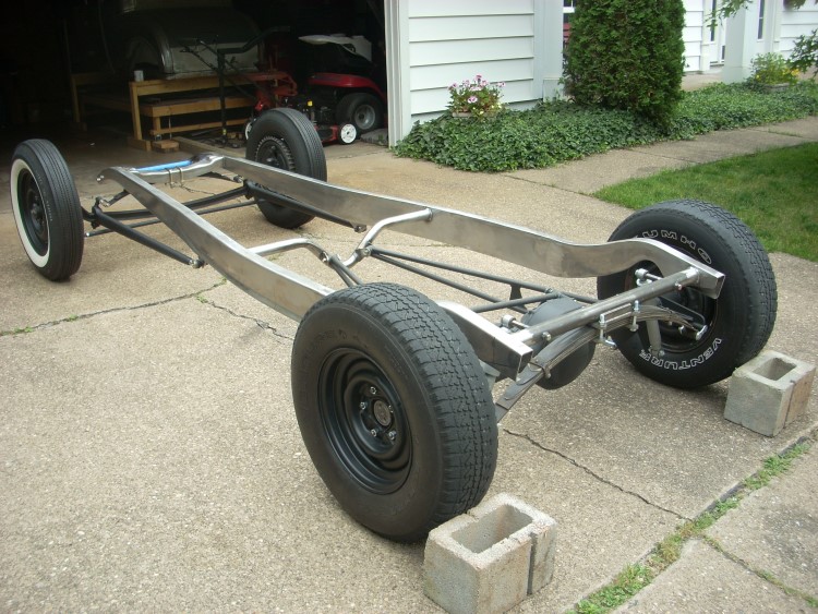

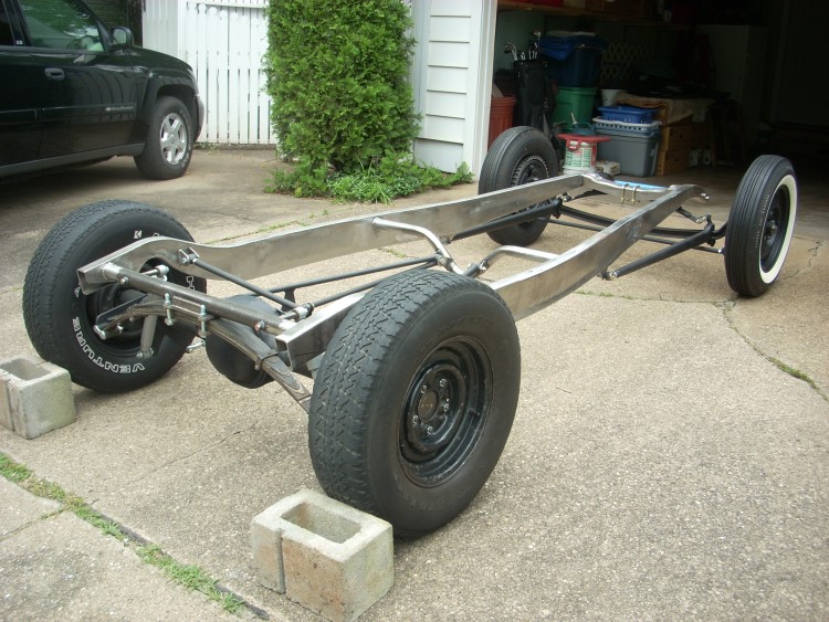

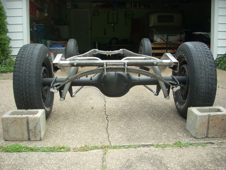

  6. i'd build or buy a rear crossmember like So-cal and Pete & Jakes uses on their buggy sprung chassis. it uses a straight rear spring , basically a `40 front

    Man...not liking that piece for a Deuce!
    Look somewhat ok on a bucket frame or something, but for a Deuce it looks really delicate and street roddy...not solid and stiff like something a larger car like a Deuce should have!
    I think the idea is fine...just the choice of materials leaves a bit to be desired, as far as looks are concerned anyway.

    You left out an important part of what I said when you quoted me...
    It's called an OPINION.
    Surely you don't expect EVERYONE to like or desire the exact same stuff!?!?
    I bet your car will look awesome once done.
    Whats under my project I don't like either...although its much more substantial than a single piece of round tube and REALLY well made for homebuilt.
