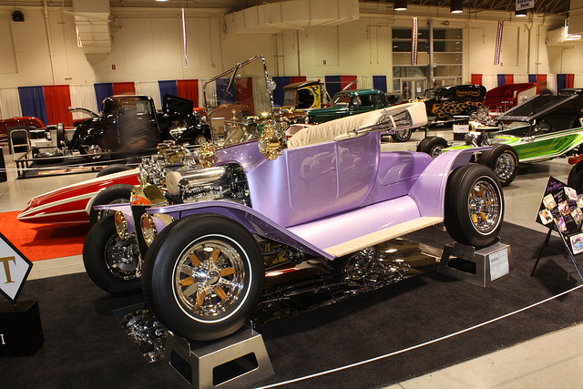

    I like your engine color, my first reaction was it reminded me of the Tognotti King T.

  30. Outback
    Joined: Mar 4, 2005
    Posts: 2,701
    Outback
    from NE Vic
    I was thinking 'The take out T" but it's darker & more purple.
