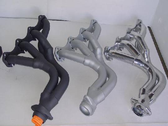

  11. TTI makes headers for the 318 poly, but I think 1 3/4" is way too big for a mild or even a well built 318, like WAY too big. Unless you put a blower on it, then that changes things.
    The drivers side is not even close to equal length either . . .
    http://www.ttiexhaust.com/Header-TTI318BC/Polyheaders.htm
