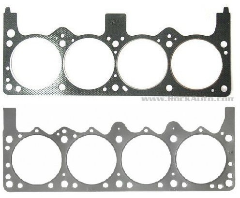

    a little image manipulation....LA gasket on top, A gasket below. Looks to me like the head bolt holes might be off a little bit?

    Looks to me like the LA gasket has larger bores, possibly because it also fits the 360 and 340. If you allow for that the head bolts look the same, although water passages are different as would be expected with the different head configuration.

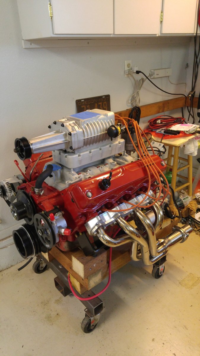

    [​IMG] [​IMG]
    The missing bolt hole in the LA cover is not a problem for the Poly block as that hole in the Poly block is easily plugged. The only problem on Poly to LA timing cover interchange is with the early 1956 to 1961 Poly blocks that use the cast iron timing cover exclusively and have a unique water pump to those years. New Mopar Performance LA timing covers are now available through Mancini Racing and other Mopar Performance vendors for the Mopar LA and would fit on a 1962 to 1965 Mopar 318s. “Fel Pro still makes valve cover gaskets for the Poly 318 Mopar engine (PN Fel Pro VS11828 R ).
    Some of the above are excerpts from information readily available on the web and were just copied to save time (and not forget anything).
    As to modifications and aftermarket parts, there is a boat-load of stuff available like larger valves, forged pistons, headers, intake manifolds (old and some new), connecting rods, piston rings, stoker crankshafts, etc. etc. As one of our Aussy friends stated, Rockauto Auto has quite a few parts available. I may have an Edelbrock 3-duece manifold available and a custom 3-deuce to single 4 barrel adapter I made (show in the attached picture with a supercharger top adapter). Due to height restrictions, I'm going to a slightly lower, custom intake manifold for my small supercharger.
    The poly engine (with heads attached) is actually wider than a big block Mopar and yes, a little heavier than an LA series engine. However the valve arrangement makes for much better airflow as compared to an LA series engine. If looks are impressive, that may count. My engine below is a 110k mile original and is my "test-mule" that I'm using to adapt to my pickup and then plan to swap-in the new engine. I intentionally stayed at a stock stroke and even at that should be right at 500 HP and extremely streetable. By the way, those are Ford headers I'm running with my custom adapters. There is a fellow that makes steel adapters for running the 3rd generation Hemi (shorty style) headers as well.
    What ever you do, have fun. These are surprising engines are great fun to mess with.
    - EM
