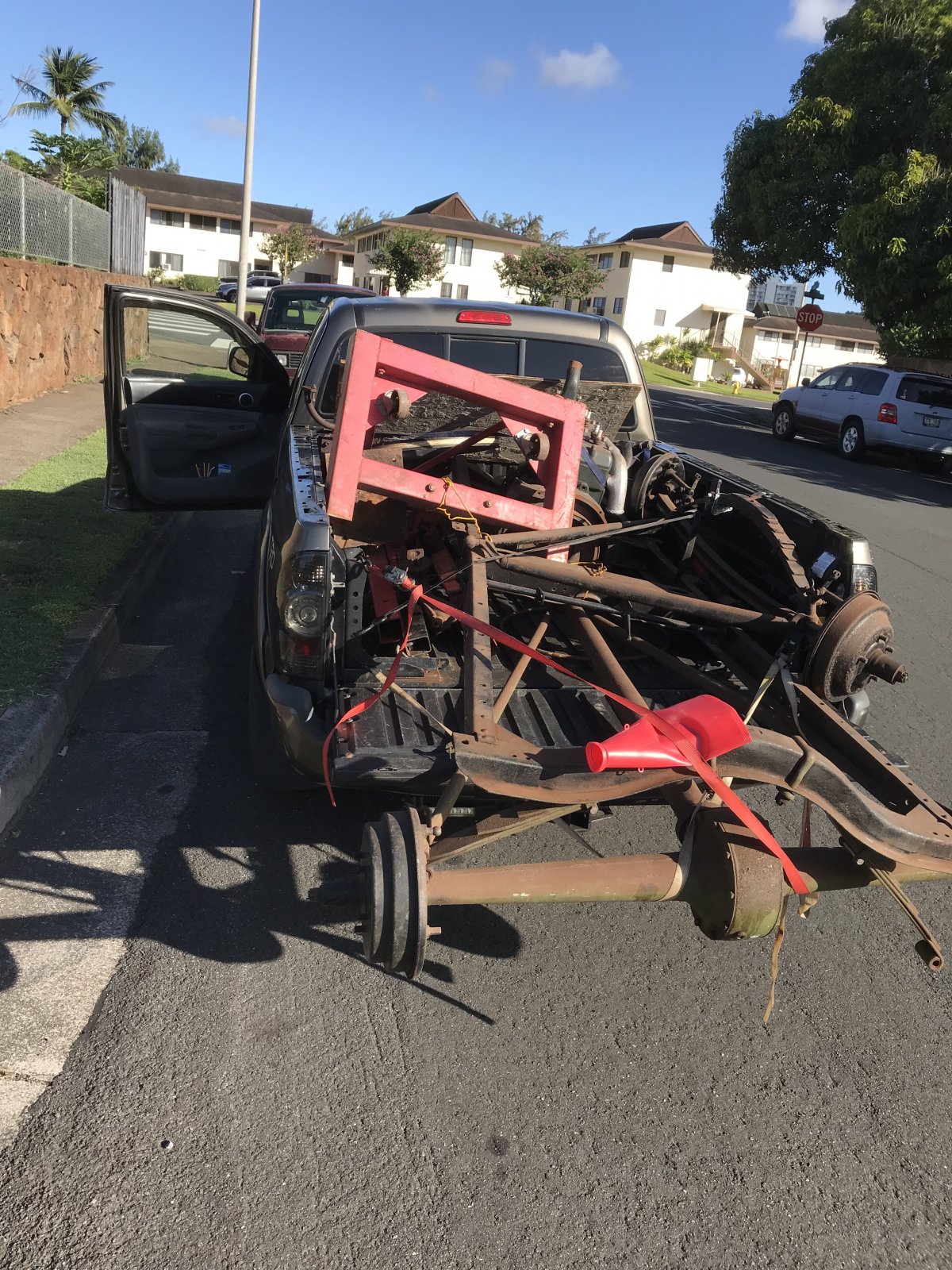

    The deal was to help clean for a discount. Twas an Estate sale.
    Load 1

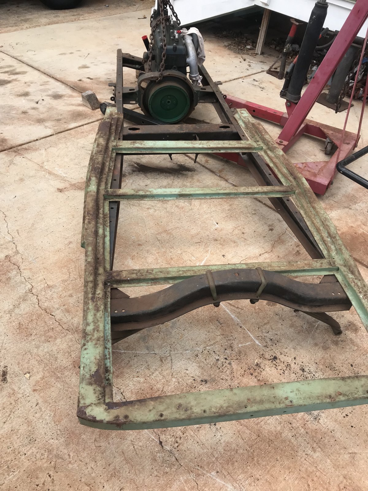

    Frame is Cherry! Grandpa had been working on this part.
    Best thing about that Toyota Truck is it was made in Texas.
    40ragtopdown, AHotRod and Stogy like this.

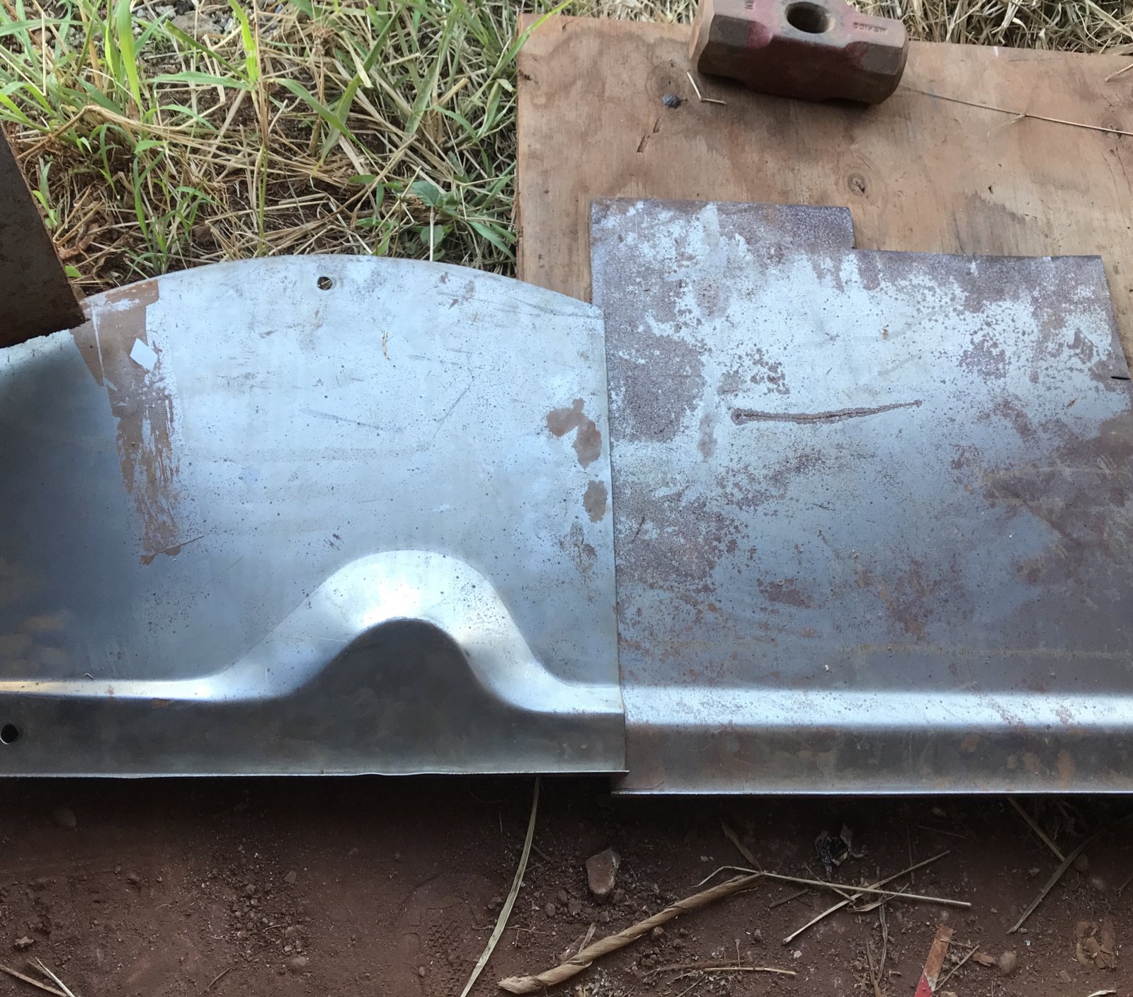

    My first patch.
    I know this piece is available from the suppliers and is reasonably priced but shipping to Oahu is outrageous.
    Every time I order large auto sheetmetal it arrives damaged. Price of Paradise I guess.
    Made some 1/8 plate to match sub frame. Bent some 1/4 by 1 inch steel bar for revel and added some 16 gauge sheetmetal to reach high enough to replace most of rust hole.
    Trimmed to fit between T~bars. Welded edge to edge to edge, no darn layers or laps.

    Sedan corner patches were about 7/8 inch to narrow, so bent flange over.
    Grandpa adjusted many things with the ball peen hammer approach.
    Sharp eyed regulars will notice my reveal is too pronounced.
