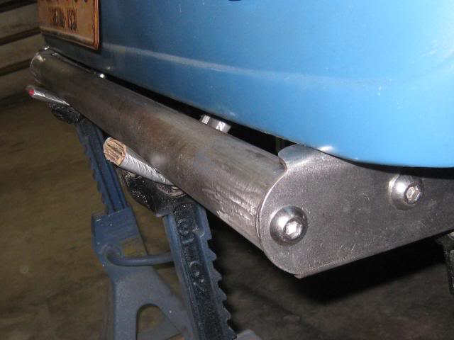

    Next, I made up a rear spreader bar to match the front one and made rear frame rail extensions to position the spreader bar. (I bobbed the rear rails early on.)

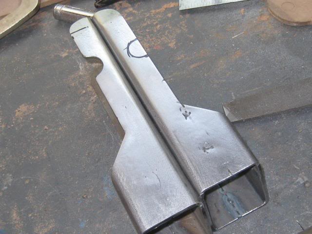

    I started with the rear horns I had cut off.

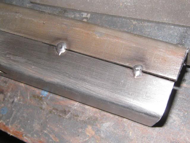

    I made a pattern, marked the horns, cut out the shape and welded up the wedge.
    Next I proceeded to box one end on each to give me more surface to weld when I attach them to the frame rails. I just used scrap from the horns.
    After a little trimming, shaping and filing, I had a pair of these.

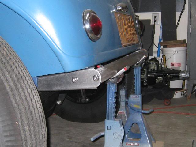

    I then test fit the spreader bar.

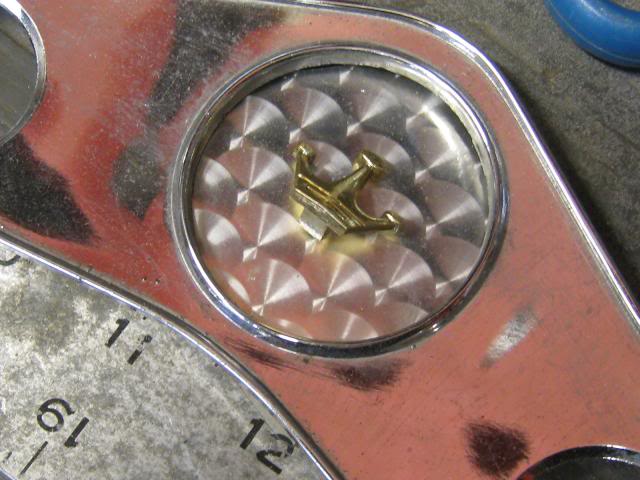

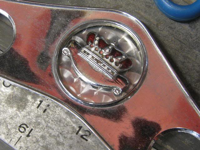

    I've also been messing around with my steering wheel horn button. I originally had a Chevrolet motor, so the Impala logo made sense, but now I'm running a Chrysler. I still dig the 59 Chevy steering wheel, but I wanted to add some sort of Chrysler logo to it. I decided to add an Imperial logo to the horn button center. So far I've cut out a circle of engine turned aluminum to match the dash insert, and I'll add a 1950s Imperial crown logo onto that (when i find one).

  24. Nice work on that spreader bar, looks like it belongs there! I keep forgetting about friday night at Kroger's parking lot, have you been?

  28. So what do we like better? I prefer the looks of the gold 57 – 59 Imperial crown emblem but it's a little small for the space. The red late 40s/early 50s Imperial crown emblem is a little big. I'm considering cutting off the banner at the bottom of the red crown to see how that looks by itself. Opinions?

  29. I like the red crown and think it would look better if the scroll was gone and the crown was centered. Also like the spreader bar.
