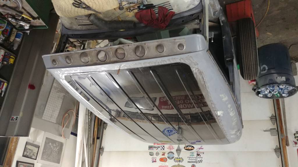

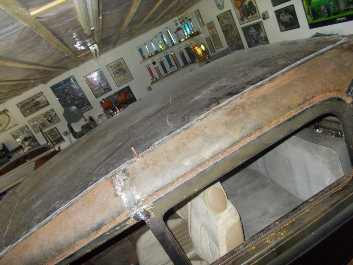

    Accidently found a great patch for the A.
    Walking the junk yard looking at roofs spotted a 04 jeep grand Cherokee and invitioned on backwardsNo reshaping required! 0308182009.jpg 0308182009a.jpg 0308182009.jpg

    Joe, that looks great...and no shaping at all? Wow. I might consider that for my 30 Tudor. So, when you went to the yard did you get the whole roof....I mean you cut the door and window posts or did you cut the panel out on site? Just curious if I do this. And you must have used cordless saw??
    Thanks for any info.

    Yes, cut at pillars. These a roof rack system that you got to remove once home, it double paneled under it. Cut a slot to get seawall blade in to remove the center. You'll also note I had to close up the opening a couple of inches. Now prep surfaces for panel bond...no welding, you don't want to lose shape.

    And yes, bring 4 charged batteries

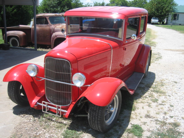

    Nice build, right grill an wheels for that car

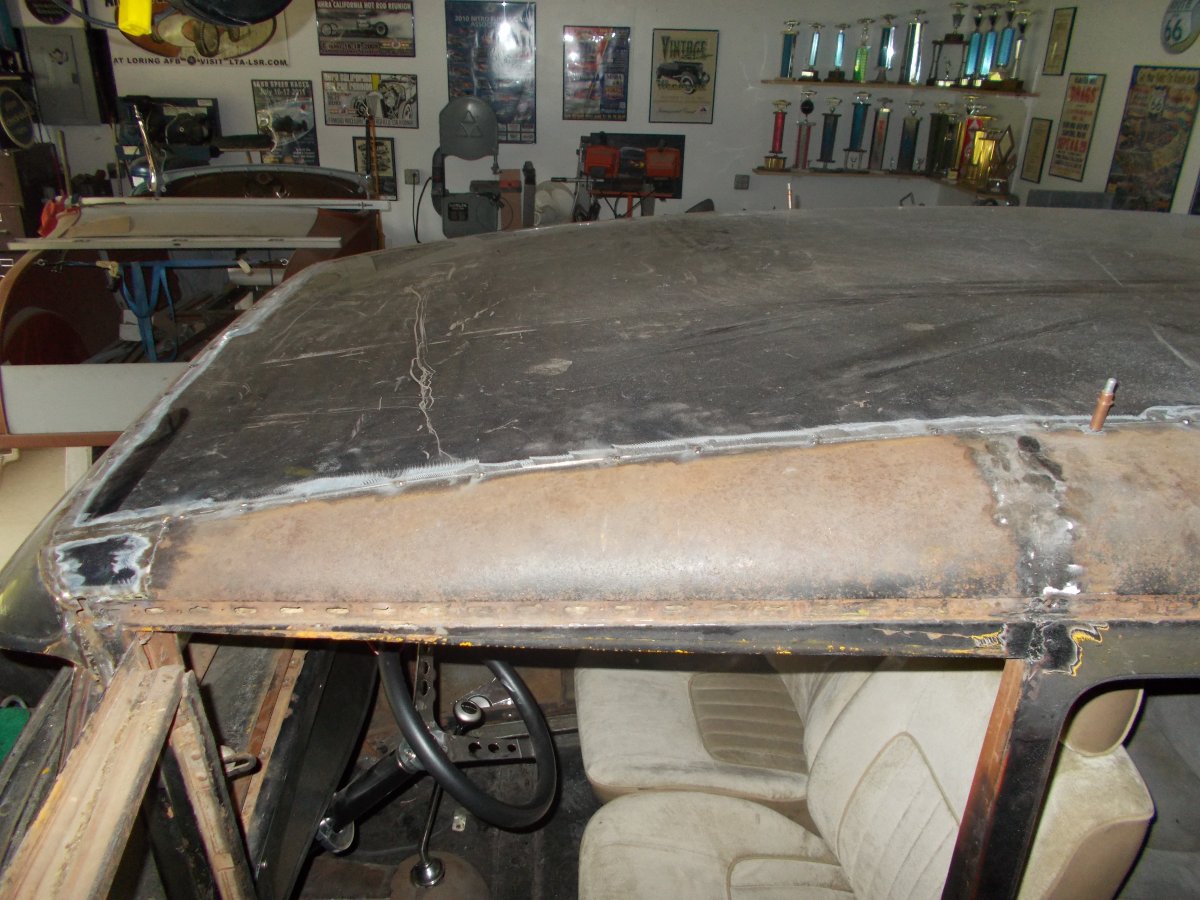

    That looks very nice, you did a great job. I used a roof from a BMW station wagon when I did mine, also very little work on the contour, makes me wonder just how many more modern cars have roof panels that would work on a Model A? IMG_2654 (Small).JPG

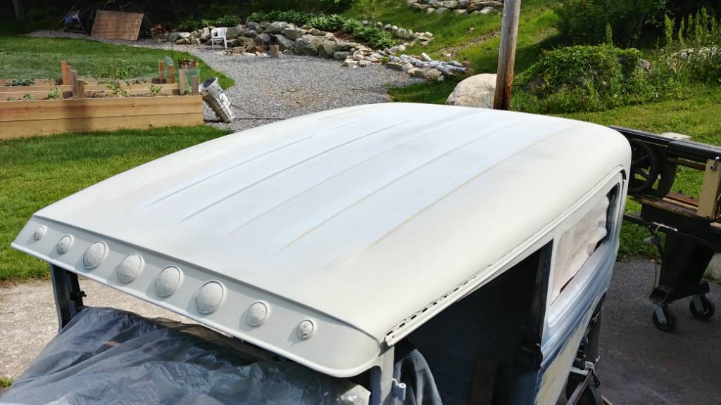

    I 3m panel bonded it to avoid warping, never did put a micrometer to it

    The old standby was 62/63/64 GM station wagon roofs. How do the ones mentioned here stack up to those? I mean has anyone used the GM roof that can (from experience) say how much work was involved or if the contour needed reshaping? I ask because there's a good probability that I might soon be involved in filling a 30/31 sedan with said Chevrolet roof. I would like to know ahead of time if we would be better off finding a different roof to use.

    Understand your concern.,
    A van or station wagon roof you must admit is pretty flat. I STUMBLED. on this 04 Jeep roof keeping the model a contour in mind. The jeeps windshield curls downward like the Ford's rear section and the rear window of the jeep flattened like the Ford's windshield.(mines on backwards) Also I felt that around the "B" pillar the roof dives down toward the windshield..the jeep had all of that.

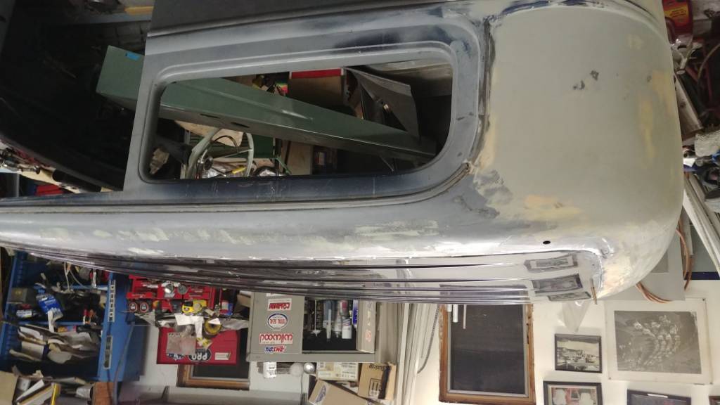

    In one of my other posts I mention that I added about a 3" flange to the A opening .
    By the time I trimmed our the jeep I needed surface to glue to. Seriously, there was no shrinking, stretching or reshaping to do. My biggest gap couldn't have been 1/16". Put sand bag weights on it when bonded.

    Joe, are those the filler pieces I see going down the sides, like the roof panel wasn't wide enough? ?

    Correct, you do want the metal on top because (but on tight) as you fill you need your mud to stop before the rib. Otherwise , if butt fit you'll have a valley or you'll be filling into the rib.

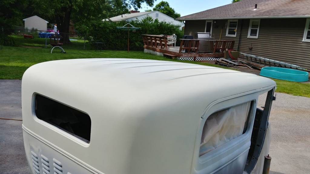

    Did you leave side and cross wood in to support the patch in position when installing , and afterward? And also while the side fillers were welded in?

    No, the original wood gone. The roof came with 2 supports and kept them in to hold the shape. Did make extensions to reach the opening ridge.
