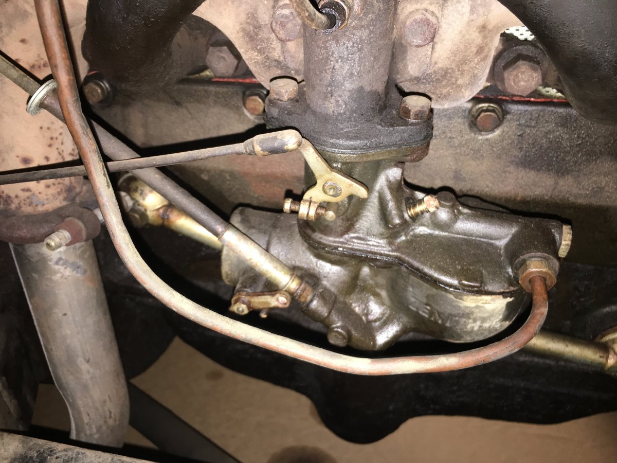

    My 31 Fordor banger will start and idle but when I push the gas it wheezes and dies. It'll start right back up and idle but I can't drive it. Before thanksgiving I wanted to wash it cuz my grandpa was coming. I fired it up and let it idle for 10 min. Drove it into the driveway and thought id take it around the block. Got about 50 yards and it died. Then it didnt want to start back up. Pushed it back into the shop after washing it and its been sitting. Today I started it and it would idle but wheezes and dies under load. Its all stock and I mean 1931 all stock with a Zenith carb. I went through the carb a few years ago to get it started but it has never wanted to stay running. I have monkeyed w the choke/adjustment knob(?) etc not joy. The timing has to be fully advanced to start it, not sure if that means something to someone. IMG_5656.JPG I tried the search feature but came up empty. Any help is appreciated. I am just south of Austin. Thanks and Merry Christmas

    if it has to be fully advanced [left lever down] to start, the timing is off. it is adjusted by loosening the screw under the rotor and turning the distributor cam. if turning the choke/mixture knob doesn't change anything the carb is plugged, in the passage that runs through the "elbow", seen at the end of the choke rod at the bottom of the carb.
  3. Recheck your timing then close the choke valve (mixture) and open it back up about 1 1/2 turns. Make sure you have good gas flow to the carb. Remember that there is a pencil filter inside the tank at the shut off valve that could be plugged. Try and start again. Let it warm up some and adjust mixture until it smooths out.

    I have closed the choke screw and backed it out the recommended 1 1/2 turns. How to I access the pencil filter? When I open the drain valve at the fire wall gas comes out. I pulled the gas supply line and blew air through it, it was clear. Thanks for the suggestions

    will it accelerate if you keep the choke pulled a little?

    No. Doesn’t want to stay running choked

  12. Your symptons sound more like bad condenser than fuel. Have you looked at your points lately?

    I just this week went through the exact same issues on a 31 A. When it would start to die, the choke really did not help. It would finally die no matter what I did to fight it to run, but it still had spark (but a bit orange), I could not get one pop out of it no matter where the advance was. Condenser was the issue.
    I've heard about Model A condenser problems before, but I've never had any car condenser that was OK at times, then die, then next day would start Ok...but die again later.
