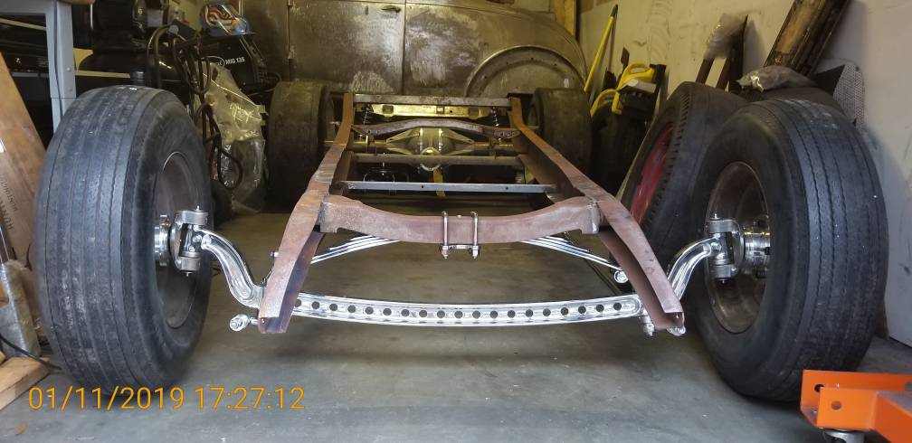

    Dick, please explain what you mean? Inside the rails? I see the positive. And I still could widdle something like that to work. But are you meaning on the outside of the recessed or flush rails?

    Do you plan on welding crossmembers to the boxing plate ?

    Yes. That was my plan. I have the rear section recessed too.

    Adding conduit inside the boxing will give you a better way to run the needed wiring in and it will be easier to pull the wiring thru than trying to just inside the boxing plates.

    I like the conduit idea better. Just a suggestion, the part of the conduit bends, point it downward as it exits the frame. That way water will need to travel uphill to enter the conduit. Maybe even a grommet to keep things out.
    Are you boxing the whole frame? I am boxing the front, adding a x member in the middle area and I already boxed some of the rear.

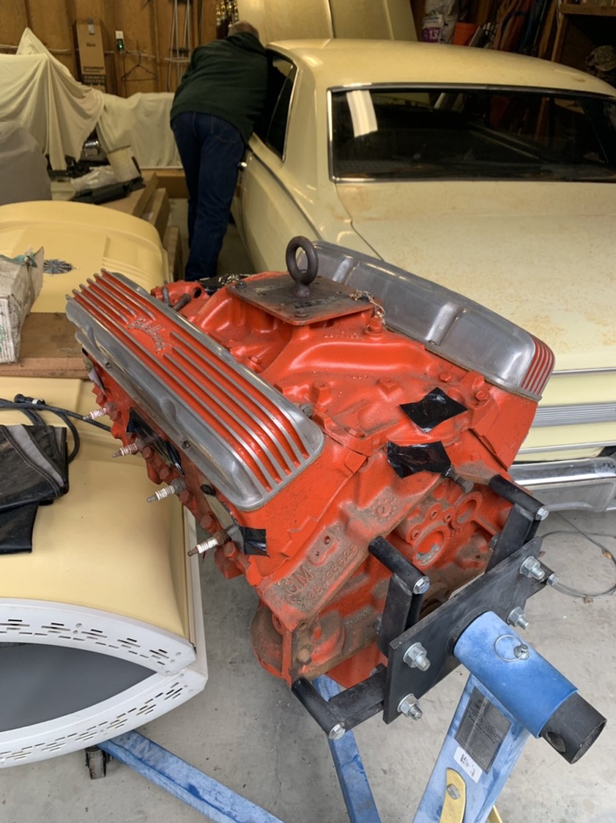

    Been a while. I’ve been having trouble posting more that one photo at a time on my phone app and the home computer is always so far away! Anyway got my hands on what I think is a great power plant for my build. I would love any input on this but I was told it’s a 283 out of a 1960’s Chevy. Haven’t ran the numbers yet but it was rebuilt 30 years ago from a former engine builder and never ran. As far as I know it has power pack heads and 4 barrel Rochester Intake setup. IMG_1279.JPG

    You scored BIGTIME on that 'ol 283 Eddie!! You have a period, steel crankshaft mill that most likely is bored .030 over. Those Edelbrock finned valve covers are the cats-meow too!! You may decide on a multi-deuce intake setup to continue the savvy hot rod look that we all crave - your decision of coarse. Does the engine spin freely? Those rings have been sitting for a really long time, you may want to shoot some Marvel Mystery oil in the spark plug openings and turn the crank by hand to get those rings and cylinders lubricated. Also, get an oil pump primer (driven by your drill) while there is no distributor and prime the engine with engine oil to get oil up into the valve train area as well. Do this from time to time so at initial start up, your 283 will be well lubricated and ready. She'll smoke for a few minutes from the Marvel oil, but will clear up and ready to CRUISE!!! Exactly how I did my initial start up of my 283 from almost 20 years of sitting.
    My hot rod originally came with a '61 283 and Turbo 400 from a truck application. Loved that mill, believe me. Any thoughts on a tranny?

    I see the oil gallery plugs are original. I would question any "rebuld" done without removing those plugs to clean the block.
