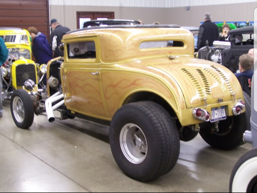

    Here's a friend's 3 window

    C472A998-F837-49ED-B443-BC6A65542840.png 5” chop 5” channel 2” section.... I don’t see a rat rod here

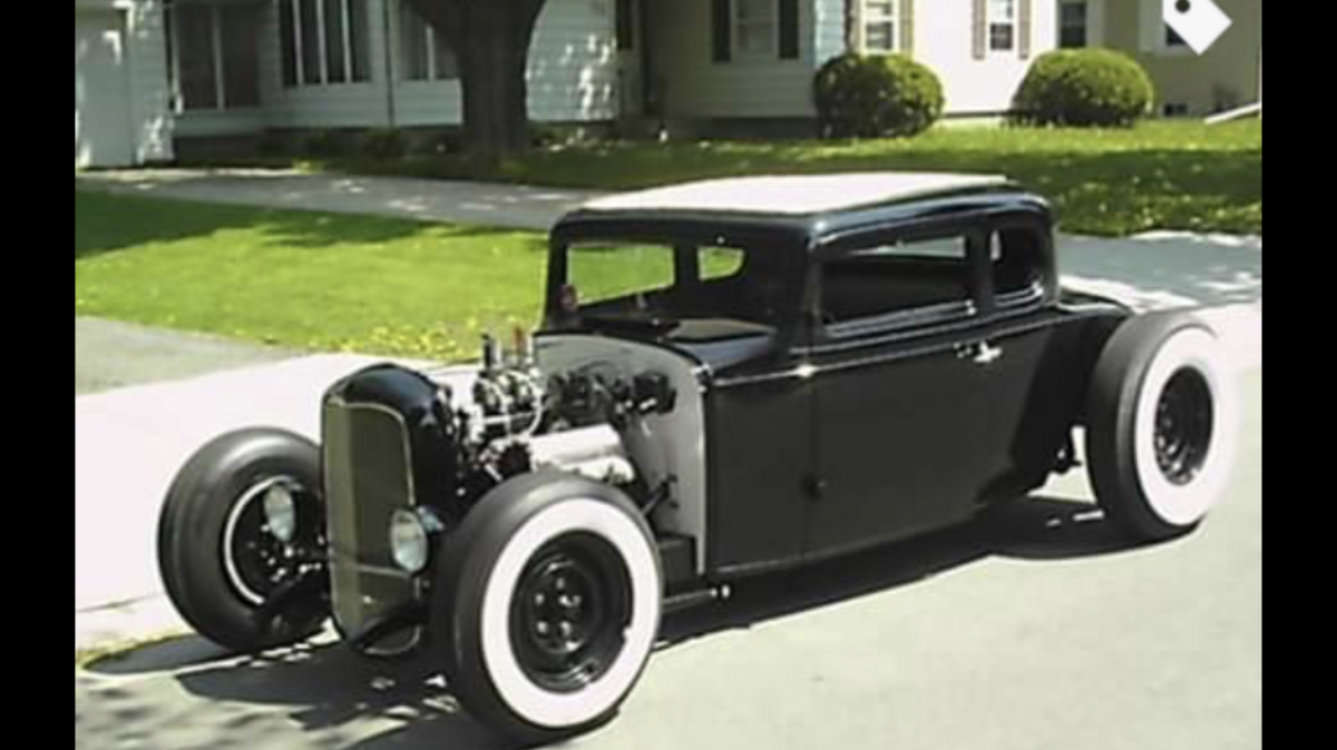

    Look at history, study the old black-n-white photos, I have ton's of them …. and my cars are low (4" from the bottom of the frame to the ground), mild chop, 1" to no channel, etc-etc …. point is, if you want to be able to sit in it without tilting your head-neck-shoulders all the time, spend the time to get your ergamonics "right/correct and then design and fabricate around it. I've been building my and others Hot Rods like this for over 40+ years.
    Here is a picture of my last Hot Rod Sedan that I built …. it's very low, had plenty of power, rode and drove great, could see out of it without pains in my neck and was a blast.

  15. Damn !! Cool as hell. Guess we can expect that from you though .... wow.

    AhotRod, that is one sweet sedan. That's along the lines I'm shooting for with mine.
