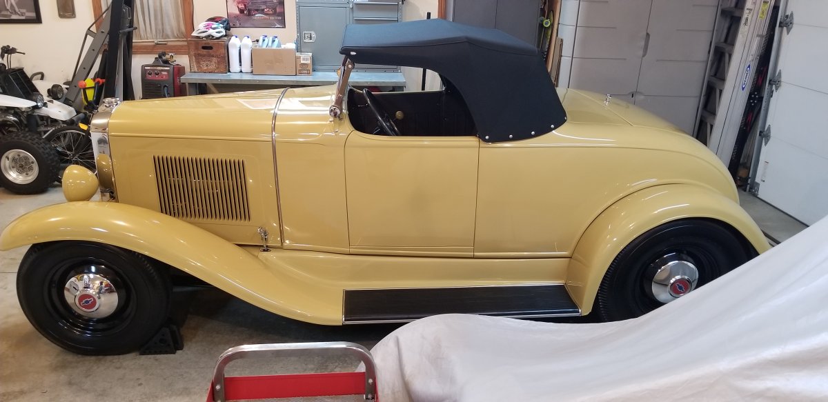

    Rear End? I just finished building a 31' Roadster with Steve. The one with the Sierra Gold Coupe. It's not ultra traditional but most everything is mid 50's. It's shitty out here but here's a garage pic.

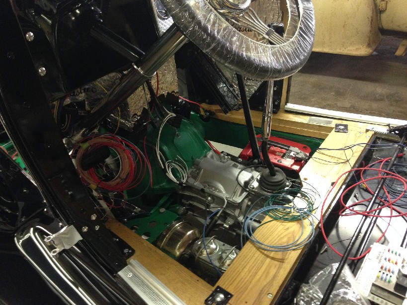

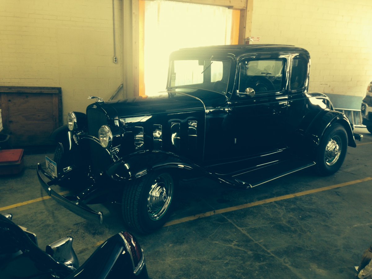

  13. My buddy, Bob's 32. He used a 261, T-5 and he re-wooded the body. Bobchaleks32coupeinterior.jpg bobchaleks32chevy.JPG

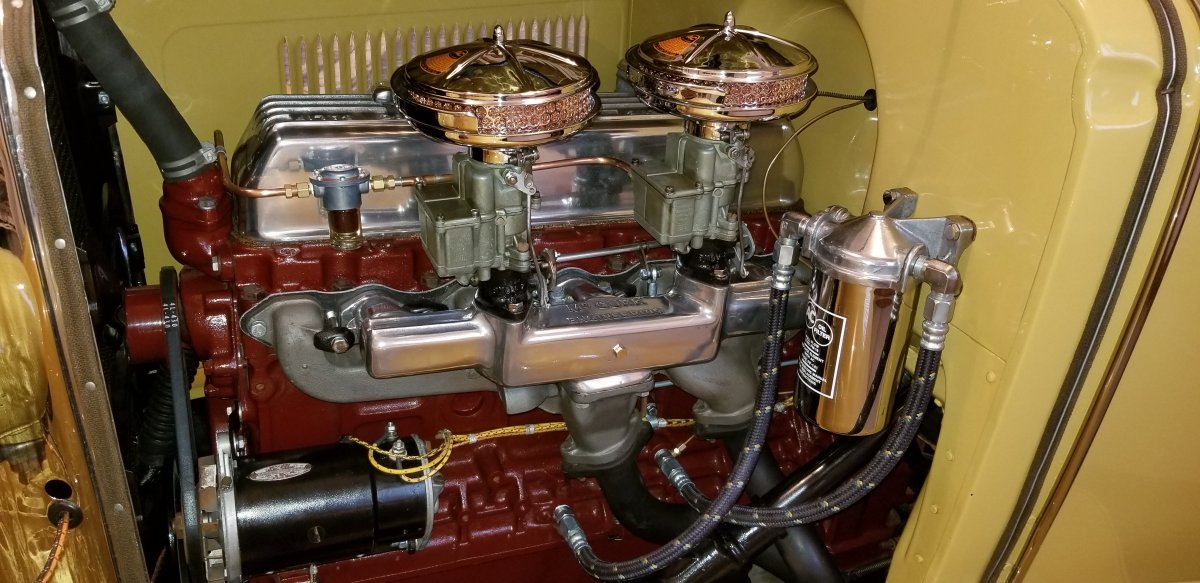

    Don't want to hijack the thread but here's the motor....261 w/a Packard Overdrive
