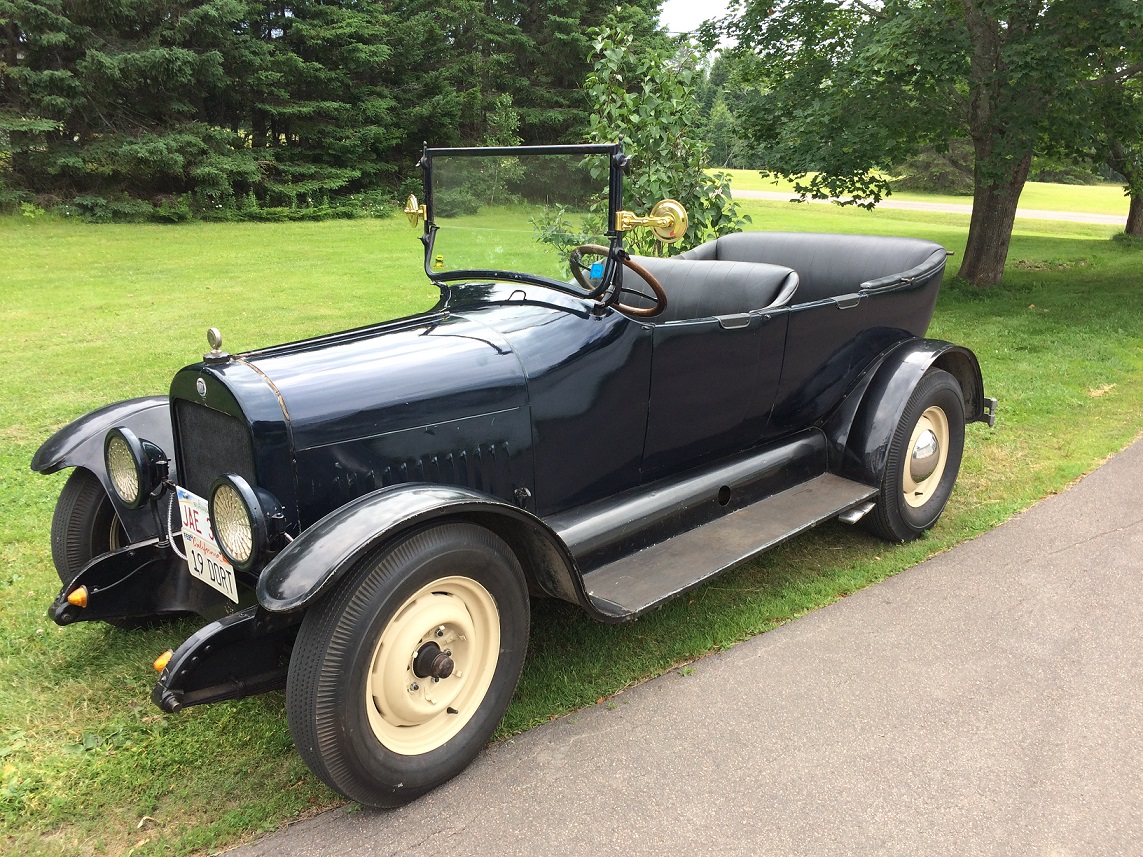

    My 1919 Dort is basically wood, skinned with metal and I do not have a top to help.
    It is bowtie V8 powered.
    I lowered it using a 4" 50's Chev pickup axle. It fit nicely with the stock Dort parallel springs. I used a Vega box for cross steering.
    Make sure you stiffen the frame rails as they will flex quite a bit and you will have some fun keeping it going straight down the road.......also mind your front and middle cross members to help stop the flexing.
    Good luck!.....keep us posted.

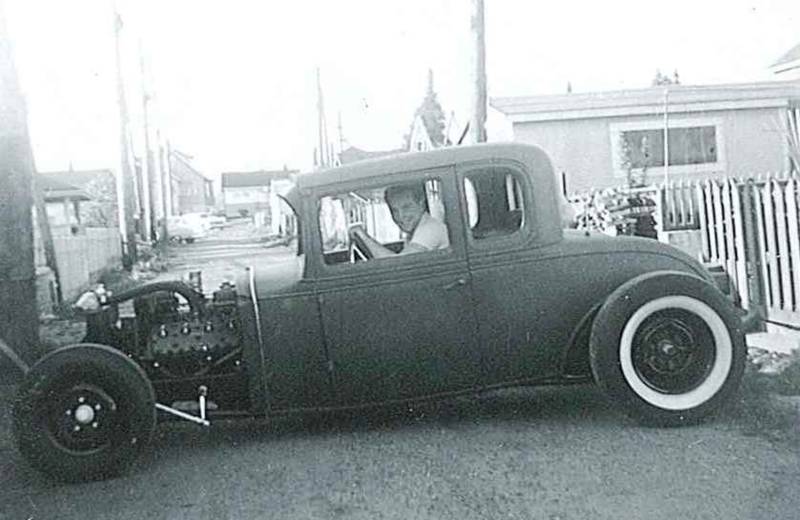

    My very first hot rod was a 33 Chevy 3 window coupe. The termites had gotten to the wood.
    I replaced all of the wood with square tubing and channeled it down over the frame .
    I used a 324 Olds and hydro. Sorry no pictures but this was mid 60's.
