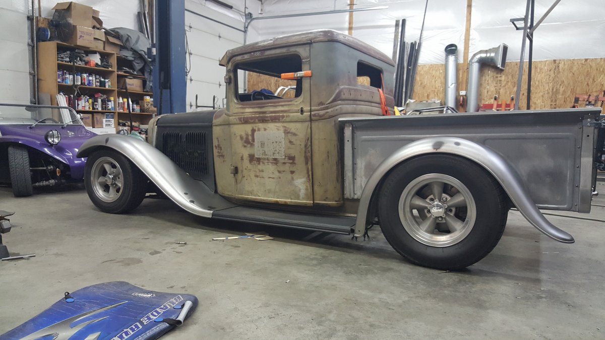

    IMG_0964.JPG IMG_4265.JPG I just picked this up and can't wait to get started.

  22. Langan

    Those are both beautiful trucks. A '32 Shell is not needed. I to would take work to make it fit the '29 hood.
