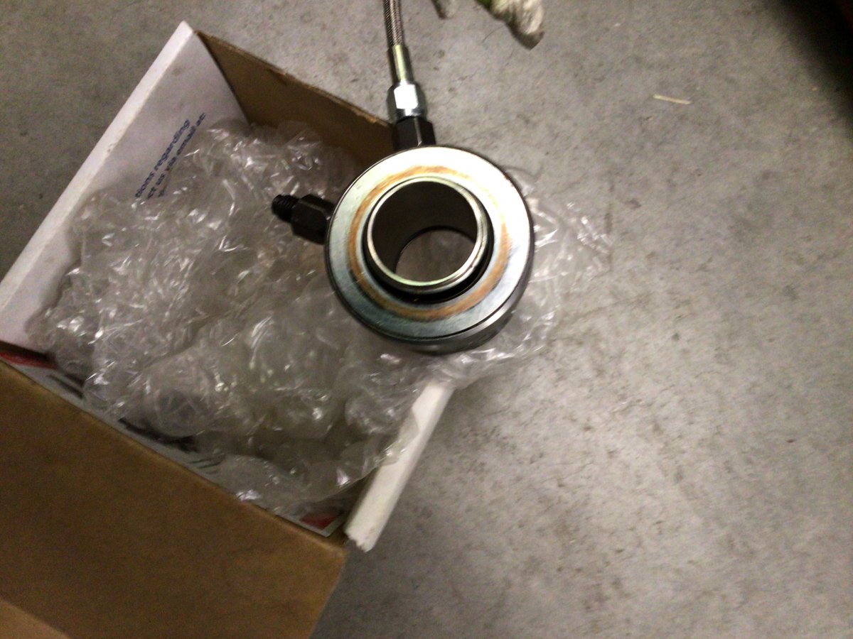

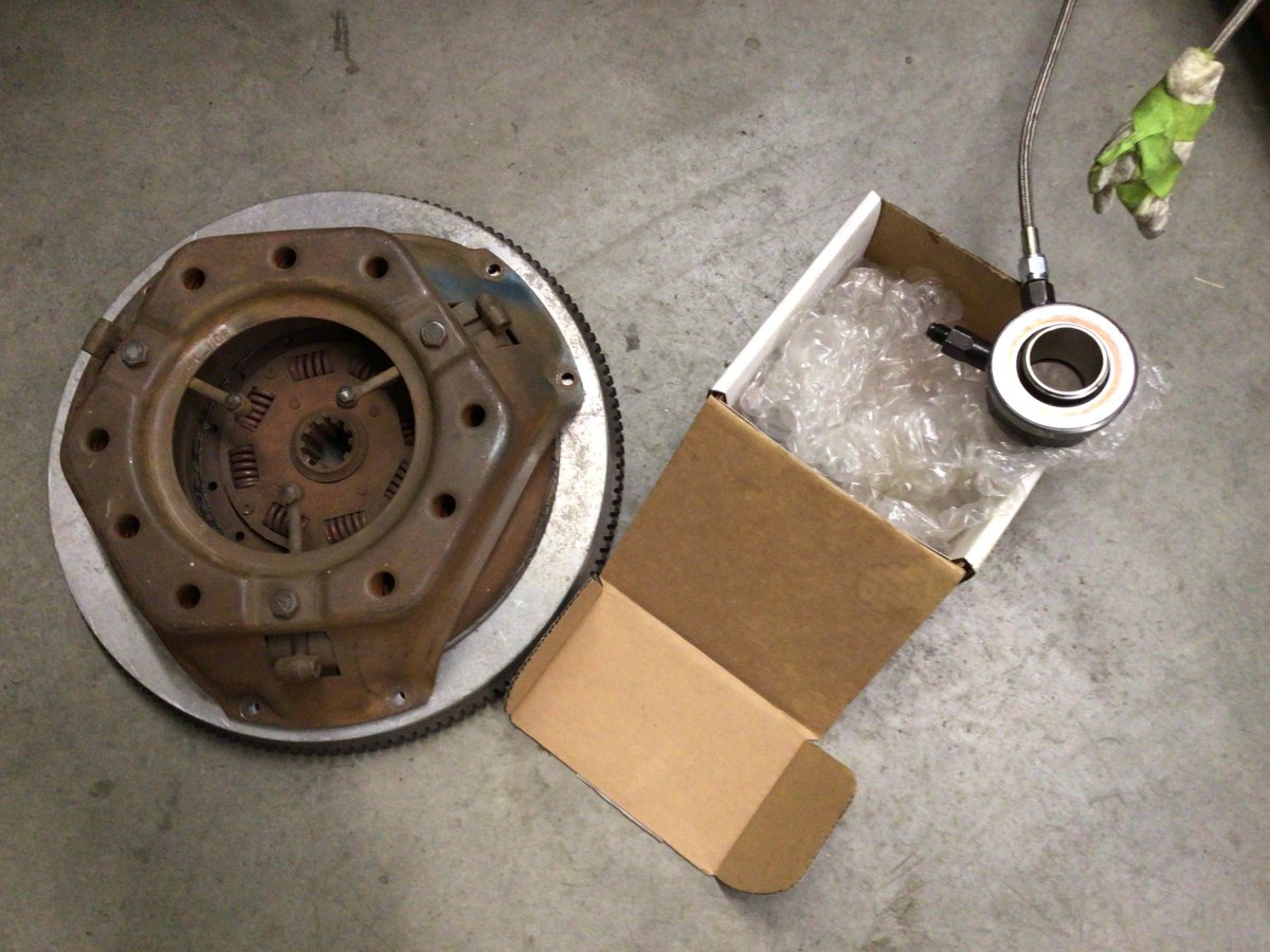

    I have a 303 motor ,aluminum flywheel and Muncie 4speed. Cutch was for a cad lasalle trans .the clutch is large Ford ( early Ford style) I would like to use a hydraulic throw out bearing but the one that fits the Muncie isn’t big enough dia. To work! Suggestions other than re-drilling flywheel would be welcome. E985F8FE-2647-4199-ABF2-7E1BD8B21051.jpeg 08DBA714-14FD-40CB-A0DE-5AF2DF417E5A.jpeg DFD60BE4-48E9-4AFF-8D62-7CC75D7481D2.jpeg 62E0F0D1-F5CB-4FE5-BD86-6174B864DDE8.jpeg

    Make a ring ( washer ) 3/8 thick may be thicker (1/4) to go from throw out bearing size to Pressure plate finger / lever,.. sometimes you have to think outside the box & experiment!!

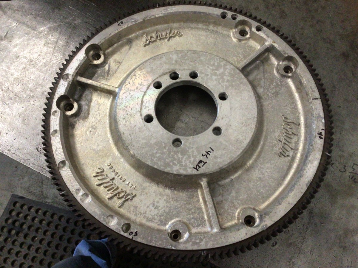

    Why is it not re drillable? Is it too thin where the chev pressure plate holes need to be? I have redrilled aluminum flywheels but never a 303... picture of the engine side of the flywheel?

    A hardened washer should work

    Maybe it would be easier to get a clutch fork and an early ford throwout bearing. If you must have a hydraulic clutch you could just put a slave cylinder on it. This setup would be far more serviceable in the event of future hyd failures as you would not need to remove the trans to repair it

    You could look for a hydraulic throw out bearing that is large enough to fit the Long type fingers, Then see about adapting it to the setup you have. When I had the same deal without the hydraulic deal I had to make a brass bushing and press it into the bearing to make it fit the collar shaft.

  9. I won’t use another hydraulic throw out like those. I’ve had Nothing but problems with that style. I’d do like @Moriarity said and use a early for fork and throw out bearing hooked up to a slave cylinder. When the hydraulics need work for the clutch, you don’t have to mess with pulling the trans or motor out.

    Above is the way to go. I had a 32 5W I put a 55 Olds engine in, 11" ford pressure plate with a 10 1/2" disc mated to a 39 trans and used a hyd slave cyl. No problems. P/Plate bolted right up to the Olds std shift flywheel. All info obtained from the "little" books back in 1961.

    My reply was why the fly wheel could not be redrilled.
    Do you have insight on that ? The PP looks to sit way outside on the edges, so maybe no meat there?
    Anyways, that is what I was wondering:)

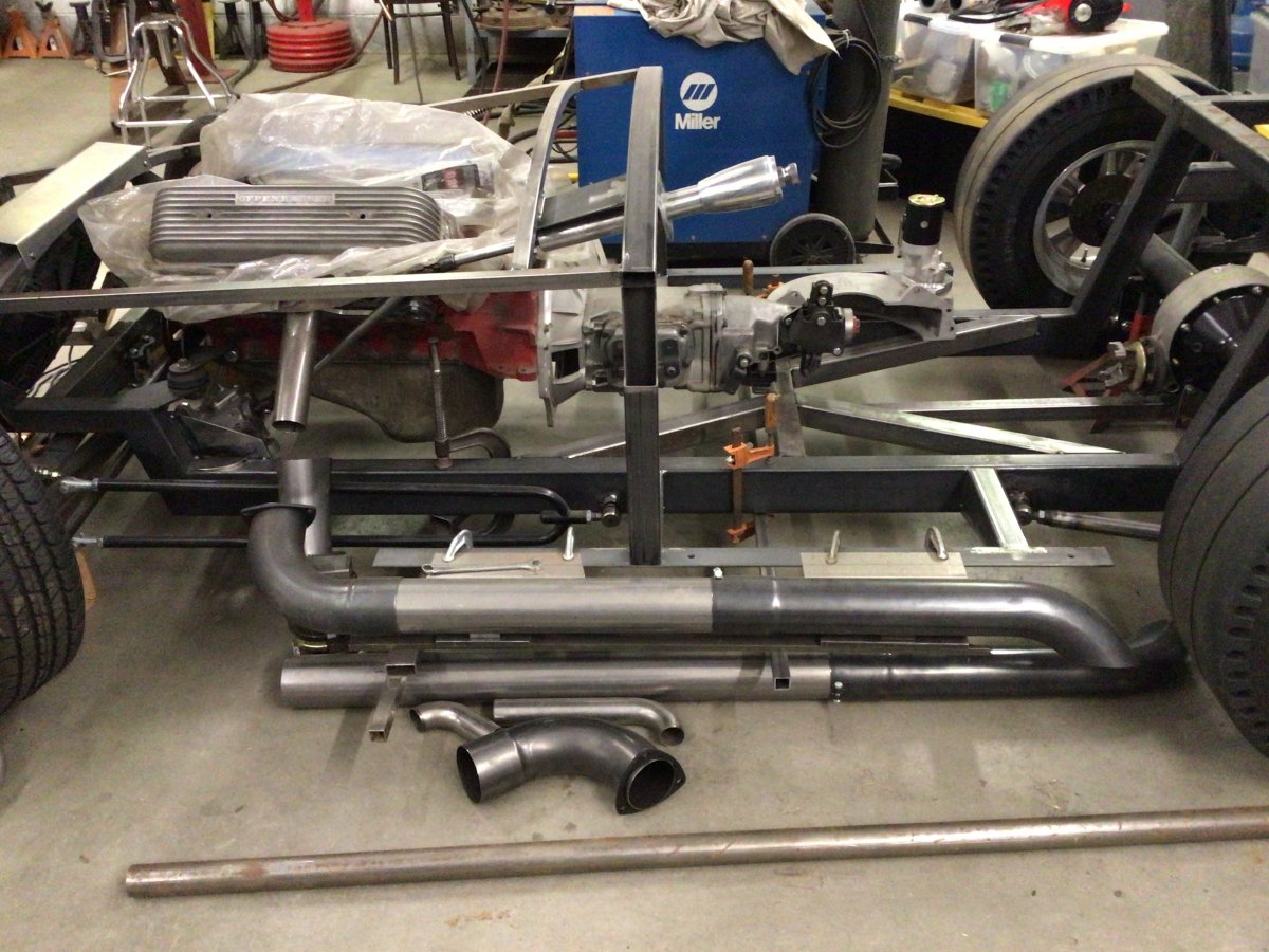

    IMG_3459.JPG IMG_3463.JPG IMG_3475.JPG Thanks for all the replies. This car is the last to use up some of what is still sitting around that I didn’t have the heart to sell off. Car is a fiberglass cobra body Ford dropped axle 471 blown 303 olds Muncie 4 speed and quick change rear. Only problem so far has been the clutch. Motor has a really nice aluminum flywheel and I sold off the stock flywheel . Using a slave cylinder is going to make the most sense but take up some room. Thanks for input now on the hunt for a flywheel.

    Here is a picture of back side of flywheel. Should have shown this in original pictures View attachment 4986870 View attachment 4986870
