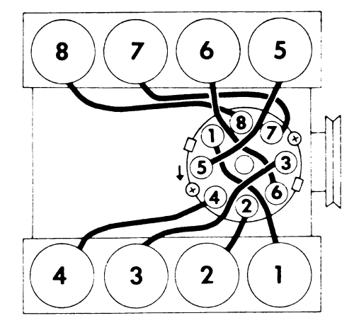

    Might have the other cam/ firing order. Ford 302s can have two different firing order.
    Bones
  4. Mr48chev
    Joined: Dec 28, 2007
    Posts: 33,948
    Mr48chev
    Bones hit on something that I would have missed. ford-v8-firing-order-ford-engine-firing-order-of-ford-v8-firing-order.jpg
    Boneyard51 and Deuces like this.

    I tried all of the newer firing orders before the teardown and the old 302 one worked best. I'm going to try a gap test, I'm strongly suspecting an ignition related issue..

    I dont think it would run without back firing using a later 5.0 firing order. I'd put in a 7.5-8.5 p/v to start.
