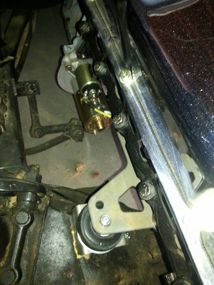

  11. brokedownbiker
    Joined: Jun 7, 2016
    Posts: 652
    brokedownbiker
    Sorry about the delay, it took me awhile to get back over to work on the car, had to go out of town unexpectedly for a few days.
    I got the starter that matched the donor transmission ('88 T-bird), it went in just fine and engaged properly when I powered it up and 'bumped' the switch. I think that solves this problem, now on to the next one! Lol, there is always a "next one", right?
    Thanks folks for all the input and information; I hope that y'all know what a help and technical resource you are, especially for those of us with limited experience!
