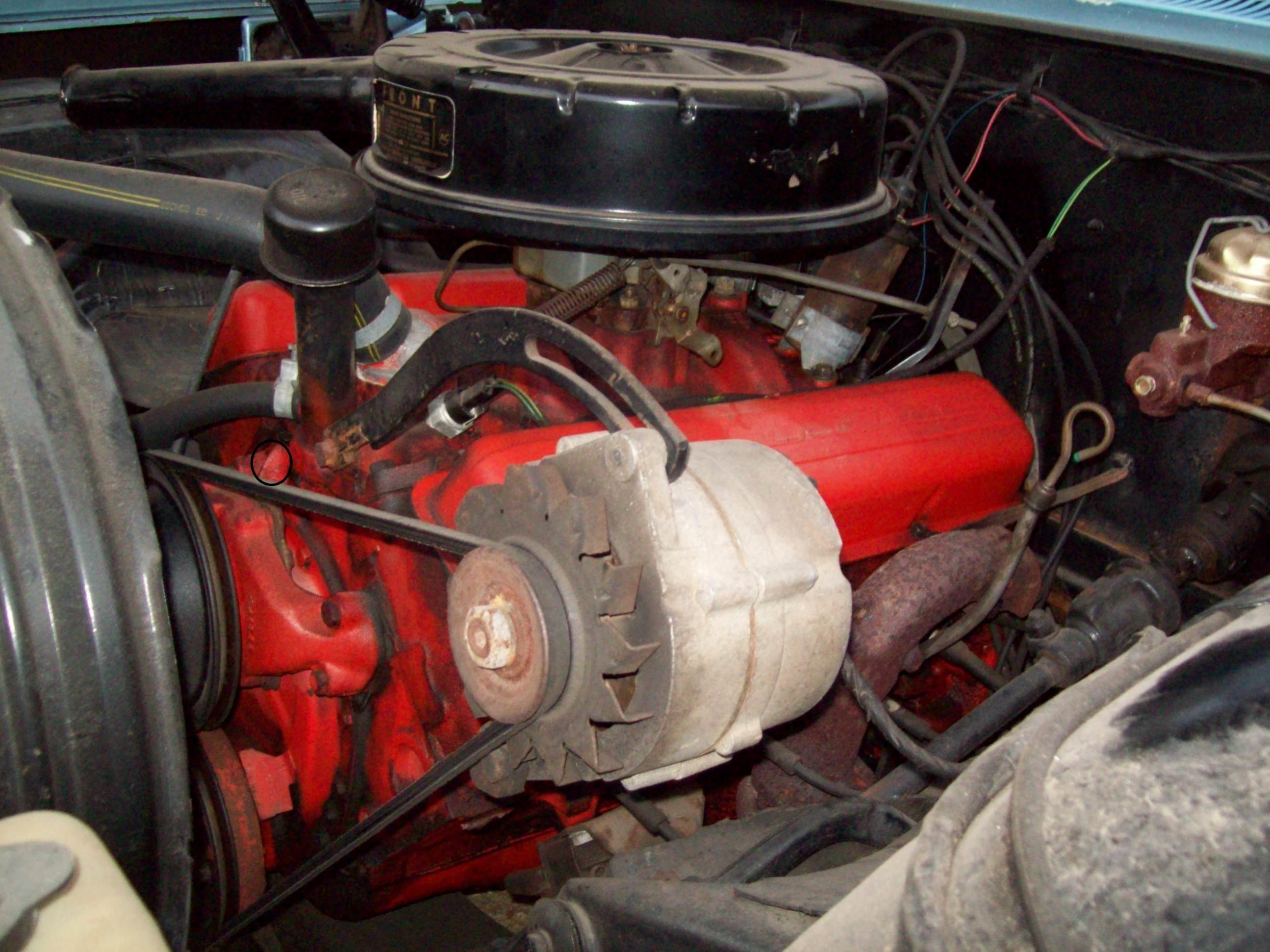

    1963 engine code for 300 hp 327 was RB for 3 and 4 speed, SB for Powerglide, SG for Powerglide with AC. Check the block numbers.
    Bob

    The rib on the front right of the block pointed out by the circle makes it a 283 or 327. You'll have to click on the pic to get it to open up large enough to see it. Casting numbers on the rear of the block will tell the story.

    It's a long shot, but it could be that the factory ran out of 4 bbl intakes when the engine was first assembled, and a 2 bbl was substituted on a 327, or the factory used 327 heads on a 283, for a similiar reason.
    The parents of a friend of ordered a new Cutlass, in the 1970's that was supposed to have a 350 Olds engine in it. It arrived with a 455, but had 350 decals on the engine.
    The original builder of the 283, (built in 1968), in my 55 Chevy told me that the heads that were used were removed from a 1966 300 hp 327. However, they ended up being 2.02 camel humps

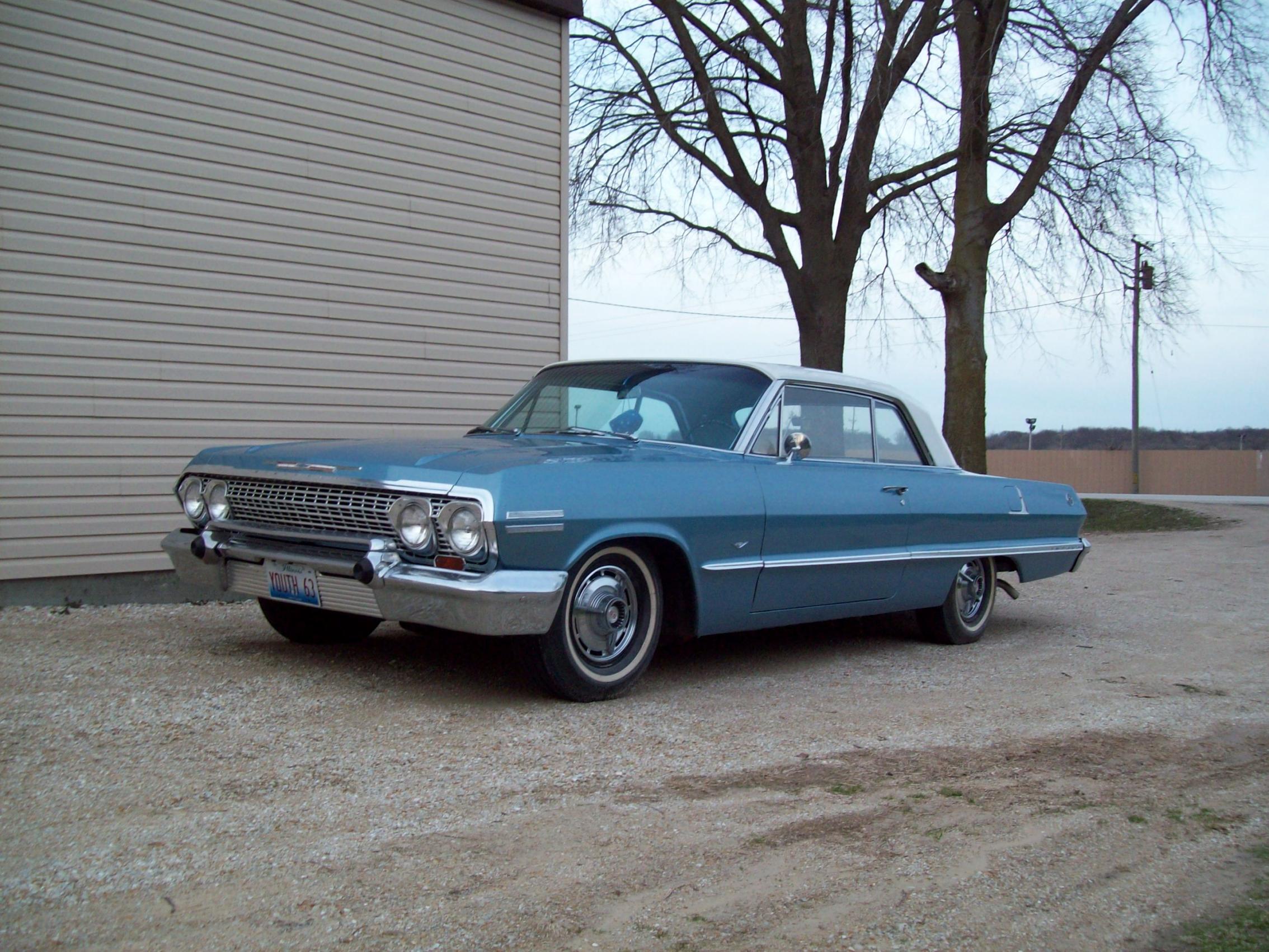

    it has 283 emblems on the front fenders...

    Someone tried to make a 327 look like a lo-po 283; "you just got beat by a 2 barrel, 283". Like that sneaky trick has't been tried before. Or maybe someone just replaced the Power Packs with camel humps with a rebuild/valve job. Butch/56 sedandelivery.

    As has already been stated.....get the stamping number from the passenger side front fo the block. Anything else is worthless speculation. The exhaust manifolds look like standard 2 inch outlets, not the 2 1/2 inchers that the 300 hp engines used. It's been fifty years....that engine could be made out of six different small blocks by now. I'm old enough to remember the first big oil crisis in '73-'74, and lots of people were removing 4 bbl. setups, replacing them with a 2 bbl. and thinking it would get them better mileage (which it almost never did, but some people insisted upon it anyway).
  21. Did you get the block numbers off the rear yet and also off the pad? this is what is needed to figure out what the motor is.
    the longer pads are early...the shorter front pad are newer blocks, think they start mid 70s or so.
  22. Lots of things can change over the years. I've taken off Q-Jets and replaced them with a 2GC before (gas crunch and it did get better mileage). The OG valve covers may have had bent flanges and leaked, replaced with 283 covers that were handy.

    So much can happen over the years you ever know what it has in it. My guess is its a replacement engine from a local rebuilder that was finished off with an intake and valve covers that had been lying around....
