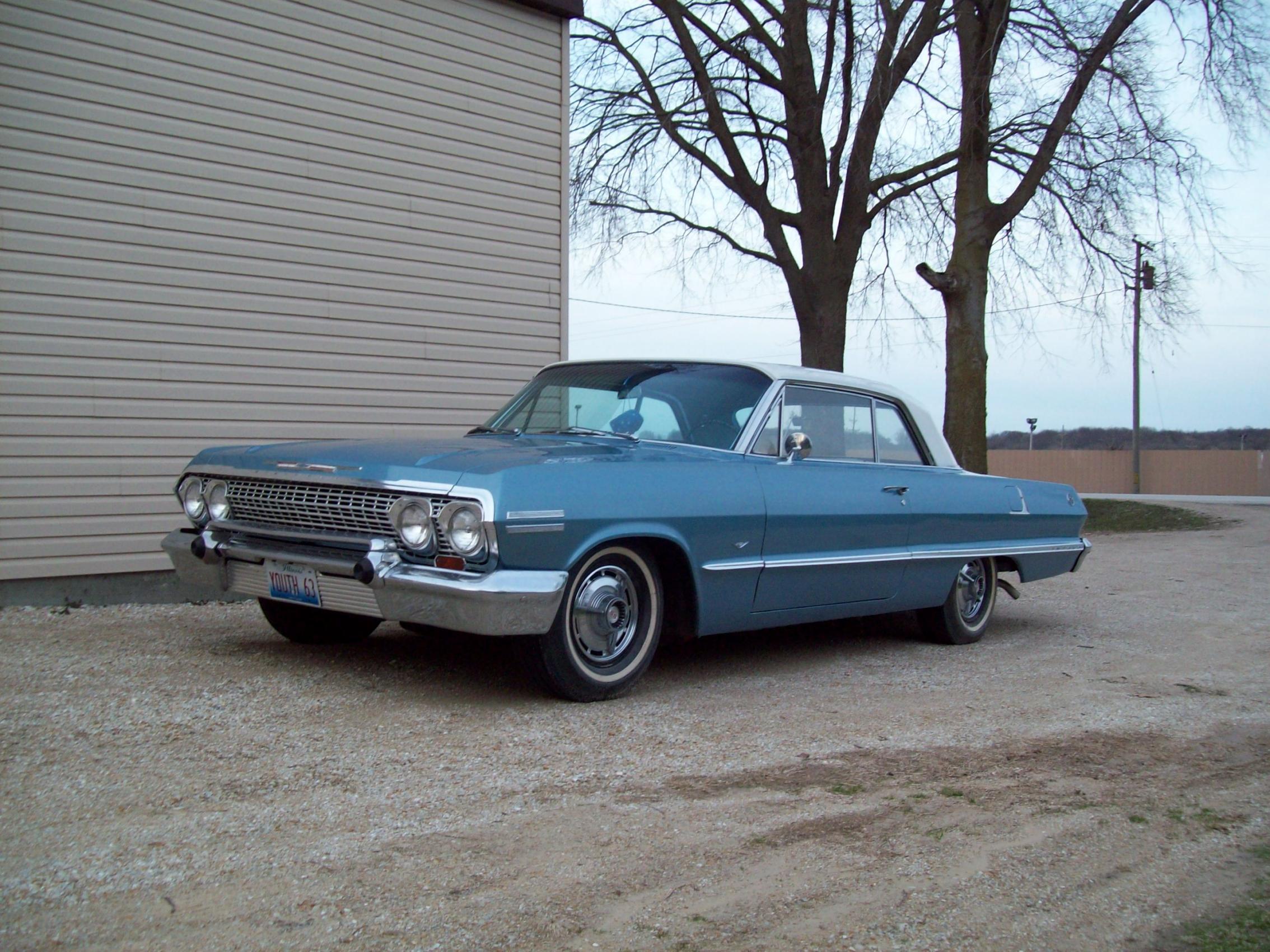

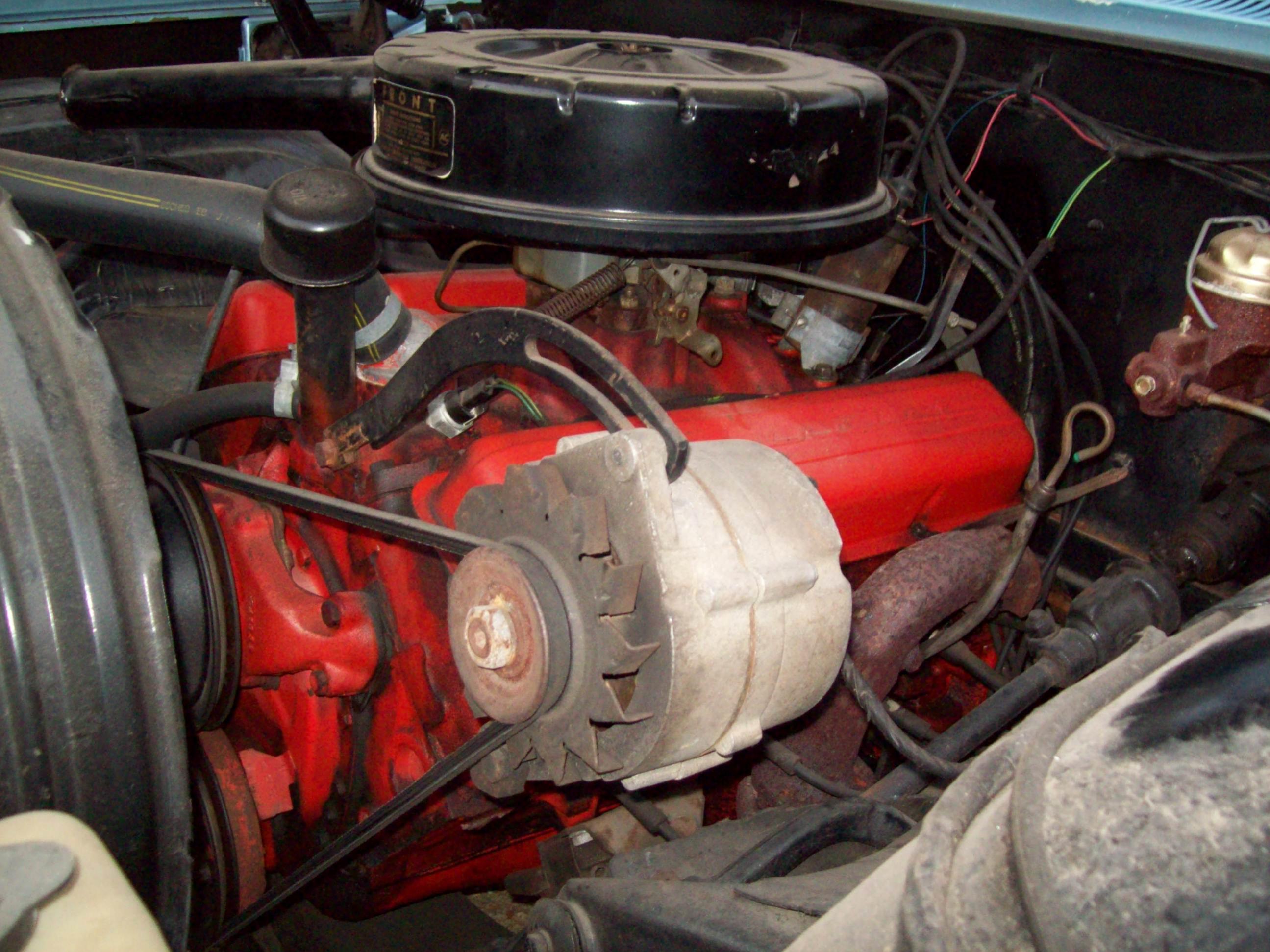

  1. This inna 41 thousand mile 63 Impala S.S. should be a 300hp 327.It has double hump heads with 283 covers and 2bbl intake....ya suppose someone was tryin to get better milage and replaced 4bbl with 2? I don't get it...283 covers?
  2. nice car...
  3. chaddilac

  8. I don't care what it is but it DOES have double hump heads! How many 63 SS 4speed cars had 283s? Stock... I say its a 327/300 hp someone put a 2bbl carb on ...

    Yeah, I see why you think something is not right there. I could see changing out the intake for two barrel but not the valve covers. Everything points to a 283 until you get to those double hump heads. Time to check the numbers. Nice car, especially with the gear shifter thingie.

    300 HP engines had 2 1/2" exhaust. Unless they changed the whole system. If it's 2" snd rusty it's probably a 283 or 250 HP 327 ( but that should have a 4 bbl)
  12. Yes it just has my curiosity up...my buddy doin the swap is gonna run the numbers cuz we were kinda wundrin wtf? I realise SS cars had 283 but never with these heads...I still say 327 with changed out 2bbl/v-covers...
  13. I will check,I know the ex is new front to back soooo did they replace with proper size? Prolly replaced it with what was on it I'm sure...stay tuned...

    Its time to pull the valve covers and check some numbers. Check the block castings nos also. I am thinking 283cid. The numbers will tell you the whole story.
  20. Or someone replaced a shelled 300 hp 327 with a 283. Pretty comon thing to do.

    Maybe it's a 283cid. and they put double hump heads thinking it would make more power.

    Correcto mondo the SS was a trim package not a performance package. My father bought a 63 Impala brand new with a 283, 2bbl and glide. I put Corvette finned aluminum valve covers on it. I totaled the car out one day and the guy at the body shop bought the car for the "327 Corvette engine" in it.

    Im seeing a 283 equipped SS 63 that just has double hump heads installed. My brother had a REAL 283 SS 63 with 49K miles he got from original owner. It had power pack looking heads not doublehumps.

  29. That's no 283, the pad above the water pump is to large. That's a later SBC. Many thing's happen in 50 years.

    Back in those good old days, a person could order a car with all kinds of options or deletes. Anything within reason is possible. Why not check the block number and know for sure?
