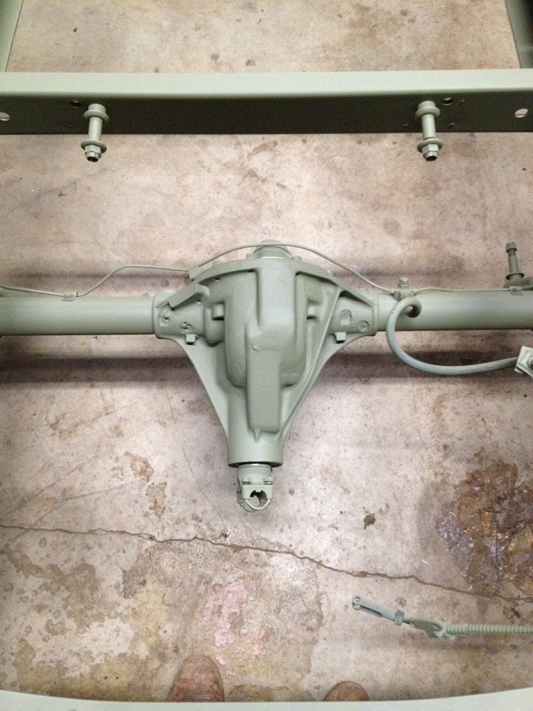

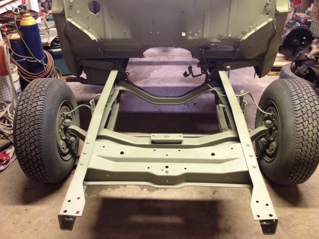

  25. mtphammer
    Joined: Aug 10, 2013
    Posts: 34
    mtphammer
    from Fresno
    First mock up of engine
    New front disc brake kit
    Drilling motor mounts
    Transmission crossmember fabricated
    Disc/drum master cylinder mocked up
    New Dana 60 with 3.55 gears put in place. Also undercoated the frame.
    Painted the master cylinder
    Engine in its final resting place.
    Fabbed up new rear brake hose mount.
    Bent some round stock for my shifter handle.
    Brute strength and ignorance can overcome any mechanical problem.
