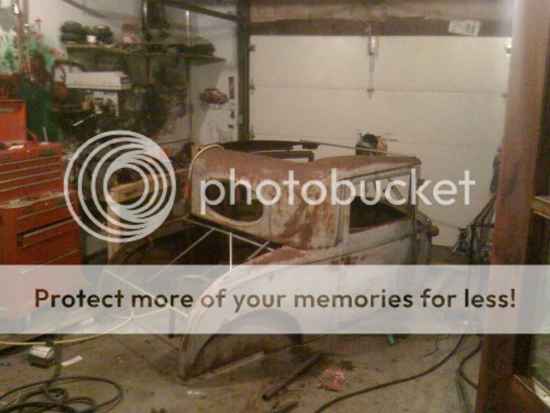

    I guess i'll start one of these things.
    I acquired a 30' pontiac body from my brother in exchange for doing some work to his flat roof T. I figured with my old project truck out in storage, now is a good time to pull the pieces out of the basement and start stringing them together.
    Odd thing is, he has another identical 30 pontiac body, and this was his 'donor' body, which means he stole the visor and windshield posts off of mine to make his more complete. Enough babble.
    The start
    starting stringing the panels together the other night.

    Sold my OT custom truck and progress is beginning again on the Pontiac. Started welding the roof to the quarters. Progress will be slow and steady starting now.[​IMG]
    Also, Gigantor off of here was kind enough to donate a section of roof he found in the woods as patch panels for my caved in and dented up passenger side. Before welding it in, I wanted to try my hand at dolly work on the dented up roof because I had nothing to lose....turns out I banged it back close enough to be saveable.
    It was bad before. Still needs alot of love but I got time.
